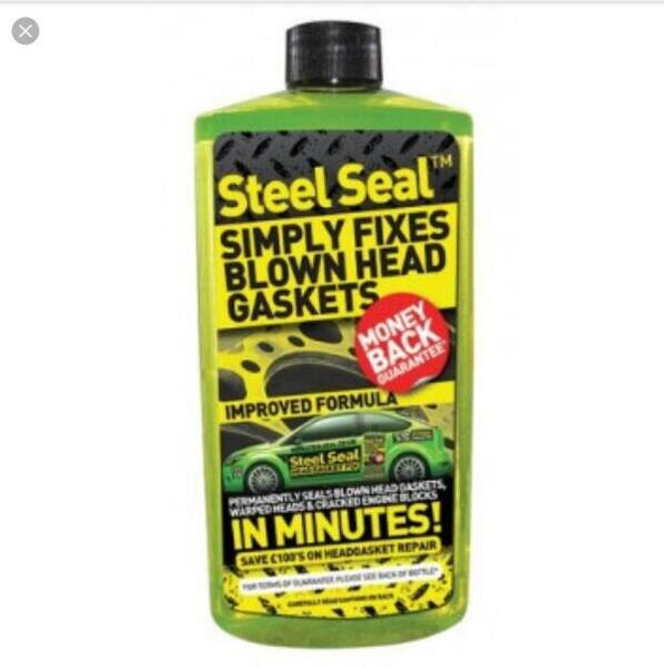

Just bang some K seal in it before it gets any worse, the smaller the fault the better chance it has of working. I've used it numerous times over the years as I've always run bangers on a tight budget.
I'm going to side with Ghosty on this one, when it comes to K seal or whatever.
A sealing substance into the cooling system works when water is trying to get out, as it gets drawn towards the leak.
Whereas in this case, the leak is backwards, and exhaust gases are coming into the water. So there's no way the k seal would be drawn to the gap/leak, as the gases are pushing inwards. Make sense? It does to me.
Other than the burst pipes, there is no water escaping, and no steam in the exhaust, so it appears that the leak is one way.

From someone thats been in the same situation, ive used this and it keeps the car going long enough to sell it for a decent price..

I used Steel Seal this afternoon - will let you know on progress.
*makes mental note to never to buy a car from this gentleman*
It was only once and it was sold to a mike brewer wannabe facebook trader.
