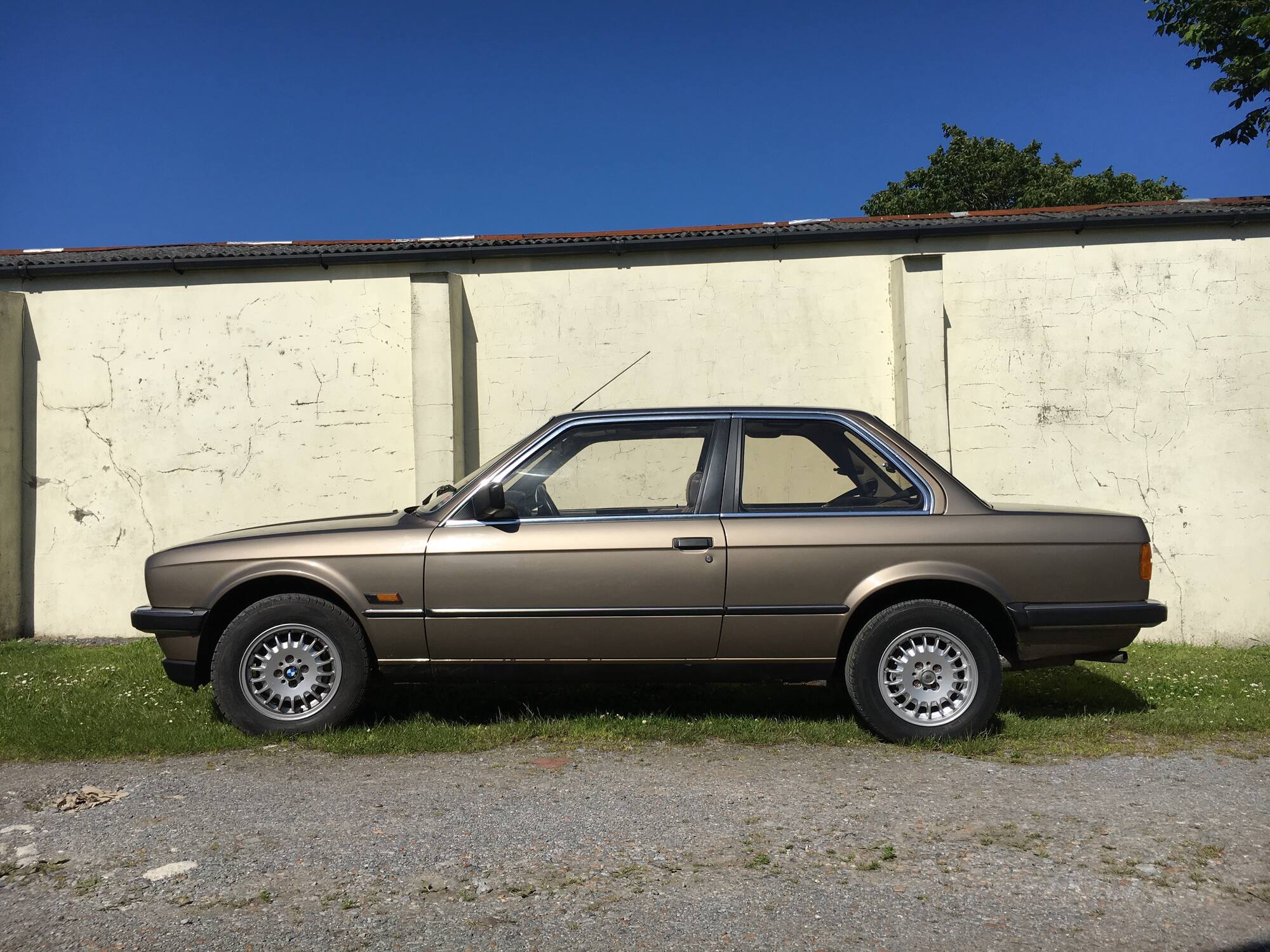

Now that looks like a winner.
Single exhaust pipe too - does it have metal door handles?
Super early ones ( I think they brought them in on a Y..) had metal door handles, no central locking and manual windows as standard.
Shortly thereafter, plastic handles cam win, and anything with a proper cylinder count had electric windows and central locking.
It looks an honest Old tub
Well bought
You had to stretch to a 323i for twin pipes.  Yes, they launched in November 82 in Europe and came in half way through Y here; I believe this is one is an 83 build, first registered Feb 84.
It has central locking and electric mirrors  (both standard I think, and all working) but manual windows.  I’ve got a Car Giant Test from 1987 that says leccy windows were still optional even on the 325i, pre-facelift.
It’s so tiny in the cabin that it’s easy to wind down even the passenger window from the driving seat. You don’t so much sit in it as wear it.

It just looks better with every further picture. What a buy.
Much of the old jealous.
