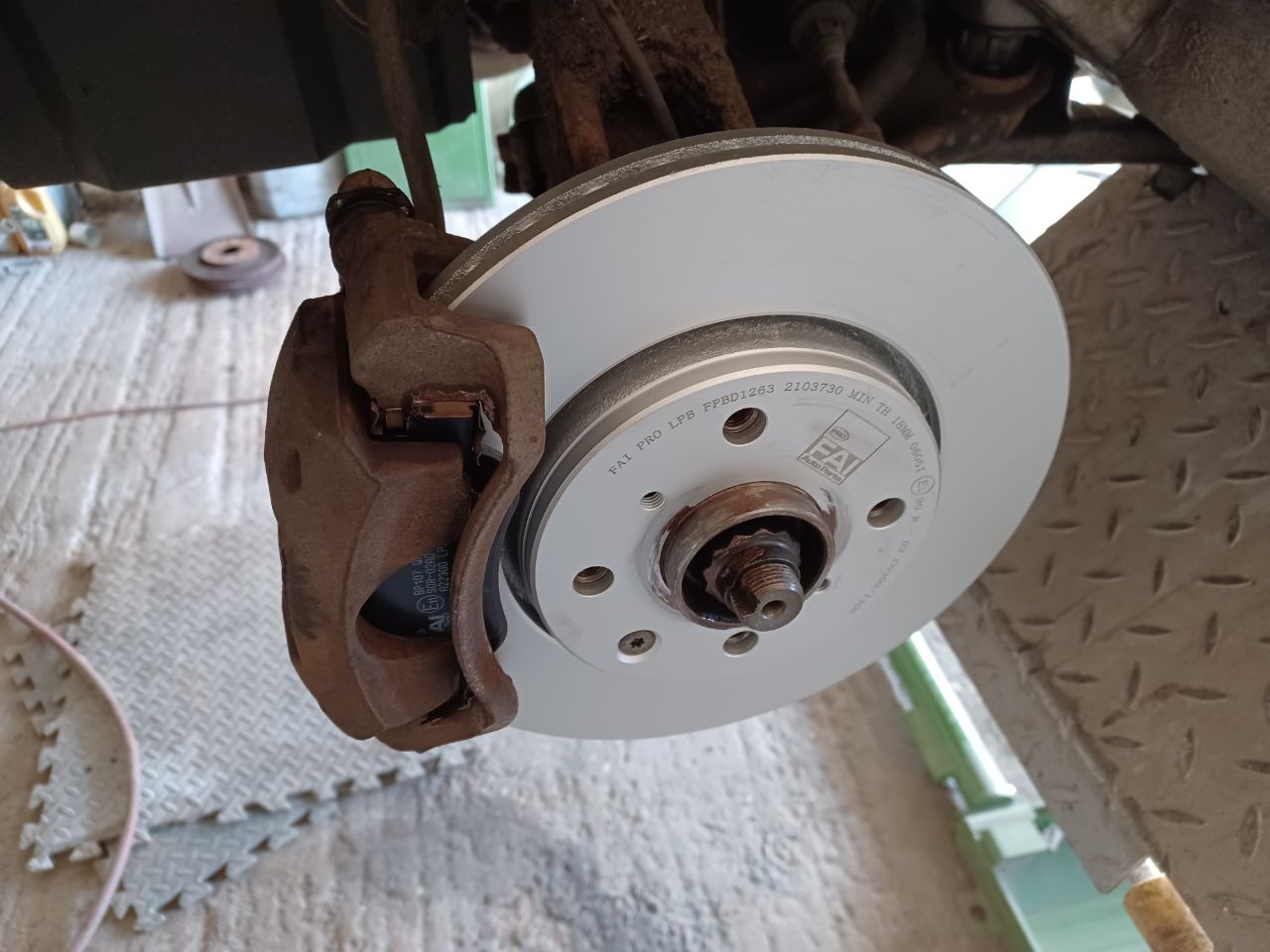

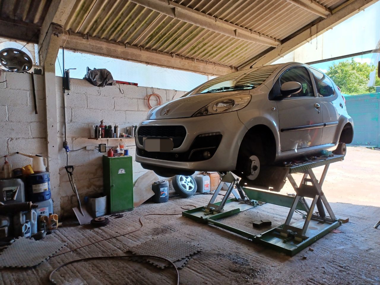

New discs and pads, a wheel bearing went on too at the back as it was grumbling. First time using FAI brakes, seem nicely made.

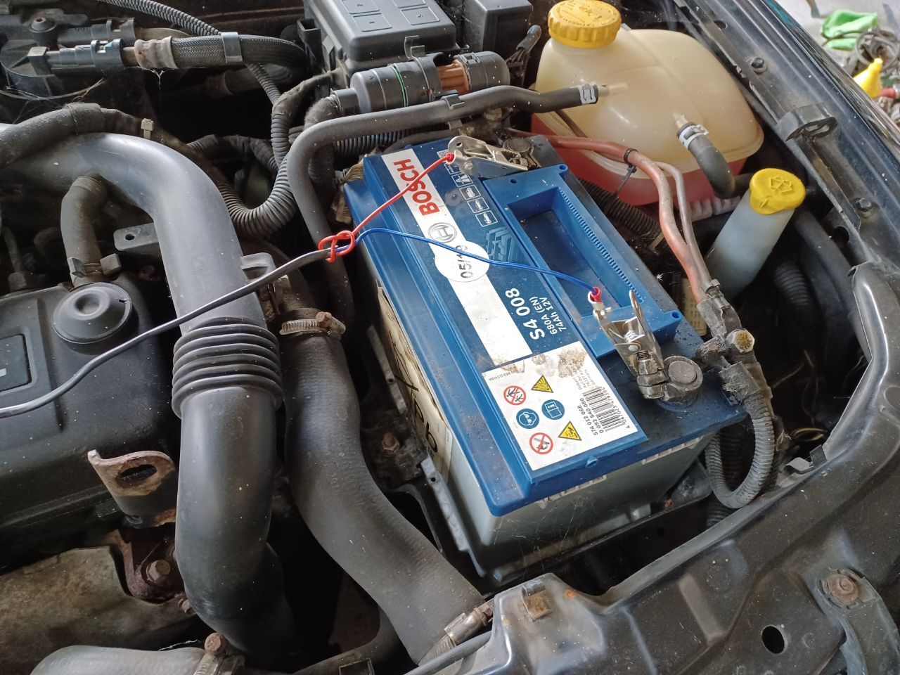

The black astra has returned from being on loan, Its been laid up for a few months and wasn't being used. I jump started it on my friends drive and beat the piss out of it on the way home. One thing of note was the steering was off and i was getting some very sweeny style tyre squeal. I took a roundabout at a brisk pace but it sounded like I was doing about 80!. Stuck my wanky alignment on and if it's to be believed it was a bit off.

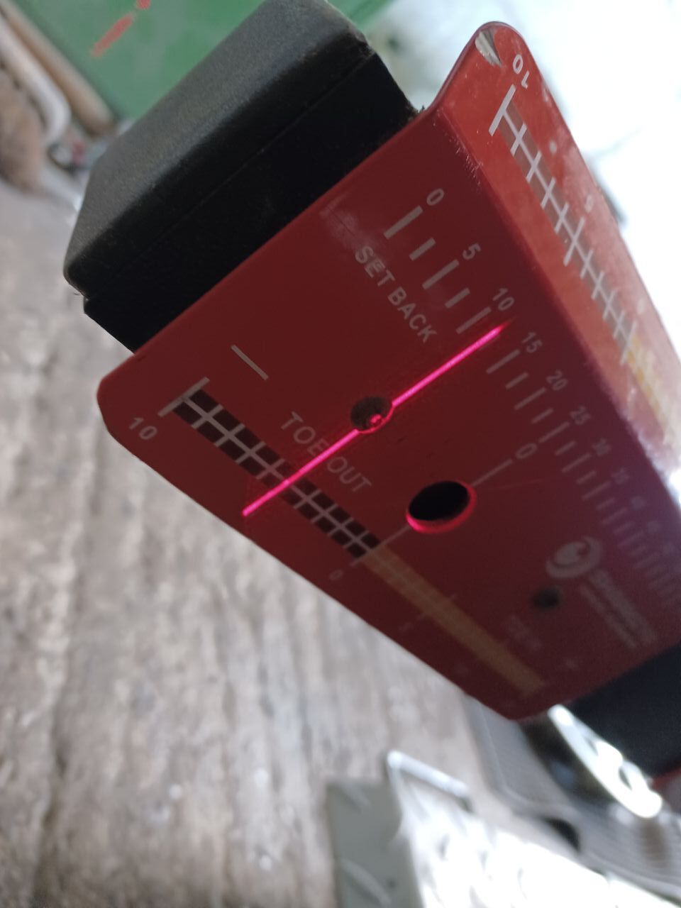

Tweaked it to 0 and it seems much better. on a quick test drive, squeal has gone from low speed and back to normal budget tyre screeching if giving it some shit.

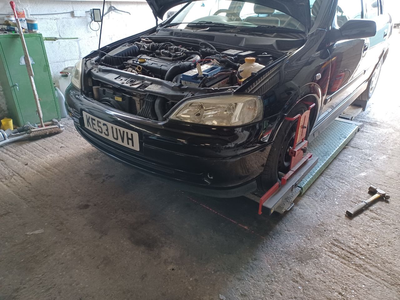

Regarding the alignment gauges, which turned out to be broken (buying something from Birmingham and it being fucked shocker) I binned all the battery pack and control board inside, purchased a 12v to 6v converter box for 7 quid and now it just Croc clips onto the cars battery. Nice simple cheap fix.

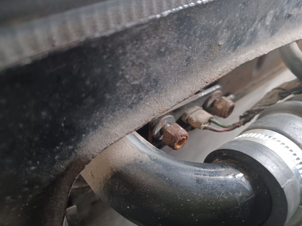

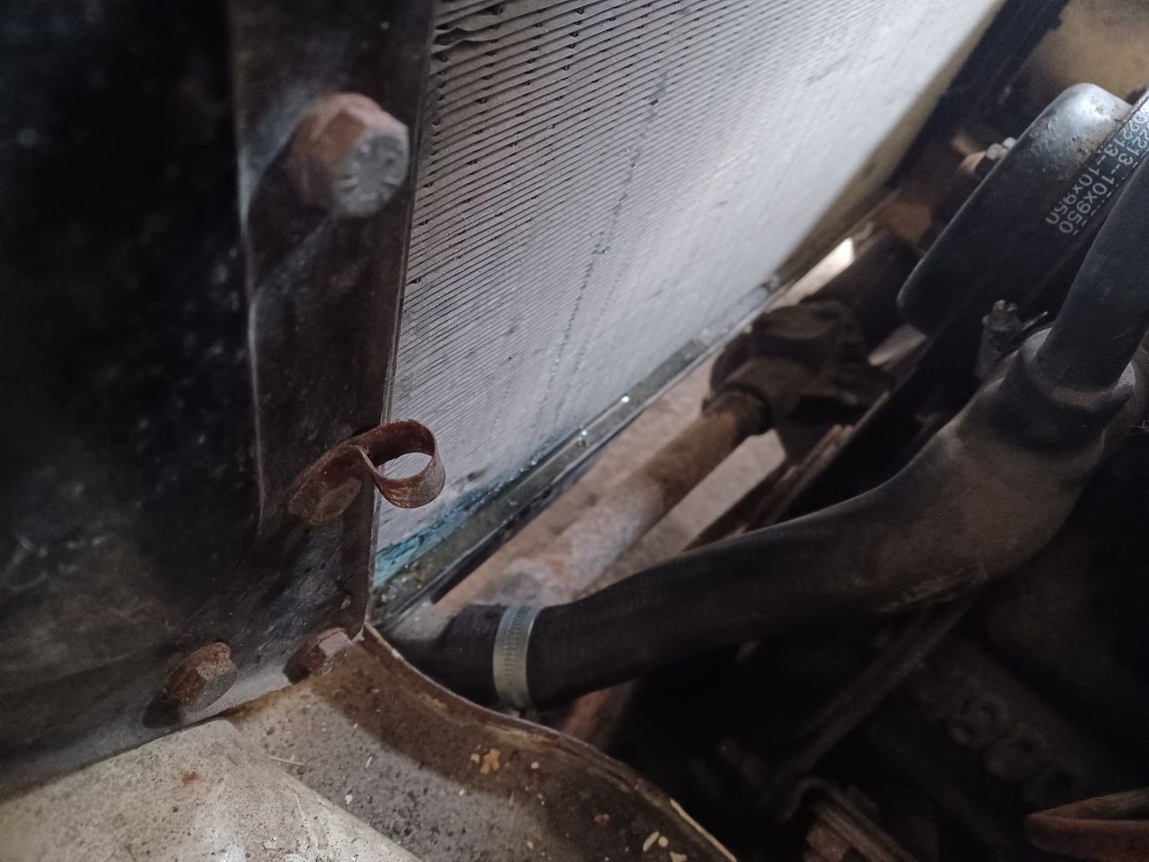

This car is a very early rubber bumper car, so has a centre fill rad. But unlike all the replacement rads online which are for cars with a mechanical fan , this has a hole for an electric fan switch (Like the later no cap rads) So hard to find then it seems this one.
I decided to pop the fan switch out as the wiring into looked pretty rough and to test the switch. This photo doesn't show it too well but it was looking a little frail.
that went well. . .
the retaining studs solder broke inside the rad so now the stud just spins and the rad leaks even more. Great, what a mojo boost this has been.

The wiring to the fan was separate but looked old enough to match the car, so maybe this was a factory thing? The loom itself was separate to the car loom I decided that the wiring was something that needs addressing. I ripped out the fan wiring and decided I'd just get a mechanical fan and do away with the fan switch, I'll leave the kenlowe in and wiring it up so it can be used in a emergency.
The wiring then, some absolute throbber has been at the wiring, now when the car was restored in the past they re wrapped the loom while the engine bay was painted. Posh cloth tape? Electrical tape? No, fucking silver gaffa tape. It's exactly the kinda mess to remove as you would expect.
Hidden kill switches, fog lights and other tat splice into the looms hacked out and binned. Choc blocks, house hold wires, 3ft of cable made from 4 different bits of wire crimped together all ripped out.
The two relays above looked aftermarket, I felt maybe they were added in to the headlight loom, the wiring was all varied sizes tiny wires joined to thick cables. Unwrapping the loom revealed they were just extended to move them about a ft away from where the should have been.  They are for the ignition and starter it seems. Why? just why did they feel the need to fuck about with them just to move them. I'll re crimp them back to were they should have been.

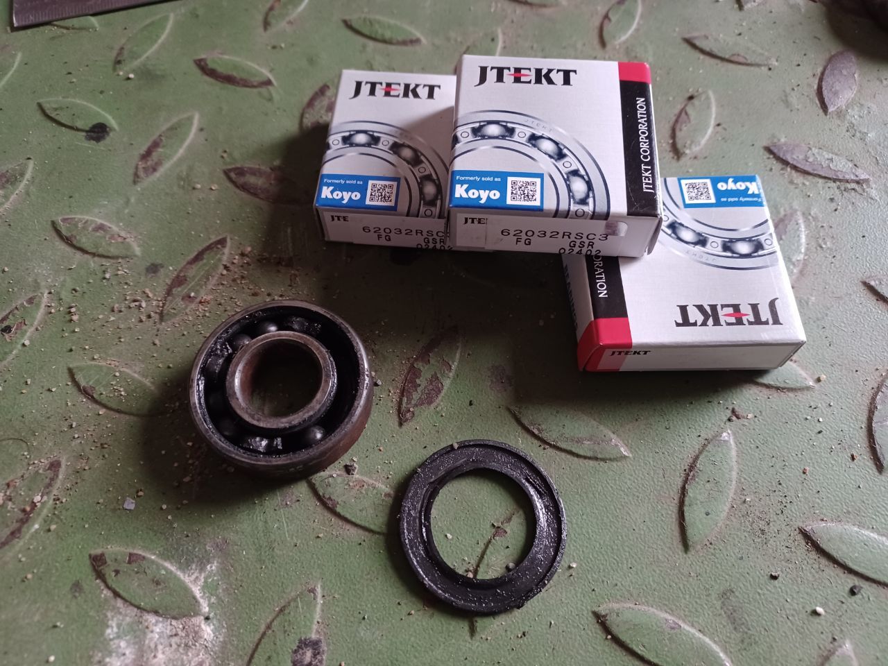

Dead bearings out, New bearings fitted.
Now runs as smooth as a smooth thing.

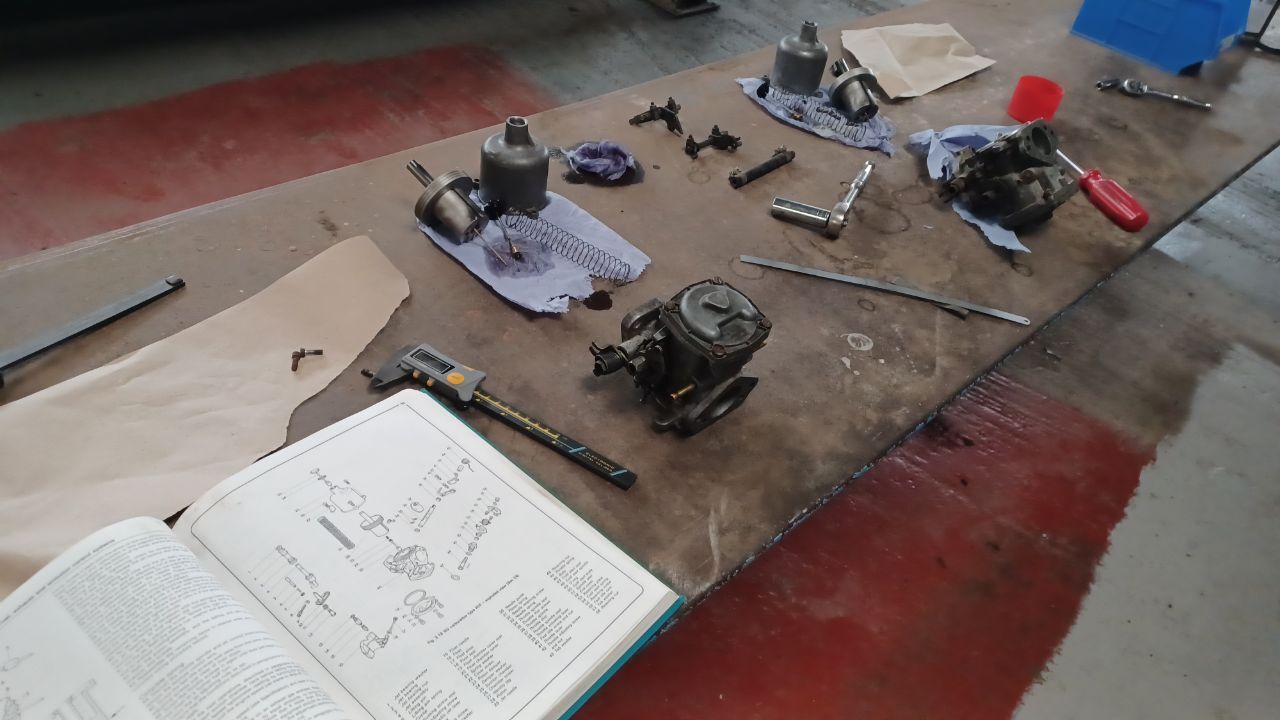

Today i gave the SUs a quick go through, the floats were miles off and there was a seal spacer missing on one of the jet guides, jets were set miles differently too. I had wondered if by small chance the smoke was unburnt fuel from the carbs pouring it in. It would seem not but the job still needed doing, needs a basic rebuild kit but wanted to get it good enough for now.
