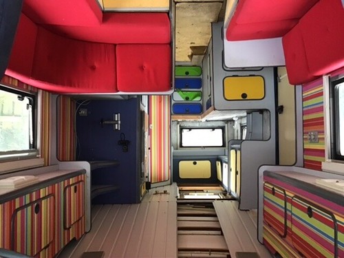

Mercedes 508D Motorhome. Somehow I just wouldn't want to wake up in this......!
https://www.ebay.co.uk/itm/Mercedes-508D-Motorhome/143709382186?hash=item2175bf262a:g:yHMAAOSwvvhfSojK
5 hours ago, wuvvum said:
There's little danger of me ever waking up in that as I wouldn't have been able to get to sleep in the first place, even if it was the right way up.
Oh! fucking hell, I didn't actually realise it was upside down until you said that LOL

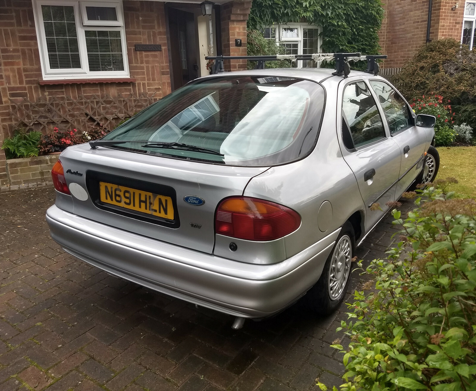

Have we had this? Tidy looking V6 Mk1 Mondeo, MOT'd til February 2021.
Seems very reasonably priced at £1295 to my mind.
We have but who cares its a lovely looking thing.
I had an estate version in Manuel flavour which was free and loved it. Another one I should have kept but fuel was £1.50 a litre back in 2008 and it seemed expensive to run then. Was actually not bad on fuel at all. Took it on a long run to Brighton amazed at the cruise control and heated front screen being a Ghia flava.
