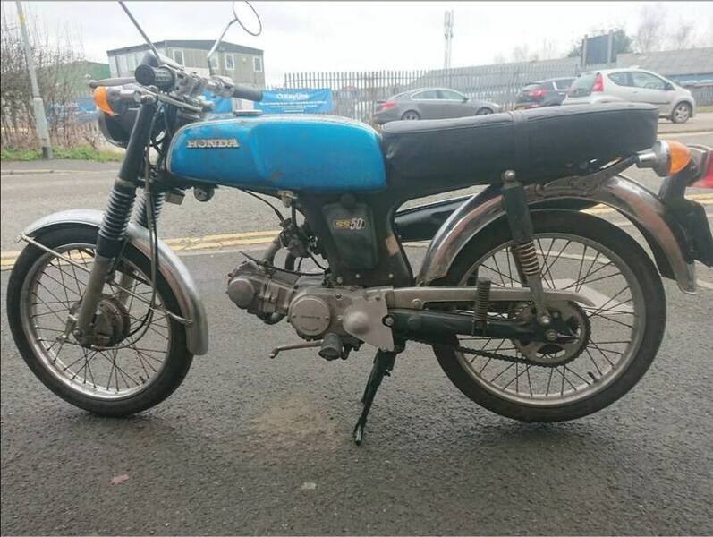

My first proper bike :)
This looks  like a four speed ?
Definitely worth getting a five speed conversion done.
Then post it to me.
4 speed indeed and crying out for at least another gear. Plan is to leave it how it stands, but think a mate has a spare 110 or 125cc Lifan semi automatic engine somewhere.

If you go Lifan ,keep the origional motor, there's loads of sad old duffers out there who'd pay good money for this.
5 speed was the same except gearbox, bars and Speedo.
So many memories of a beast like this... some of them pain full :)
I'd leave as it is. So many saddo's (like me) like them as they were when we were 16. Only worthwhile mod is to 70cc Honda barrell, head and carb. Proper 1975 modifications

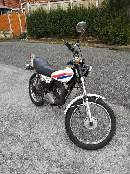

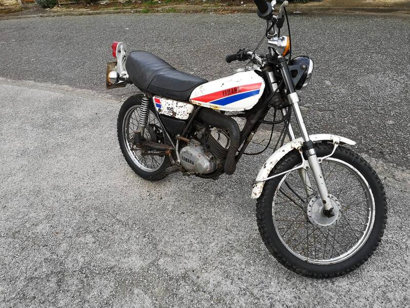

Of course,being strange ,I had to have one of these:-unnamed.jpg.28935a9b0d50f05028e37f040a50490a.jpg
(Not this actual bike)It did an indicated 48mph,ok for 50cc.

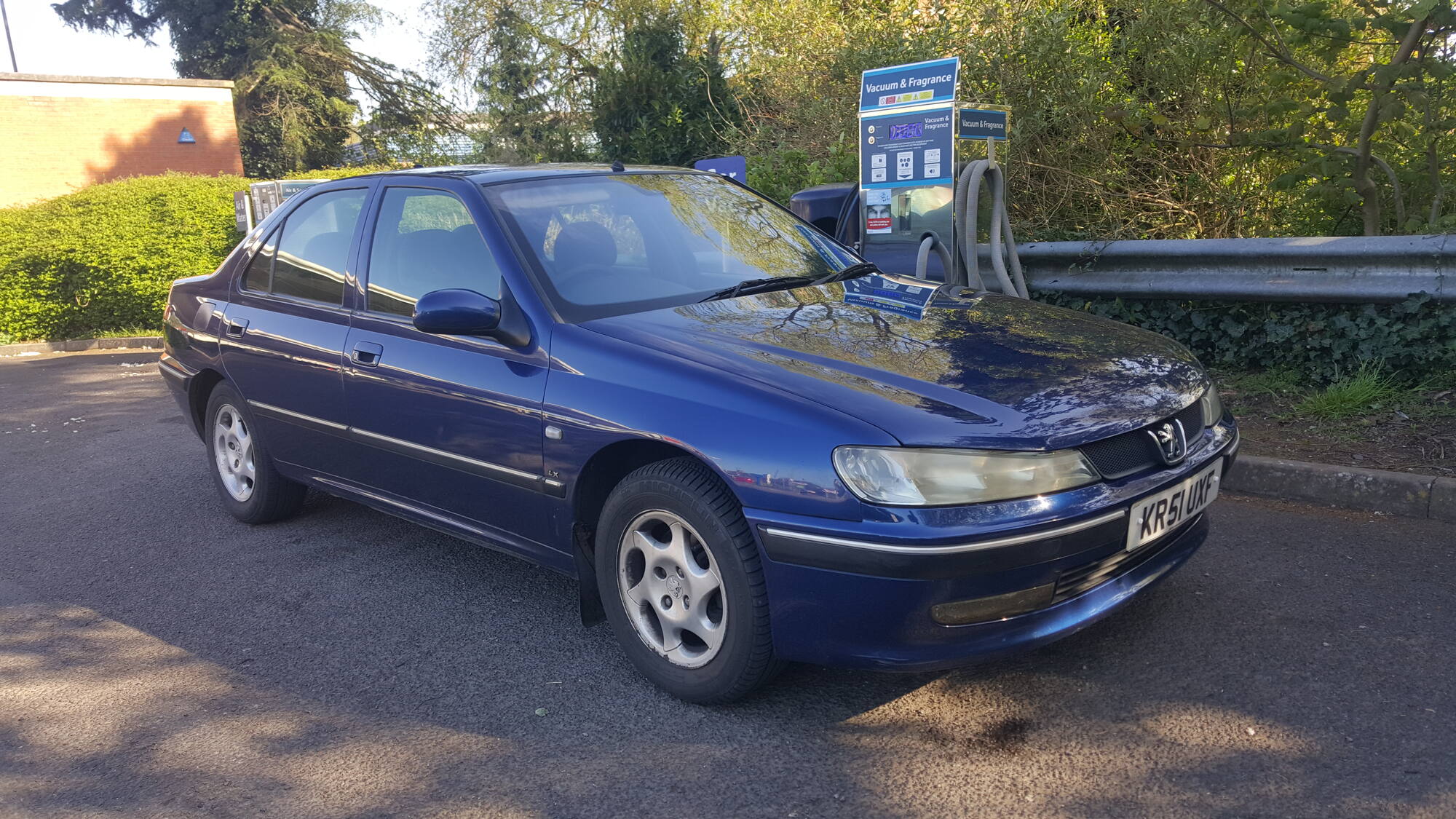

Talking of smoke, the 406HDi is still out the back, as not been used in a while. It frequently displays its gratitude for spending about 14 random days cleaning it by behaving like a wanker. Tried clearing the DPF thing by warming the car up first, then going for a decent run and giving it some welly, i.e 5 miles down the by pass flat out in 3rd. That seems to clear out a load of smoke, but then it just carries on randomly going into limp mode. When it runs as it should, it's ace, but it very rarely does and pulling away at roundabouts is embarrassing. Once into second and third in limp mode it's just about bearable if you've not got someone up your arse end, but it's still shit.
If you don't try clearing it out it seems to run a little better, but I've not done a single journey yet (even the 3 or 4 miles to work) without the fucker playing up. The usual sign is that it shakes like a shitting dog at tick over and it feels like the clutch is vibrating, though when the car is behaving itself, that goes away.
Suspect it really needs one of those 'Carbon Clean' people with a buffed up old Vivara van to come round and over-ride the rev limiter, before taking it to about 9,000,000RPM for ten minutes, or whatever they do. The radio isn't very loud, but is very loud when it switches itself on for no reason, and the bastard things still stinks of bifters (but not as badly) despite the big clean up. Might possibly take the seats out and jet wash them, ditto the carpet.  My missus prefers to get a lift to work in the Transit as it's ' less horrible and doesn't smell as bad'.  I haven't attempted to sell it as at the moment it's useful as a garage door blocker and the nice Michelin tyres are the same size as the ones on the Galaxy.
*Edit: put a tincture of veg oil in it the other day, just to teach it a lesson. Not tried driving it since, but will possibly use it to go to work one day.
5000 shite points for use of the word 'tincture'.
Good to see your 4 wheeled escapades are continuing as before!
Slurp seafoam into the intake?
Tbh the DPF (is it not a FAP?) probably needs taking off and cleaning properly. Surprised at that age they had one. Would be one of the really early ones and probably quite experimental for PSA.
Sorry not seen the 406, is it a coupe with the 2.2hdi?
If so they did have optional FAP/DPF from about 2003, a shit system that needs unicorn jizz fluid, quite easy to map it out and gut the DPF, at least it was on my old C8 with the same engine.
Thanks lads, and soz, it's this one, which is a 2.0HDI...
Just assuming it has a DPF, could it be EGR and that's the problem?
99% sure that won't have a DPF, some other PSA licker can confirm.
Could be EGR, to be honest on these there is not much to go wrong. Is it a 110 or a 90 HDi?
Shaking at tickover could be an injector maybe? You could try putting a new fuel filter in, with a bottle of diesel magic or similar straight into the filter housing neat, then take it for the mother of all thrashings.
These are the old 8v HDi and are normally tough as old boots, taxi drivers in experts etc often downgrade to this lump as it's so much more reliable than the 16v that replaced it.
Lold at that review from your mrs though, not exactly a ringing endorsement.
Ahh, actually forgot, put a new fuel filter in that replaced a genuine Peugeot one, (but surely that's not the original?) that was absolutely minging. It did seem to make a difference for the first couple of miles, but it does have the odd moment where it runs ok anyhow. Not sure what BHP it's supposed to throw out, will try and find out.
It doesn't always shake at tick-over, but an injector could well be the problem, thank you.
I know very little about the engines in the 406 but the symptoms sound similar to a dodgy MAF sensor.
Have you tried unplugging and taking it for a quick drive it to see if it makes any difference? It might not, but it's quick and free.
Asking about bhp as the 90bhp has a simple wastegate turbo which doesn't really go wrong and the 110 I think has a variable turbo which could have issues with vac hoses etc causing overboost and therefore limp mode.
You may be able to tell by looking, the 110 has an intercooler and the 90 doesn't, so if the intake looks like it comes from the back of the engine it's a 90, if you can see hoses coming to/from the front somewhere it will be a 110.
Yep, this is the easiest way to visually tell apart the 90/110 HDi engines.  If there's an intercooler it's the 110.
Should have a sticker in the door showing either 90/110. 90 has no intercooler. No dpf on any Ive ever seen. Cam position sensor can cause awkwardness on these if I remember right.

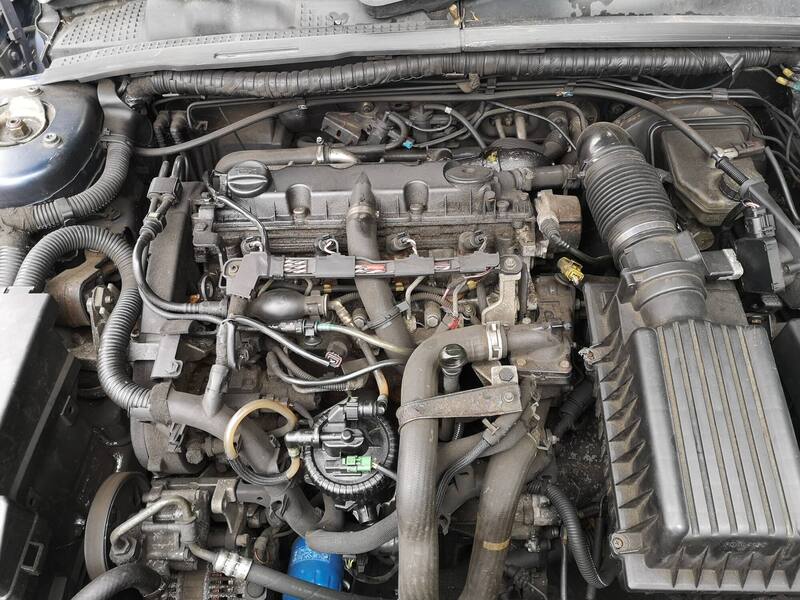

Took it for a thrash before, started ran and drove ok. When you absolutely cane it (i.e hold it in each gear at max revs, or rev flat out at tickover) it makes a sort of ',wah wah' noise. Hard to explain, but it's like although it's staying at full revs, the noise makes it sound like it's fluctuating. Does that sound entirely stupid, or can anyone relate?
Thanks, as ever.
Is three and four injectors leaking? There looks a little funky around the head there.
They have a crush washer that leaks in old age, although there about 50p each.
