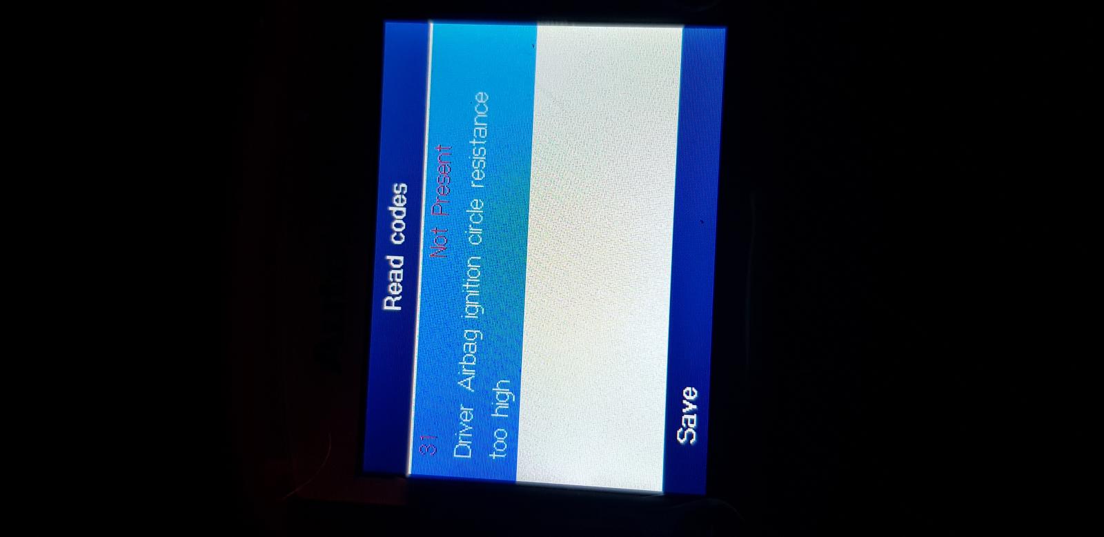

drum Posted February 15, 2019 Posted February 15, 2019 Wassup dudes? A wee search found that Autell has been mentioned on these pages before, so rather than start a new thread, I'll join in here. I bought this today It's good! My Volvo had the eml light on, omega has airbag light, wife's golf has abs and tc lights and daughter's polo abs light. All diagnosed and cleared temporarily. The Santa fe with blown turbo was also checked. Sorry about the pic orientation. Mrs6C, Tickman and Lacquer Peel 3
Tickman Posted February 15, 2019 Posted February 15, 2019 Wassup dudes? A wee search found that Autell has been mentioned on these pages before, so rather than start a new thread, I'll join in here. I bought this today20190215_193432.jpg It's good! My Volvo had the eml light on, omega has airbag light, wife's golf has abs and tc lights and daughter's polo abs light. 20190215_191430.jpg 20190215_191913.jpg All diagnosed and cleared temporarily. The Santa fe with blown turbo was also checked. 20190215_192655.jpg Sorry about the pic orientation.I have a couple of Autell readers and one is VAG specific so if you want a shot of that one give me a shout.I brought up a load of codes on the Octavia that got deleted and I've not looked to see if they are back. drum 1
