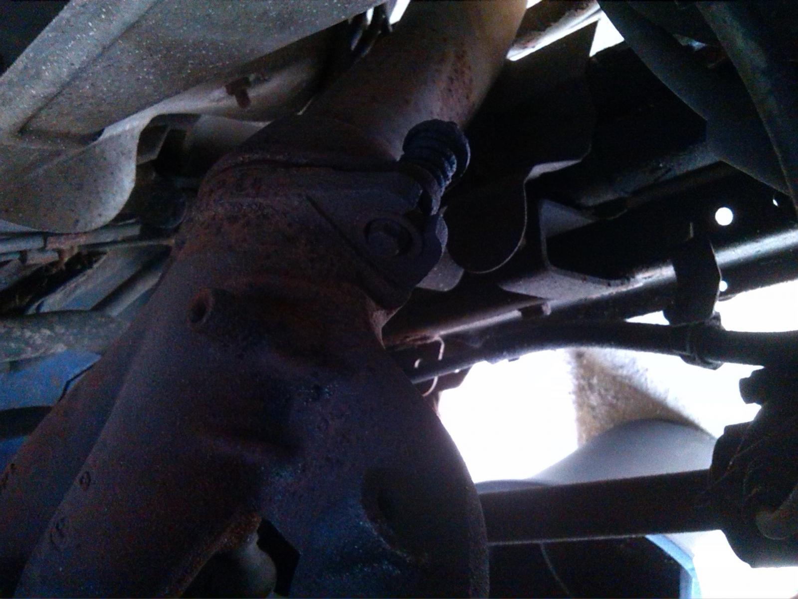

AlabamaShrimp Posted March 30, 2017 Posted March 30, 2017 OK so the mobile mechanic came today and thinks my Fiesta over heating issue isn't the head gasket or the water pump as with it all running everything got hot and the can came on but, the heater still blew cold so he thinks blocked heater matrix. We changed the thermostat just in case (tested the old one, works fine) and later I took it out for a drive. Got red hot within a mile, to just under red on the gauge, then dropped down just as before. Heater s ill blew cold till I was almost home when it was warm. That might have been though as the warm water one side of the potential blocked just warmed the rest. So the question is. Could it be the heater blocked? And if it is why is it getting so hot then not? (don't think I have an air lock)
Guest Hooli Posted March 30, 2017 Posted March 30, 2017 Heaters can block, I can't see why it'd make the engine overheat though. As far as I know it's not required for the flow around the block/rad. Seen enough cars with a leaky heater bypassed to make me doubt it too.
twosmoke300 Posted March 30, 2017 Posted March 30, 2017 What shape fiesta ? The sad fish faced one ? If so it's the heater valve on the bulkhead causing the lack of heater but this wouldn't cause overheating . Also if your mobile man didn't know that then get another
AlabamaShrimp Posted March 30, 2017 Posted March 30, 2017 You can see the two pipes that come off for the heater and they don't stop the main flow round the engine. Just going to take all the pipes off and stick the hose in and see what comes out.

AlabamaShrimp Posted March 31, 2017 Posted March 31, 2017 Help! This stupid Fiesta is driving me mad! In follow up to yesterdays advice that the heater matrix might be blocked I undid the two hoses circled red Stuck the water hose in and ran it until clearish Initial water out was a bit browner than the stuff that had come out of the car end of the pipes and had a few, but not loads of these small bits in So water going through, I reattached everything, refilled with antifreeze and went for a drive. Five minutes later and the temp gauge is going up to the N on norm and then drops to just above where it is here All seems good but the inside heater still isn't getting even warm! Water must be going round the system somewhere. Is it the head gasket? But there's no oil in water, water in oil. Is it the water pump? Relatively new but one of the bolts won't come out and I think it's going to snap. What the he'll is wrong with it?
dave21478 Posted March 31, 2017 Posted March 31, 2017 I dunno what you disconnected, but you need to undo those two circled yellow to flush out the matrix.
dave21478 Posted March 31, 2017 Posted March 31, 2017 Also, I cant remember how foosties are rigged, but there are two basic systems for hot n cold from a heater. First is two air passages from outside, one straight to the vents and one through the matrix to the vents. Your temperature control on the dash just works a flap which changes between the two. In this system the matrix is always flowing hot water. Second is one air passage through the matrix to the vents and the hot cold control works a tap that shuts off the flow of hot water through the matrix. If its this system, these taps often give grief. Im thinking Fiestas are the first system though.
dave21478 Posted March 31, 2017 Posted March 31, 2017 Also also, I am retarded, it looks like you undid the right hoses, just further away from the matrix rather than at the bulkhead connections - should be fine.

Timewaster Posted March 31, 2017 Posted March 31, 2017 Maybe try disconnecting those heater hoses again and start the engine. One side should pump water out to prove that the water is flowing. No?
AlabamaShrimp Posted March 31, 2017 Posted March 31, 2017 Also, I cant remember how foosties are rigged, but there are two basic systems for hot n cold from a heater. First is two air passages from outside, one straight to the vents and one through the matrix to the vents. Your temperature control on the dash just works a flap which changes between the two. In this system the matrix is always flowing hot water. Second is one air passage through the matrix to the vents and the hot cold control works a tap that shuts off the flow of hot water through the matrix. If its this system, these taps often give grief. Im thinking Fiestas are the first system though.Yeah think Mines the first one and the as you can get your hand in I've checked and all the entire stuff is moving as it should. You're right in the first picture but as you guessed I too them off further away as they were easier to reach. Went to the local garage to ask what they thought and he says the header tank on the heater has both he inlet and outlet right next to each other so you don't flush out the actual channels when they're blocked. He also gave me the number of a bloke that can get the bolt out of the water pump if it snaps.
AlabamaShrimp Posted March 31, 2017 Posted March 31, 2017 Maybe try disconnecting those heater hoses again and start the engine. One side should pump water out to prove that the water is flowing. No?I might have to if I can't get the water pump out. I'd be worried about running it without the thermostat open so it doesn't run dry.
DodgeRover Posted March 31, 2017 Posted March 31, 2017 What about fitting an auxiliary water pump to push water through the heater matrix.
dave21478 Posted March 31, 2017 Posted March 31, 2017 Yeah think Mines the first one and the as you can get your hand in I've checked and all the entire stuff is moving as it should. You're right in the first picture but as you guessed I too them off further away as they were easier to reach. Went to the local garage to ask what they thought and he says the header tank on the heater has both he inlet and outlet right next to each other so you don't flush out the actual channels when they're blocked.He also gave me the number of a bloke that can get the bolt out of the water pump if it snaps. Get a bit of pipe and connect the two hoses that go to the matrix together, bypassing it entirely. If this bit of pipe gets hot, your problem is likely the matrix. cobblers and tinribs 2
AlabamaShrimp Posted March 31, 2017 Posted March 31, 2017 ^^that sounds like a good idea! Tbh both pipes in and out were hot yesterday when I took it on a longer drive but that might just have been from the rest of the engine being hot.
