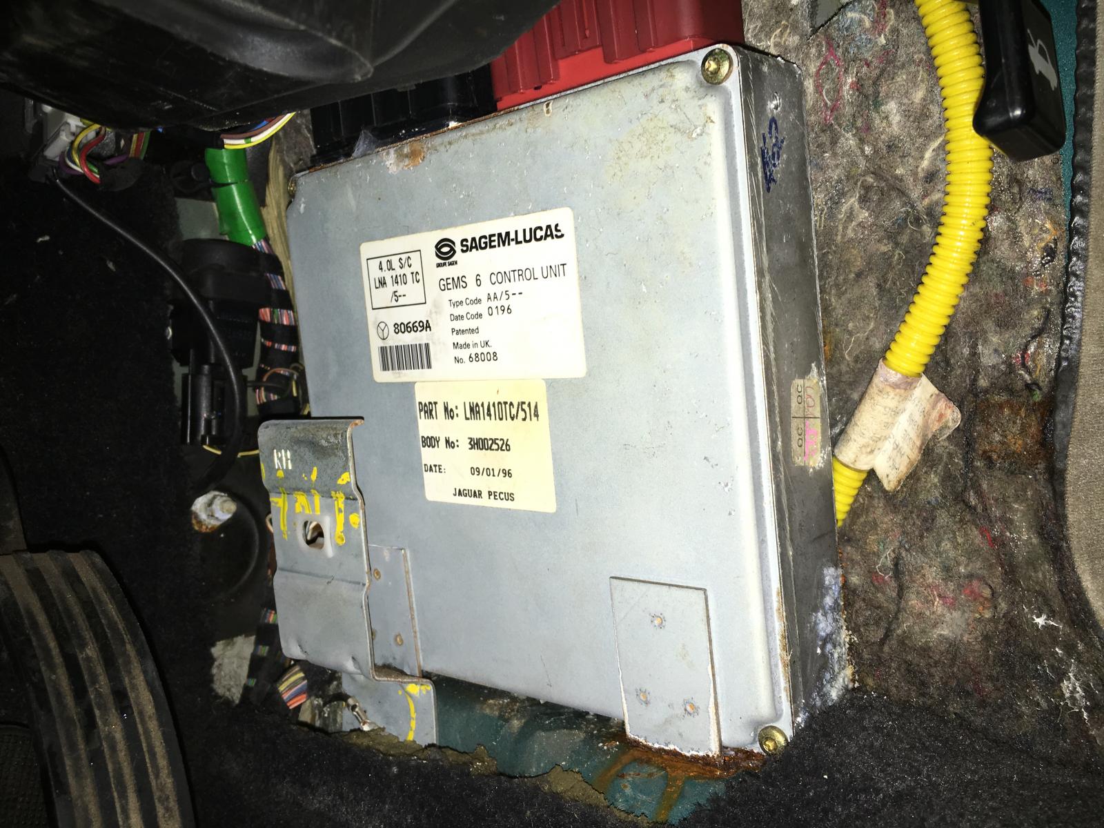

As far as the engine troubles. Here are some ideas:
1. Disconnect throttle cable and run the engine, this might tell us where the cable is sticking at the pedal side of things or whether it's on the throttle body I'm thinking. Throttle body is not so easy to access on these. Something is in the way....
2. Inspect wiring on CPS and clean sensor. If the CPS fails, the car won't start, but apparently slightly damaged wiring will cause running issue without killing it totally.
3. Swap MAF from other members of the fleet.
4. Swap coil packs from other members of the fleet.
5. Change coolant temperature sensor (yes it can cause running issues).
6. Clean throttle body (might have to do this to fix sticking throttle).
7. Swap ECU from ELA. I don't really want to mess with that
8. Check the state of the fueboxes and their wiring.
9. Panic.
Luckily no-one has attempted to clean the engine bay. This gets done quite often and the car never runs again.

I've had a thought about this this morning. Do the X300 XJRs have an extra fuel pump like the X308s? Dying under throttle could be low fuel pressure when the demand is increased.
Non-interesting fact, the replacement tank in my Sov has the S/C part number on it.
X306 does indeed have two fuel pumps. I would need to figure out a way to test that idea. Weather is dreadful today, which is stopping play.

Riiiight I think I have figured it all out now. I couldn't do any work on the car today due to heavy rain. I did poke my head in the door just as the rain stopped half an hour ago. There were some drops of water on the centre console. Ah. I dried all around the windscreen and applied an impenetrable bezel of Gorilla tape, then dried up inside. This got me poking around the front of the cabin looking how damp it really was. Not massively but a bit. Mainly around passenger side sun visor area, and the corners of the footwells. All consistent with a leaking windscreen then.
Then I had the idea to pop the plastic cover off next to the throttle (remember sticking) pedal. Ah, corrosion around the ECU. So it all adds up. Damp in the driver's footwell has caused the throttle cable to seize, and more than likely there is something going on with the ECU. I'm hoping it's corrosion just on the connecting pins and earth. Anyway it's easy to remove, clean up and have a look. Hoping to investigate this tomorrow. Water and Lucas do not mix.
  • Like 9
SAGEM explains it, it's closet frenchness embedded in the electric string that's to blame.
Also of note is that it is not the original ECU. It’s from 96 and there was a protective thing making it difficult to remove the multi plugs which is missing (this is a good thing). Not sure what is a good implement to clean the pins and the plugs.
Electrical contact cleaner, it comes in a spray can.
Yeah, I was thinking that and a very fine brush, but of course I have to be very careful not to break any pins.
Suede brush usually does the trick along with a can of contact cleaner.
I used an old electric toothbrush and isopropyl alcohol on the clocks of the Spanish Rocket. Worked a treat.
