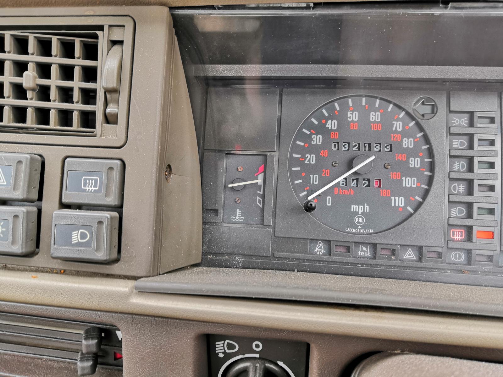

Anyway, the other news is that I was finally brave enough to let it get hot enough for the fan to kick in. Infra red thermometer was reading 96 degrees at the bottom of the rad, but the fan kicked in just before I lost my nerve. Reassuring.
The fan is very quiet, so could well have been working before and I just hadn't noticed.

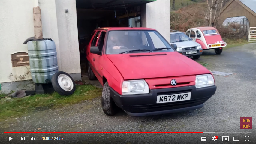

Video now I'm on an actual laptop.
White-tinged spark plugs and general lack of oomph do make me think that fuel filter needs tackling. Why did they put it in such a STUPID place?!

Yeah, I need to work on better angles. As ever, I was rushing a bit, as I was also washing/reproofing the 2CV's hood at the same time and all while trying to record a video and on Christmas Eve...

https://www.youtube.com/watch?v=DthR4OfpBNc

Hi Ian, just watched your servicing video. I see you put 10/40 semi synthetic in. The correct oil should be 15/40 very much unsynthetic. Probably won't make much difference but might make the tappets one or two db quieter.
I also very much like your fancy laser guided temperature gun thing. I bought a new thermostat for mine as I suspected the old one was stuck open.
The new one has the gauge sitting here.
And the heater is now much improved so I think your gauge is probably about right, maybe very slightly higher than this. I'm guessing anywhere in the solid white area is ok.

Video now available on all good browsers.
To be honest, not much happens.
Now I have watched the video I can see I  got it horribly wrong. :-(
