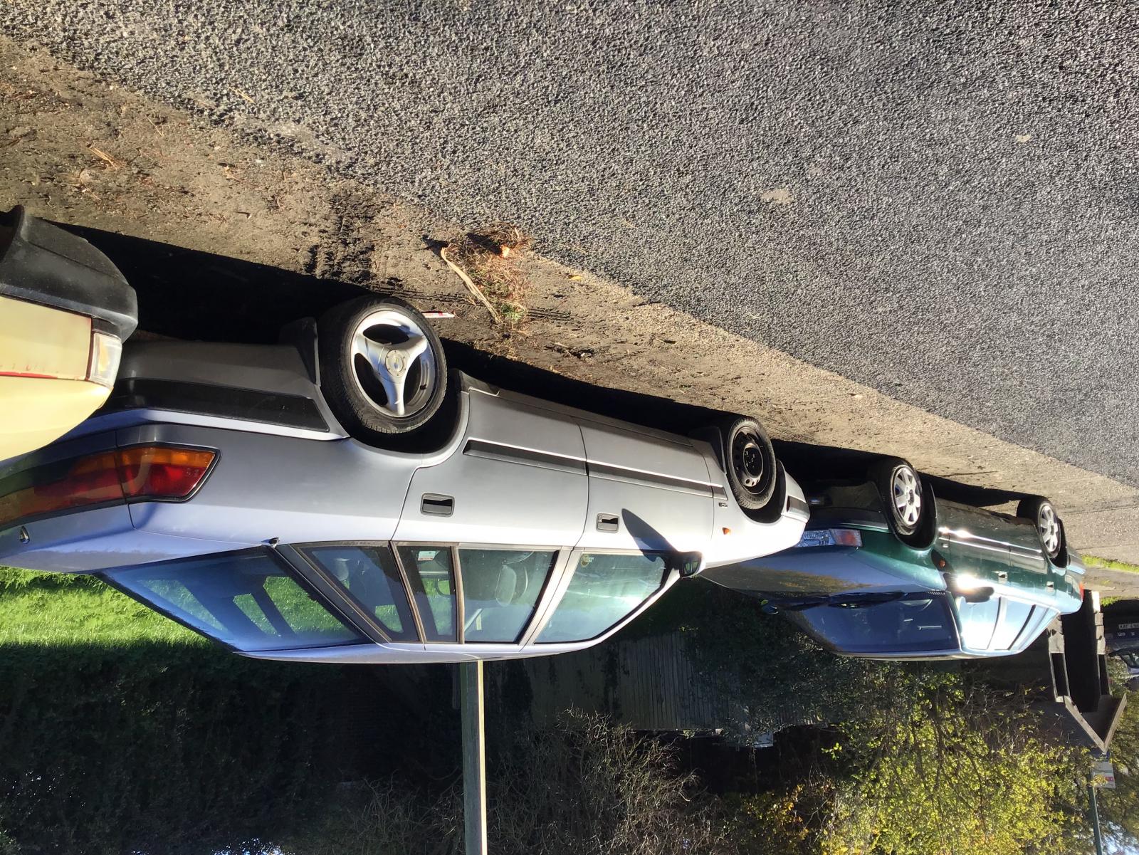

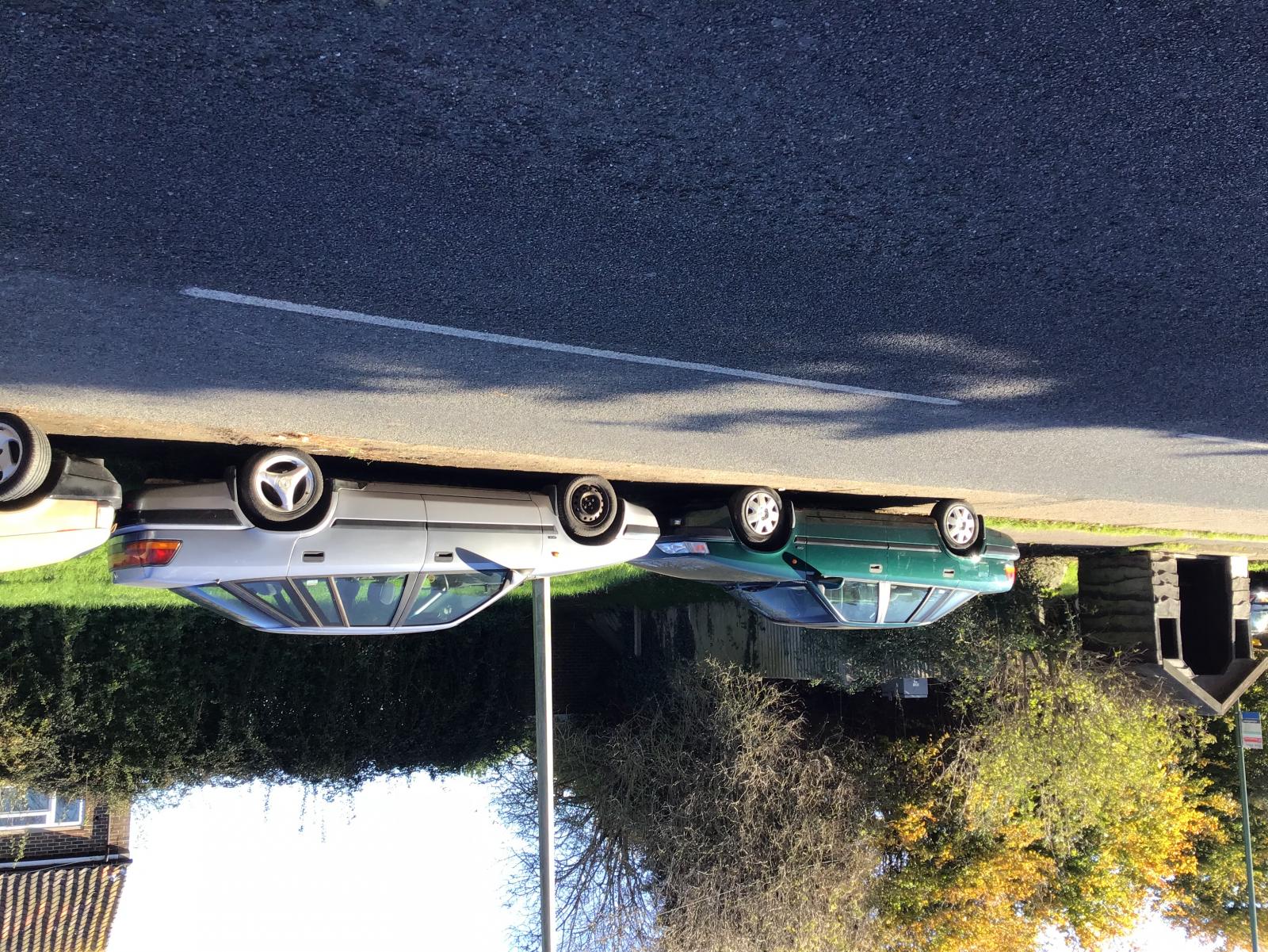

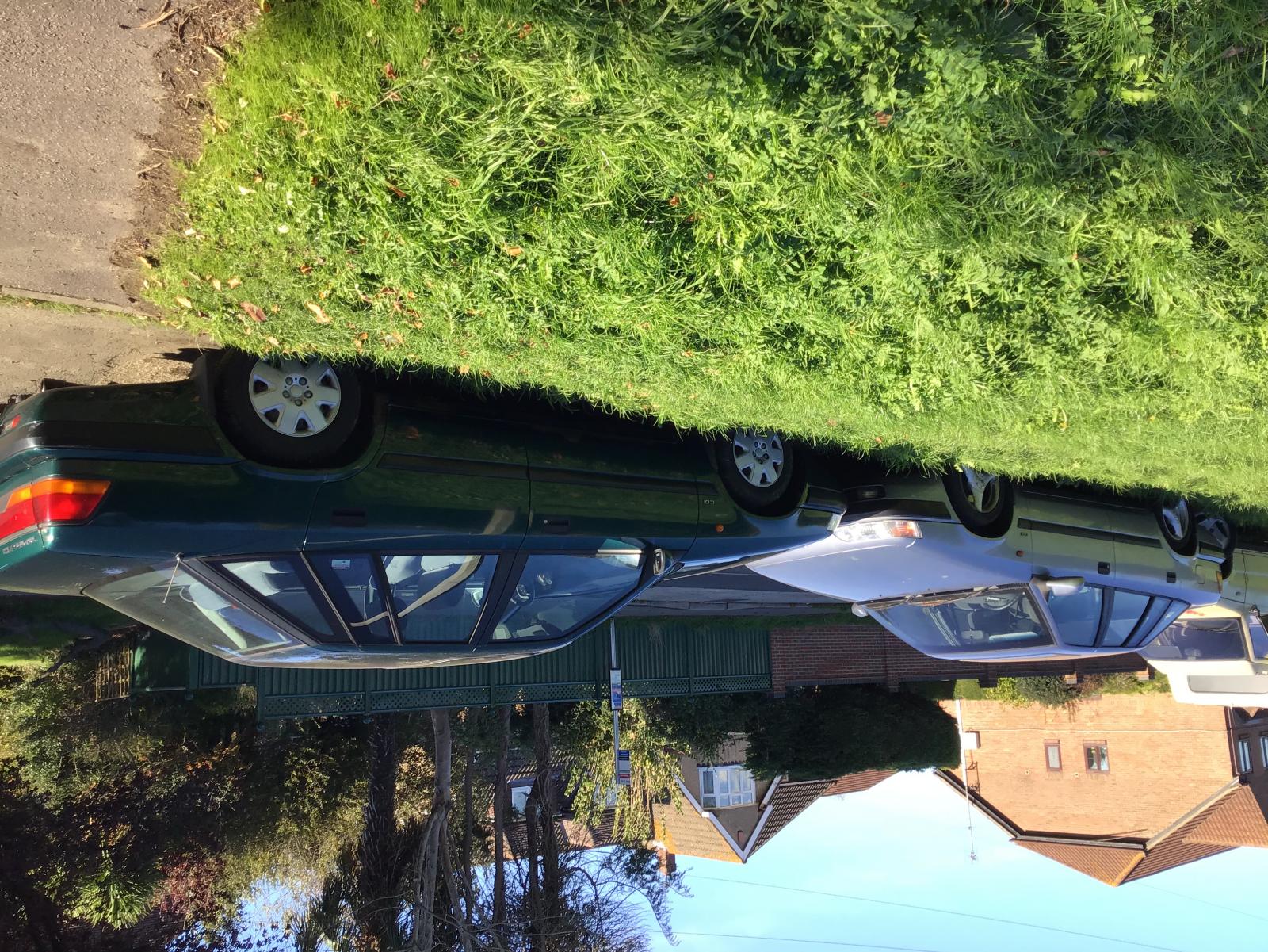

So here’s a couple of pics of the new, green auto, (resplendent post Mot/ wash) & the low mileage manual...
And if I find another, i’ll Let you know. 6 Daewoos is more than enough!
And a little something to put a smile on your faces....
They do look sleek, even with those sticky tyres
