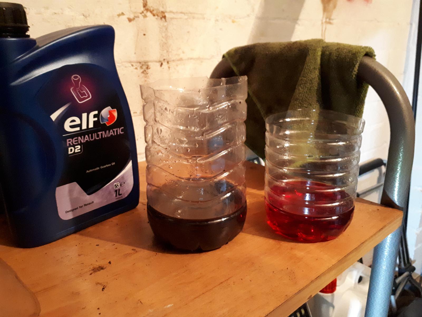

Today I changed the automatic 'box fluid.
The old stuff looked like a full bodied Côtes du Rhône, with the new resembling Benelyn.  Total capacity is 4.5 litres but only 2 comes out when doing a change, so I'll do another one in January when I get some more Renaultmatic.  I'll also replace the sump washers next time as one of the plugs has a slight leak now.
There's a noticeable improvement when engaging R and D (previously there was some slight shunt), and first to second is a lot smoother too.  Shifting to top is still a tad jerky, but TADTS apparently.

If I'd had the Pela-type pump, I might have discovered the burnt fluid sooner. Instead I got weird readings on the dipstick.
