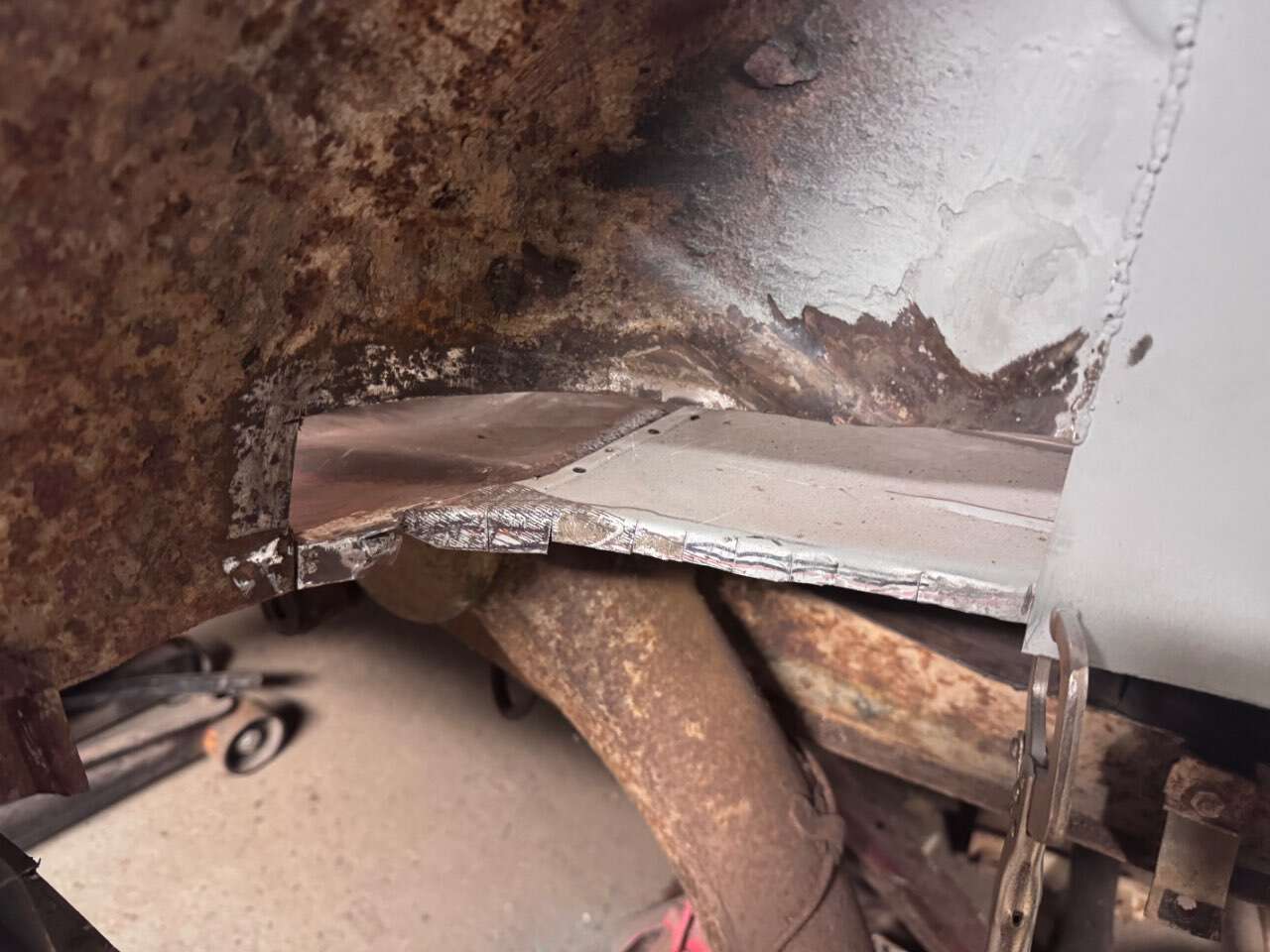

I managed to secure a couple of hours today to work on my Ami. I’ve been trying to fix this area
but having made what feels like 15 panels each of which didn’t fit
I decided to increase motivation by doing something a bit easier.
This bit is at the front of the garage so at least when I walk past it I’ll not just see rusty metal.

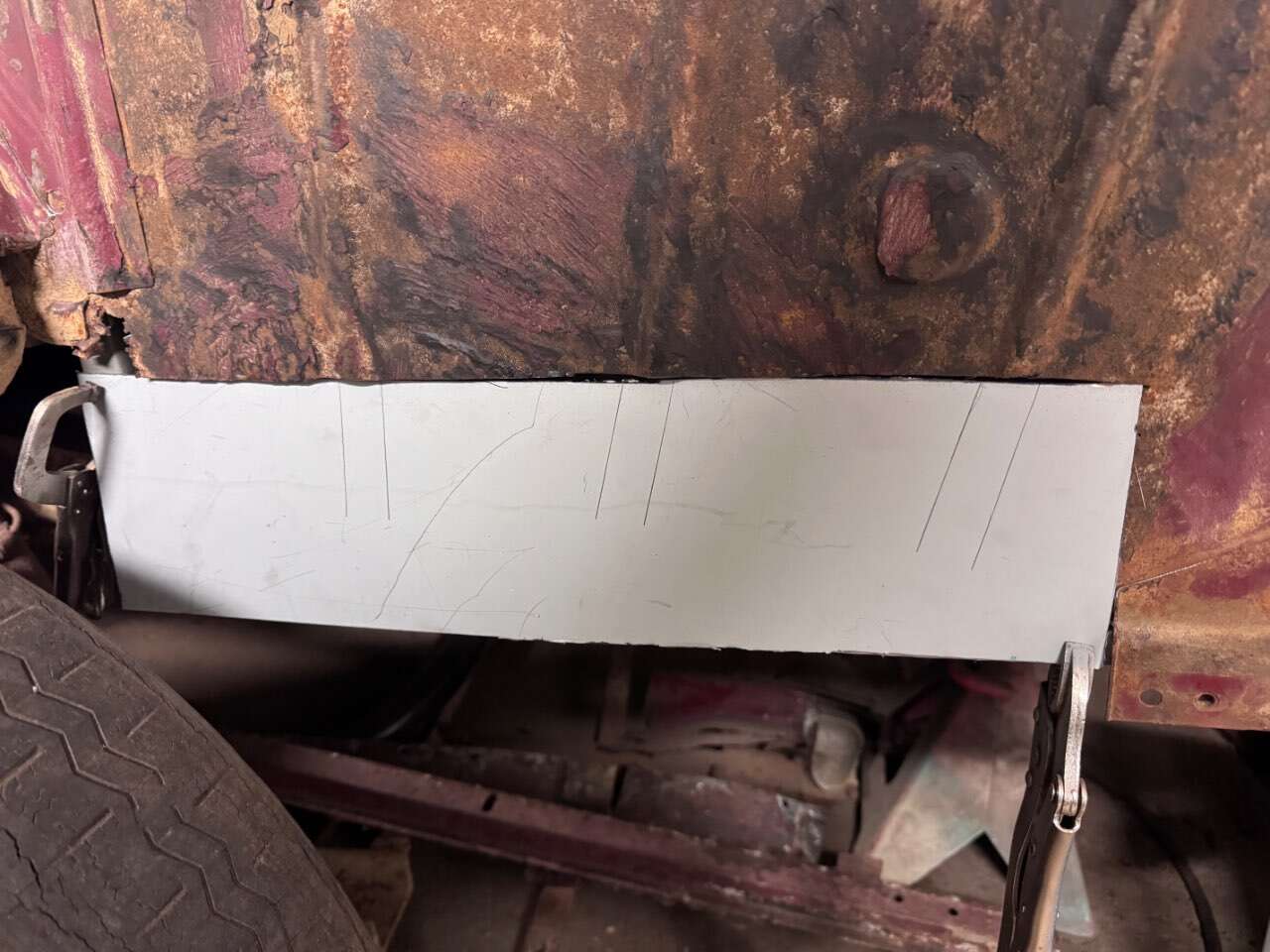

chop chop
then make up a panel
roll some beads and do some welding
happy with that, the beads don’t *quite* line up, but given I’m not on commission for pebble beach I reckon it’ll do.

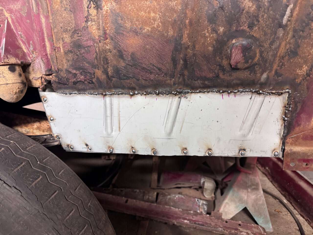

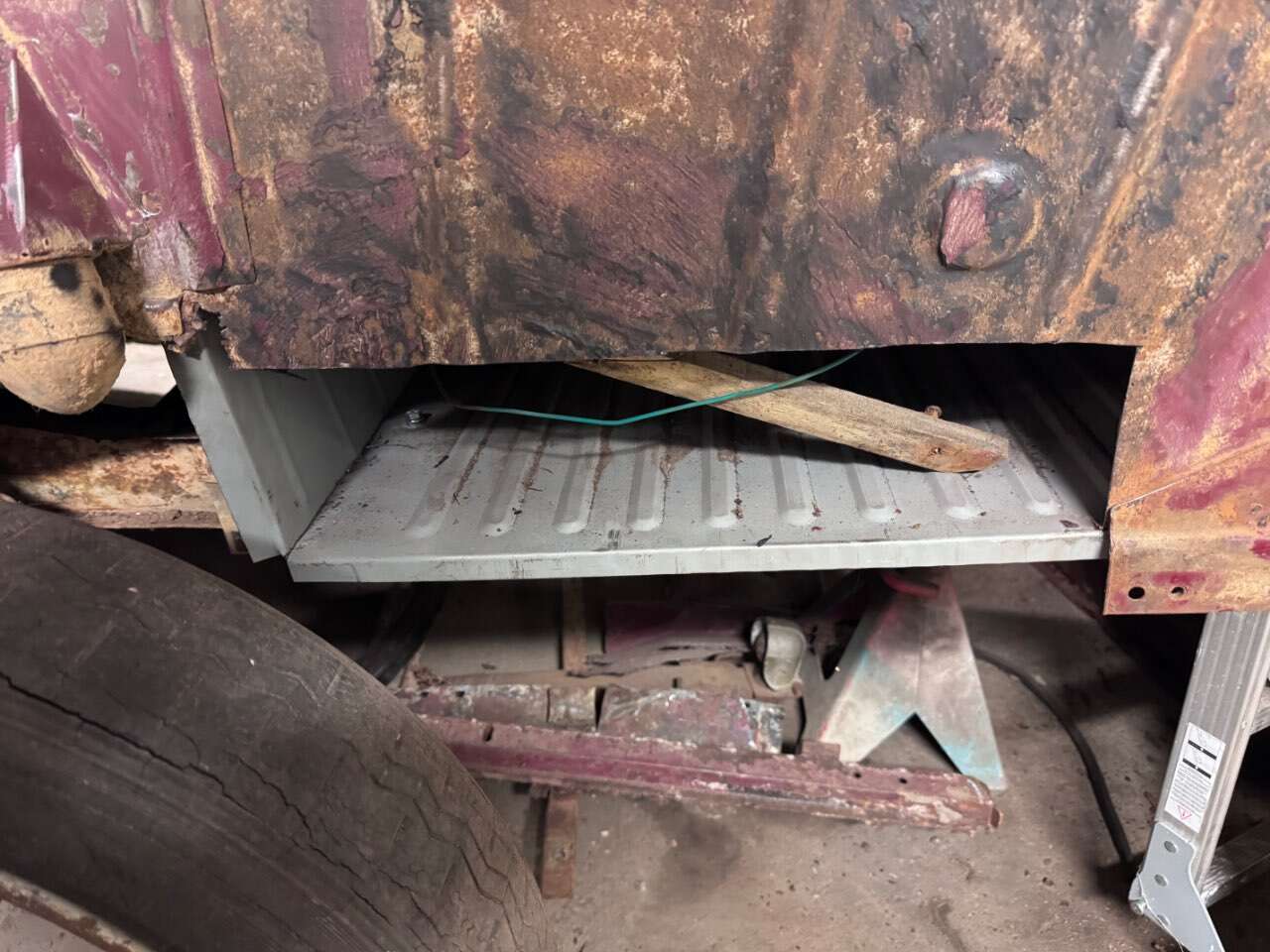

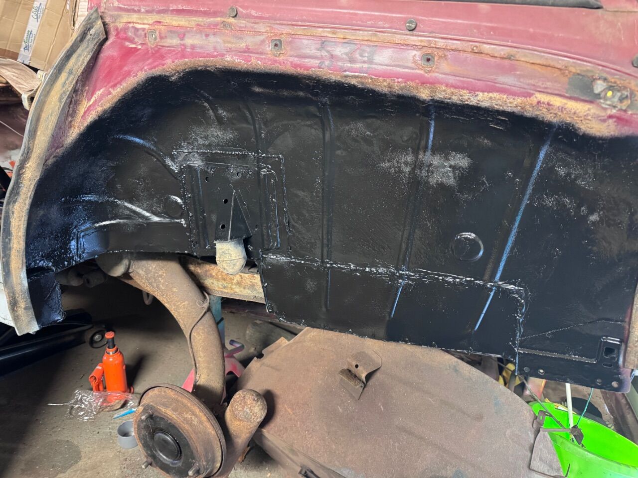

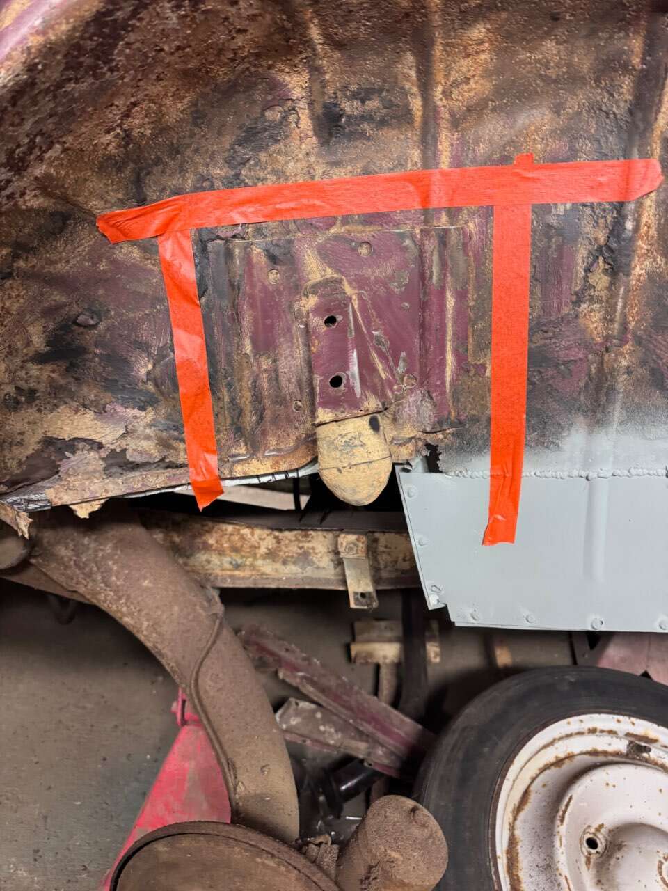

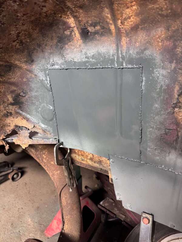

Grabbed an hour or so away from daily duties today to prep for the next bit of welding.
the area for work

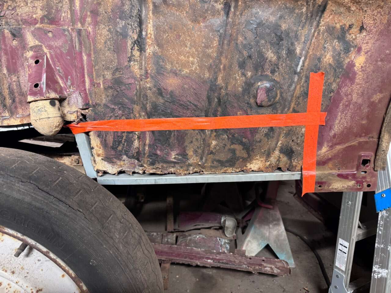

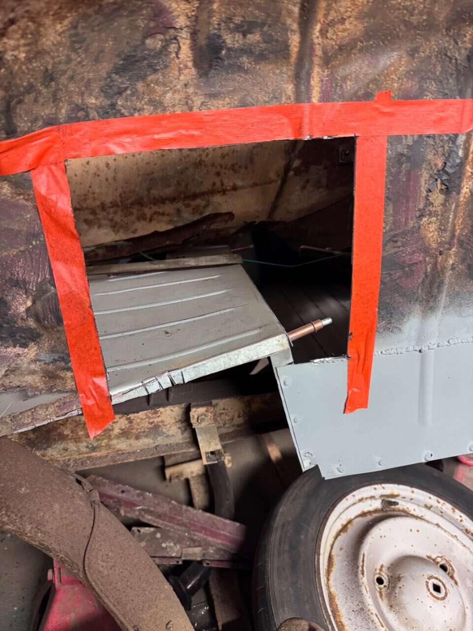

angle grinder makes short work of that. I need to remember to weld that lip that the cleco is holding before I put in the repair panel. I made a panel, rolled the bead and voila:
luckily the bump stop panel is reusable on this side - I had to remake it from scratch on the other side
might have some time to weld this in towards the end of this weekend, but more likely it’ll be a few weeks before I can get the time. Edging ever closer to finishing… but there’s still a few complex sections to finish off first.

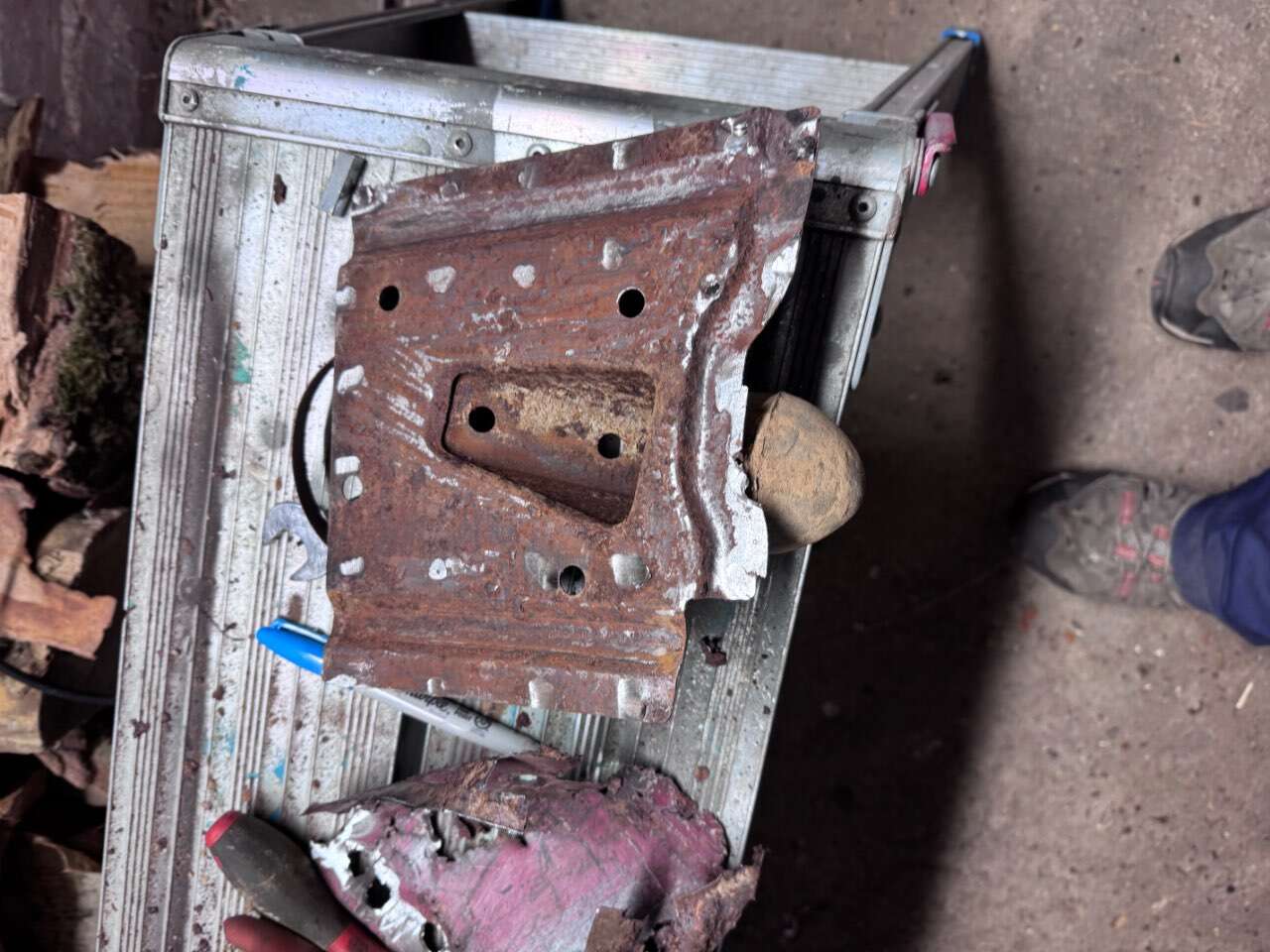

Grabbed a couple of hours this morning - bit more chopping out
then cut a simple patch (I decided to put my joddler to work and put a lip to make the welding slightly easier).  Buzzed it in, and finished the puddle welds to the upper boot floorIMG_7185.thumb.jpeg.d58155aff03f7739cd7336e087ceb760.jpeg
this finishes the boot floor area

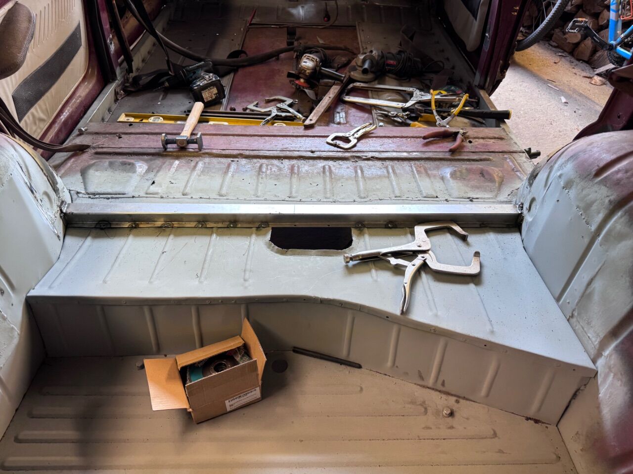

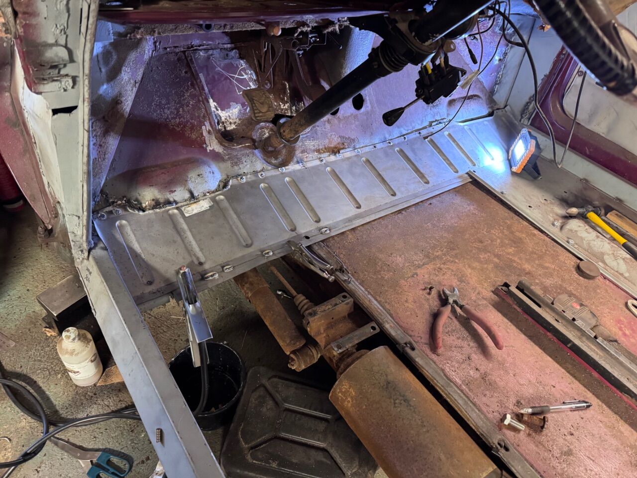

next off I thought I’d fit the inner toeboard- which seem to slide in easily. Can only do the drivers side welding at the mo:
I then fitted the floor on the near side to bring the inside nearly to completion
I had also, earlier in the week, repaired rhe rear corner, which will need more care with the grinder and perhaps a skim of filler before I pronounce it done.

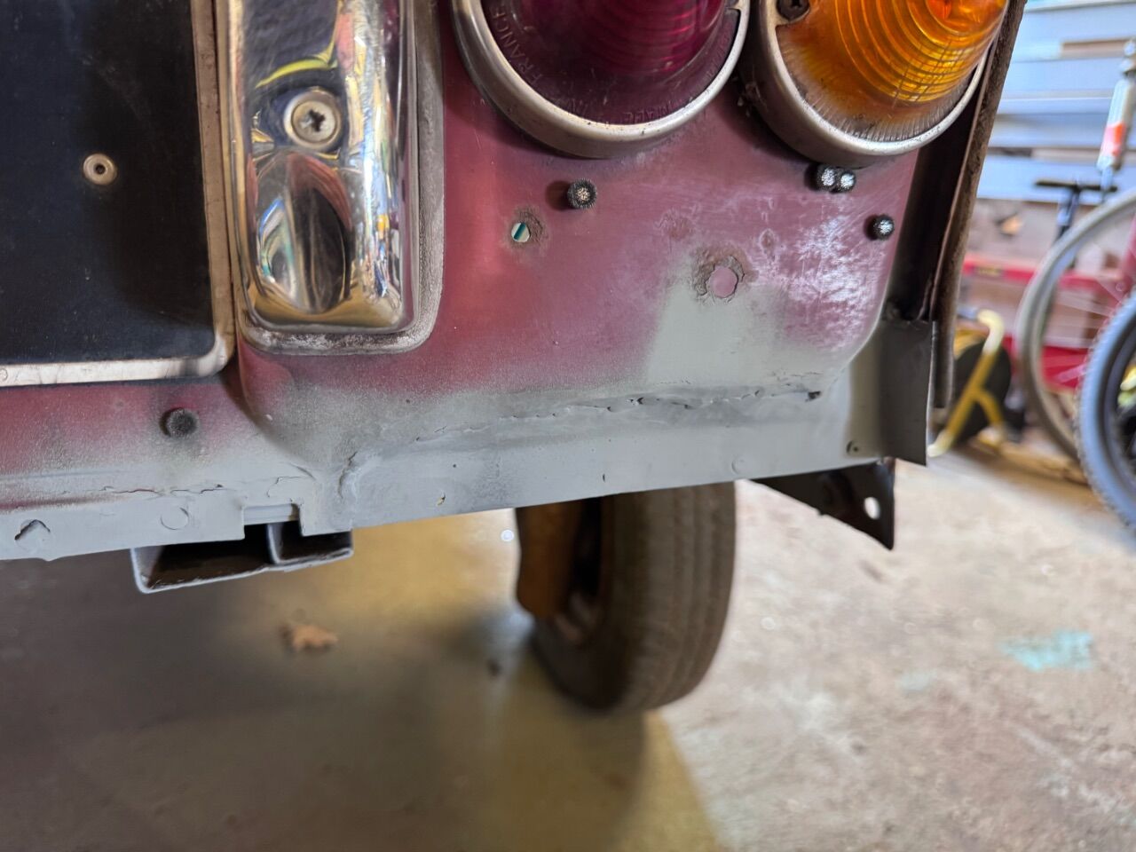

managed to find a couple of hours last night after discussing with some very knowledgeable chaps during the day.
This was bothering me, should I just spot in the holes or do it properly?
I was persuaded that I should do it properly, so out came the grinder
yeah, that’s a lot of branflakes, and I suspect* that the tail lights won’t work anymore
chop and bend
and a bit of welding leaves me needing a skim of filler
getting closer now (that’s what I’m telling myself at least).

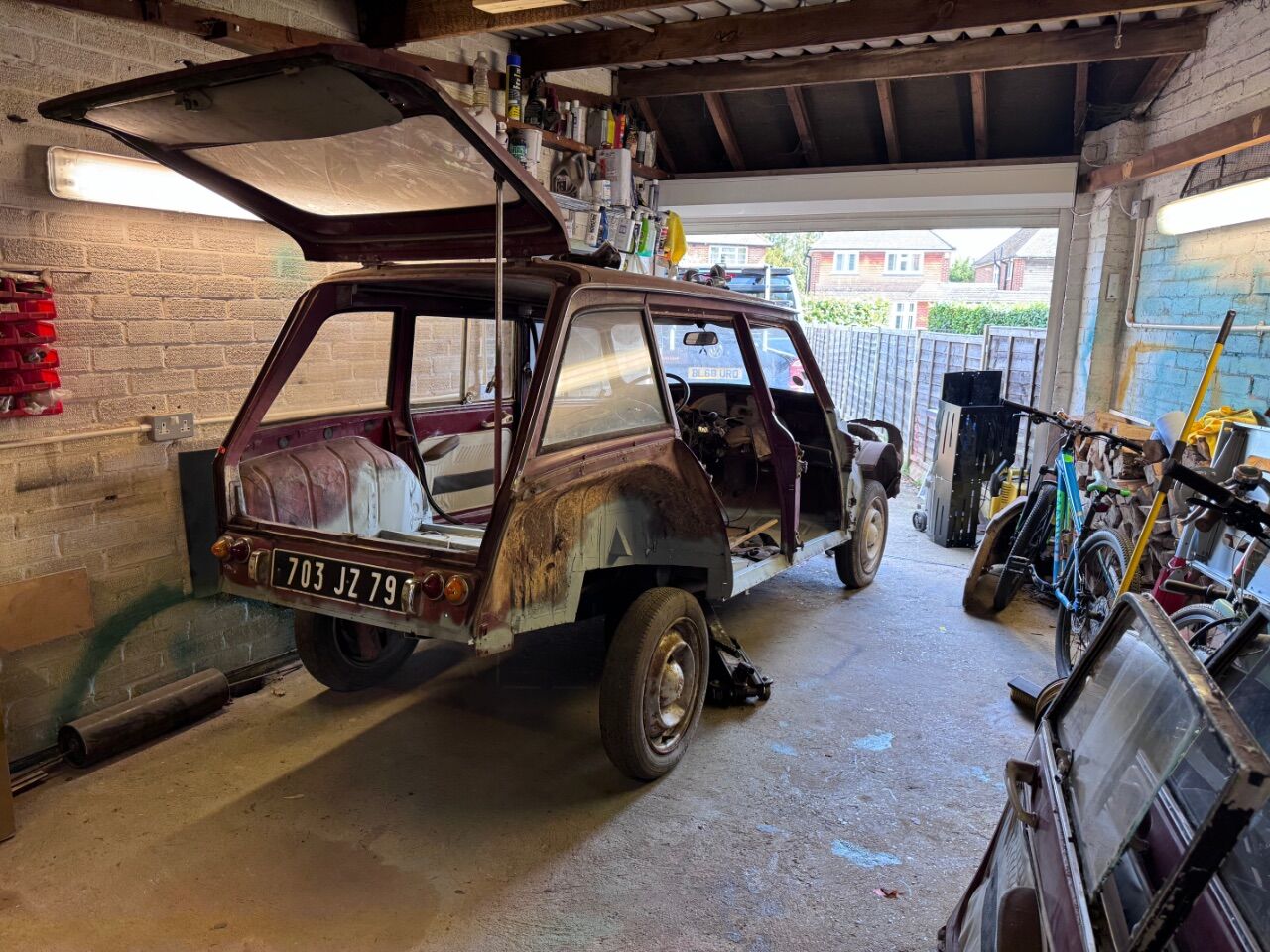

turned my ami around today so I can begin the last bits of welding (famous last words)
Looking more like a car now!

With the Audi moved onto pastures new, and a back that was pummelled into submission by an osteopath, it was back to upsetting the perfectionists.
welded the support bar into the rear seat box and finalised the rear end
this left me here
welding done*.

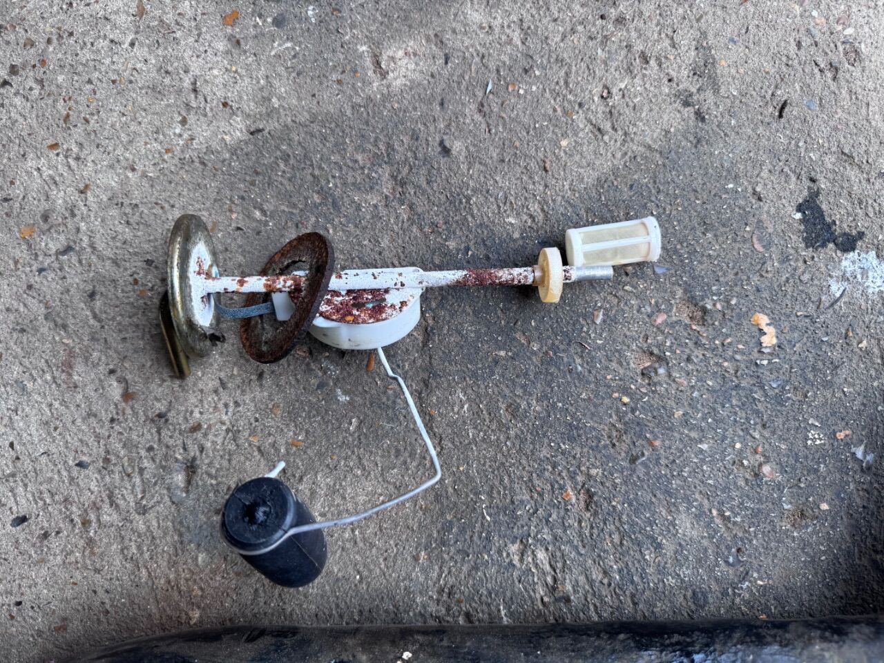

I then decided that I should prepare the fuel tank - usually the sender will be broken or the pick up clagged.
Didn’t look too bad, if you ignore the filter that has become detached. I’ve got a new one ready I be fitted once I’ve used some sealer on the tank (metal tank on this one).

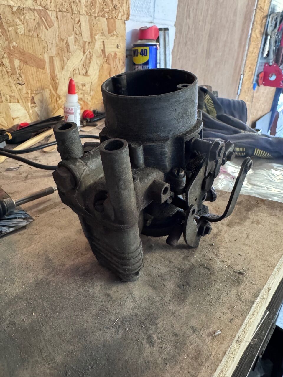

Whilst the lamb was roasting I whipped the carb off (gasket set is in the post hopefully)
the accelerator pump is missing the four screws that hold it in. Not sure where I’ll get those at the moment, but fingers crossed someone has some. In any case, off to the cleaner IMG_7675.jpeg.dd58523f1c2fae49ae903b4bd28650ad.jpeg
and couple of hours later it’s drying waiting for the gasket set to arrive.

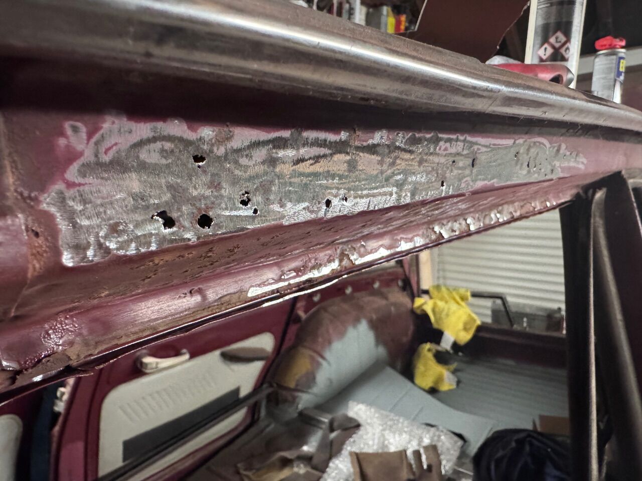

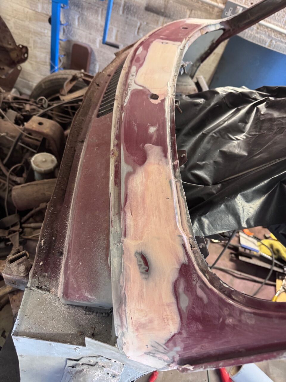

The windscreen surround wasn’t great, having looked up from underneath
so I sought reassurance from the greater knowledge of @Skizzer @RobT @Kiltoxand of course @320touring. A new windscreen rubber ordered from Germany on Monday, arrived Wednesday evening. So Stanley blade was deployed and the screen removed.
IMG_7840.jpeg.59cdf31452341c5afb6c0d200354f9ed.jpegIMG_7838.jpeg.6eee4e3f56b259d0706fb132c1ebf3ca.jpeg
not too bad, hopefully some fabrication can be performed to remedy.

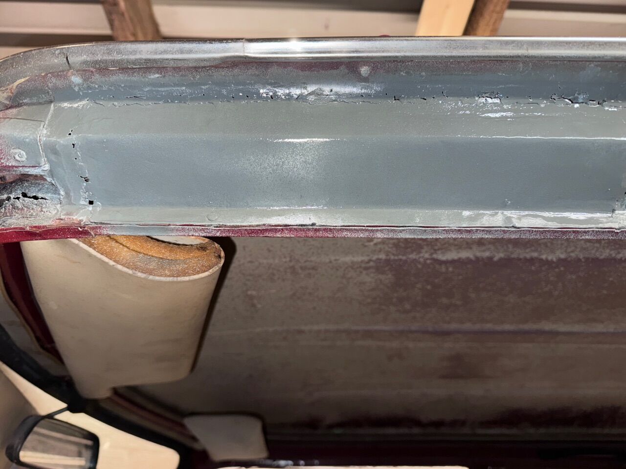

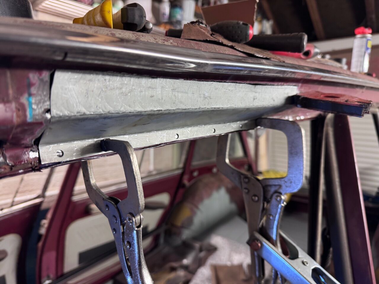

Windscreen was taken out and new metal let in to fix up the holes.
it’s not all filler, there’s definitely metal under there. Bit of spraying
happy with that. It’s semi gloss paint to try and blend in with the old paint.
windscreen refitted with new rubbers. Need a little bit of sealant around the edges, but it’s progress.
