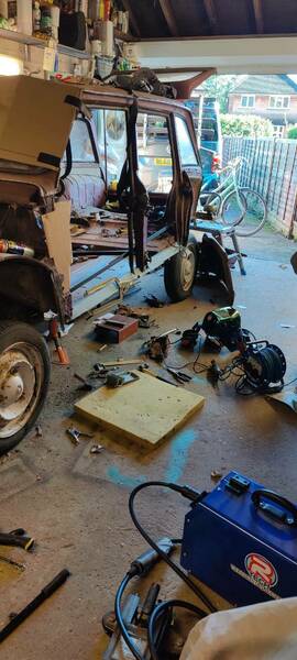

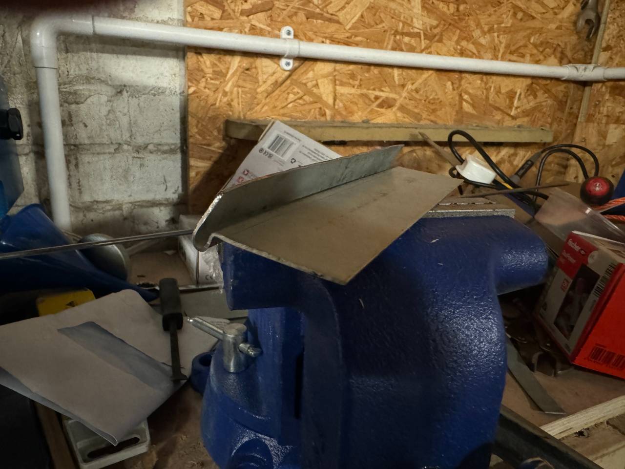

meshking Posted June 11, 2023 Author Posted June 11, 2023 Managed to grab a couple of hours on the car today. Unfortunately it's about 40 degrees in the garage as it has a metal roof. Should get round to some insulation some day. Anyway - what did I get up to? @Skizzerput me onto, beside his own awesome YouTube channel, "make it kustom" created by a Canadian who shows how to fix and make panels without a complete workshop of tools. Much more up my alley. So, inspired to bash some metal, I worked out that I should be fixing this section first: Bit of cad Bit of reuse of offcuts from the steels used in my house extension Leaves us here Happy with that for a first attempt. Might try and put a bead in the middle for a bit of strength. Skizzer, Stinkwheel, 500tops and 10 others 13

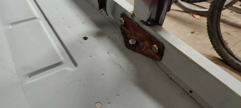

meshking Posted July 20, 2023 Author Posted July 20, 2023 Had a few moments to spend on this today - the difficult bit is making sure the seatbelt aligns, and then drilling/reinforcing/welding captive nuts inside the sill before the floor closes off the sill. All needs to align as : Marked and drilled 12mm holes Bolt up the vertical plane then refit the floor WIN! Now to weld it in... 320touring, chaseracer, grizgut and 9 others 12

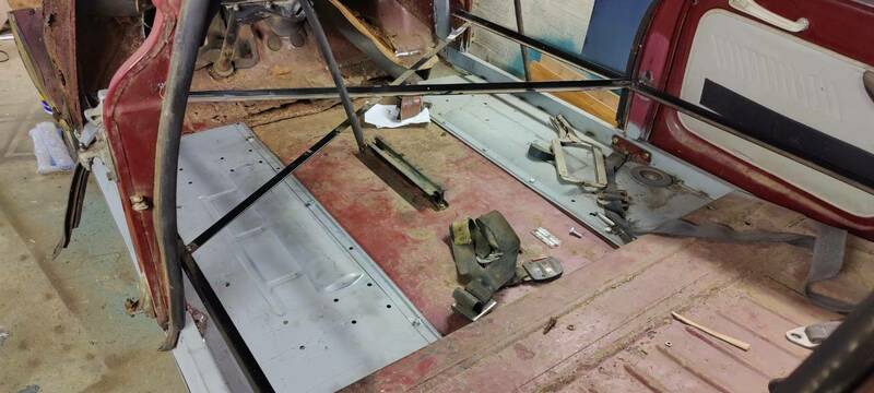

meshking Posted October 23, 2023 Author Posted October 23, 2023 You got me wondering earlier today. This is, I think, my eighth Citroen a series. But I've never been mad enough to own more than two at once. Progress has been slow on this - it was never going to be speedy, but it ground to a halt as my work life took a step up. In any case, both sills are now replaced, with the floor fitted but not welded in on the nearside now. With that done, I wondered what to do with the toeboard and what was actually supporting the front of the car. I chopped out the rust and lined up the repair panel I was quite amazed that it all lined up. The floor aligned on both sides but there's a jacking panel that needs to be fitted to the end of the outer panel seen here. That's a panel that isn't available, but an ami8 was available. So ordered up the four jacking points (which will never be used!) and set about trying to fit something that shouldn't fit. This is old Vs new: I was rather amazed to discover that it fitted! Last check to ensure the rear jacking point fits . I'm calling that a win. Skizzer, Scruffy Bodger, drewd and 15 others 18

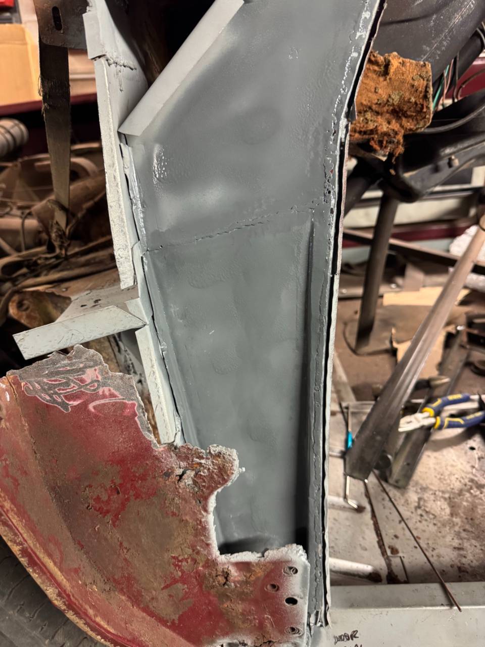

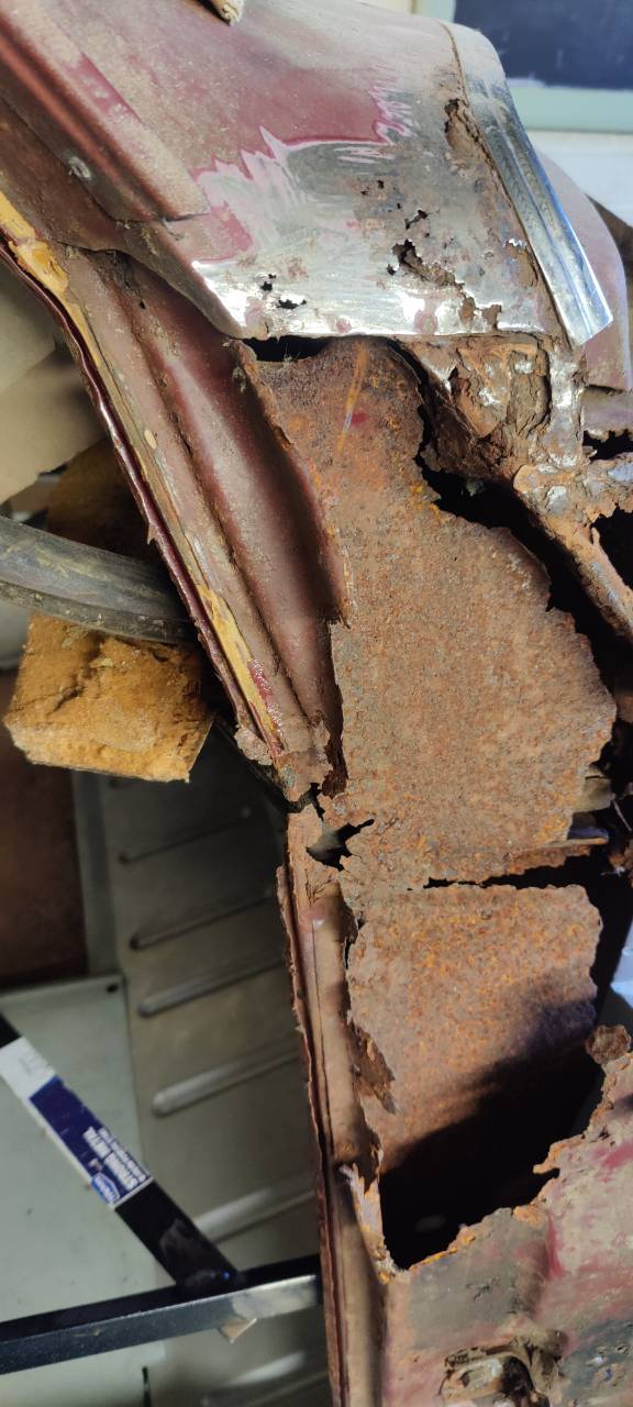

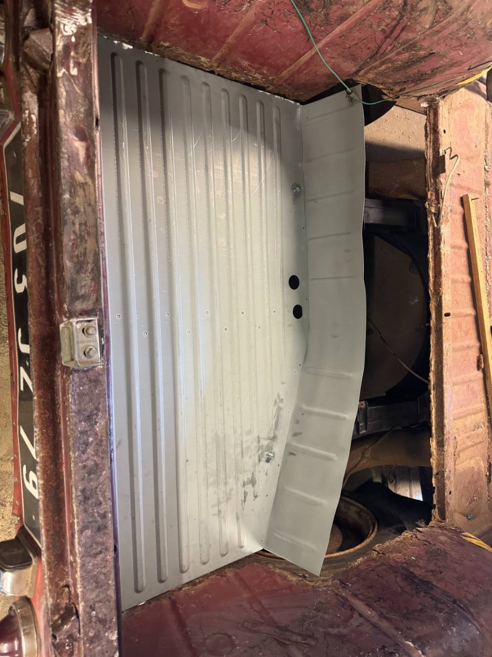

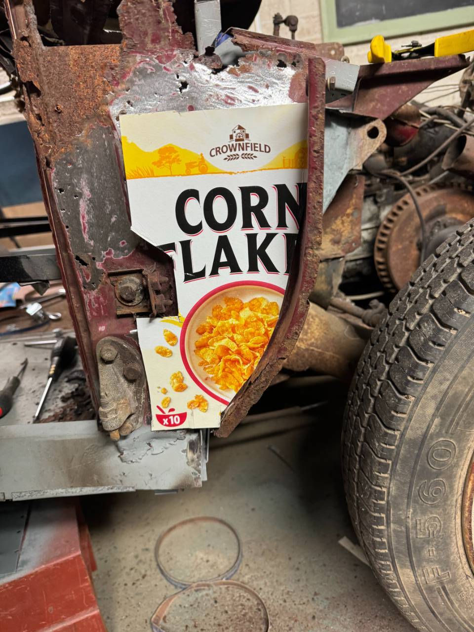

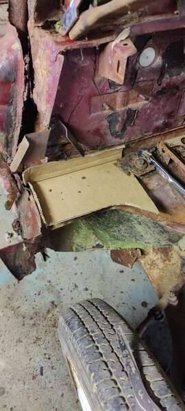

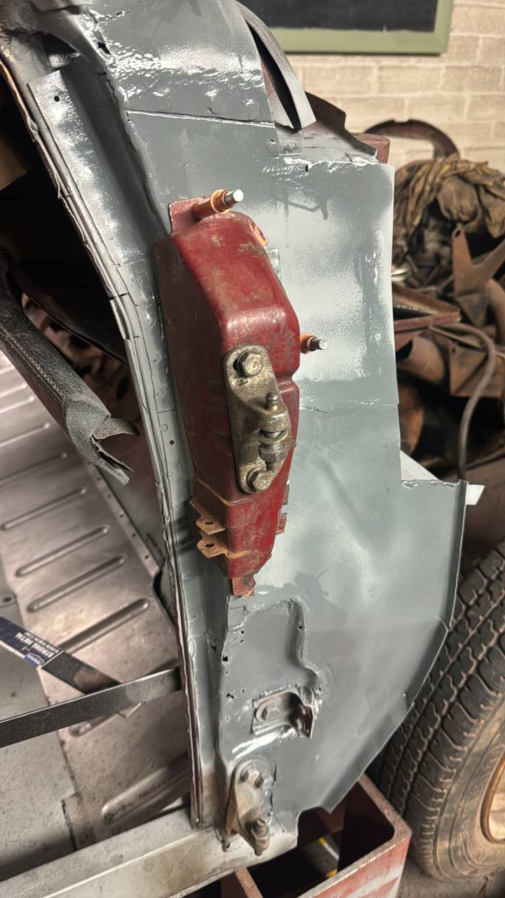

meshking Posted October 19, 2024 Author Posted October 19, 2024 Time for an annual update! Few things have changed - health took a nosedive in Jan this year, but a change of job and a few weeks R&R between jobs improved things massively. Welded in the outer toeboard (don't look too closely at the welding quality pls) and turned my attention to the a pillar... or what was left of it crunchy. And of course, there wasn't much left around this - so had to fix those areas first. Then onto the inner panel and shelf that was awol I used some filler rods to keep the channel in roughly the correct profile - but if course had to fix that too. Fabrication Now some CAD Resulted in: Have of course since filled the holes. Now attention moved to the back of the car - where the boot floor and rear seat mount was awol Plenty of work here: Luckily the chassis is solid as a solid thing. The boot floor was available but not the other parts that had long departed. Fab'd the rear wall, then the rear seat mount Had to rope in a second pair of hands to put beads in that panel But happy with the outcome. Then noticed the NLA bumpstops weren't there anymore Created some paper ones, then made them in metal: Now attention has just turned to the other a pillar... which was also in a mess: More repairs: more CAD Phew - and we're up to date. What's left? Inner toeboard, need to fabricate the pedal recess, fix up nearside inner rear wing. I definitely didn't realise I was taking on such a project, but I'm kinda glad I did tbh. Thanks for reading this far! Marshall2810, somewhatfoolish, RobT and 25 others 26 2
