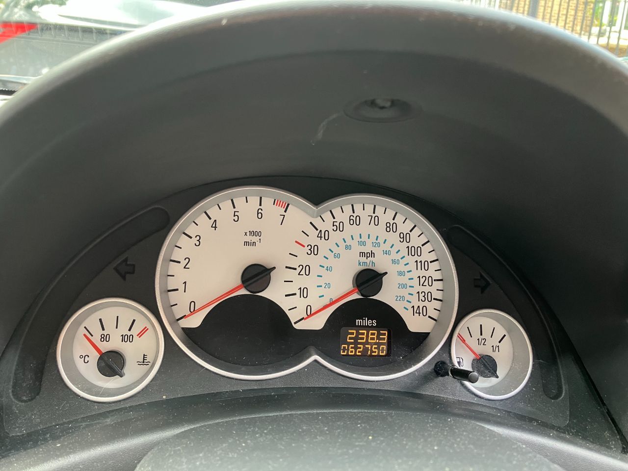

@LightBulbFun : Has the car got a rev counter?  It would make it easier to spot whether changing the oil, filters and plugs has fractionally reduced idling revs. If no rev counter is fitted, try very gradually increasing throttle to see if the oil light goes off at just a very slightly increased engine speed.  If it's in the range of 600-1000rpm when warm, then just adjust the throttle stop slightly to hold idle speed slightly higher than it now is.  If the light fails to go out until the revs are higher than an acceptable sounding idle, check that the oil pressure sensor which operates the light has got a good connection and the fitting is not leaking. If none of this rectifies the problem, begin head scratching then rechecking everything.  Could the oil suction pump used to drain the oil have shoved sludge towards the oil pump inlet?
yeah there is a rev gauge, but we did not record what the idle revs where before and after the service sadly

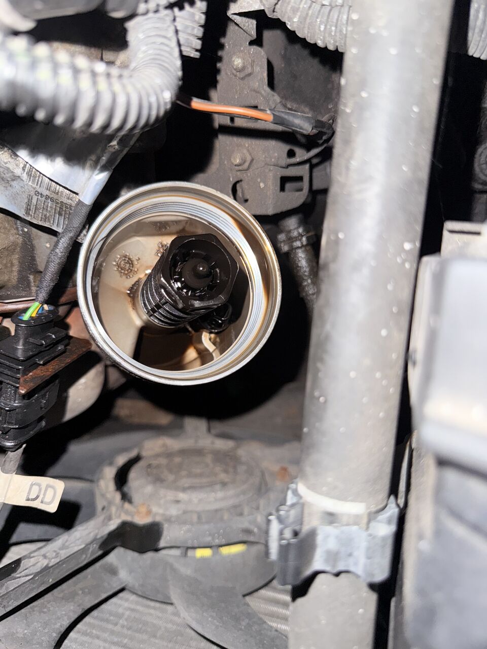

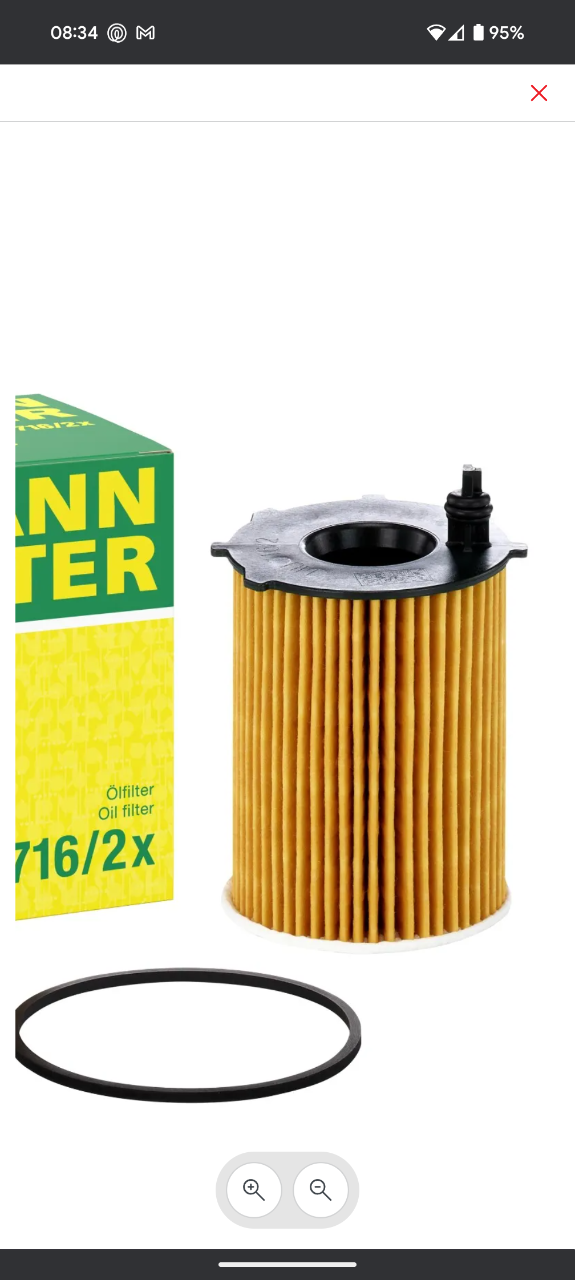

Re oil pressure. You need to check the 'nipple' on the end of the oil filter hasn't snapped off and blocked the hole in the base of the filter housing it sits in. If you attached the filter to the cap and then spun it in place rather than seating it in the housing and screwing the cap on it may have been damaged.
interesting! I admit I am not sure what the nipple is exactly that you refer to? but heres the filter as just fitted the other day

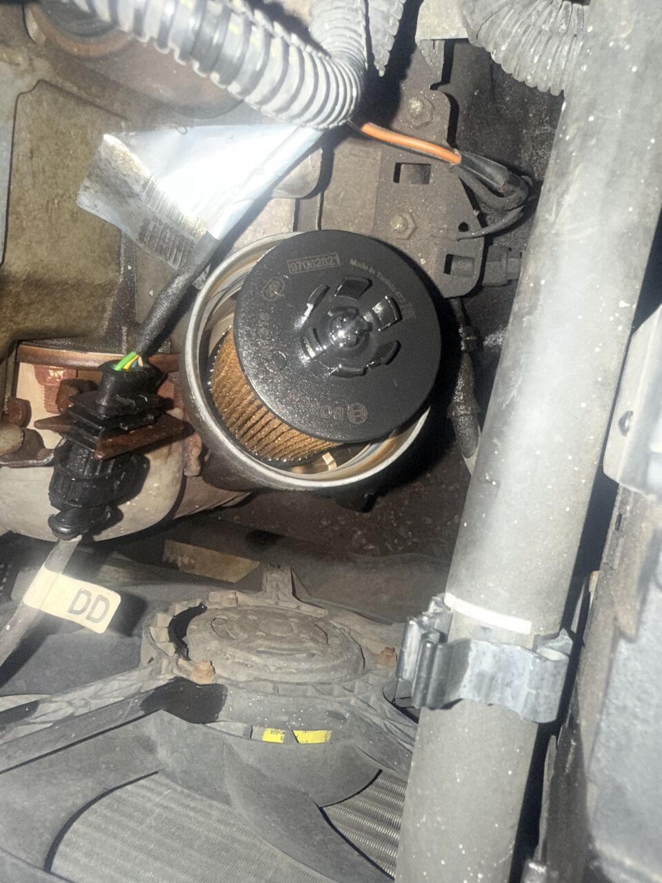

as installed 5 minutes ago
77413695392__CF1186E1-B36B-4451-925D-3337585919A9.jpeg.00780af401160e7c5e885cf5debd22b1.jpeg
here is the oil filter housing with filter removed
and here is looking down the oil filter's inner hole for lack of a better term
my brother came back to it just now after an hour to see if it dripped any oil, which it did not, I got him to remove the oil filter and run the engine without it installed just incase somehow the oil filter had become clogged/defective?
and in light of your comment have a rummage around to see if there was any loose plastic bits or anything that looked snapped off etc, but there was not anything he could find (other then a spring loaded thing to the right of the main "shaft" which I am going to assume is a pressure release/bypass valve?)
but the oil pressure light *did* go out at idle with the filter removed, so I then had him re-install the oil filter, aaand it still stayed out?! sooo its fixed? but still quite mysterious
its obviously had an hour or so to cool down between the first incident and now, so I got him to leave it running for about 10 minutes, to see if letting it warm up would cause it to come back on, but it stayed off still
I suppose the next plan of action is take it for another drive and see if it really stays off or not! but that probably wont be for a few days because his schedule is busy etc

Touch wood and subject to further test runs the problem has now gone away.  I would not worry about it too much unless the light stays on.  Older, high mileage engines can carry on for years with a light which comes on at idle or flickers.  My daughter's 2004 Focus 1.4 petrol burns a fair bit of oil.  It's done 230K miles but still runs fine. She only puts oil in when the light starts coming on when going round corners!  Oil and filters are changed annually as a pre-MOT service.  My Reliant has an oil gauge and a light.  The gauge is probably an aftermarket addition by the previous owner back in the 1980s.  It reads around 20psi when idling,  engine warm, around 30-40psi when driving.  The Stellar that I had a few years ago had a standard dashboard oil pressure gauge which was simply labelled Low to High. At warm idle it barely registered in the Low region which was a concern at first.  50K miles later it was still running absolutely fine.  In general, low stressed engines will tolerate low oil pressure for years without ill effect, 'Low' being in the 10-20psi range.  I see no need for major expense and/or disassembly if the thing is running ok.  You are doing the right thing to investigate a step change after a service but if the  symptoms have now gone away don't lose any sleep over it.  Much more care is required with many modern engines which are capable of wrecking themselves very rapidly if servicing or symptoms are ignored, particularly if some genius has stuffed a 'rubber' cambelt drive into the oily bits.
Was the old oil pretty "sludgy" when you sucked it out? I wonder if the fresh oil, being clean and of the correct viscosity has moved a little of the dirt from the old oil around the engine in someway? Perhaps running some flushing oil through the engine once the old oil had been removed but before the fresh oil was added would gave helped, but, we can all be wise after the event!
It's not being able fully to drain the oil via the sump plug that might have been part of the problem.
My apologies, review of your photos shows this doesn't apply in this application. I was recalling an experience with a DV6 engine which has a locator nipple that if it breaks off during installation, due to filter not being seated properly and turning with filter housing cap, can block things up and cause a low oil pressure warning.
