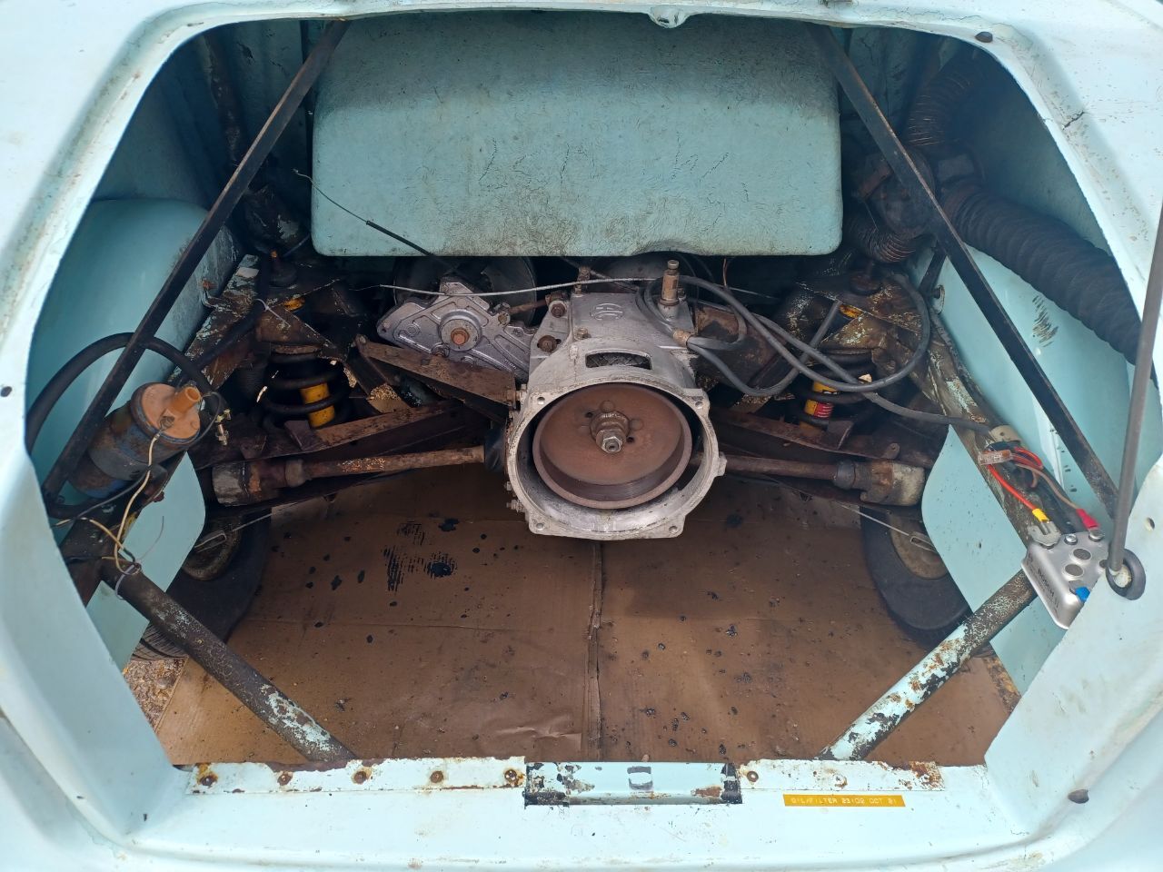

I didn't take any before photo but the gearbox was absolutely covered in shite, the engine bay itself was pretty grubby so let's start with making it a bit nicer to work in. Some engine degreaser,, some tar  Remover and a bit of scrubbing later and we are looking better.

Awesome stuff! as Zel says its strange seeing the gearbox so clean! I can actually see the drive-belt-adjuster mechanism clearly now, when I popped the drive the belt on the M25, and then replaced it and the pulley, I was most thankful I did not have to touch the adjuster in the end, because of how much sludge everything was covered in otherwise LOL

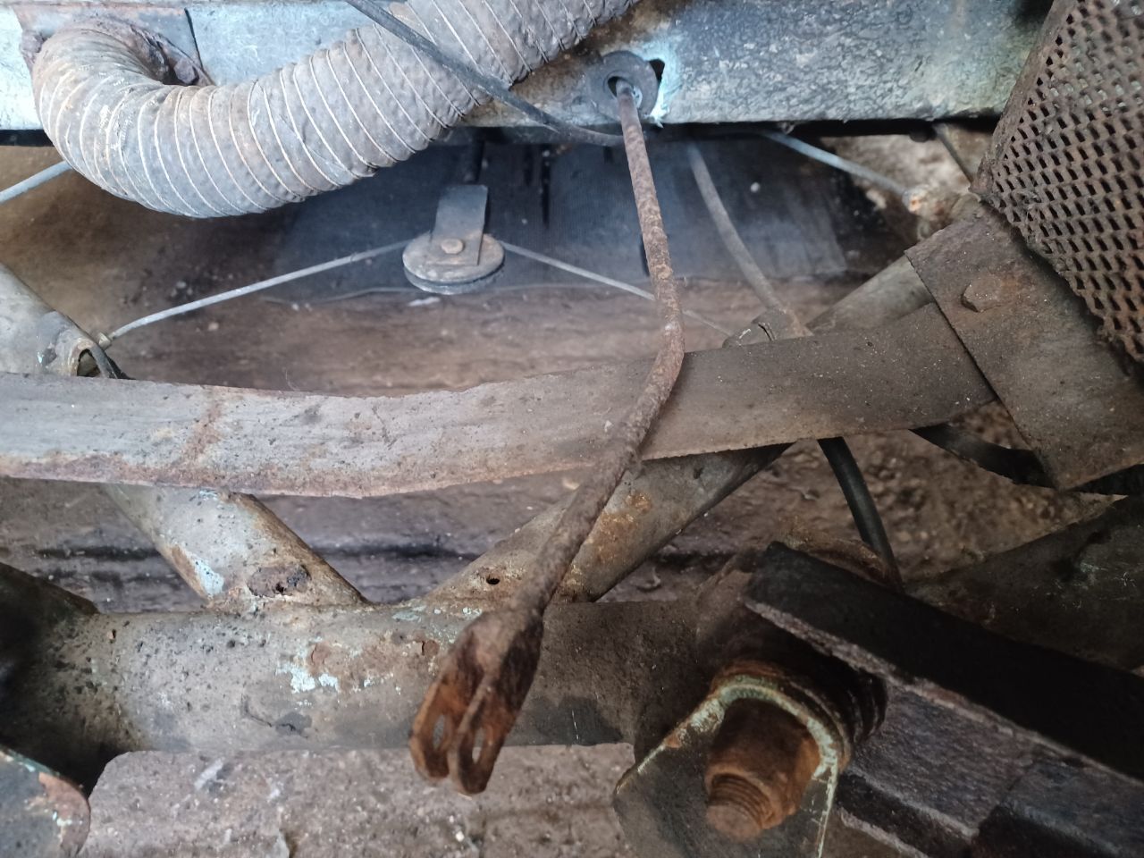

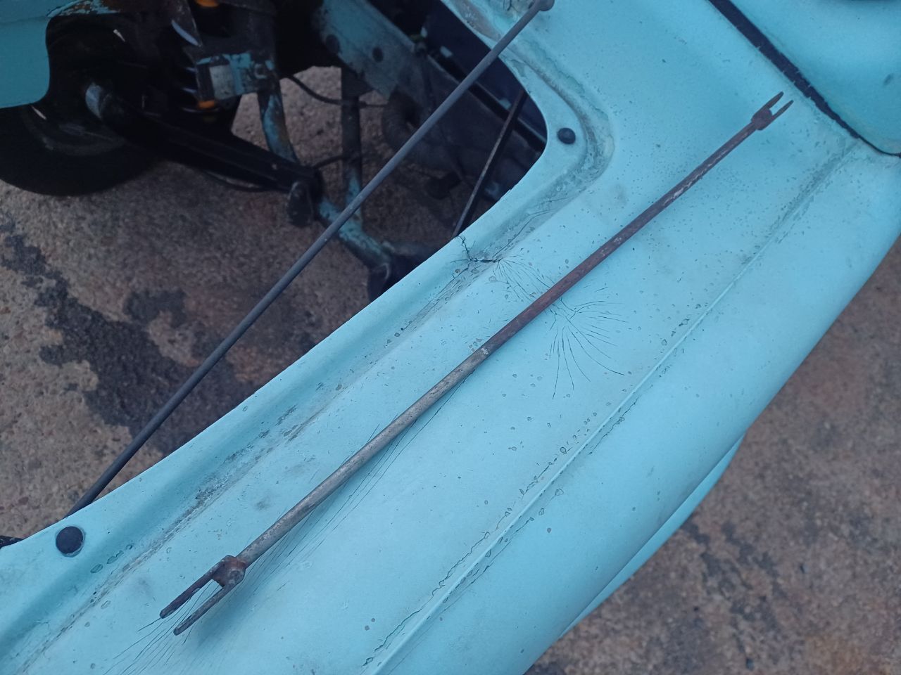

I also wanted to have a nosey regarding straightening the gear selector rod. Both of these jobs would be made easier with the gearbox out the way so I dropped that out. Much heavier than I expected, unwieldy with the driveshafts. @Zelandeth was completely correct about half the drive flange bolts were indeed loose!

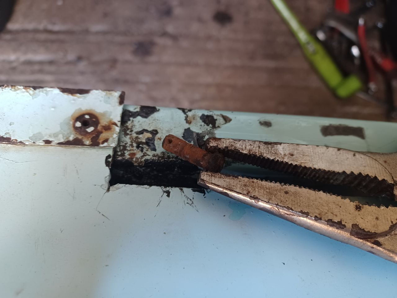

This little shit put up way more fuss than it should. The R clip was rusted solid and broke the the clevis pin was stuck too.
Quite a bend it must be said, appears to have worn a slot into the body were it was pressed into it.

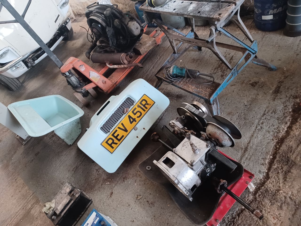

gearbox out, springs and shocks out.
Parts pile

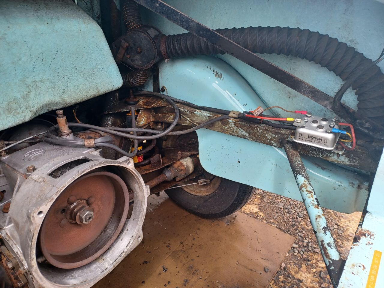

The engine covers hinges have basically ripped through the body, one side has previously had a large penny washer from breaking through.  I Think it's because the engine cover doesnt hinge up as high as you expect so gets lifted too far, I'd guess alot of them are damaged around this area. I have a solution in mind so should be an easy fix.
Eeep! glad thats been caught, makes me wonder about other Model 70's on here, @dollywobbler and @AdgeCutler's etc
Blimey thats a bit more bent then I realised! I am pretty sure thats suppose to be just a straight linkage to the gearbox!

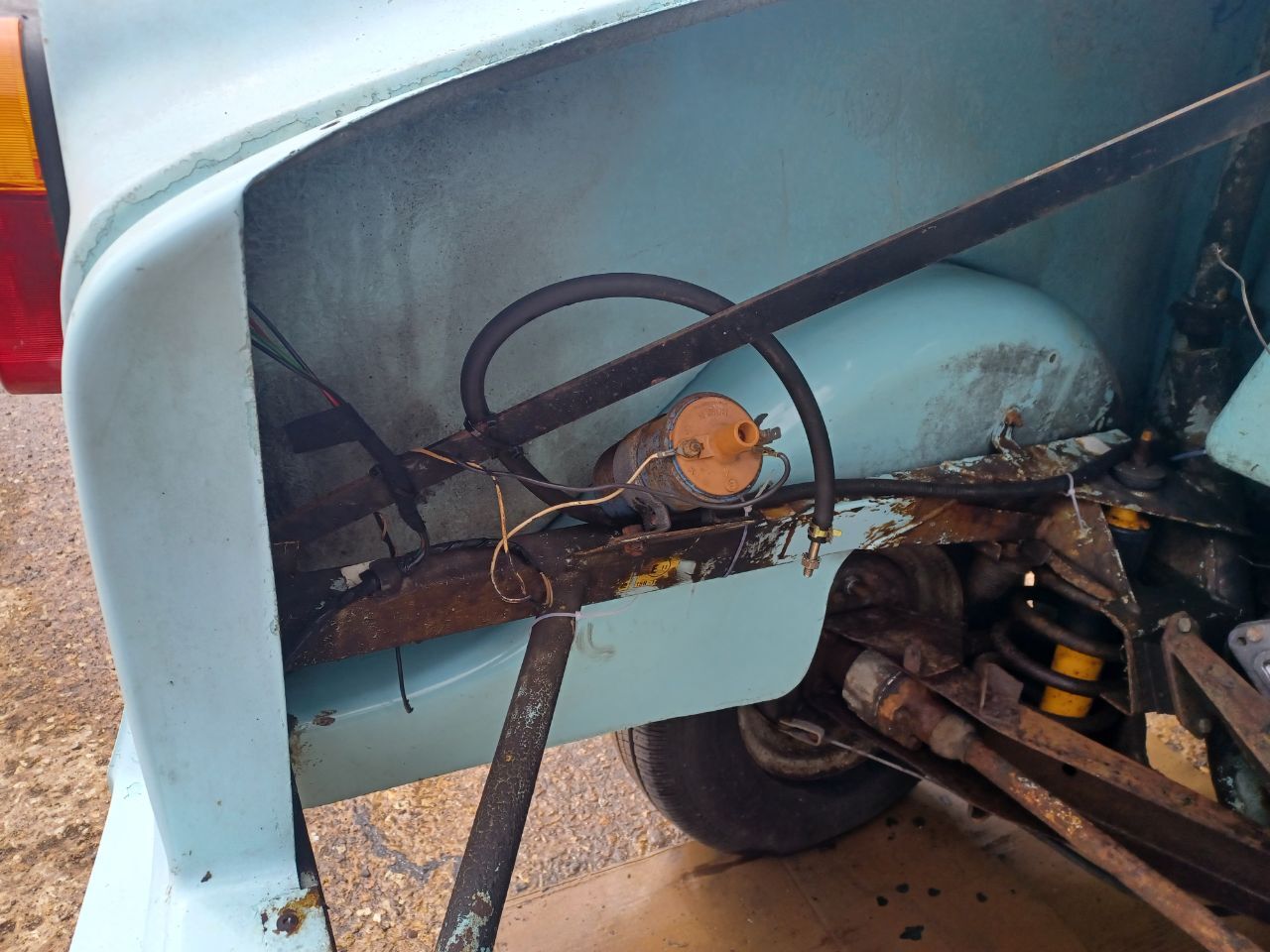

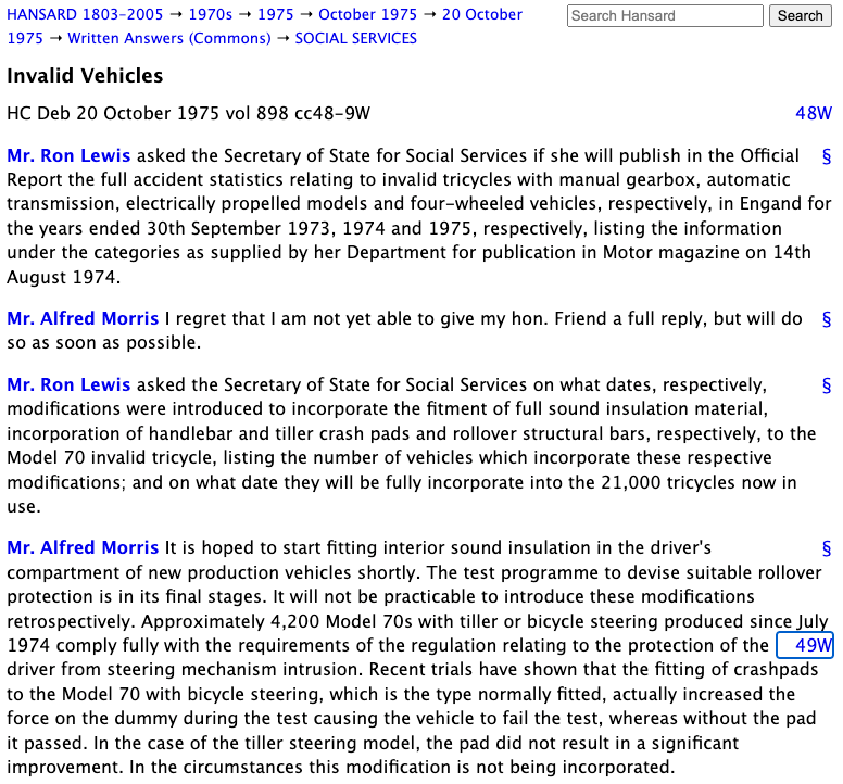

as a general aside, I noticed in one of the pictures some stickers on the chassis below the ignition coil bracket, that I had never otherwise seen before!
and what they are is most interesting from my whole research into the history and development of the Model 70 perspective, they are ECE approval markings for fuel consumption/exhaust emissions (ECE R15) and electromagnetic emissions (ECE R10) I wonder what the "242" and "176.01" numbers mean?
all throughout the Model 70's production life, it was constantly being iterated on and improved, and I had read about the ECE compliance stuff, so its really cool to see actual physical evidence of it,
also for those wondering about the Crash pads, it turned out that those where not really required and actually made things worse when fitted
Absolutely fascinating detail. Not many more - if any cars - got that kind of Parliamentary scrutiny.

Those pins in the gear linkage were an utter menace to get apart on KPL as well - pretty sure there's a bolt and pair of lock nuts in place of one of the pins there.  The gear linkage rod should indeed just be completely straight.

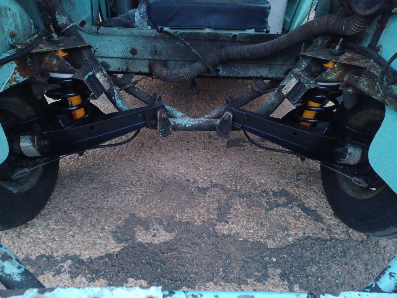

New springs and shocks fitted, way more fiddly than I expected
Gear linkage straightening also happened
Oooh shiny! and is she sitting level now? :) I notice interestingly the 2 silver spacers(?) above the coil springs seem to be different thicknesses?
the presence of such silver thingies, makes me think of this note from the DHSS Parts list, but REV is a pretty late Model 70, so I wonder if the 'distance piece' is something else entirely?
The (now quickly sprayed) silver things are metal spring cups that go over the rubber springs mounts.
Won't find out if it's level until there's an engine back in there.
Without any weight  each time I jacked up one side the other lifted so I will double check everything is sitting correctly when it's a little heavier.
  • Like 6

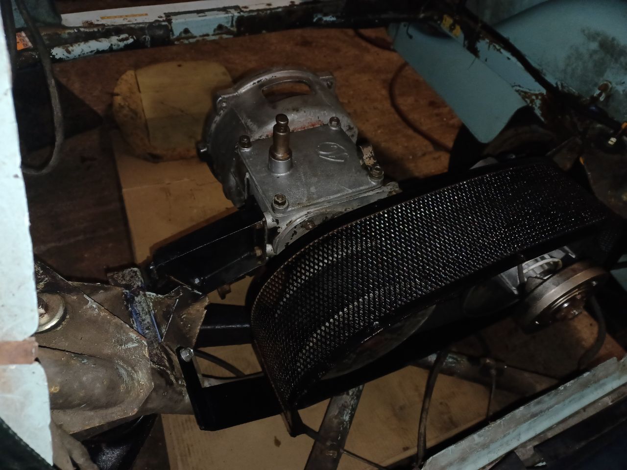

Some surface knocked back and some hydrate 80 splashed on, Gearbox back in,  belt guard and mounting bracket given a very light clean up and spritz of paint. Some bolts are being replaced if they put up a fight /mismatch/rusty mess.
Not aiming for perfection here but if it can be made nicer to Maintain in the future then while I have good access it makes sense to free off that rusty clamp or bolt etc etc.

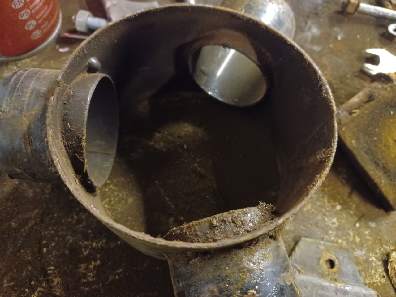

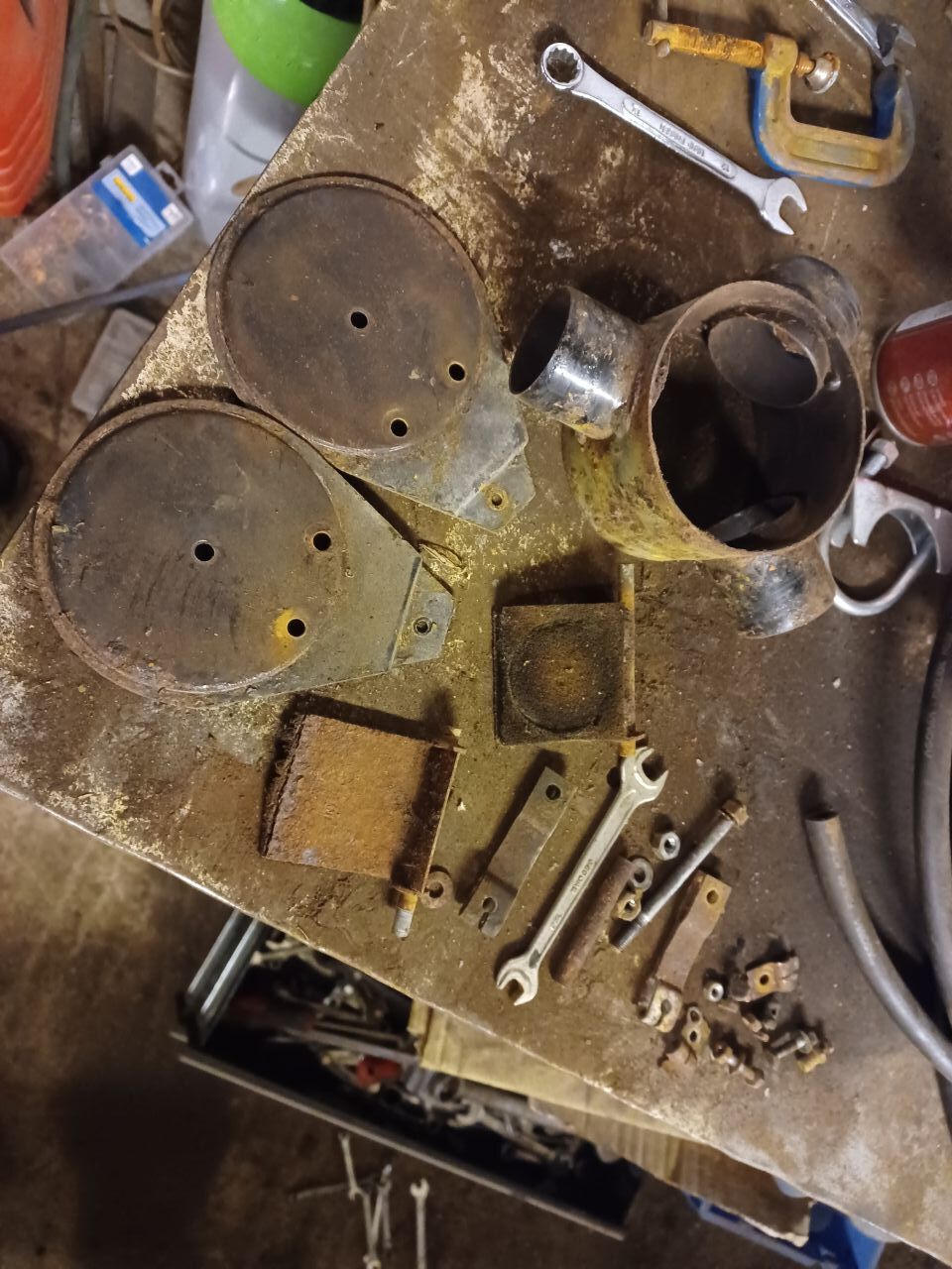

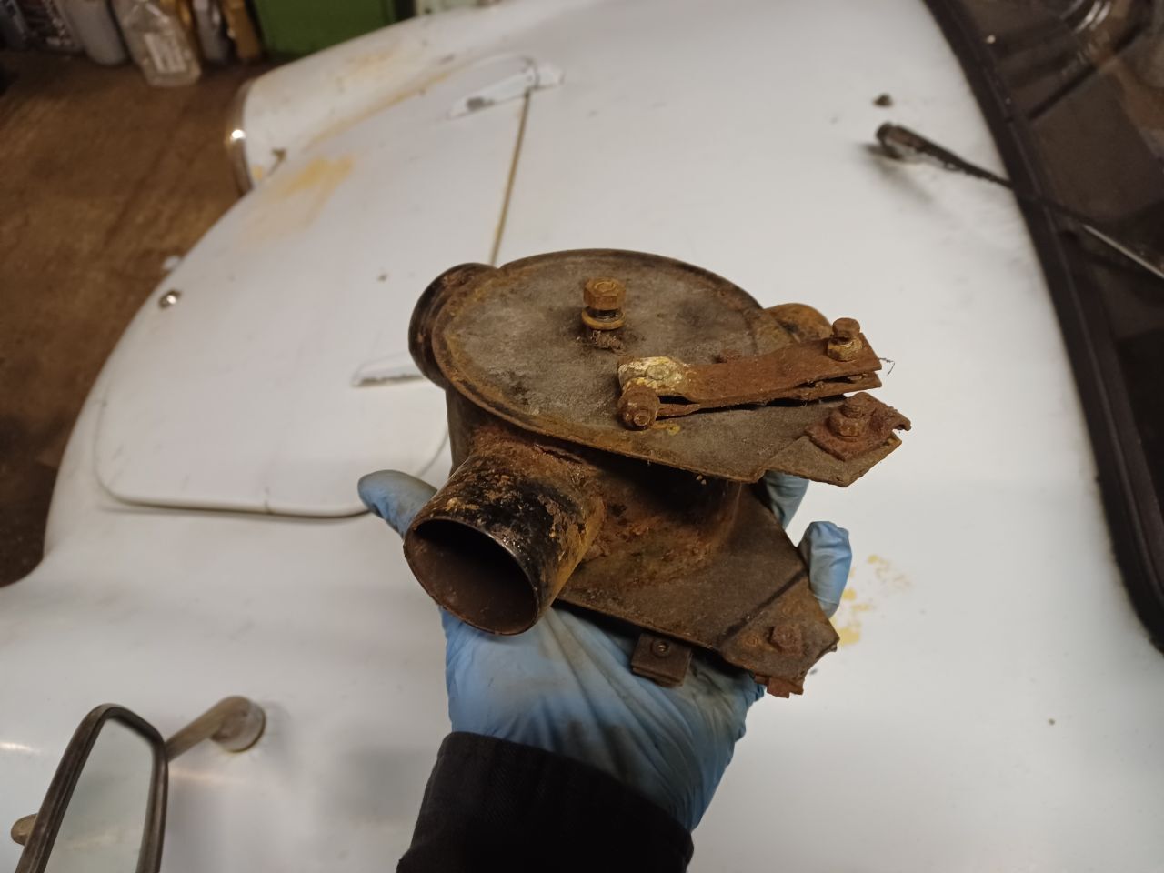

While the gearbox was still out i removed the heater ducting that goes to the floor vent. The ducting is pretty shagged, Internal coiling is rusting away and the fabric degrading. The hose clamps were rusted solid and would have been an absolute bastard to get off with the engine in the way. The P clips holding the hose were also rusted out. I'll make some new ones out of a strip of Ali sheet.

Awesome! I really appreciate all the little touch up jobs you have been doing while your in there :)

which reminds me :) here is the details on the heater ducting, extracted from the depths of @Zelandeth's own thread :)   rather fortuitously it looks like the same eBay listing is still going all these years later! (note on the length drawing however that TPA, Zel's car is a Mark A, REV is a later Mark B so there might be some fine detail differences)
