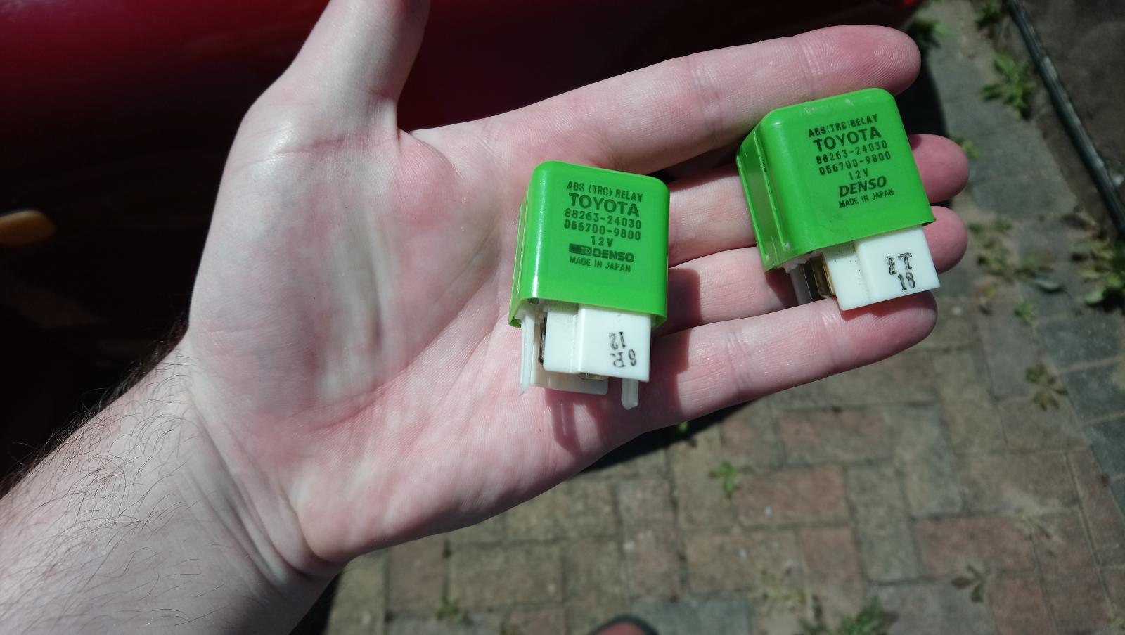

The new (to me) relay arrived yesterday, I didn't have time to do any fixerating last night after work but did have some time today in between mundane weekend errands to do some fixing.
Here is the new (left) next to the old relay, they have the same part number though the new one looks newer to me. i can't work out any date codes so lets just hope for the best shall we?

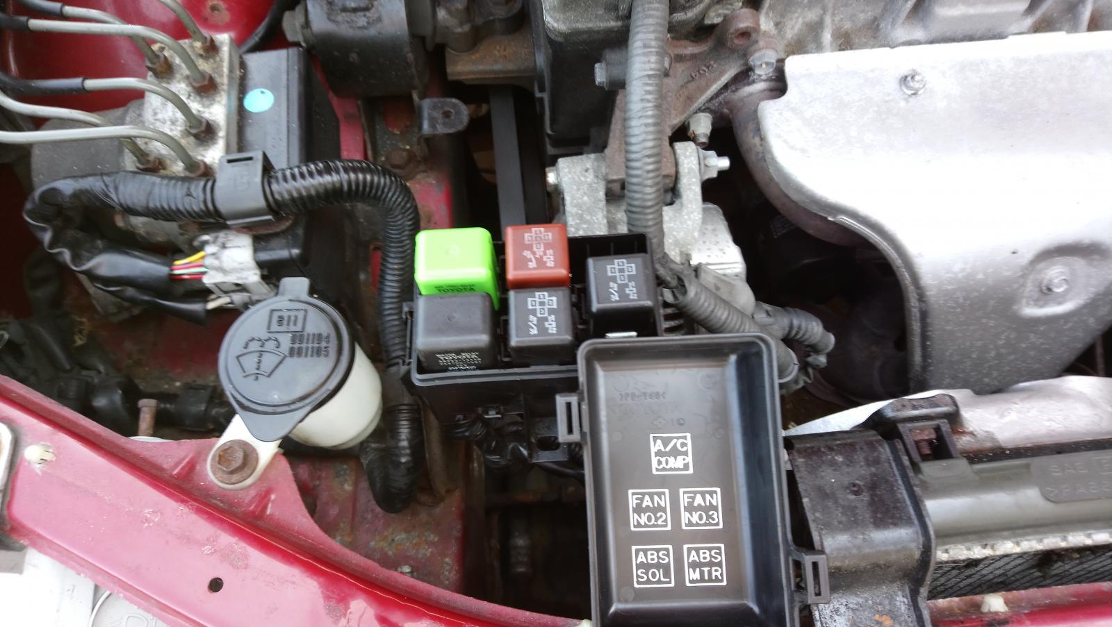

I opened up the little house the relays live in, gave it a squirt of contact cleaner for good measure and pushed the new relay into the socket. I really only wanted to do this once because getting them back out again is a miserable job, filled with broken plastic tangs and frayed nerves. The new one had the tangs still attached so the person who removed it was clearly more talented than I am (not hard TBH).

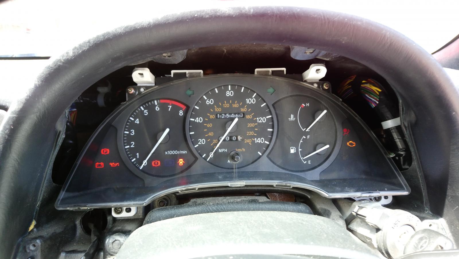

Next up was removing the instrument cluster again. Stupidly I'd refitted this all after the fiddling the other day but without the ABS warning light fitted, so I undid all the shrouds and stuff to get at the cluster again
Fitted the bulb into the ABS slot, reconnected the three multiplugs into the back of the binnacle then popped the bonnet to get at the diagnostic plug. I pulled out the bridging pin and plugged the AS approved 'diagnostic' paperclip in to bridge E1 and TC and then back into the driver seat.
Turn the key to position 2 and observe the flashing light of ultimate information. it goes on. It goes off. Then it flashed three times, pause, then two more. Long pause. three flashes, pause, two flashes. repeat. RIGHT Mo_FOs, thats just fixed 66% of my problems.
This means that the relay was indeed iffy, and the error code 31 was a false positive. I've fixed this by replacing the relay so its no longer 'open circuit' (code 11) and the ECU can talk to the clearly working ABS sensor in the right hand (drivers side) wheel hub (code 31). However this does mean that the passenger side (left) one is still sad (code 32) and needs cleaning or replacing.

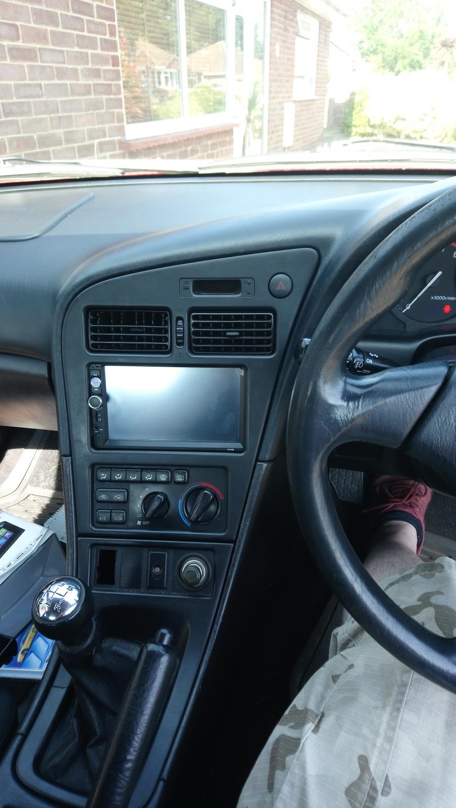

Thats right folks, check this bad boy out.
It does all the things - bluetooth, USB, FM radio, AUX and will take a microSD/TF card. No GPS, thats extra. Here is the old one, sulking in the passenger footwell

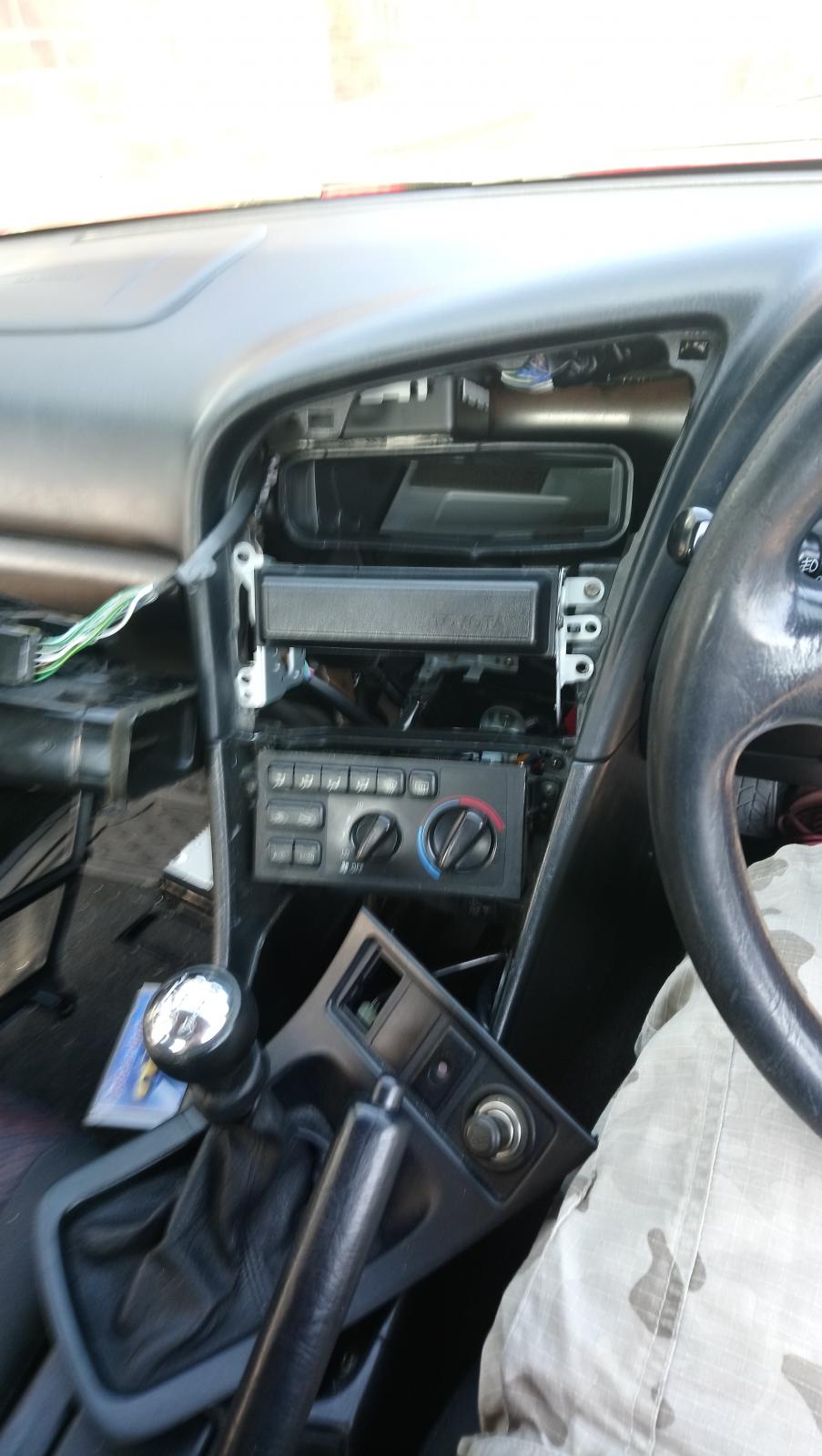

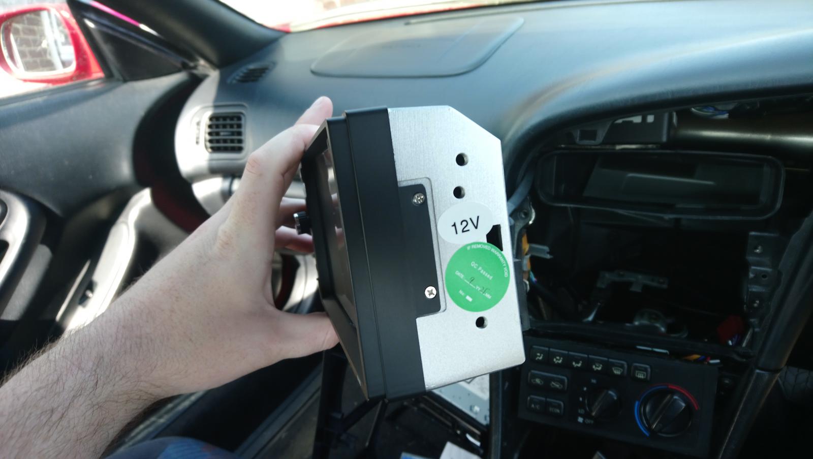

Anyway, first up I had to pop out the surround of the centre console and take out the top din slot blanking plate. Why can't cars these days be more like this? sculpted dashboards with stereos that have to be coded in and out is a pain in the todger.
Next up, debox the new head unit.
12 valve, yeah?
Seems nice and compact, obviously not very deep because it doesn't accomodate CDs but not visibly broken. Lets plug it in.
Here it is trial fitted
What followed next is what can only be described as an almighty faff. The brackets that hold it in dont have holes in the right places really, so I had to grind off some of the extruded bits, shim the bolts that hold the brackets to the head unit with some washers and generally fiddle about a lot to get it to sit right* in the dash so i could get the centre console fascia to go back on right, but not obscure any of the (admittedly few) buttons. This took some while to achieve and still could be better, but by now, with the aerial and power/speaker connecters plugged in I was rewarded with this
I plugged a full size SD card connected to a USB multi-reader and it happily played music, the radio works, and actually picks up more stations than either of the other cars, all 4 speakers work, everything.
With it turned off its relatively inoffensive
The fit could be better, but it will do for now. What I really need is a proper full-depth cage for it, I might get around to that one day but its not going to be today. It works, actually it works better than I expected for £28, and looks alright.
I'd recommend one of these to anyone actually, we'll see how it does longer term.

Quick update, the cheap-ass head unit is a bit crap. I know, shocking right?
it works fine most of the time, however it will cut out about once an hour. Sometimes more, sometimes less but if listening to the radio it just reboots and carries on as normal which is no real hardship. If you're listening to music on a SD card (or watching a film, I assume) it stutters then reboots and starts from a couple of songs back. I thought it was a corrupted mp3 but it can happen at any time it seems.
Overall its not terrible, but a bit iffy. Its not coming out because I've nothing to replace it with but it is a little bit annoying.
the sound and stuff is fine though.
I've always thought that touchscreen devices in car are a silly idea anyway.
Then add the fact it's a £28 dodgy bit of Chinese electronics and you have a party.

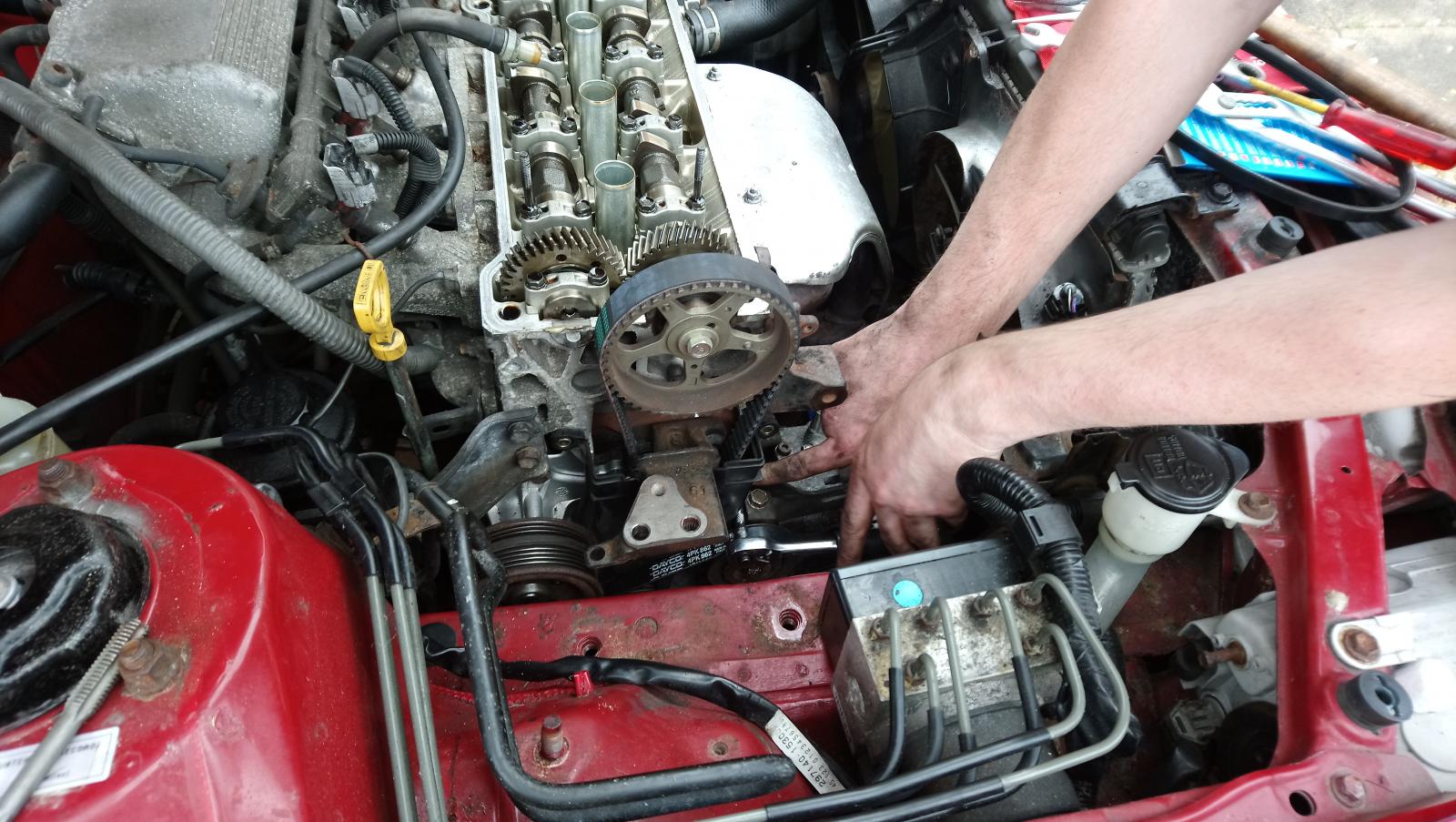

In this shot, I've taken off the coil packs, taken the spark plugs out, and removed the top section of cambelt house from the left hand side of the engine. its remarkably clean in there.
This is the old cambelt fitted, its not cracked or particularly haggard looking, but it is a genuine Toyota one, so is certainly the 2003 belt and therefore very elderly.

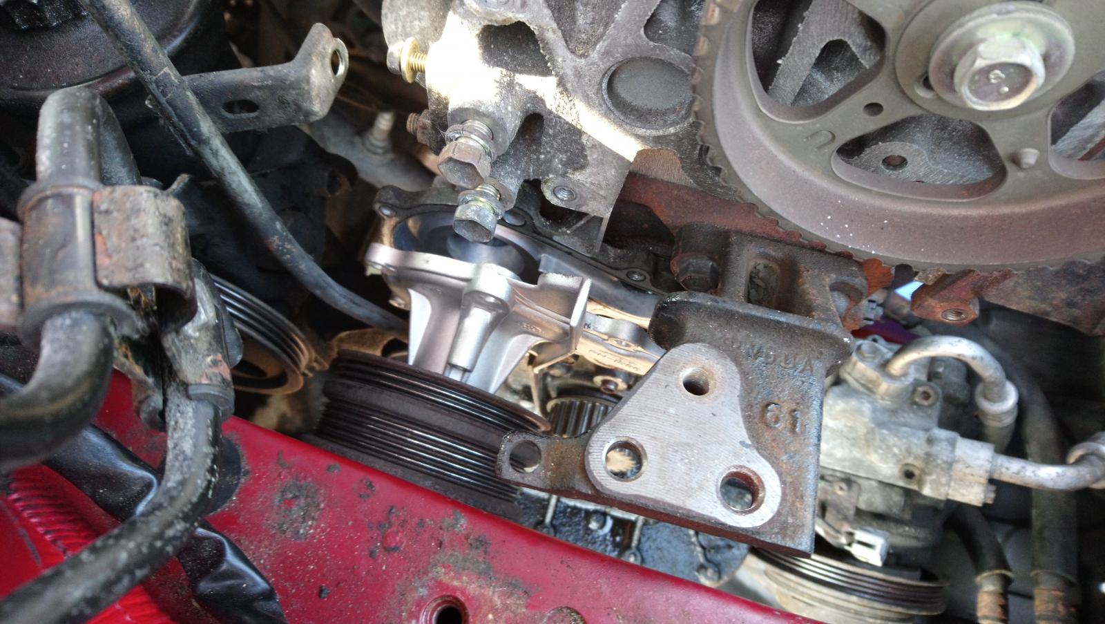

The water pump was wiggled expertly free without pulling the cambelt off for a third time, but there was no way we could get the new one in without ripping the gasket to pieces. Frustratingly, this meant the cambelt and tensioner did indeed need to came off AGAIN. Urgh. Oh well, at least we know what we're doing now. Bottom pulley off, tensioner detensioned with the hookity-hook, belt slid off the sprockets and a clear run to the housing. Here we are with the belt almost off for the third time
The water pump housing is visible in the bottom left, nice and shiny and cleaned up with a rag.
In a fit of cleverness (more on this later) I bolted the pulley to the new water pump before fitting, then with some VERY careful manouvring the new water pump was moved into place, and the gasket slid into the gap. We then carefully put the water pump bolts in, making sure the gasket was kept flat throughout. Here it is in roughly the right place, before the gasket was inserted
