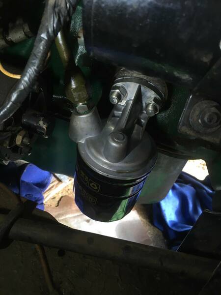

Asimo Posted May 22, 2021 Share Posted May 22, 2021 Did you fit the filter upside down? If you do then the oil rushes out past the gasket and all over the pristine new concrete drive. Guess how I know. Link to comment Share on other sites More sharing options...
LightBulbFun Posted May 22, 2021 Share Posted May 22, 2021 28 minutes ago, 17-Coffees said: Long time buuuuuuuump. Since last time I posted not much has happened. I started it up and did quick look arounds every so often and that's about it. And over the last year I've just been feeling shit and not in the right mind set for much, so good to be back to tinkering again. Anyway... As stated in News24 the other day, work has started on the Minor again! Yay! Having done a service last week I got hold of a new battery (Stole the new one for my golf) and managed to get it fired up. That's the good news! The bad news is that I was an idiot and acted against my better judgment! You see, the oil filter wasn't 100% the same, but I though "Looks close enough" and loped it in...As soon as it fired up it started pissing oil from the filter. Oh cock. So looking for a filter that looks correct, I saw conversion kits for a spin on filter so decided that for £30 it was a now brainer! I'll also need to get some new oil as although have some oil left from the service and it never pissed much out, I've no idea how much it'll leak when doing the conversion! So anyone have recommendations for oil as Halfords don't list there own brand stuff any more (I get mad discount on own brand stuff). Also with the battery fitted tested the lights, and now 90% sure it's the relay for the indicators, so ordered that as well. So fingers crossed it all arrives quickly, so I can then move onto other stuff such as greasing all the geese nipples and checking the underside fully again! 😀 Yay! glad to see you have got your enthusiasm back for it I look forward to seeing more posts and pictures of it once more 17-Coffees 1 Link to comment Share on other sites More sharing options...

SiC Posted May 22, 2021 Share Posted May 22, 2021 3 hours ago, 17-Coffees said: Long time buuuuuuuump. Since last time I posted not much has happened. I started it up and did quick look arounds every so often and that's about it. And over the last year I've just been feeling shit and not in the right mind set for much, so good to be back to tinkering again. Anyway... As stated in News24 the other day, work has started on the Minor again! Yay! Having done a service last week I got hold of a new battery (Stole the new one for my golf) and managed to get it fired up. That's the good news! The bad news is that I was an idiot and acted against my better judgment! You see, the oil filter wasn't 100% the same, but I though "Looks close enough" and loped it in...As soon as it fired up it started pissing oil from the filter. Oh cock. So looking for a filter that looks correct, I saw conversion kits for a spin on filter so decided that for £30 it was a now brainer! I'll also need to get some new oil as although have some oil left from the service and it never pissed much out, I've no idea how much it'll leak when doing the conversion! So anyone have recommendations for oil as Halfords don't list there own brand stuff any more (I get mad discount on own brand stuff). Also with the battery fitted tested the lights, and now 90% sure it's the relay for the indicators, so ordered that as well. So fingers crossed it all arrives quickly, so I can then move onto other stuff such as greasing all the geese nipples and checking the underside fully again! 😀 I still see it https://www.halfords.com/motoring/engine-oils-and-fluids/engine-oil/halfords-classic-oil-20w50-5l-537977.html Don't forget the oil filter needs the big metal washer thing on the bottom. Often stuck on the old filter and accidentally thrown away. Otherwise oil will completely bypass the filter medium. Low Horatio gearbox and LightBulbFun 2 Link to comment Share on other sites More sharing options...

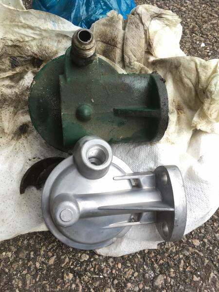

17-Coffees Posted May 24, 2021 Author Share Posted May 24, 2021 On 5/22/2021 at 8:47 PM, Matty said: Just make sure you get em done before autumn before they fly south 😁 Don't worry, I plan to! 🤣 @Asimo - Sadly it's not as simple as that, the filter is just a different design altogether top & bottom. I was being an idiot and thought "Meh, It'll do the same as its the same size" 😅... @SiC - Much as I said above it's my own fault! But Never did check for a washer, just an O ring! I'll find out when I do the swap for the Spin on filter. I must be blind when checking Halfords as couldn't find there own brand! Thanks for that! 😁 Matty 1 Link to comment Share on other sites More sharing options...
SiC Posted May 24, 2021 Share Posted May 24, 2021 Item 20. Often lost. Without it, oil won't be filtered as it will simply go around the filter rather than thru it. https://www.morrisminor.org.uk/parts/10-oil-filters Link to comment Share on other sites More sharing options...
17-Coffees Posted May 24, 2021 Author Share Posted May 24, 2021 Ah cock! I'm an idiot! When When said a big washer I wasn't thinking that big! I know for a fact without looking that it's still attached to the old filter! I just thought it was an attached part of the filter. Thanks for clearing that up for me. I'll throw it on tomorrow just to get it fired up and moving. With the spin on filter conversion on order I'll take it as a lesson learned, but least It wont happen again! And to think it was a near daily thing for me to do oil & fuel filter changes on a fleet of HGV's! 😅 Tickman 1 Link to comment Share on other sites More sharing options...
17-Coffees Posted May 28, 2021 Author Share Posted May 28, 2021 I never got the chance to put the washing in, got called for overtime so been working. But today the parts arrived so got round to that, as expected, basic kit... I was hoping I wouldn't have to fit the new studs as my experience with them can be fine or absolute hell. But yeah, they needed to be fit as you can see the length different... But thankfully came out no problems! Nice and shiny! 😀 Also moved the Lexus down the driveway, so for the first time in about 2 years I got the old girl out the garage under her own steam! Appears to be running fine too but I'm sure adding 5 liters of new fuel would help as what's in the tank is about 2 & half years old. Reversed back in and called job a good un for now! Now to fit the indicator relay and see if that sorts out that issue, as well as start greasing the nipples. Next things I'll need to buy are headlights, only got one working (O/S is blown) and a few tines of primer! PhilA, tooSavvy, Joey spud and 7 others 10 Link to comment Share on other sites More sharing options...
