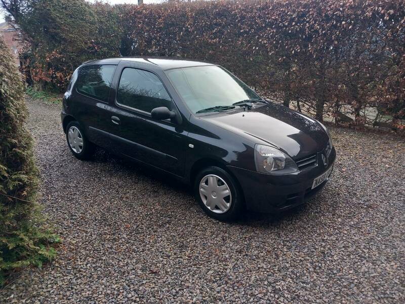

These Clios are brilliant - we’ve got a friend with a very neglected 2007 1.2 that just will not give up. Never gives a moment’s trouble - she throws it at the mechanic once a year and says “get it through the MOT” and is handed a freshly serviced car and a bill of no more than £300.
Cambelt isn’t difficult either - daft not to for that money

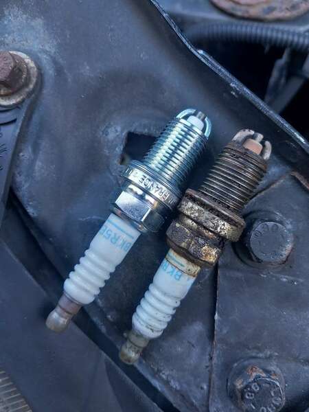

Just changed the plugs on this before setting about making tea.
@320touring, (with relief) I can report there're no special tools required. I assume the 8v cars are easier than their posher 16v brethren.... That being said, the ones that were in there were pretty difficult to get out, perhaps original?? Great resistance and some arse clenching whilst getting them to initially move, and also whilst winding them sloooooowly out.
Old vs new....
Weirdly, the plugs my factor sold me were NGK BKR5EK, which turned out to be an exact match with the ones that came out.

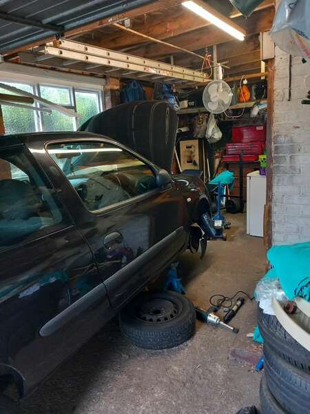

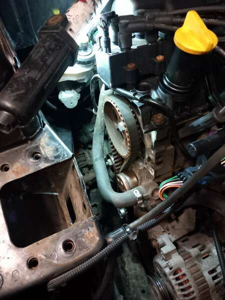

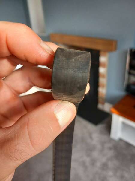

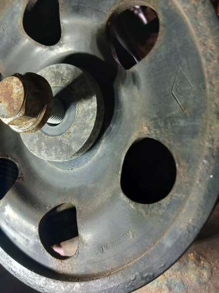

Pretty frustrating evening here- Literally about a third of the way through a timing belt change, sump supported/jacked up, alternator swung forward, engine mount removed.... and.... wait for it.... I don't have an 18mm socket in 1/2" inch impact flavour.
Very little chance of removing the crank pulley bolt with 3/8 stuff and a 12" breaker.  Ive furiously re-assembled everything and reversed it out of the workshop.
Current status- Sat sulking with a single malt whilst ordering sockets from Ebay.

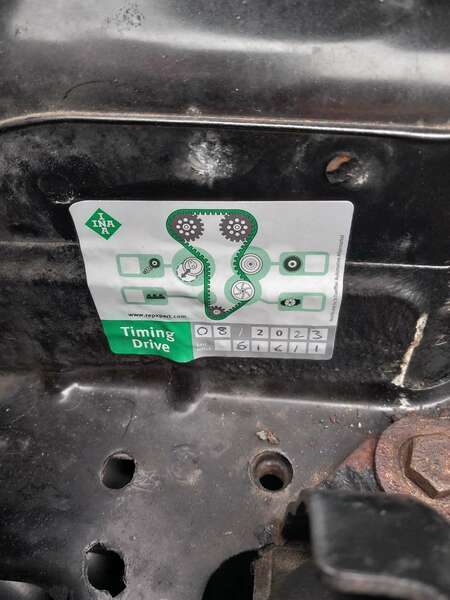

FINALLY got the timing belt done on the Clio last night.
The crank pulley nut buzzed right out with my corded Silverline impact gun of excellence (Praise the lord and the baby Jesus)
All in all the operation went smoothly.  Waterpump was checked and found not to be leaking so was left as is. I have another one on hand should troubles arise in future.
Total cost for the kit was £35, so bit of a no brainer. The cars only done 60k, but it's nearly 15 years old and the stuff that came off was clearly original and badly worn.
Alternator belt was replaced at the same time as it was coming off anyway and only cost £7 so daft not to.

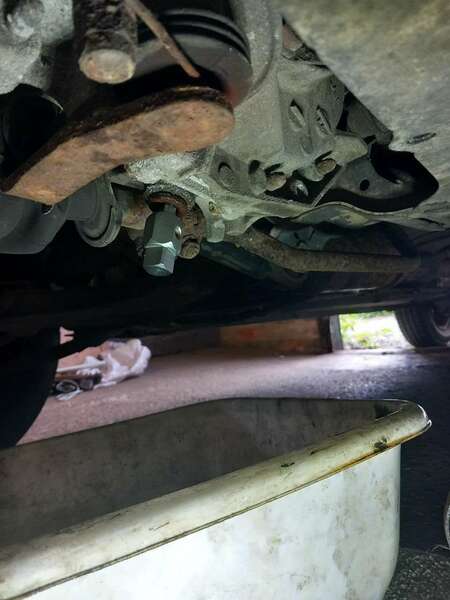

And then this morning I changed the gearbox oil. The old oil looked fairly bad, so again, a decent bit of preventative maintenance.

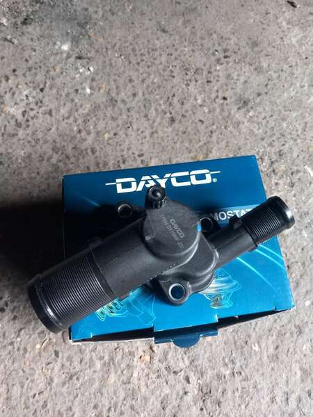

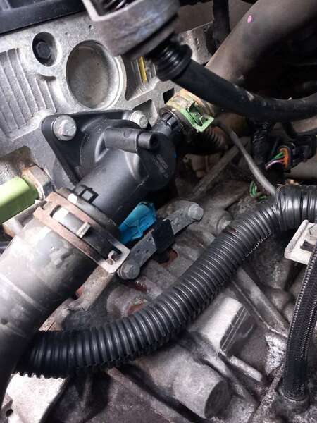

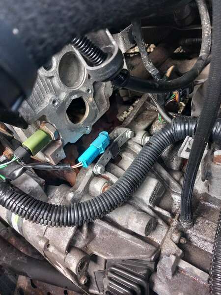

I'd noticed the Clio temperature was up and down, so today a new thermostat was the first port of call.
At £13 for a Dayco unit, it's daft not to...
The thermostat lives here (Hole on side of block where the old one came from)....
Access is great and in less than 20 minutes a new 'stat was fitted....
This worked a treat- Temperature is now locked in at 4 bars after a couple of miles warming up, and the onboard MPG average has jumped up from mid 30's to mid 40's. Result.

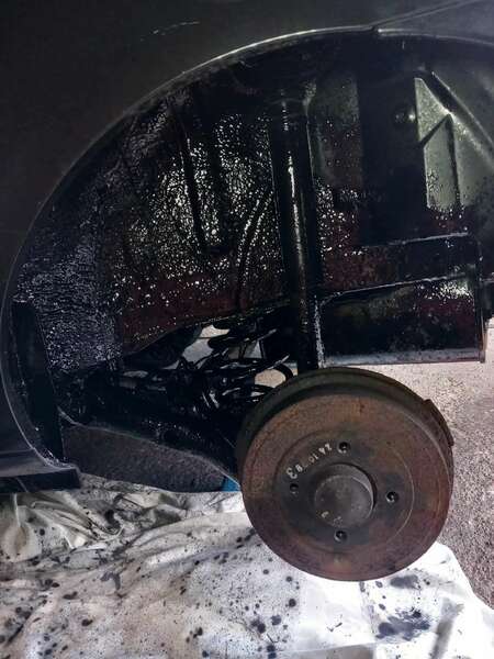

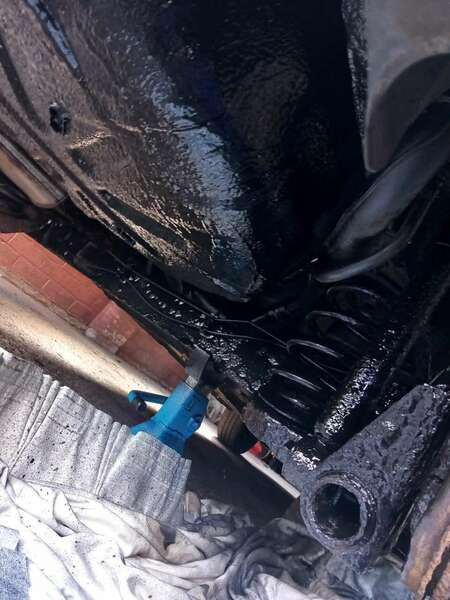

Busy day yesterday applying 'Lanoblack' rust treatment. In the past I've always used petroleum based stuff.... Only time will tell how good the sheep  based alternatives are eh.
Ita gone on OK at least- I'll let the pics do the talking....

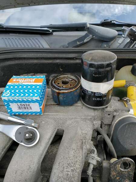

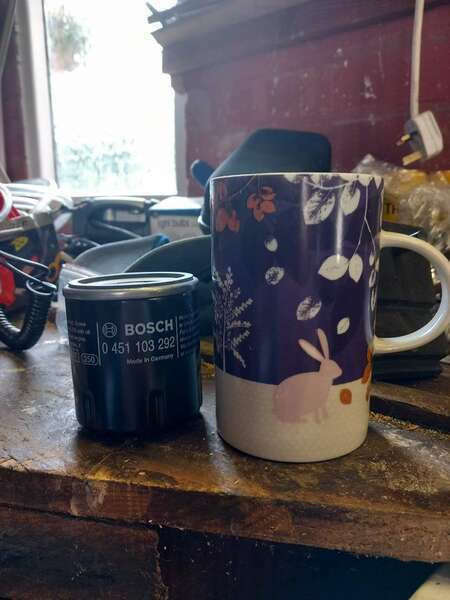

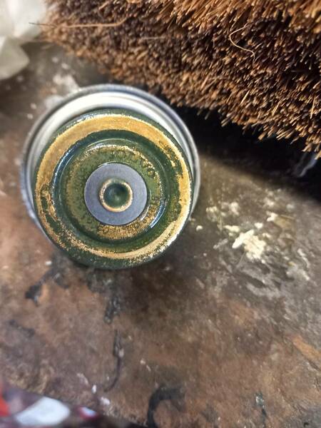

Aye, that's properly miniscule TBF. Makes you wonder how much filtering can actually be going on really.
Too busy gaun lit fuck Tae bother filtering
They've been flat like that for many decades without getting a reputation for lubrication failure, so it seems to work.
To be fair, most 182's don't manage between oil changes before breaking😁
You could also get Purflux LS946, which is basically the same filter but deeper.

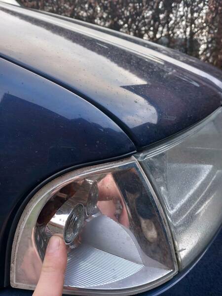

I've been looking after my brothers cars as usual (Both Mk1 diesel Octavias, the blue one us a VE ALH 90 TDI, and the silver one an SDI in AQM flavour)
Basically, aside from an indicator that lost its lense, and an upgrade to Osram Nightbreakers on one of them, they've needed nothing.

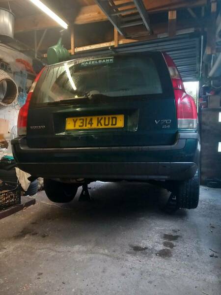

Meanwhile,  today I set about the annual adjustments to the Volvo's handbrake system in preparation for MOT next week.
These are a major week point for the P2 platform across the board, and despite the annual battle to set it up as best as I can, I never escape without and advisory for it.

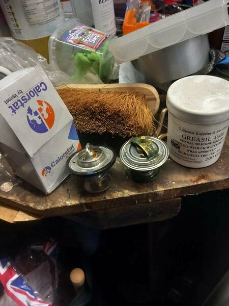

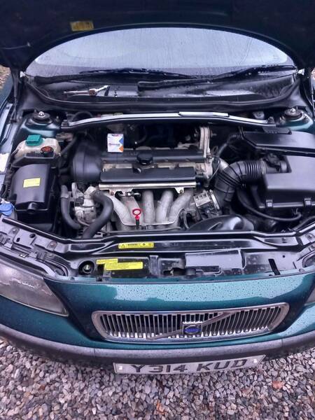

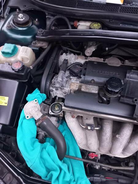

This one passed its MOT with a clean sheet last week, but meanwhile has been cruising around struggling to raise the temperature guage above 30% - Not good for a PCV system already infamous for gunking up.  A stuck thermostat was my diagnosis.  A very simple job on pre 2003 P2 cars thankfully.
Old vs new (NOS calorstat branded item sourced via Ebay for £12)
The original was Volvo branded, so in all likelihood had been in situ for 23 years. New stat installed, now the temperature gauge is pinned in the middle so job jobbed.

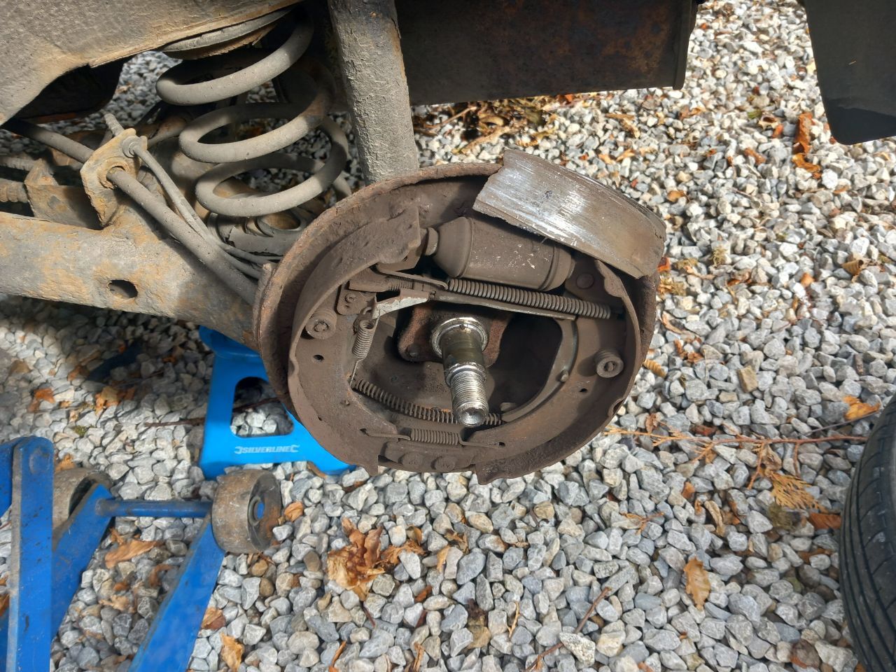

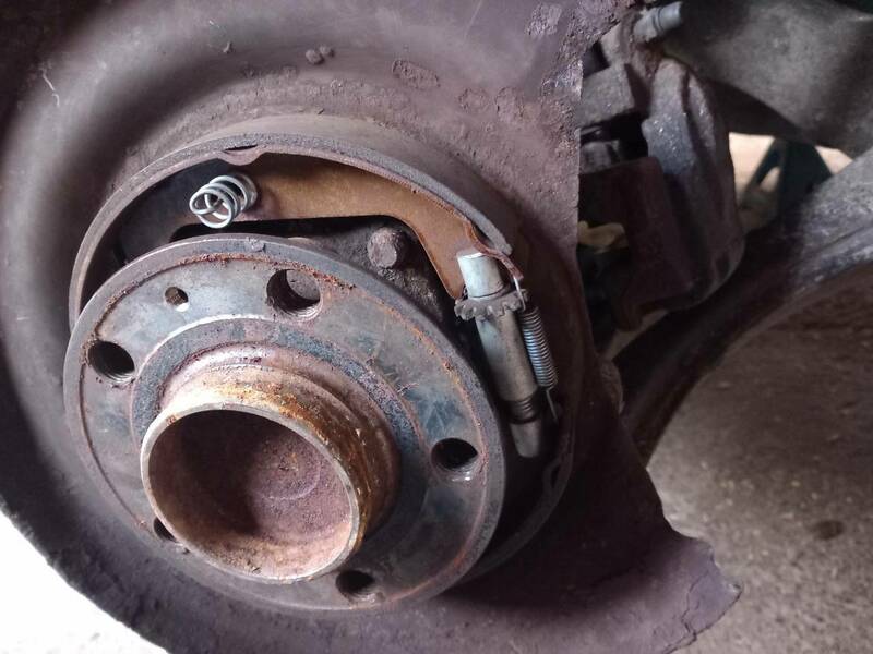

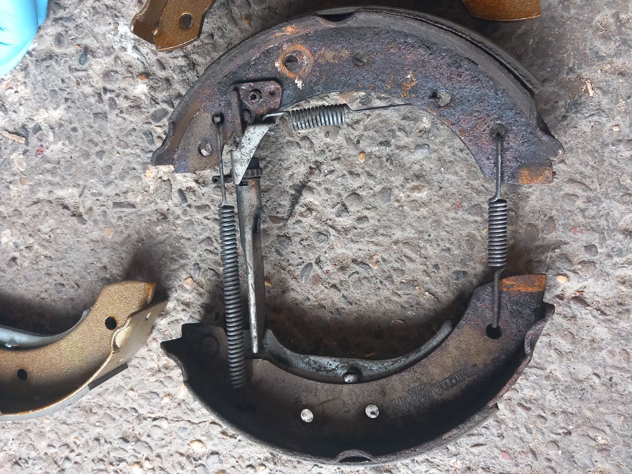

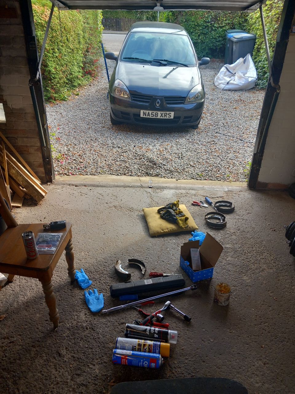

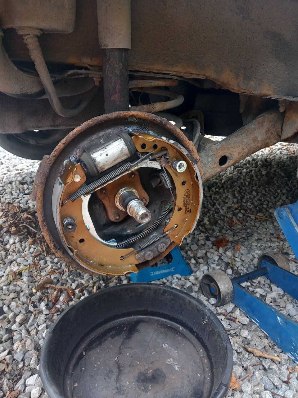

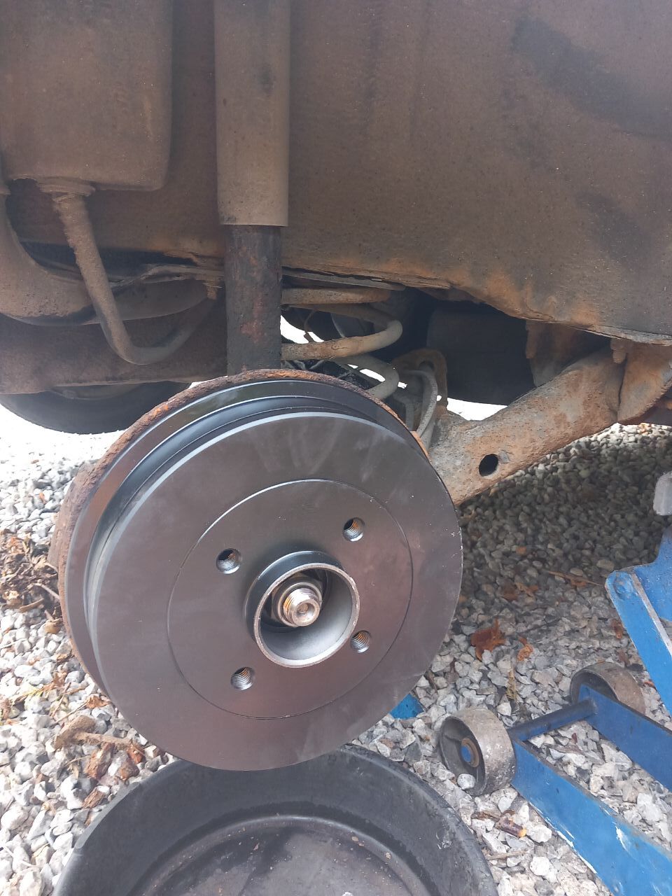

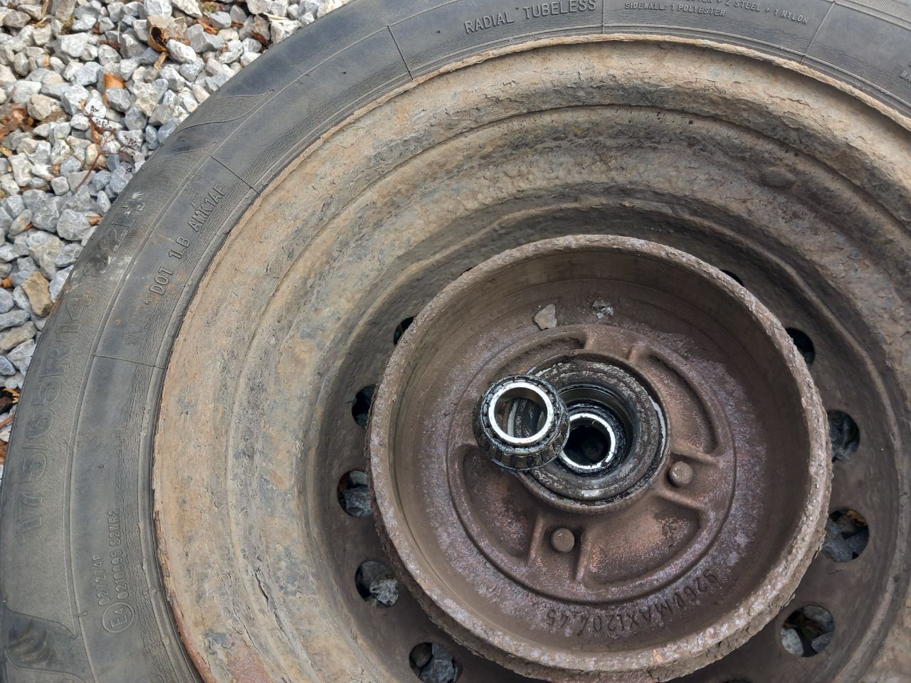

I set about servicing the Clio today only to find that the rear drum was stuck. Much to my shame I've never really checked the rear shoes in the two years I've had the car as mileage is quite low. Eventually got it off to find....
Yep. The shoes have completely delaminated and fallen apart in the drum (Apparently this is a fairly common *quirk for Clios of this generation). How on earth this wasn't causing any issues/ didn't lock the wheel up I'm not entirely sure.
Technically speaking I've been lucky...
Things got even better....
Yes indeed. The bearing has decided it doesn't want to be part of the drum anymore (Possibly due to the force excerted on it removing it from the car, although it must have been on its last legs).
I don't fancy trying to remove the old bearings and drift new ones in without a press, so that'll be new drums too then...
After working my way through the ninety seven different possible drum/shoe options fitted to Clio Campus models of that year it became clear the only people who could order them in locally were GFS.... And wait for it... They want £100 per drum, and £32  for a set of shoes even with a 20% discount.  Deep joy.
I've ordered the same Apec drums from CPIM on Ebay for £68 for the pair and Bosch branded shoes for £18. Clio status-  shoved into a corner of the drive to sulk/think about what it's done until one evening next week when I can get at it again.
  • Shirley Knott changed the title to Shirley Knott's Evil Web Of Shite
New drums/bearings/brake shoes went on the Clio on Saturday morning...
Its been a while since Ive had to deal with drums/shoes/the nightmarish fuck on with springs and adjusters that comes with them so it's been *good to get my hand back in.

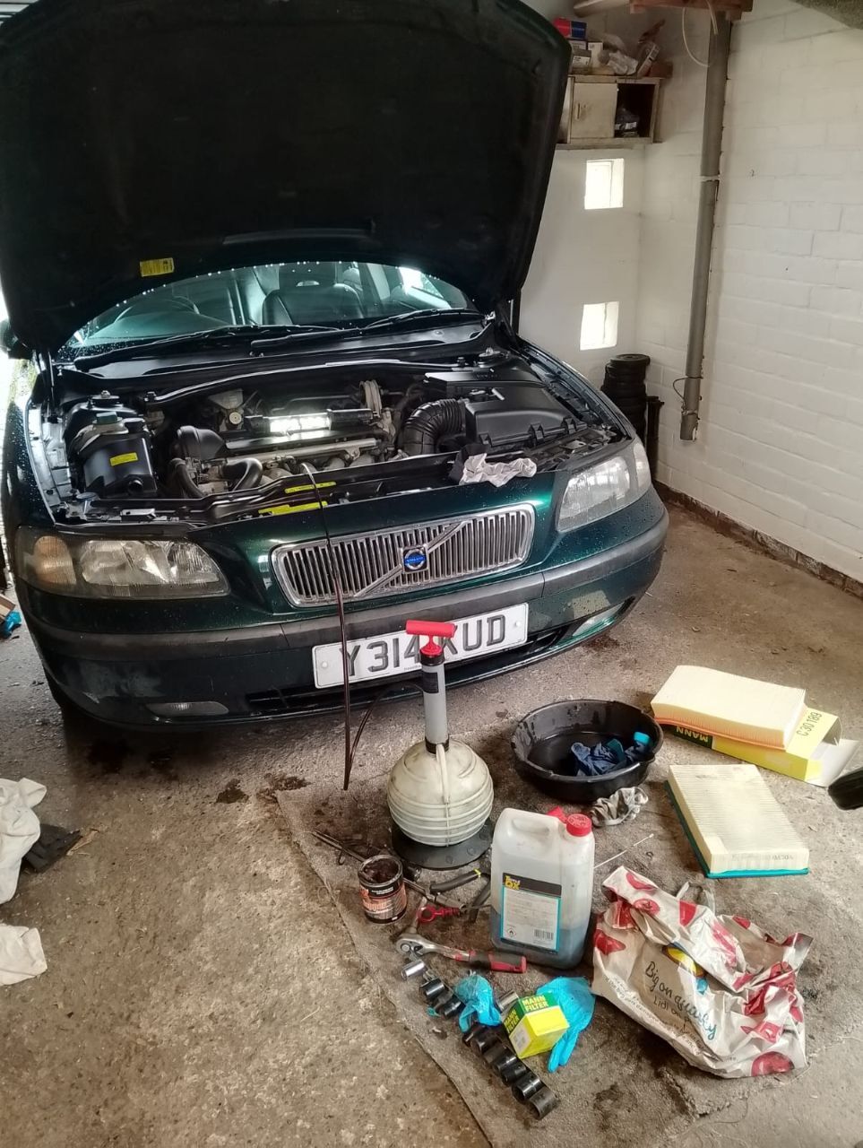

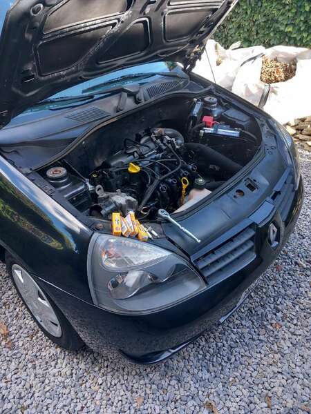

Bit of servicing today, new plugs for the Clio plus oil/oil filter change.
The ropey V70 got an oil and filter change and a fresh air filter too.
