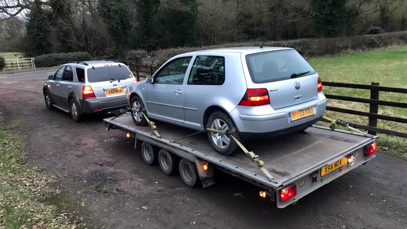

Incoming
The C1 was my wife's daily driver, but in a moment of brilliant decision making I've now replaced it with the £25 roffle win Golf GTI. Looking at the MOT history the car has stood for two or three years, and then went to live with @blackbart where this was remedied by allowing it to stand for a further 6 months. Blackbart has only driven the car a mile or two in his ownership, so I literally have no idea if it overheats, has OMGHGF, or any other foibles. One things for sure, allowing a car to stand for years at a time is never good.
Here's a picture of it en-route via @worldofceri, who delivered on time and offered a world class service FWIW (Thanks again Ceri!) Also, an honourable mention to @Sh'Eds who kindly supplied some oil filters gratis to be shuffled, along with the car up North.
IMG-20210304-WA0000
I've had the car 24 hours now and the snagging list is as follows...
Miss-matched tyres (One very badly perrished), No timing belt history or service history at all worth mentioning, arm rest broken, bonnet release handle broken, slight misfire at idle, temperature gauge completely inoperative, dip stick tube broken, all brakes badly rusted, exhaust blowing.
As people say around these parts, WCPGW?
