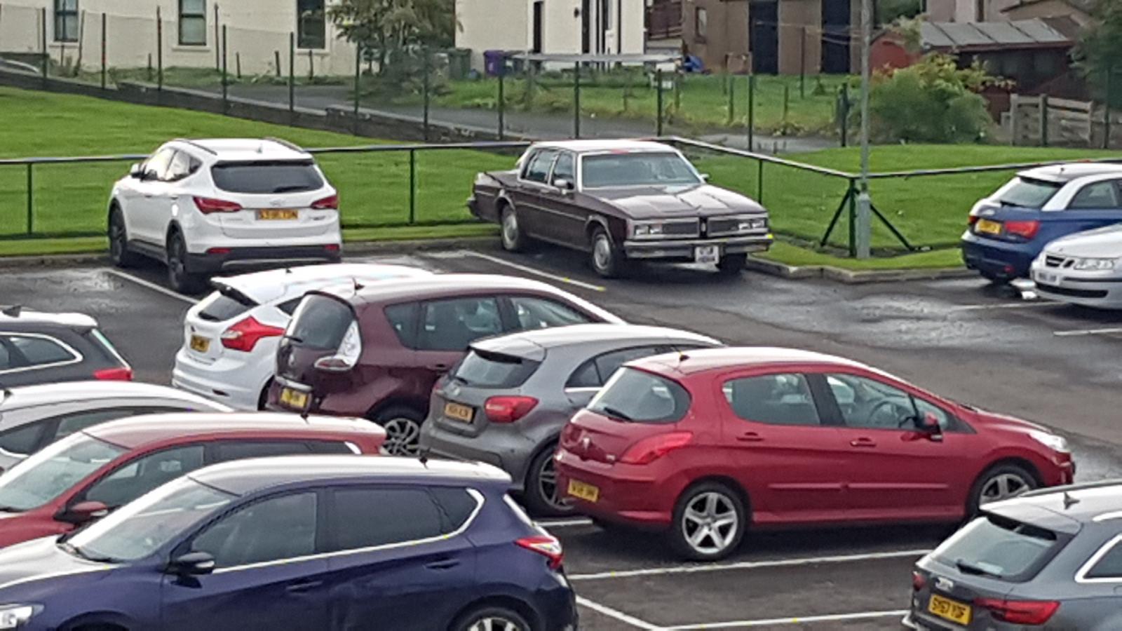

I've been dailying the delta lately. No point having this fine beast and not makimg the most of it.post-5582-0-31850400-1537543232_thumb.jpg
Looking quite petite in the staff car park.
Only niggle is its tendency to hang onto the gears too long. It has always done this, but I think it's getting worse. Previous owner had old Engelbert's box reconditioned to cure this, unsuccessfully apparently.
I'm off down town to buy a pint of milk, in the Olds.
There should be some sort of pedal position to gearchange relationship that can be adjusted.
