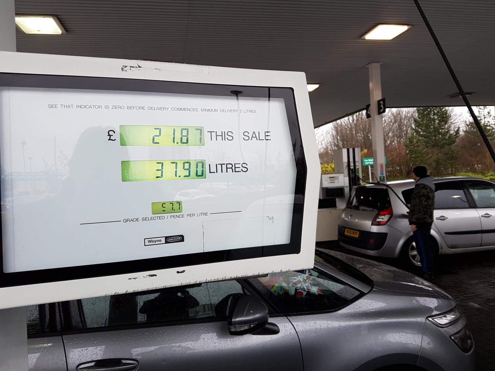

Time for a refill. Which also means:Time for some man mathmatics.
These litres, then these number of miles traveled,
And then these litres:
Comes out by my imprecise reckoning to be about 30 Miles per gallon running on gas.
If that doesnt sound too great, you can spin the shit out of the numbers by pointing out that LPG is less than half the price of Petrol and Diesel so youre kinda getting in excess of 60 mpg er, comparatively speaking. Then you just ignore the petrol you have to slop in to start the engine on.
Still, cheap enough eh?
