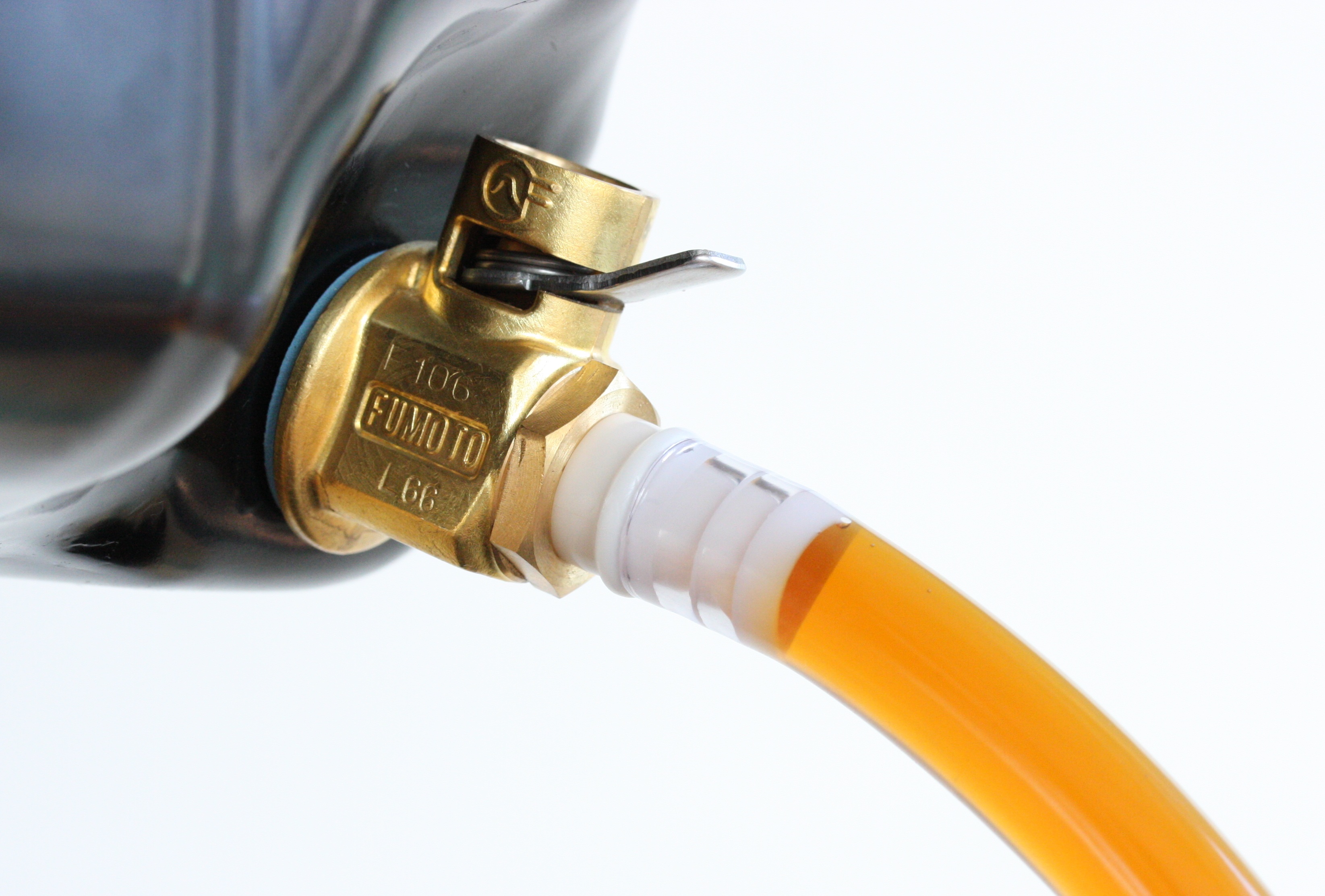

Other mess free solution's are available. The (not)Swift is due an oil change and I might get one of those pumps and replace the Fumoto valve if I can remove the filter from the top. That way I could change the oil without even getting down on the ground which would be awesome.
You will still need a drain pan for the filter with this though

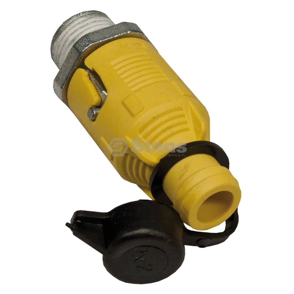

Blimey. On my Snapper ( lawnmower ) letting the oil out is way too easy. They have a plastic quarter turn tap which sticks out the back, it being rear engined. (Like a Porche.) I bet Briggs & Stratton had a big upsurge in sales when they fitted this stupid device...
