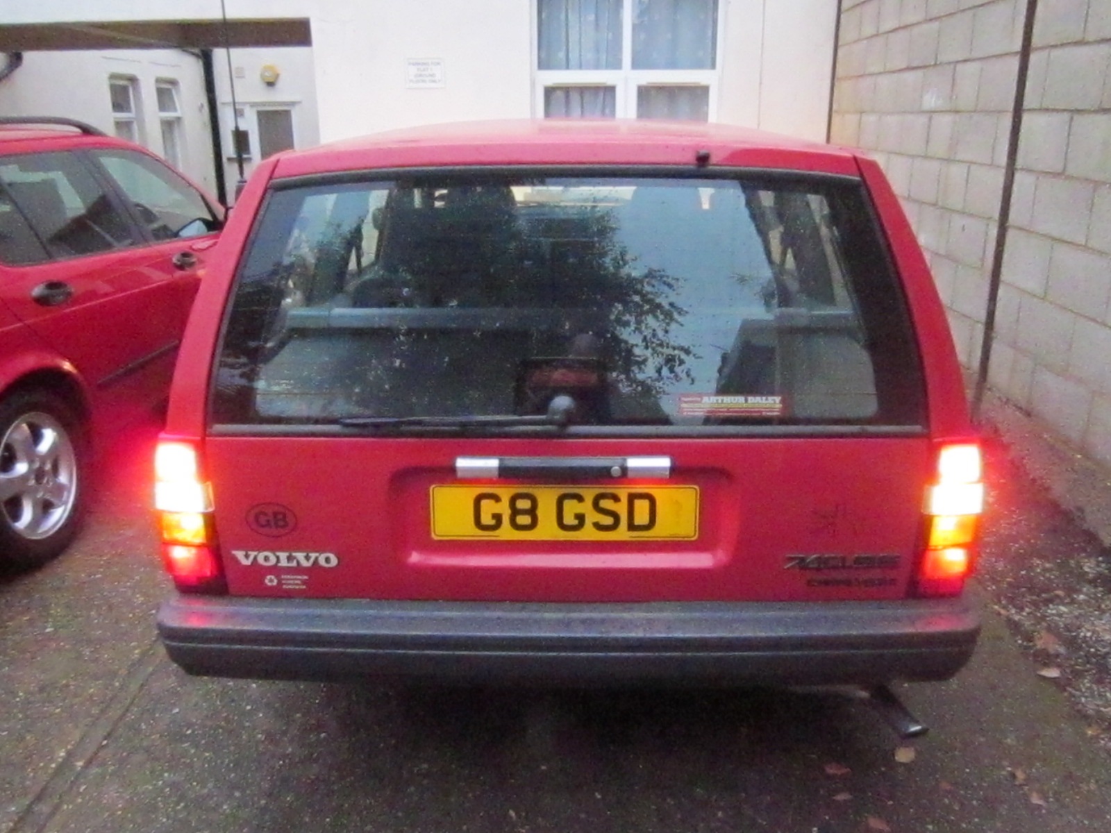

Managed to get all of The Volvo's rear lights working this afternoon:
Should improve its MOT chances :)

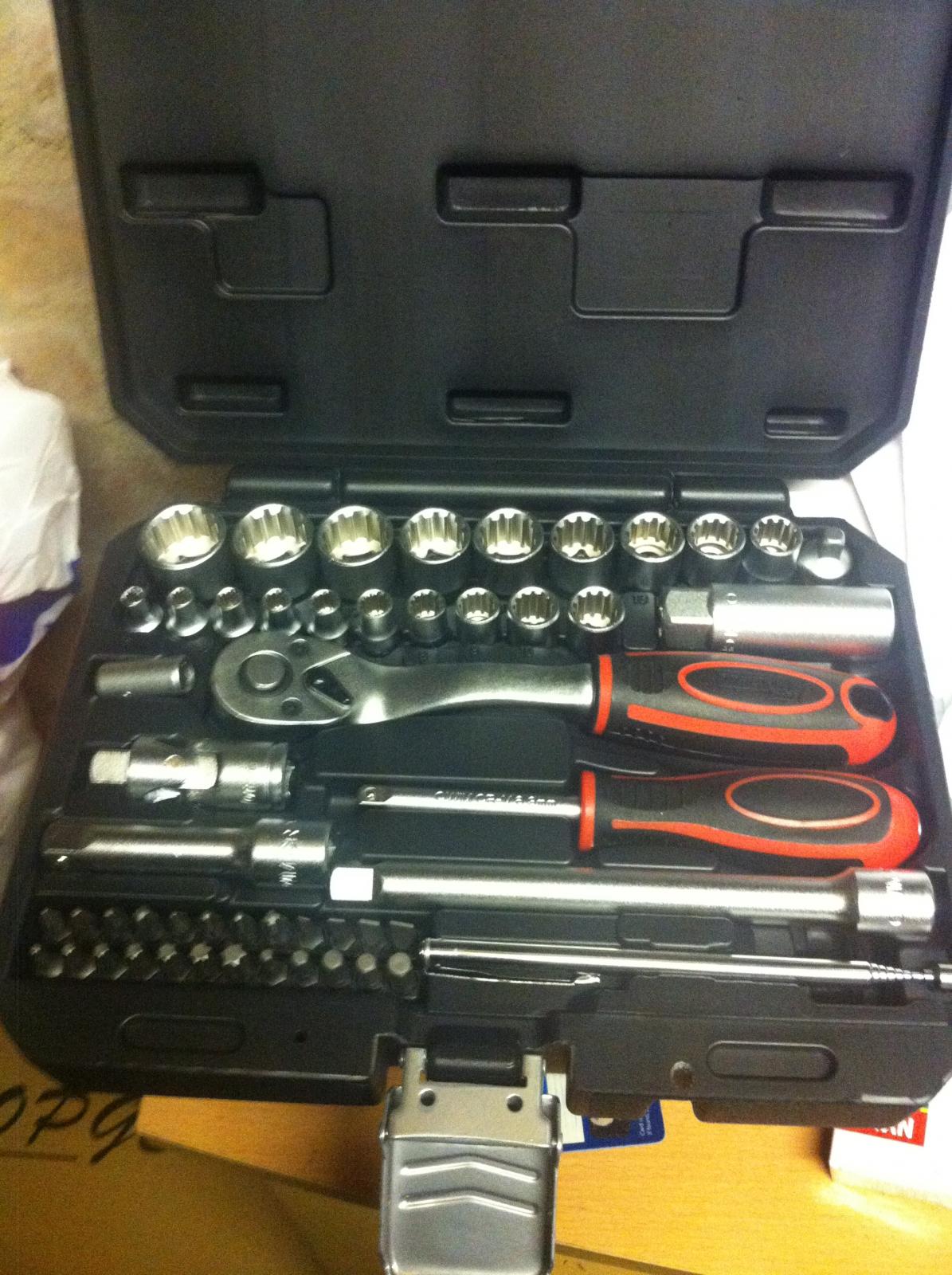

Is it not 52 piece? I was having a butchers at a small set in Didldidi this morning whilst out for some milk. Managed to resist it and the bench grinder and just come home with some wood drill bits.
Yep you are correct, 52 piece.
Maybe some glasses would have been better!!
Mmm tools.
*pendant mode on*
er no you didnt you missed one in the middle of rear screen
*pedant mode off*
