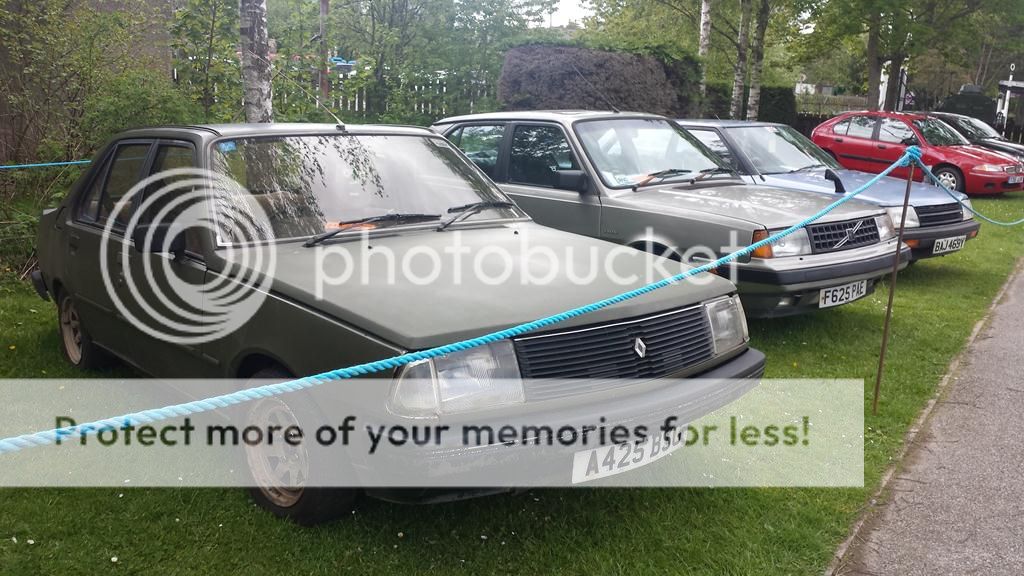

The time we took a Renault 18 GTD, a Proton MPI, a Datsun Stanza and a Volvo 360 to a classic car show was a laugh.
A guy in an Anglia 105e reversed his car so that FOAD's proton wasn't in any pictures.
You've got to laugh though!
I dunno', the 18 got plenty of attention when you fired it up, old boys swarming from everywhere. I think they thought it was a tractor in fairness...

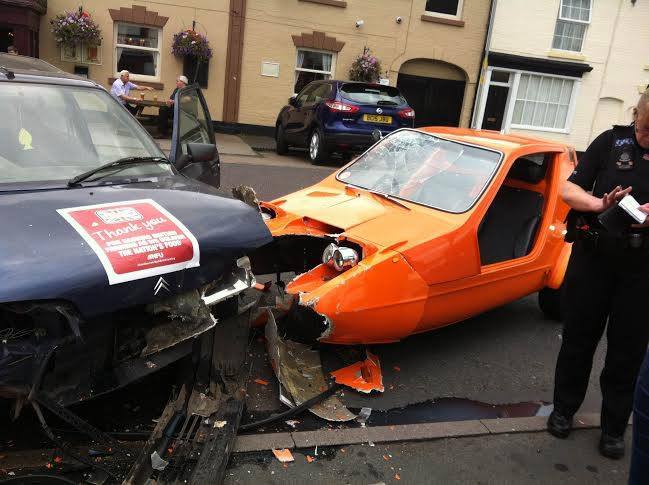

Ooosh, that doesn't look good. Note the headprint on the Bug's windscreen...
:shock:  :-( not good hope the driver is ok. Was it a friends car or do you still have Reliants?

Ouch indeed. Two cars you probably don't want to have a bump in.
One occasion where you might be thankful to be in an AX? Hope all the occupants are as well as they can be (I'm kind of skirting round the suggestion from the photo that at least one person appears to have been hurt).

Both the bug and ax drivers are fine. Yes,these owners answer was " I didn't see you" ffs. I'd rather have been in the bug,why are crash helmet s made of fibreglass I wonder ;-) the bug is powered by a 1000cc hayabusa engine BTW.....and no,its not mine lol
That's not the Bug that got featured in a mag a couple of years back, is it? Damn shame if so, although I guess the important stuff at the back can be transferred to another one fairly easily.

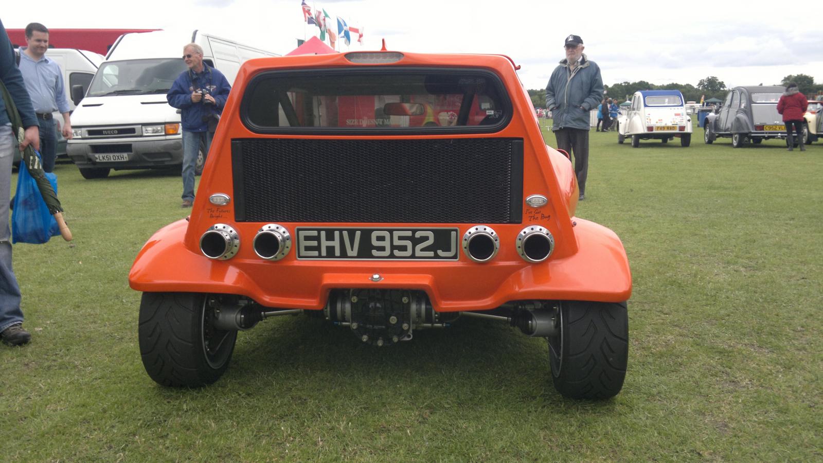

 Oh please don't let it be this one.........

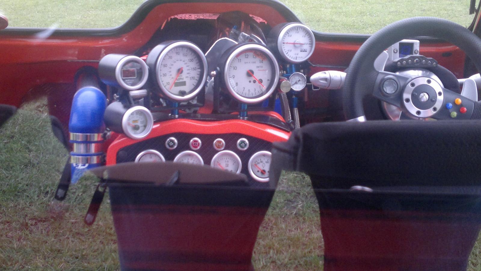

Really well engineered. X-Box steering wheel buttons change the gears.

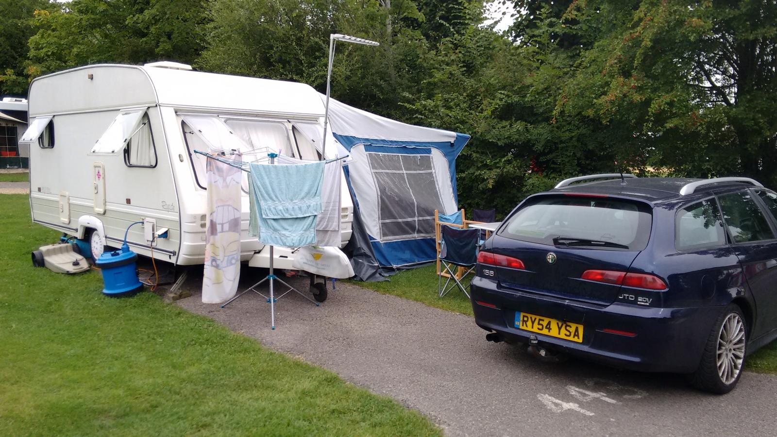

The Alfa coped well towing the shite family caravan to the New Forest. I get a lot of pleasure having the oldest most worthless caravan on the site. It's a 1993 5 berth but it all works well in a retro kind of way. OK, there's no heating or hot water but not a problem in August. It gives the same feeling as running an old, unpopular car. Others may look on in derision but we're having the last laugh as it's worth less than a monthly instalment on their new model and is doing a grand job. I thought it would expire about 5 years ago but it just refuses to die!

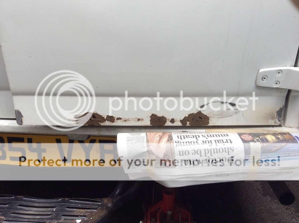

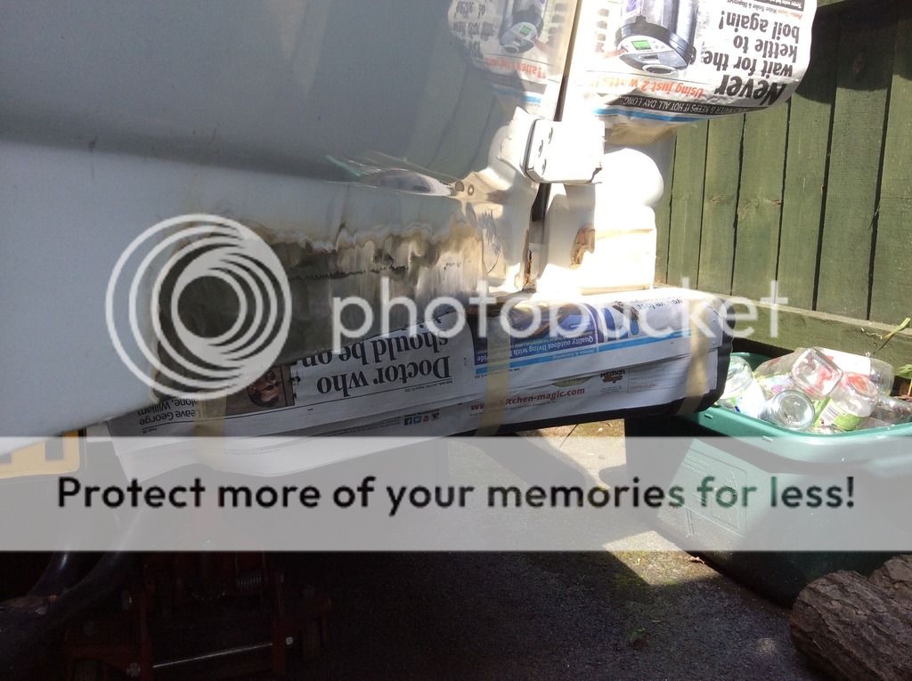

I did a bit of bodywork on the Transit today.
One of the rear doors had blisters appearing along the bottom edge. I gave them a scrape and prod with the trusty screwdriver and sure enough the two biggest blisters turned into holes.
image.jpg1_zps6bz9c1i9.jpg​

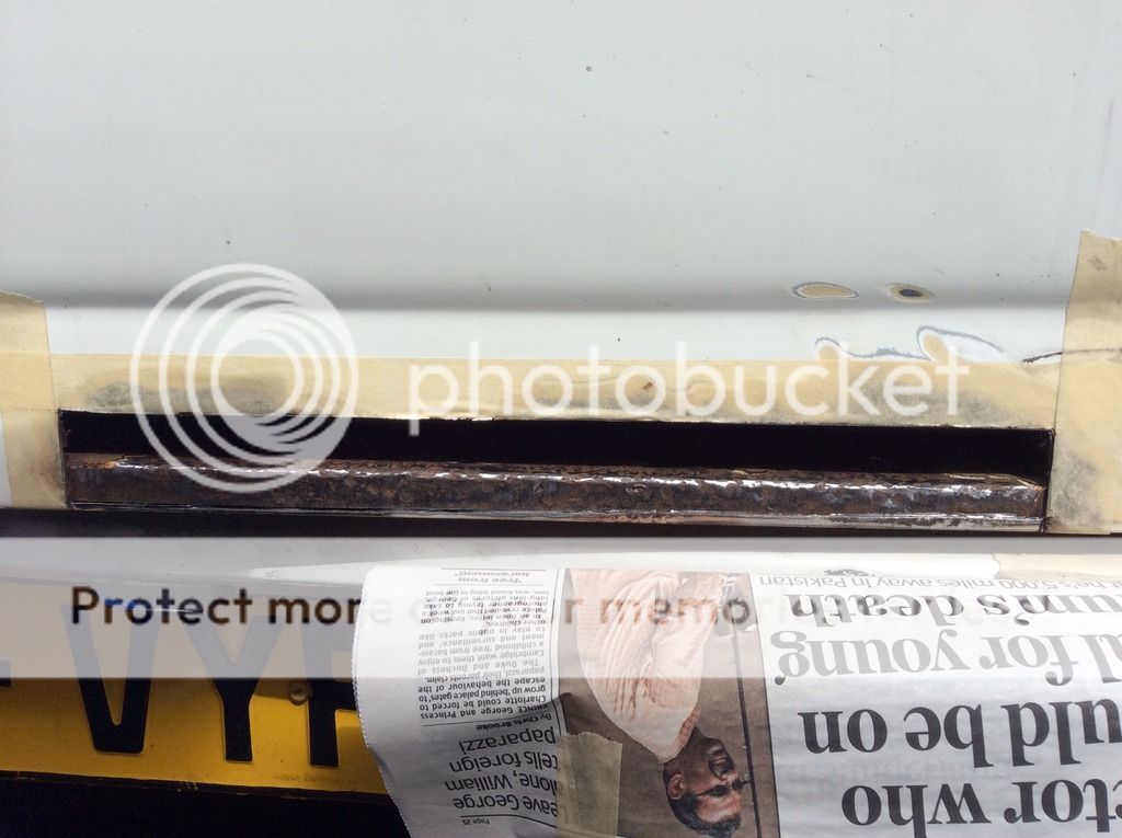

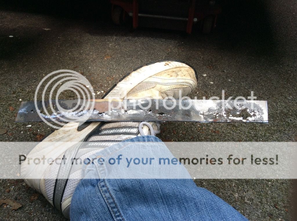

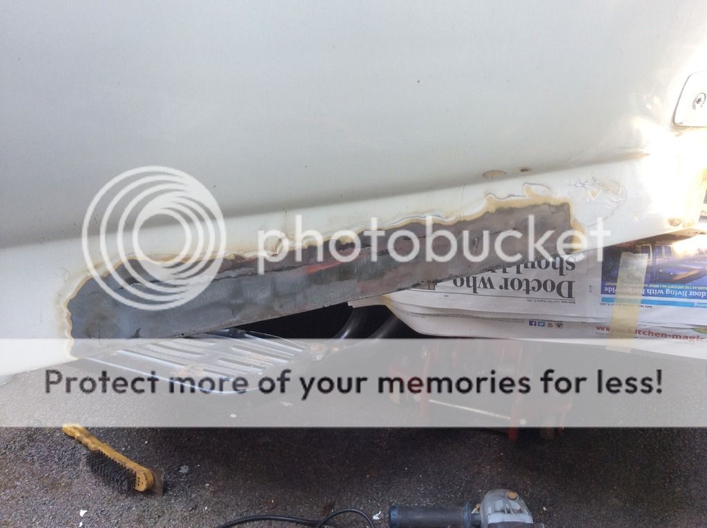

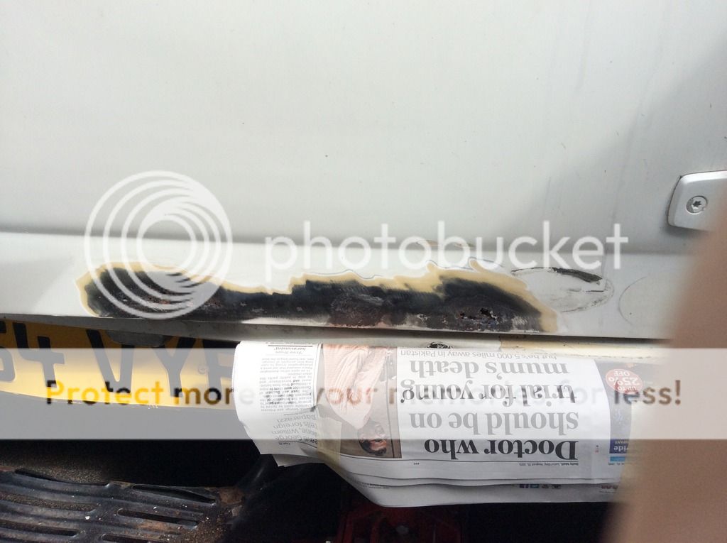

Flashing the grinder over it all revealed loads of little rusty pits and little holes. These were all fairly close together so I just cut the whole piece out.
image.jpg2_zpsbaoasox9.jpg​
image.jpg4_zps1wbrognr.jpg​
image.jpg3_zpsc9drh4vw.jpg​

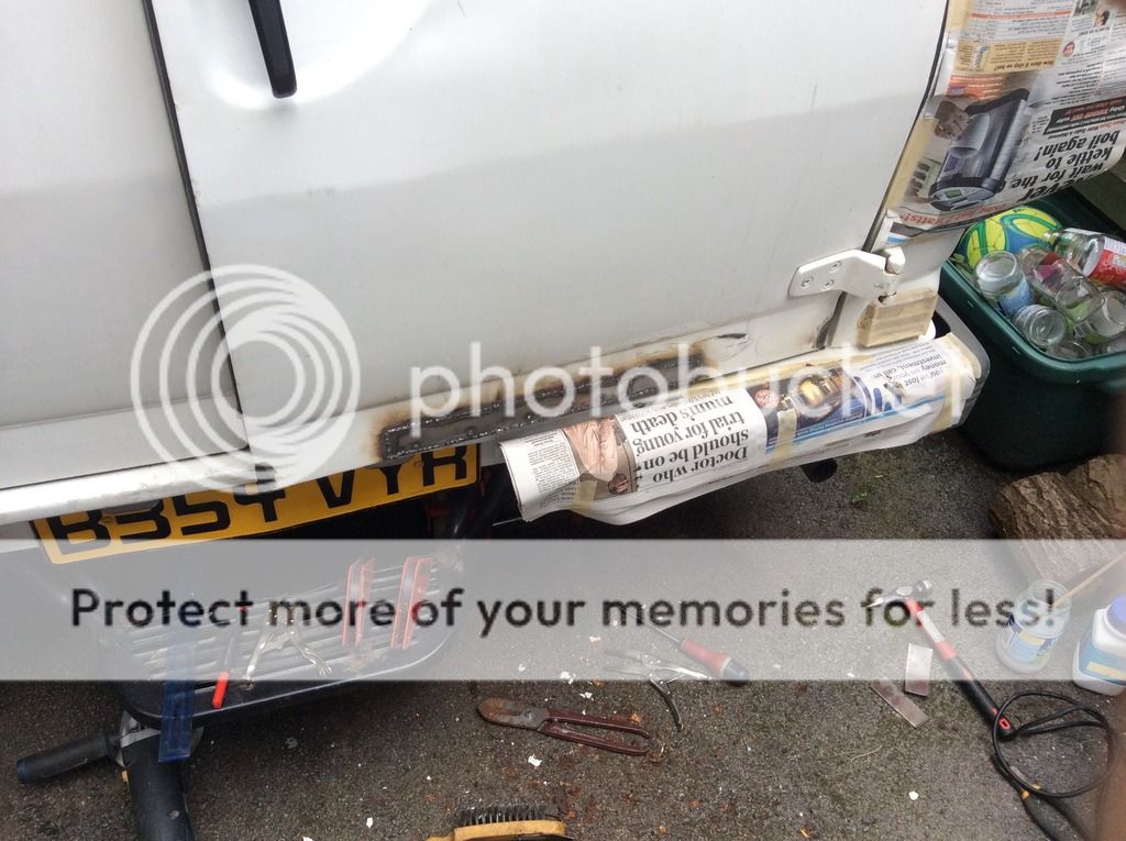

The door frame and bottom edge of the skin are ok so just had a good clean up with the grinder to get rid of the surface rust, then a coat of rust converter on top just to stop it coming back. then a small rectangular panel was made up and butt welded in using overlapping spots to keep the heat down and avoid distorting the door skin.
image.jpg5_zpsy2ccd3em.jpg​
Then cleaned back with the grinder to get a nice smooth panel.
image.jpg6_zpslhrtqipv.jpg​
image.jpg7_zpsczvpzdkv.jpg​

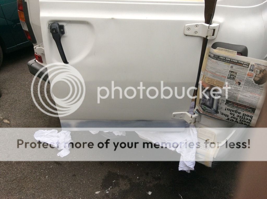

Finally for today, it was given a skim of filler, rubbed down with wet and dry and finally given a coat of primer.
image.jpg1_zpsz2o3kaur.jpg​
Not a bad little job, but took a bit longer than I thought, so ill have to finish rubbing down and painting tomorrow. Once that's all done the inside will be pumped full of Bilt Hamber Dynax S50 cavity wax so the rot never returns! Strangely this is the only rot I can find on the van, the other doors and lower panels all seem ok.
It has been Ziebarted from new, which will of helped it stay in good condition but it did cause a few small fires during welding!
And yes, that is a copy of the daily fail being used for masking and no its not mine! It was taken from a bin at work specifically for this job!

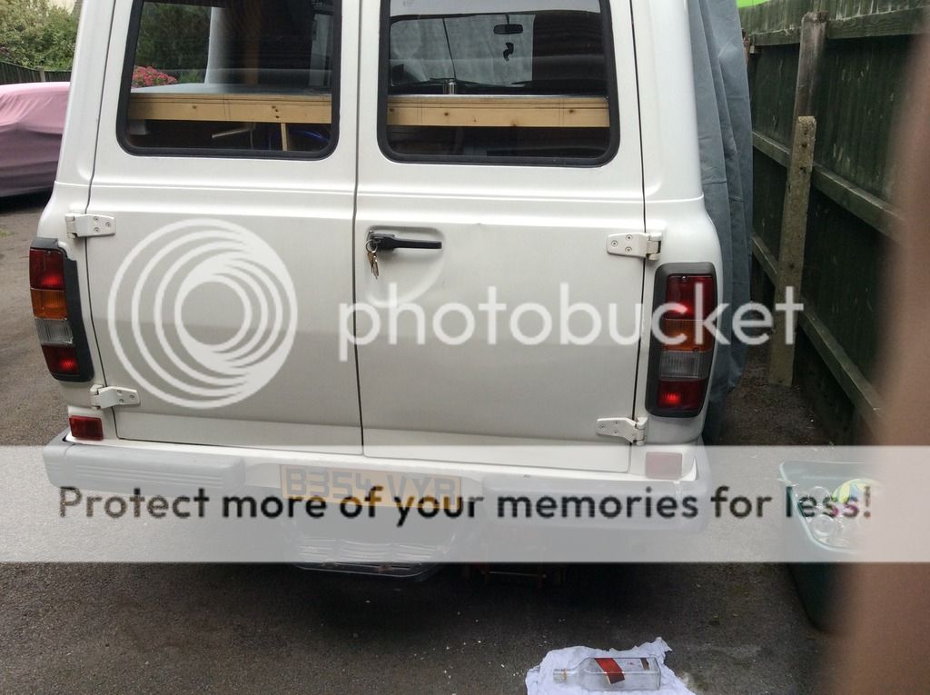

Finishing this off today.
Paint on, possibly still needs a few more coats as it's a bit thin and patchy in places but it's going on nicely and seems to match the old paint fairly well.
Also glued the door seal back in place with some contact glue. Then gave both rear doors a thorough blast of cavity wax. Just needs the 'Ford' badge putting back on once the paint goes hard.
