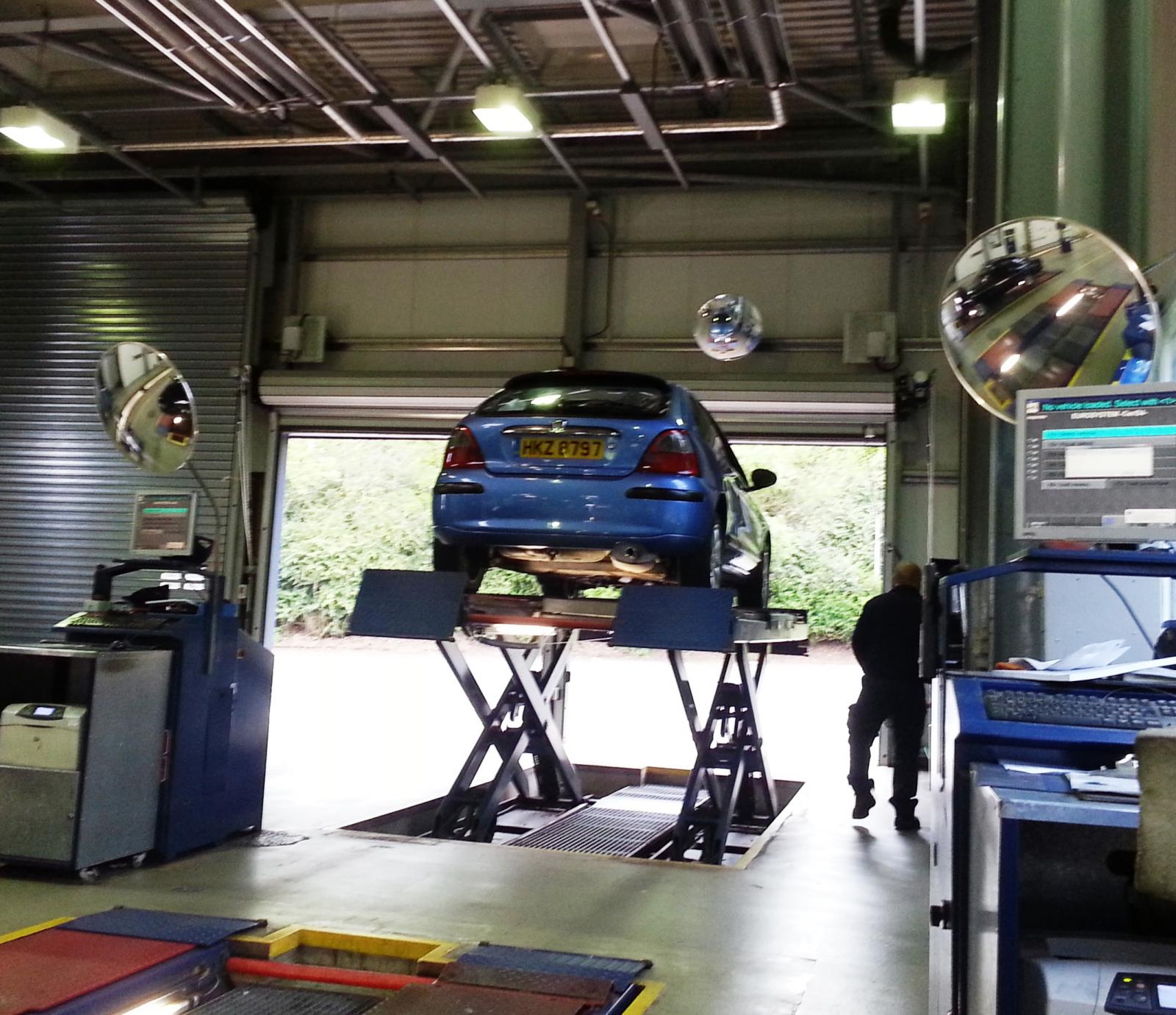

Ten MoT passes in a row. Also worth noting that from April this year, the MoT "Tax Discs" are no longer issued here in Northern Ireland. You just get a certificate.

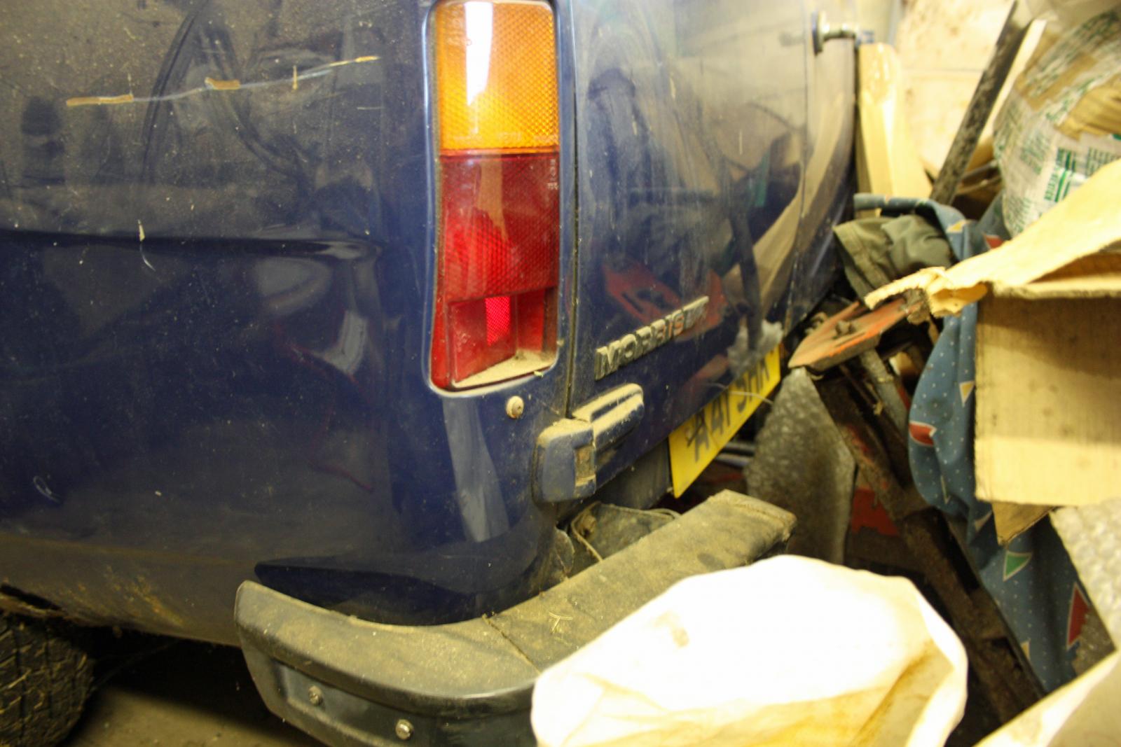

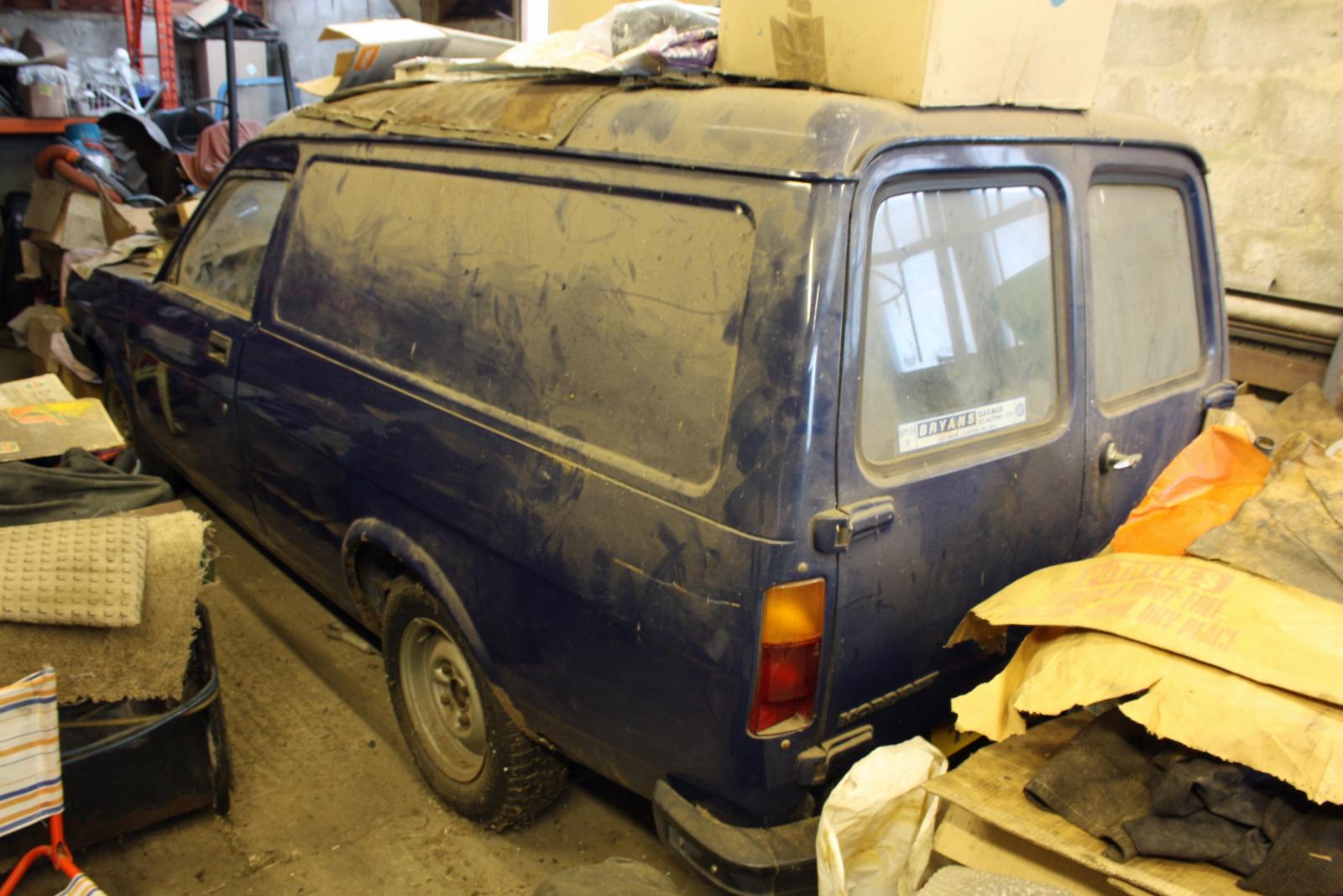

Remember my post last night in the grin thread about going to look at a Ital van?. Well I've just got back...

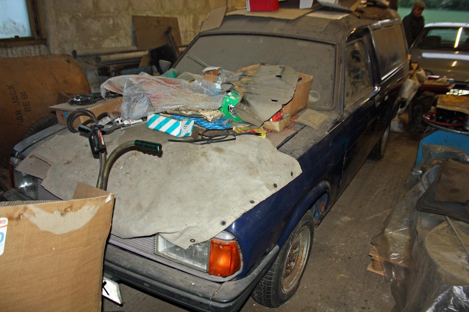

See, it exists! It belongs to the same chap with the Orion i posted the other day, His brother bought it back in 1994 with plans to sell the number plate for loads of money, The chap i know was kindly given the job of getting a mot on it but that's as far as it got, It had a plate welded to the passenger floor, it got driven into the barn and sat there since.

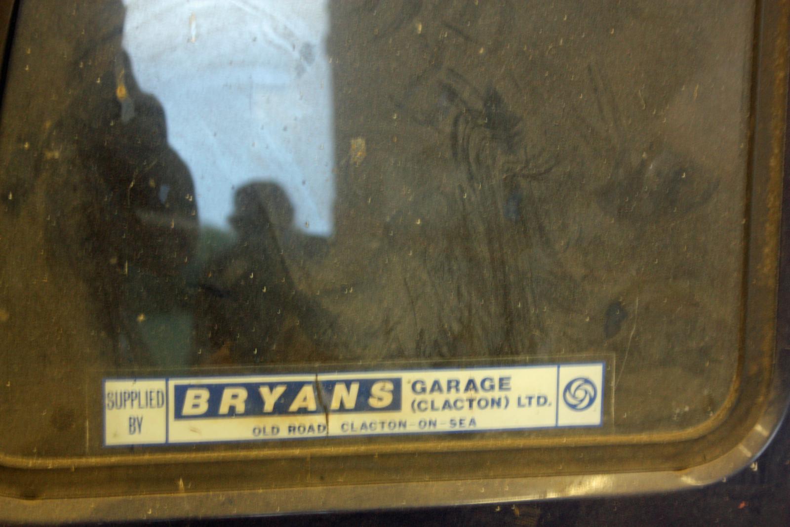

He now needs to get shot of it, it's a 1 previous owner who was a plumber in Clacton, some of there gear is still in the back, it's done 41000 miles but hasn't ran for at least 12 years. There's a new exhaust inside, the front wing is rust along the rear edge and there's a hole in the rear wheel arch. He's told me they are after £400 for it, Is that about right or too much?. I haven't a clue?
It still has it's dealer plates and sticker.

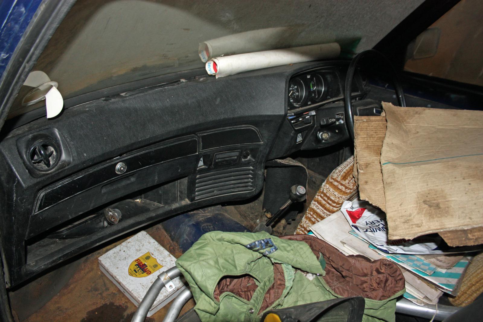

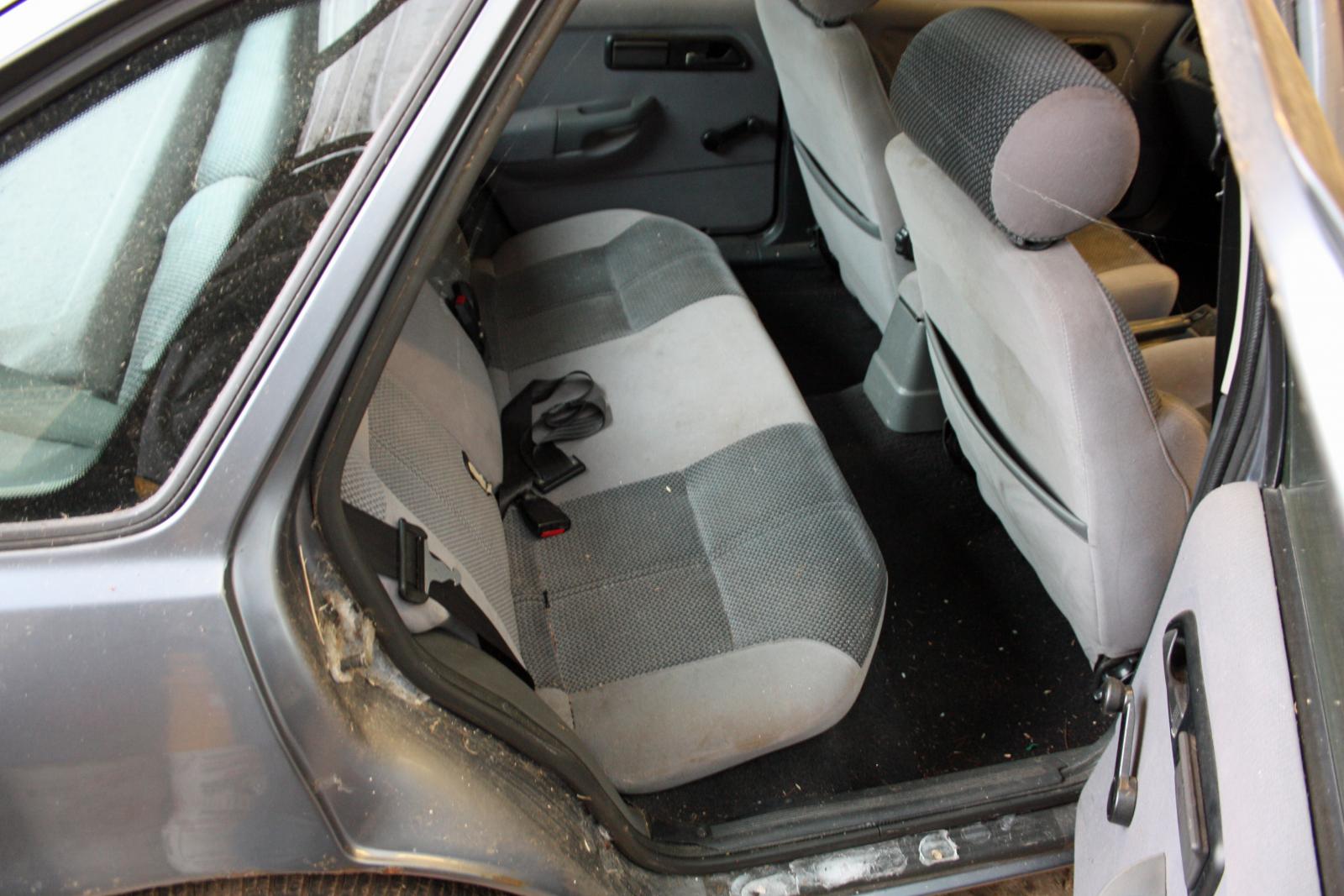

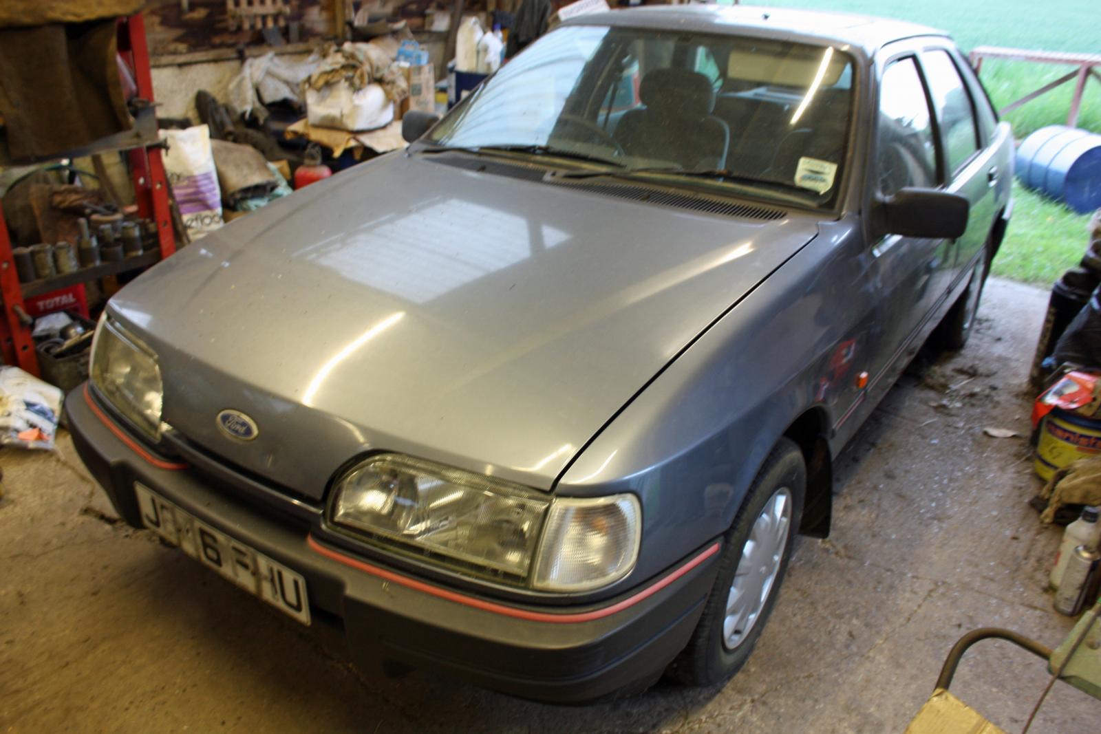

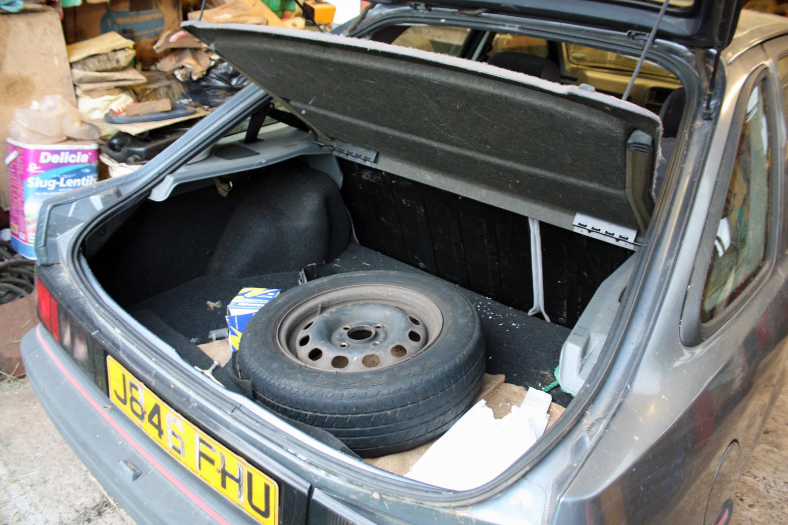

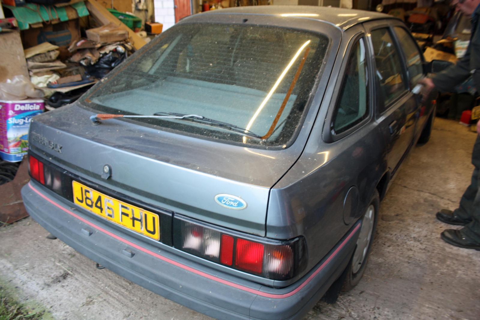

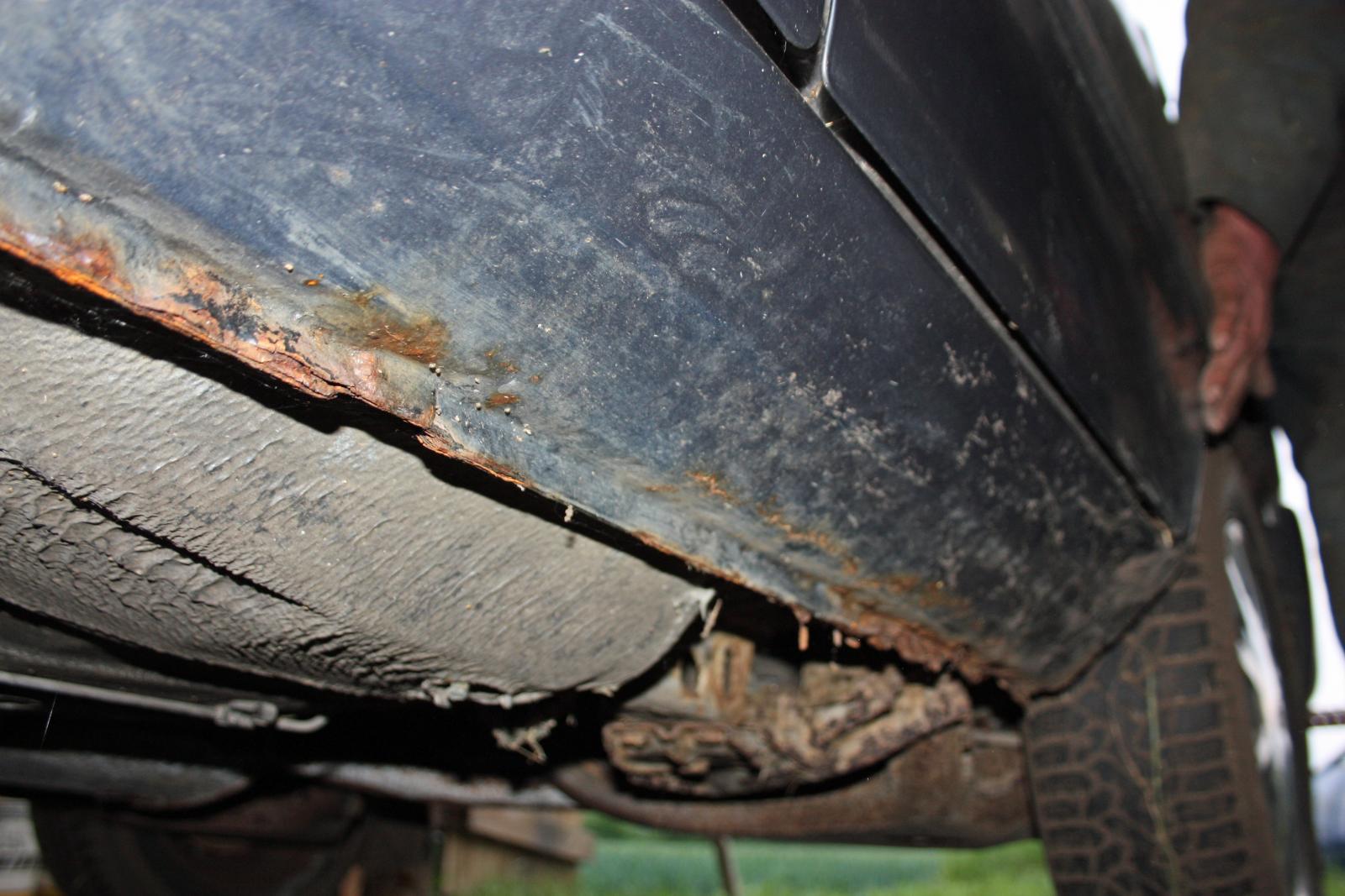

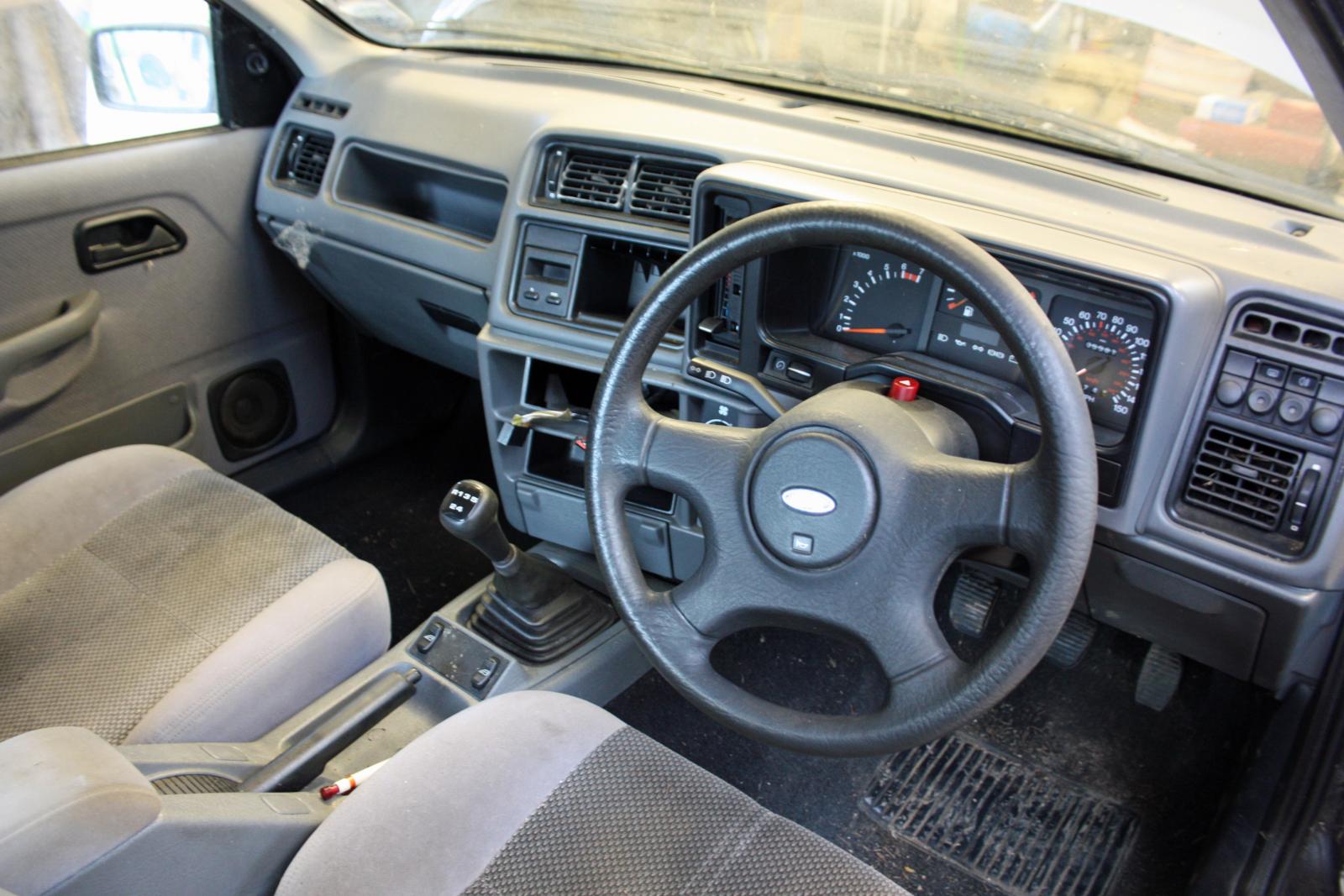

I'm also probably having this. It was parked in the barn in 2006 after they didn't need it anymore, 105k on the clock, It's actually quite tidy other than one scabby rear arch and both rears of the sills probably need patching.
It started and ran quite nicely but it will need 4 tyres and a good service and the handbrake doesn't work, The radio is in the glovebox. I've been offered it for £250 and he'll deliver it to my dads in the price if i want it, the box along is worth £200 so It's probably worth the gamble.
£400 for an Ital van that hasn't run for years, I've no idea what it's worth, but try and find another for sale.

£400 for an Ital van that hasn't run for years, I've no idea what it's worth.
That's what I'm thinking, and i can't weld which I'm sure it will need plenty off, £400 isn't a lot of money though in the great scheme of things, What's it worth witha  mot, £1200?.

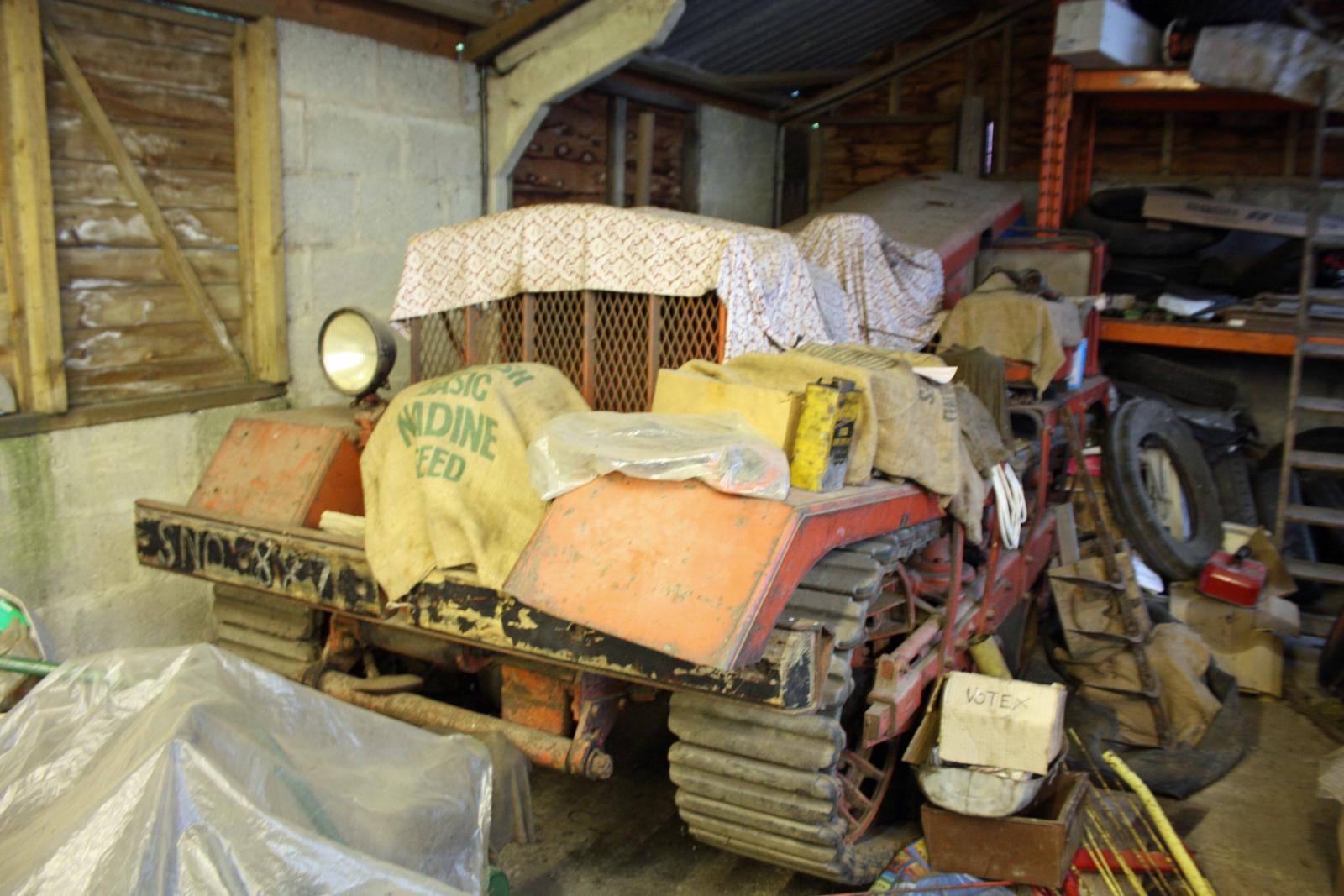

I forgot to say, this also lives in the corner of the lock up, I can't remember what it's called, a ceetrak or something from 1946, it would have been in camouflage colours and was used for towing aircrafts up and down the runways. It's sat in that corner at least 25 years now.
^ looks very original trig! Bristol reg IIRC. At this rate you won't be far off having a full house of ford family motahs!

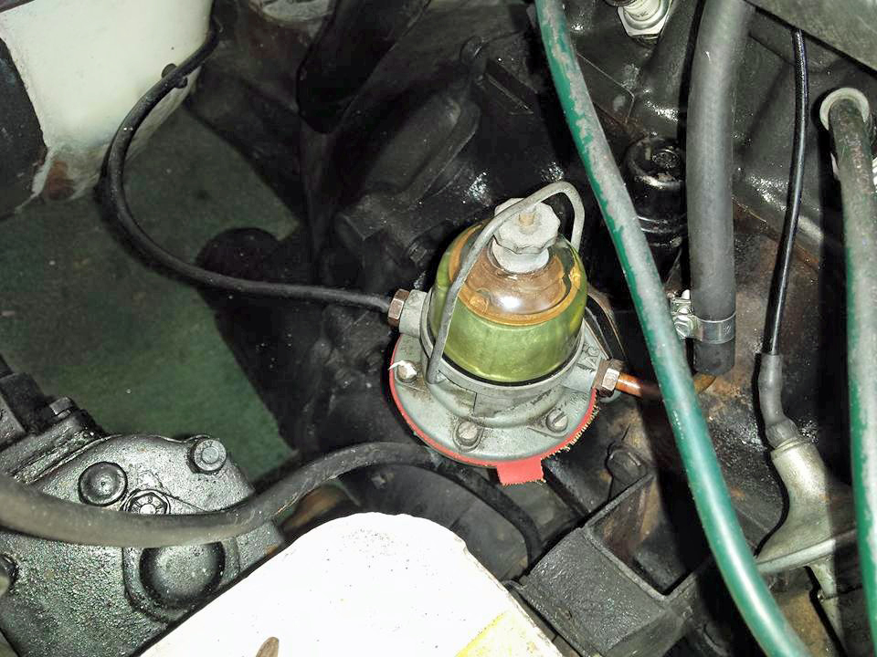

This is the outlet end of the fuel pipe from my pump on the Mk1, I've changed the pump and now is leaking, I'm guessing that the olive is crushed and needs replacing, The trouble is I'm struggle to find a new olive and nut, the pipe is 5mm which works out as 5/16 in old money.
Now I've found this set up on ebay, http://www.ebay.co.uk/itm/5-16-Petrol-Pipe-Nut-x-20-UNF-Carburettor-Fuel-Pump-petrol-Tank-With-1-Olive-/150858578541?pt=LH_DefaultDomain_3&hash=item231fdf3a6dwhich i think is right, can anyone confirm please?. Also how do i fit the olive, does it need to be soldered on to the pipe, if so how do i do that? or can it be crushed on when i do the nut up?

Looks like a crush olive. Just do it up (careful now) and it should crush down on the pipe.
A bodge method to get you out of the shit is to wrap a couple of turns of PTFE tape fully around the crushed on but leaking olive then carefully stuff pipe back in and do up. Not a permanent fix but would see you right for a while.
Edit: I just realised its a olive onto a steel pipe. Sometimes they can be a bastard to seal/crush straight to get a leak free seal. Sometimes if you've a spare fitting (unlikely, I know) it's sometimes better to crush the olive nice and straight on the spare fitting, say in a vice, before fitting. (Sorry for the surplus of sometimes - I'm no writer)
A few people have said about PTFE tape but I was under the impression that petrol would make it go like jelly and clog up the pipe work? Cheers for that, my dad said I had to solder it up but the old one isn't soldered so I did wonder if it just crushes together.
Olives are designed to be crushed, Trig. That's how they work on domestic plumbing, for example. Indeed, that's how they form a seal. Back in the old days, when I wasn't senile, my Uncle and I used to use Aeroquip hoses all over rallycross car's brake systems. Crush olives have a higher "Burst pressure". Soldering it on won't seal it. However, if you're going to nip it up to a 50 year old carburetter, you might break something.

The trick with PTFE is, is to just use enough to cover the olive and not get anywhere near the bore of the pipe. That way it does the sealing without interfering with fuel flow.
SauceDoctor, you are completely right. On plumbing, however, the copper pipe "gives" a little under the crushing of the olive, somehow helping and contributing the sealing process. Steel pipes don't crush and solely rely on the olive to do the sealing.
Trig get that van bought for that price, also that sierra is a bargain so get that as well
Trigger.
first - the ital is a bargain and even if all you do is buy it clean it up and sell it straight on I'd be surprised if you don't get into 4 figures. Any commercial is worth good money. If you're not interested I could pass the word around.
Regards the cortina fuel pump. Where is the pipe that fastens on the end?
They had 2 set ups, one was a solid pipe right the way up to the carb and the other was I rigid plastic pipe fastened to the ends you show.
personally I'd forget about a diy attempt to this. I've had this issue loads of times as same set up as anglia. Check that the fuel pump is not split. Many times the pipe gets overtigtend and the pump splits. Other than that just a wrap of ptfe will do. Done it loads of times.
Or try and find a used pipe. (I might have one but will need to rummage) I want the ital :-) lol
Well, what happened is the old pump was a bit weak and whilst at an autojumble last weekend i found an original AC Delco glass pump for £1, Whilst trying it on (and finding it didn't work) i refitted the old one and this join started leaking so i nipped it a bit more and cracked the casing on the old pump instead. :(.
Lesson learned there, meanwhile i bought a rebuild kit for this glass pump and fitted it.
but now the outlet join weeps when it runs, I've ordered that olive and nut set above and will fit that once it's here, hopefully that will cure it. As for the pipe it's a rubber one which we've fitted (The old rubber one was perished) with a couple of fuel filters in.
Trig...that fuel pipe looks like a barrel olive rather than an ordinary one. If the pipe nut goes right up to the part you are screwing it into chances are it won't seal......

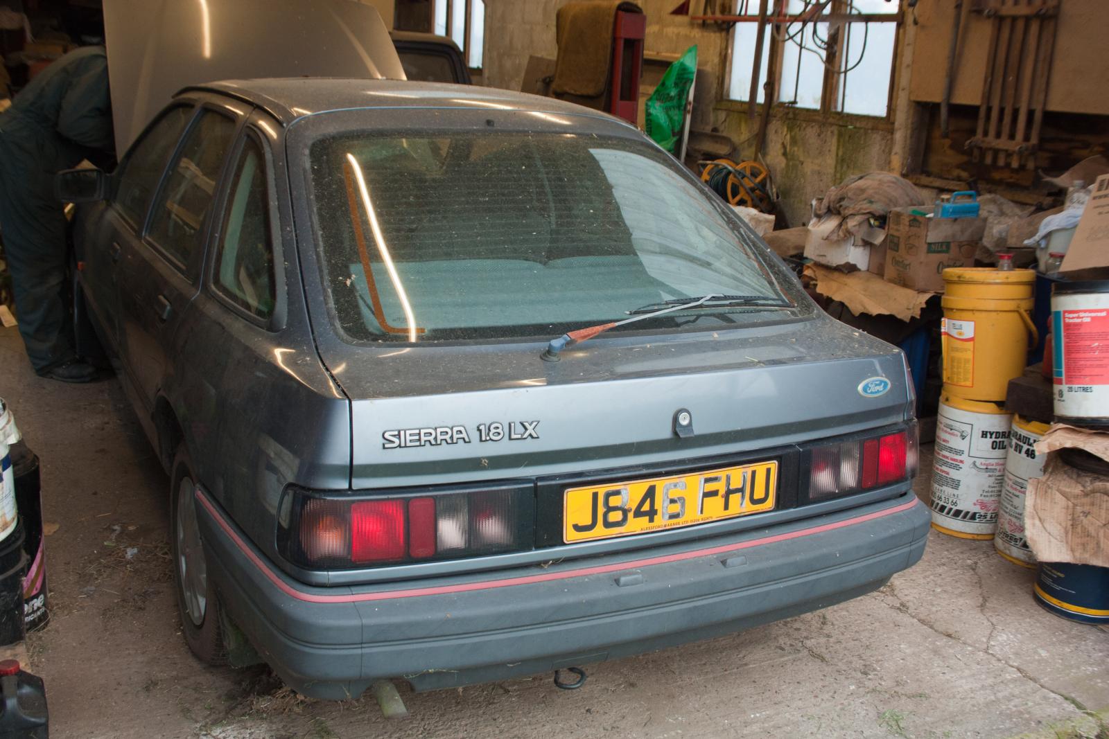

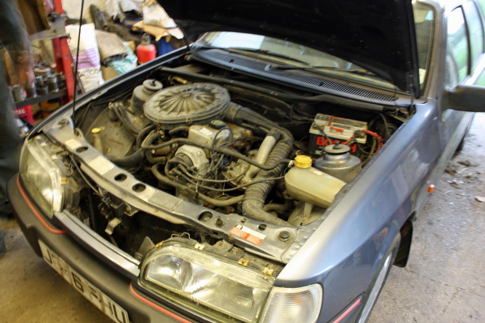

I've agreed to buy the Sierra for £250, delivered. The Ital might take a little longer as the seller is quipping about the "valuable" number plate now.

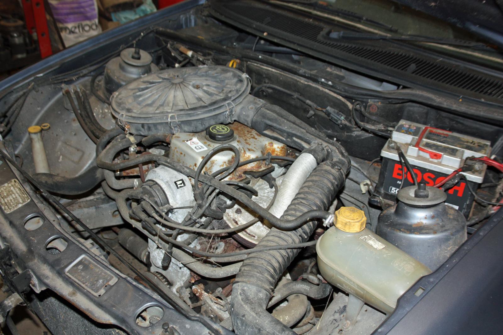

Does a weber 32/36 fit a CVH Sierra without much modification? The old Pierburg one currently fitted is temperamental and was one of the reasons it got parked up.
