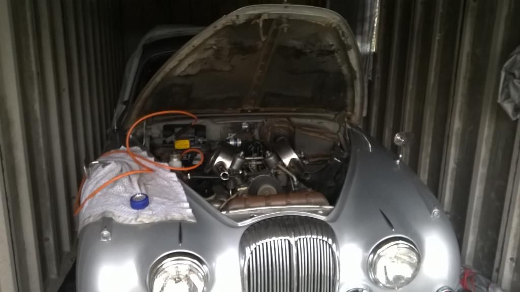

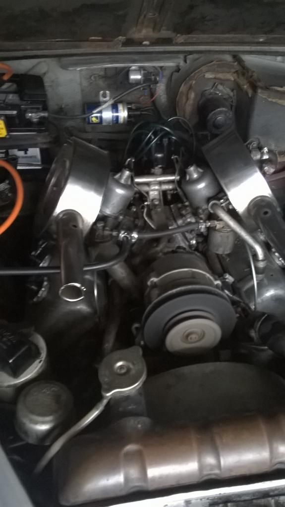

This morning was spent fitting the new battery to the Daimler.
Battery in place connecting the battery leads,the earth lead snaps at the terminal.Jump lead required.
Due to work,operations and holidays it was the first time started since since around Feb this year.Starter sticking but rocked free then it fired up,2nd or 3rd try.
Very pleased.I'll order a new earth lead then MOT time.
