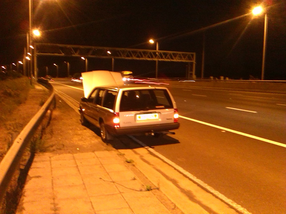

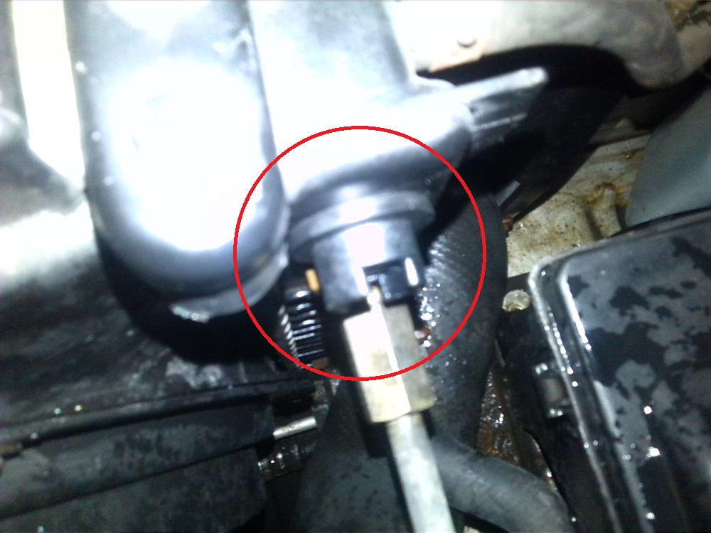

Driving home from Cambridge in The Wentworth late last night, I got stuck in a traffic jam on the M11 for almost an hour due to some numpty roadtard in a Zafira hitting the central reservation. Not long afterwards, when I joined the M25, the car's temperature gauge went almost into the red zone, resulting in this:
While I waited an hour for the AA contractor to rescue me, I ascertained that a blanking plug on the car's radiator had popped out, leading to most of the coolant escaping:
Luckily, said plug was prevented from being lost on the road by the car's engine under-tray, which enabled it to be rescued and refitted with a bit of PTFE tape; after refilling the cooling system with water at a garage and leaving the car to idle for a bit, I drove it back to Southend from Brentwood with no problems at all - old Volvos are hard to kill :)
I'll be replacing the coolant at some point this week, as the cooling system contains about 95% plain water now...
EDIT (15:30): Just checked the car and it seems none the worse for its ordeal. Just as well that I saw the temperature gauge rising and managed to stop in a timely manner :)

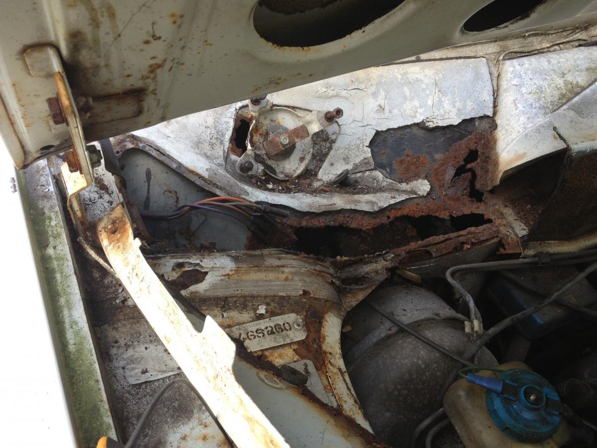

504 estate rot repairs-
been sectioning and removing bits of bulkhead to get at the worst of the rot. Its suprises me the interior wasn't more mouldy when I got it considering the gaping holes the water could get through!post-4673-0-17378200-1403555457_thumb.jpg

The rust on your 504 would see me searching for the telephone number of the local scrapyard if I unearthed it on one of my Volvos! :shock:

To be fair it's no worse than the bulk head of most 80's fords.
