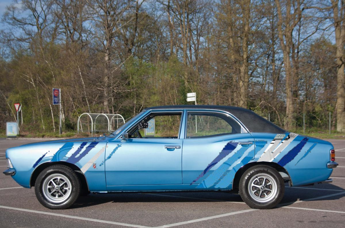

Trig; don't worry, I've got the stripes thing sorted for you!

Trig I think pinstripes spoil the coke bottle shape, it looks gorgeous without the stripe, I am literally salivating at the pictures of it and my wantometer is in the red
