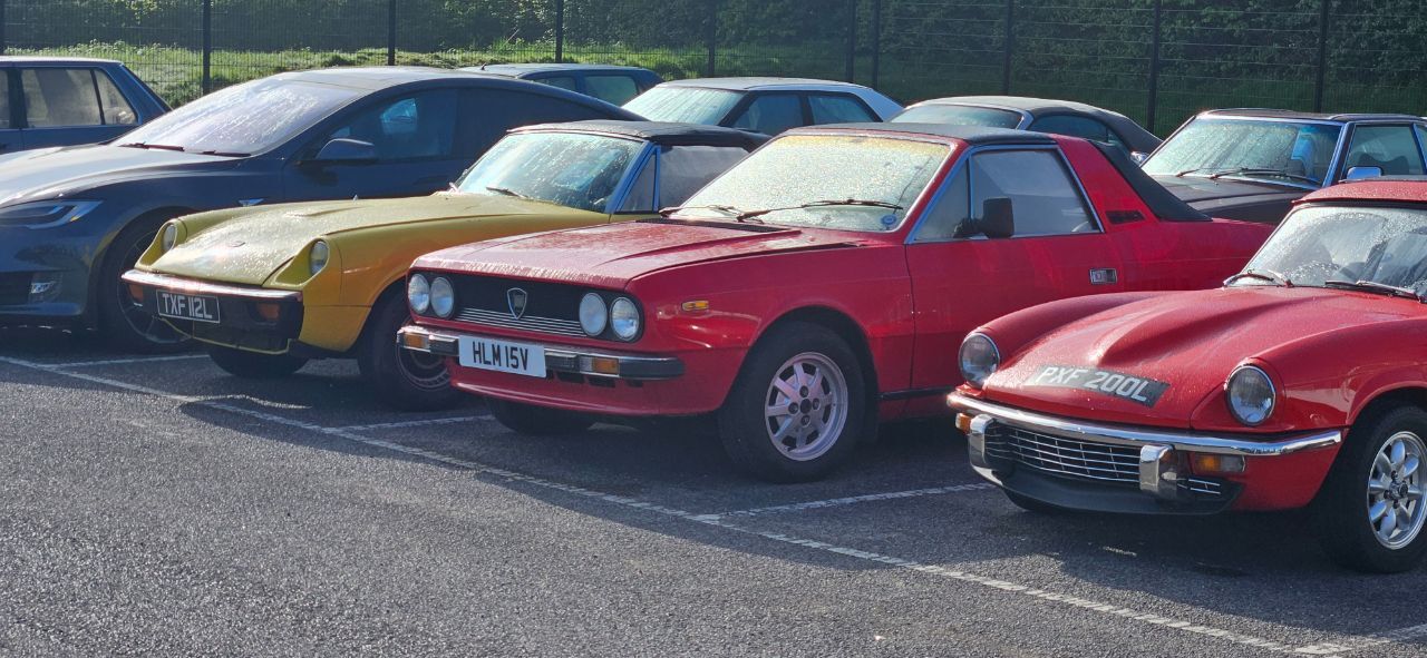

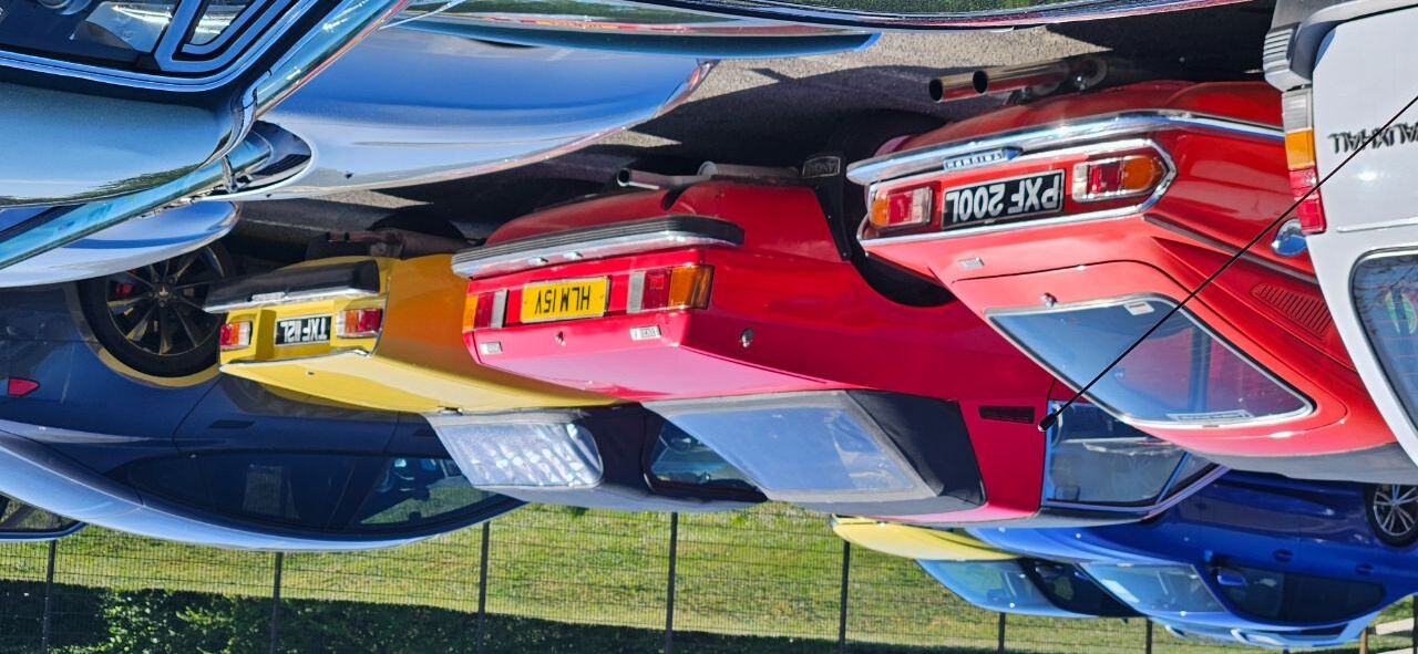

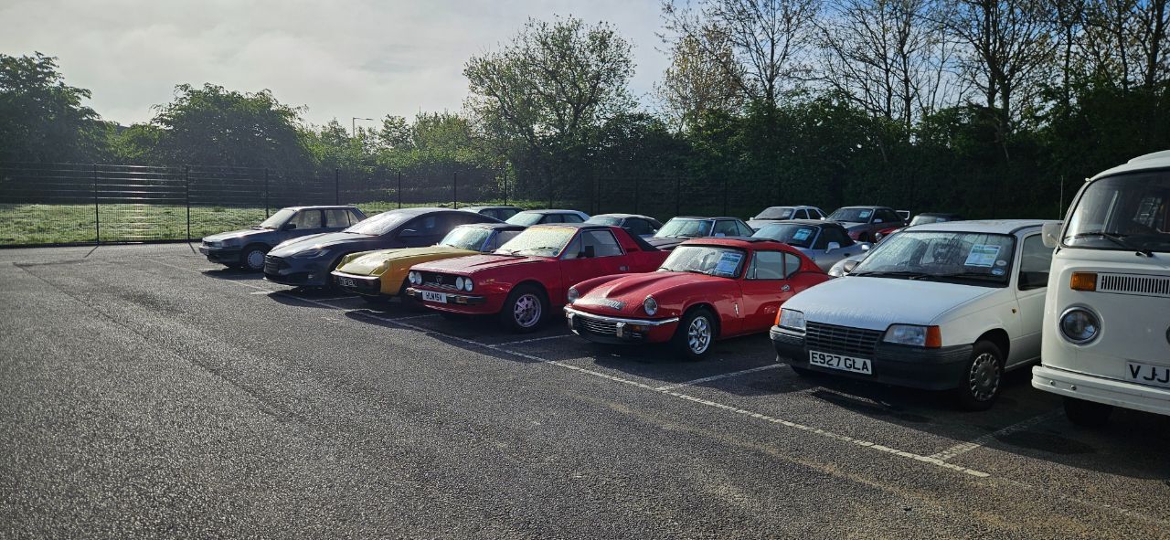

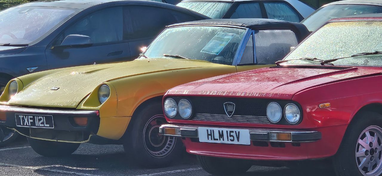

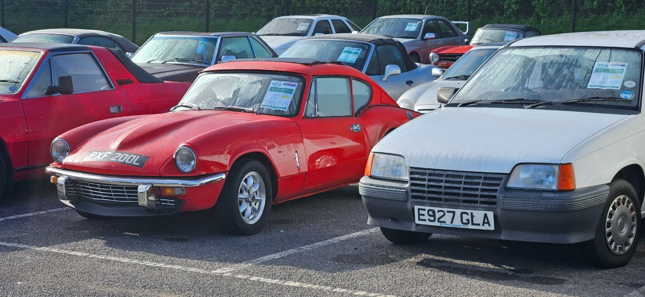

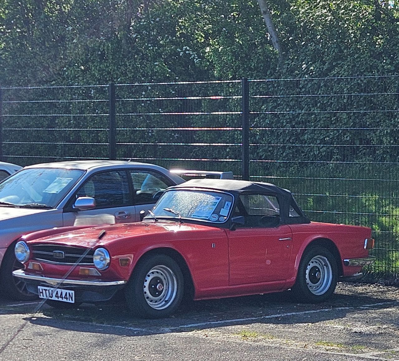

Forgot to post, spotted these 'gems' awaiting at the car auctions where they hold the boot fair.
