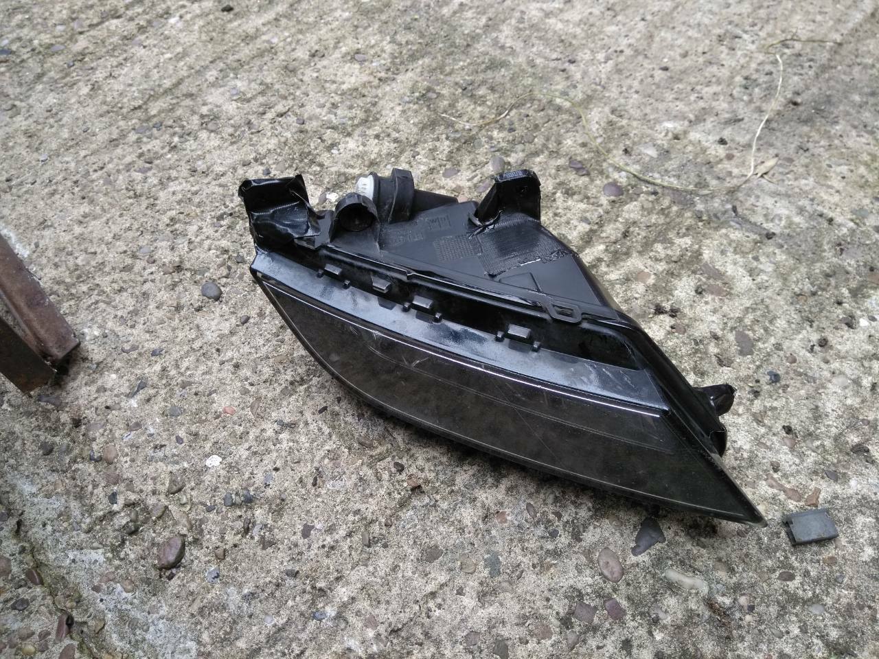

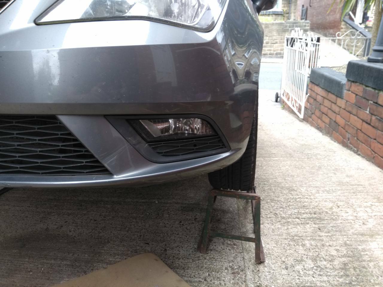

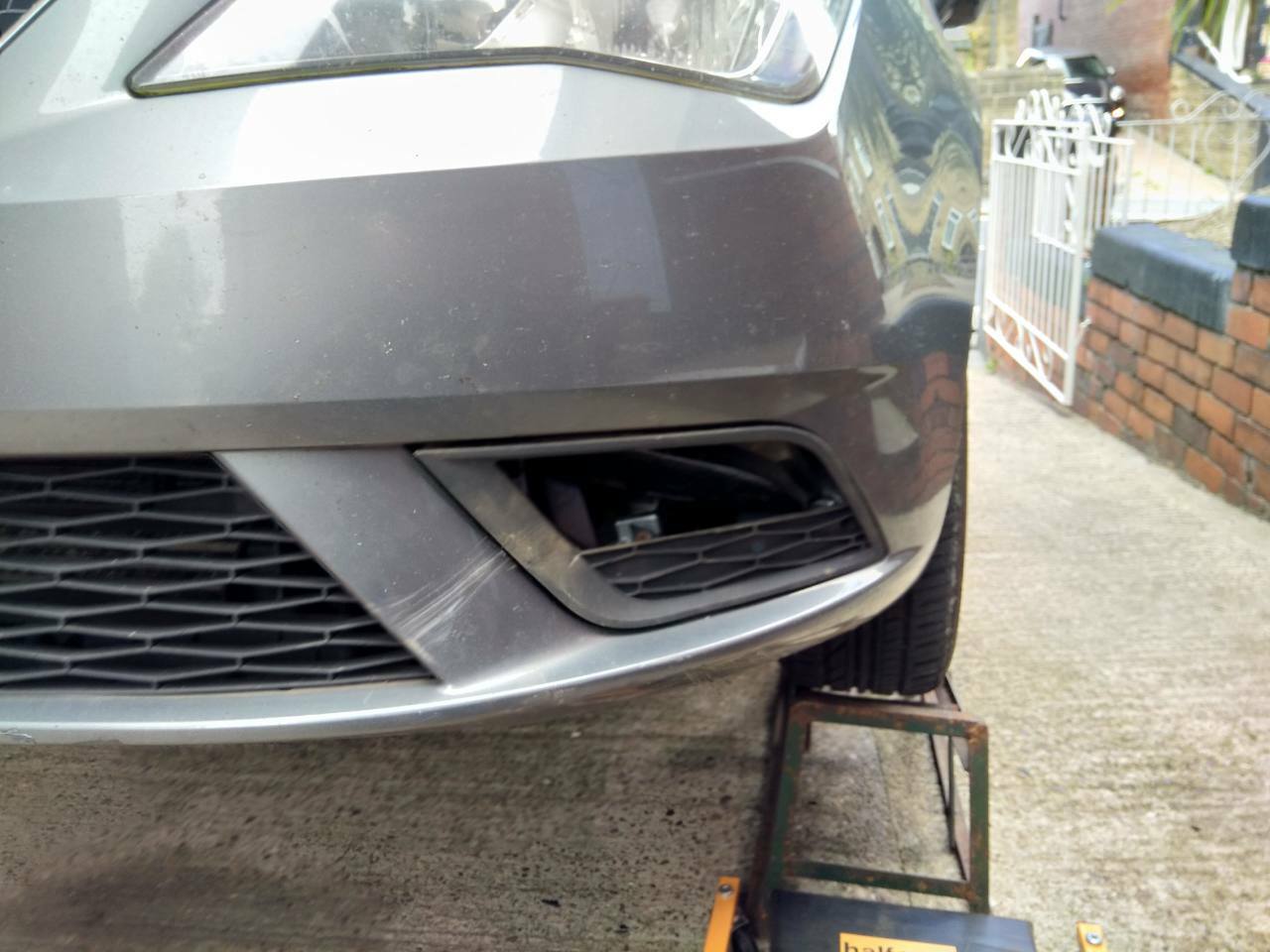

Who the fook left that bfo bit of a tree hidden in the undergrowth where I was turning the car?
Fortunately it just* pushed the fog light upwards, and bust all the brackets.
Oh well, super glue and gaffa tape to the rescue.
Nobody will ever notice.

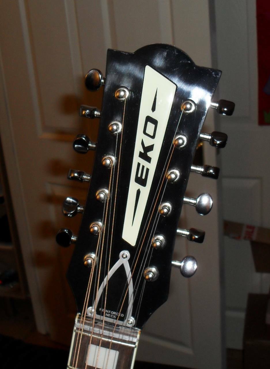

/ Yup, it's actually spelt Ekco, looks like a type CR32.
Spelling "Ekco" comes from "E.K. Cole and company" They did all sorts of domestic electrical stuff, radios, tvs, etc. I think they did vacuum cleaners as well ?
Correct, also not to be confused with the instrument maker Eko.
All of course pronounced exactly the same.

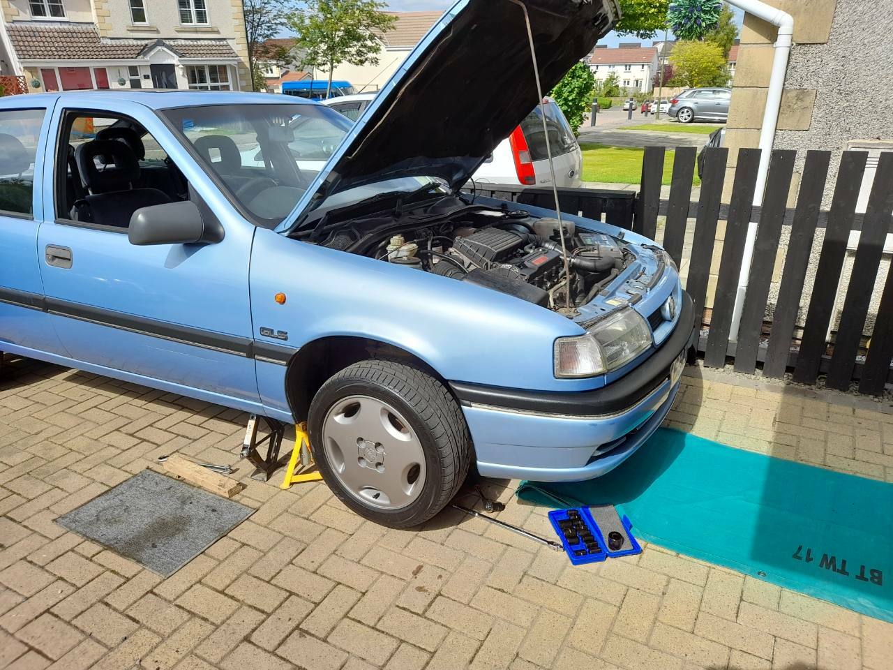

Cavalier oil change disaster.
First it didn't like the Pela so I drained it the traditional way.
The oil filter was an utter bastard to get off, it was FFFFT.
Next, the filter Opie oils sent me was completely wrong, it doesnt even fit on the thread.
The old filter is not reusable as its a bit mullered now.
I've screwed it back on and filled with fresh oil at least.
The worst part is that NOWHERE sells the right filter. Fuck!!

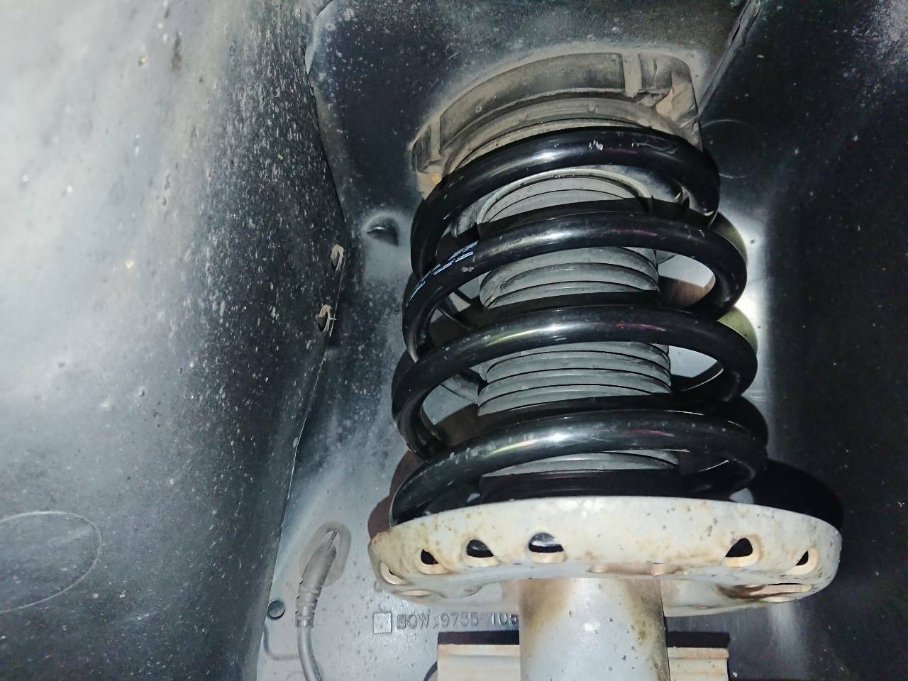

Firstly, got my car back from engine replacement and they'd forgot to put my locking wheel nut in the car. That's fine, not normally a major biggy, but I've taken a day off work to change the springs and fit some brake pads ready to go away and the garage that did it is 80 miles away and I've only just realised when I've come to take the wheels off.
So spent the first half of the day fashioning a 10mm socket to fit. The first one broke. The second one broke the adapter so had to find a 1/2 inch one that I could spare. That managed to get 3 wheels off, but the 4th had been torqued up so ridiculously that it wouldn't go, even with a breaker bar. So had to resort to a dremel and carefully taking off the sleeve and then using an Irwin socket to remove. I've thrown them all away anyway - I had another set already.
Once I'd done that, the 17 year old rear suspension decided that it really didn't want to come off. Rusty as a ginger man's bollocks, the casing was falling to bits. So having got me where I was going, I'm now going to have to take the whole rear apart again and put 2 new replacements in. Also, whilst changing the pads, the front discs were absolutely rotten. Literally bits of rust coming off in my hand.
So now I have another dozen jobs to do. Replace rear suspension, top mounts and drop links (I got one side out, but the other didn't want to move). Replaced the front discs, but then that took 10x longer than it should, because (I estimated using my trusty torque wrench) that the callipers had been tightened to 130 lb/ft and clearly, it's awkward trying to get a breaker bar in. WTF.

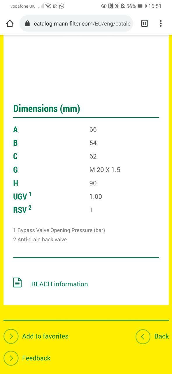

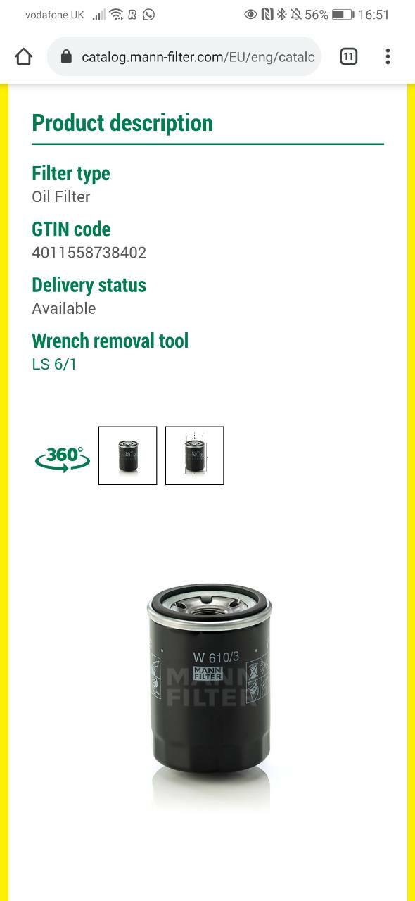

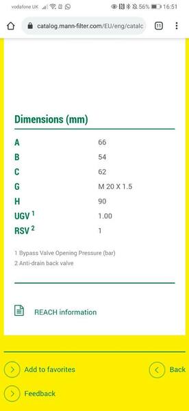

Just now, Split_Pin said:
No that's for a completely different engine.
Thisnis mine
According to the Mann Part catalog, which I find really good it's a w610/3.
You should be able to find an equivalent part for that for others.
https://m.autodoc.co.uk/car-parts/oil-filter-10359/vauxhall/cavalier/cavalier-mk-iii-hatchback/8657-1-7-td
Pull the part number for common brands, and go into your local factors? They're not exclusive to the Cav they'll be for loads of other cars.

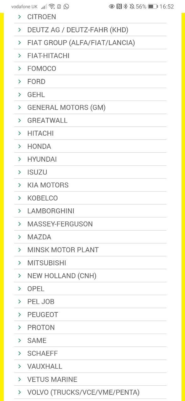

My Local ECP has the right Mahle & Bosch filters?
Cheers man, seen all those and they're the same ones that are too small.
Panicking a bit now like, I mean how the fuck can a Vauxhall have a completely unobtainable oil filter????

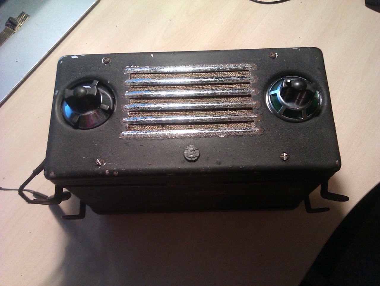

Finally got around to connecting power to it tonight.  It buzzes, which probably means the vibrator is vibrating like it should, and the buzzing gets quieter after a few minutes.  I can see one of the valves glowing when I look through the case vent too.  No smoke, no horrible smells, no excessive heat so that's probably a good sign.  I'll retest it with the case off so I can actually see what's going on inside.  Nothing from the selector light, and not able to pick up any static or stations (no surprise there, no aerial attached for a start).  I just wanted to see if it would power up and do something, which it does, so it's probably repairable since the general consensus seems to be these are pretty crude old things and easy to work on.

52 minutes ago, Zelandeth said:
and for those curious here is a good writeup that explains the origins of the company :)
http://www.lamptech.co.uk/Documents/Factory - UK - Southend.htm

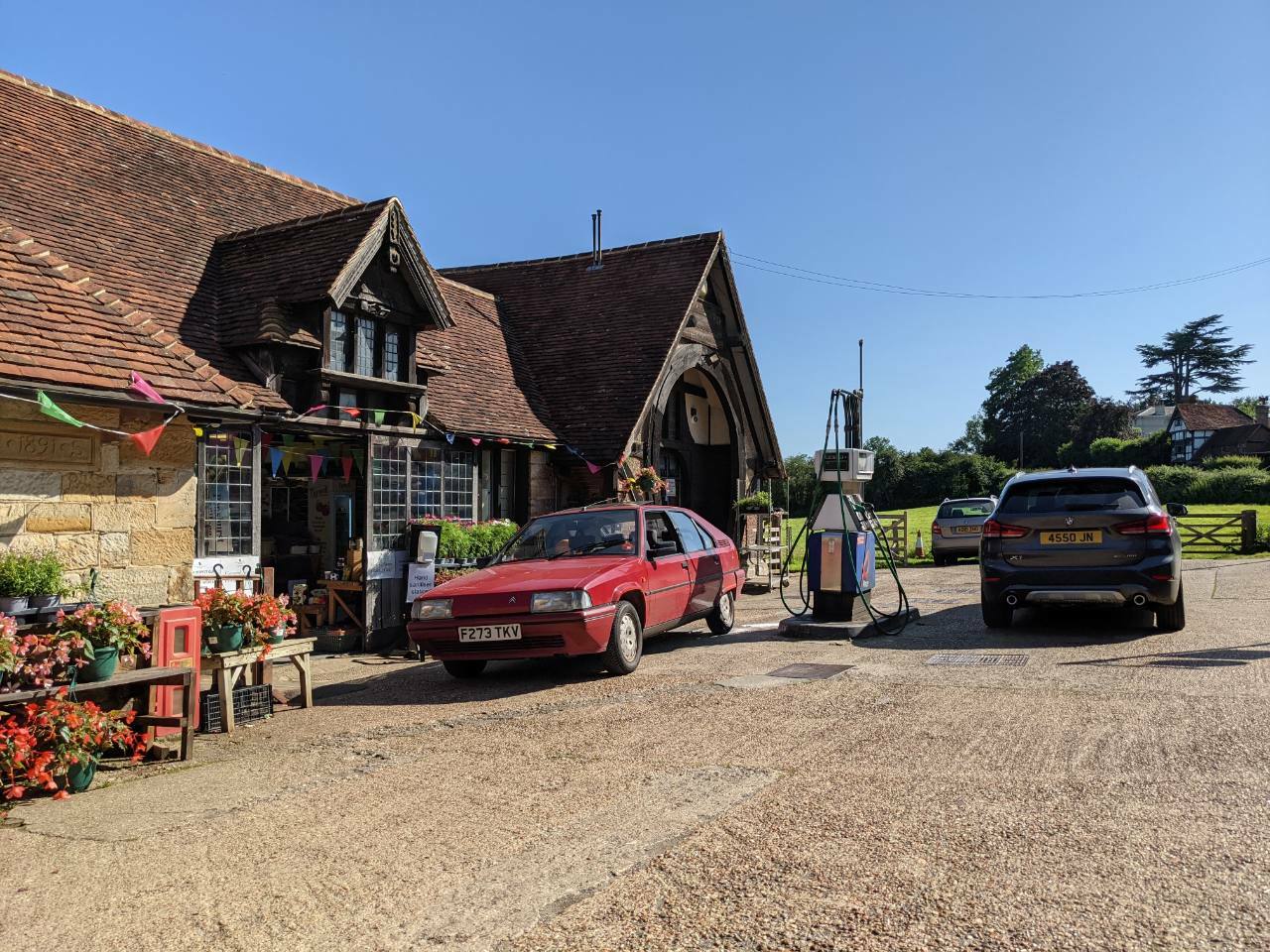

Went to Forge Garage in Penshurst, Kent.
Old pump, unsure how old the petrol was but it smelled fine 😅
PXL_20210716_154912258_MP.thumb.jpg.1c0da79f5d4e0257986a80e8f08f7d86.jpgPXL_20210716_154936140.thumb.jpg.cfcc488ec2792486ad1f2d452f7a2dcd.jpg
Really lovely part of the world.

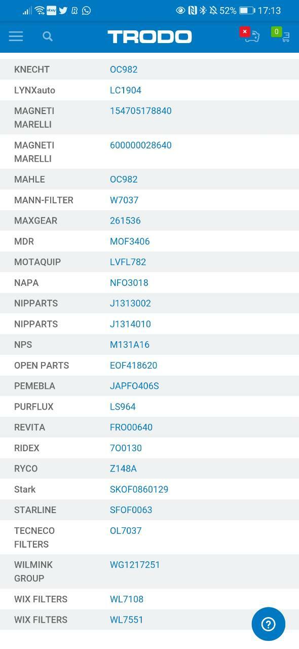

Well the one that came off seems to be a Napa3018
Allegedly these are alternatives to that.
Super, cheers chap, I'll go into ECP tomorrow and give them the entire list, surely they'll have something.
