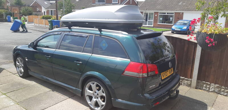

Road trip tomorrow. Dawlish Warren for two weeks. Pasties and local ale.
