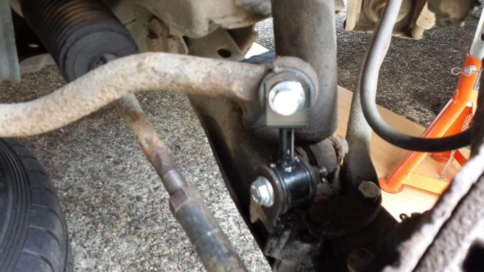

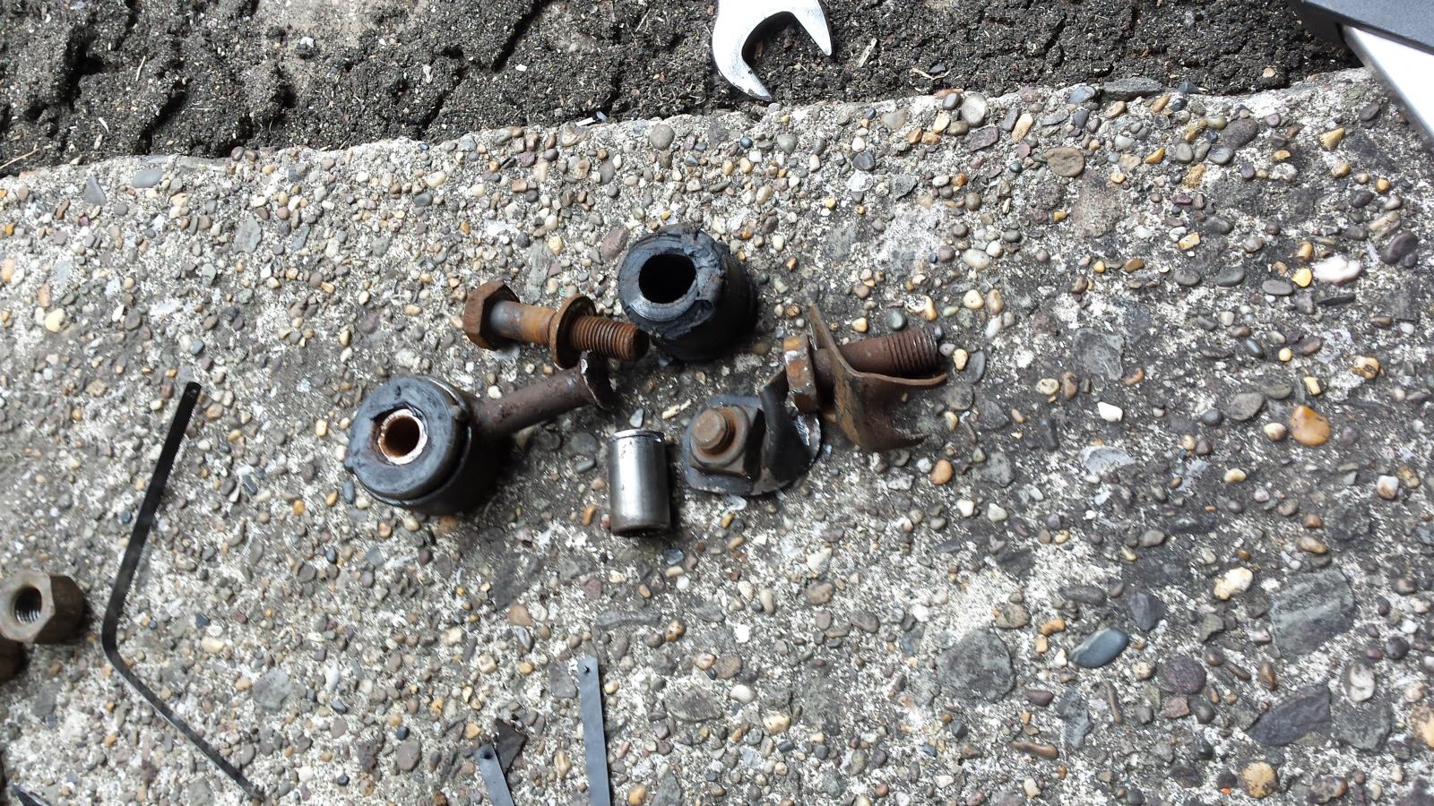

Anyway, as I had a day off work today I decided to get a couple of van jobs done.  The snapped drop-link was priority number one, the weather was reasonable and I had the whole day, they were only fitted a year or so ago so should be a nice, easy job, right?  Meh, just for once I'd like that to be true!  The broken one on the passenger side did come out fairly easily, in bits:
The only issue I had here really was the new tyres seem to give the van just a half inch more ground clearance, it was already a struggle for my Halfords jack to reach the chassis rails, even with a big sturdy piece of wood bridging the gap, and I was a few mm shy of the axle stands lifting the wheel completely off the ground so had to resort to putting wood underneath them, not something I particularly wanted to do but it seemed to work and nobody died.
I remember when I fitted the old drop links that neither was particularly well made, the one on the passenger side in particular was a complete bastard to get aligned with the anti roll bar, it took ages and a lot of washing up liquid and bad words to force it into place and this probably hasn't helped its demise.  The new one was much better and took very little time to get in place.
I thought I'd better do the pair and moved over to the driver's side - it's a good thing I did decide to change both, it was almost on the point of snapping as well and after a few minutes of fighting with the spanners it did break, in exactly the same place.  At that point, it all went downhill as the bolt holding it to the antiroll bar was seized solid and no amount of Plusgas, talking to it or brute force made the slightest bit of difference.
In the end, I resorted to spending 40 minutes lying underneath the van at a strange angle with a hacksaw looped around the track rod end and cutting through the bolt.  It put up quite a fight but I wasn't about to be defeated.
Again, the new one went in much more easily.  Success!

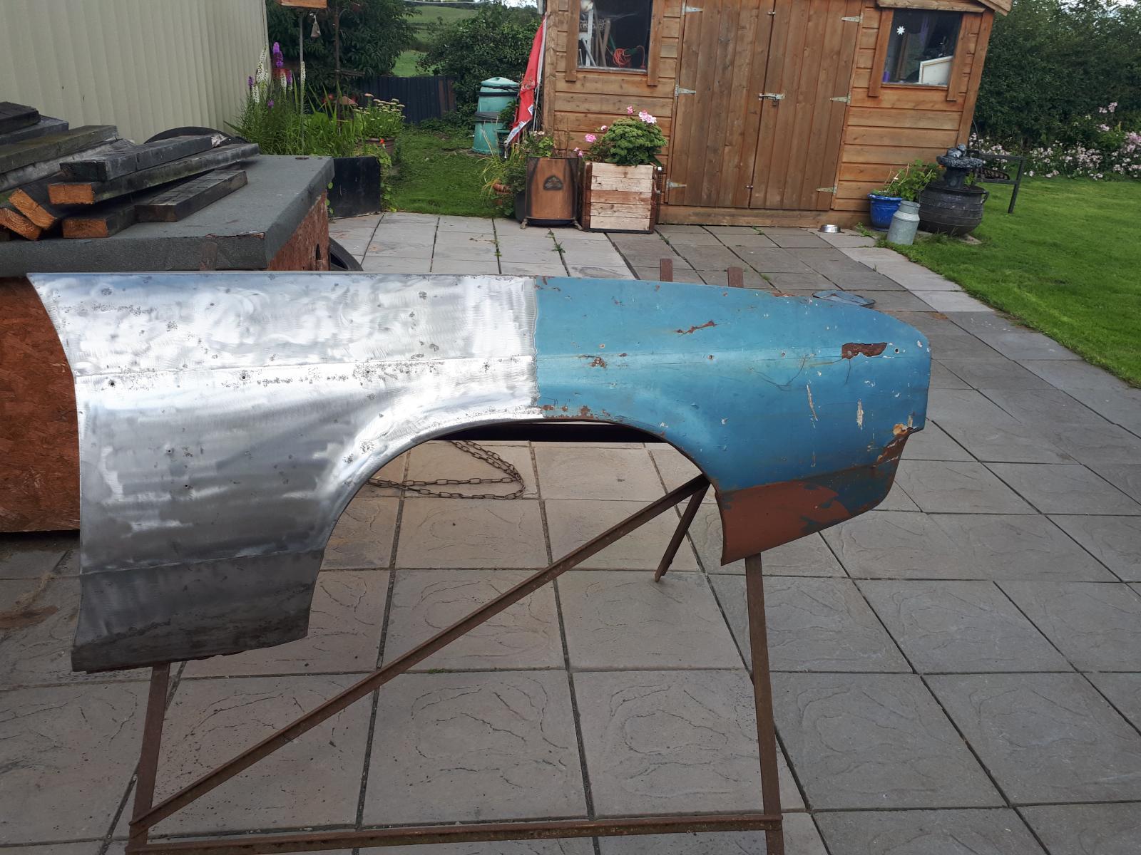

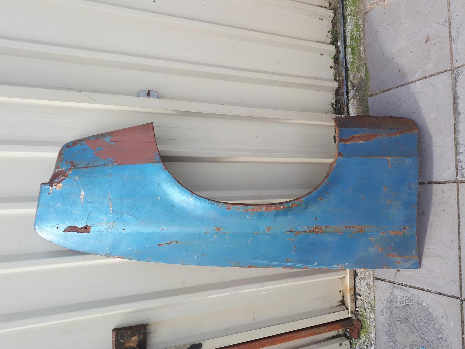

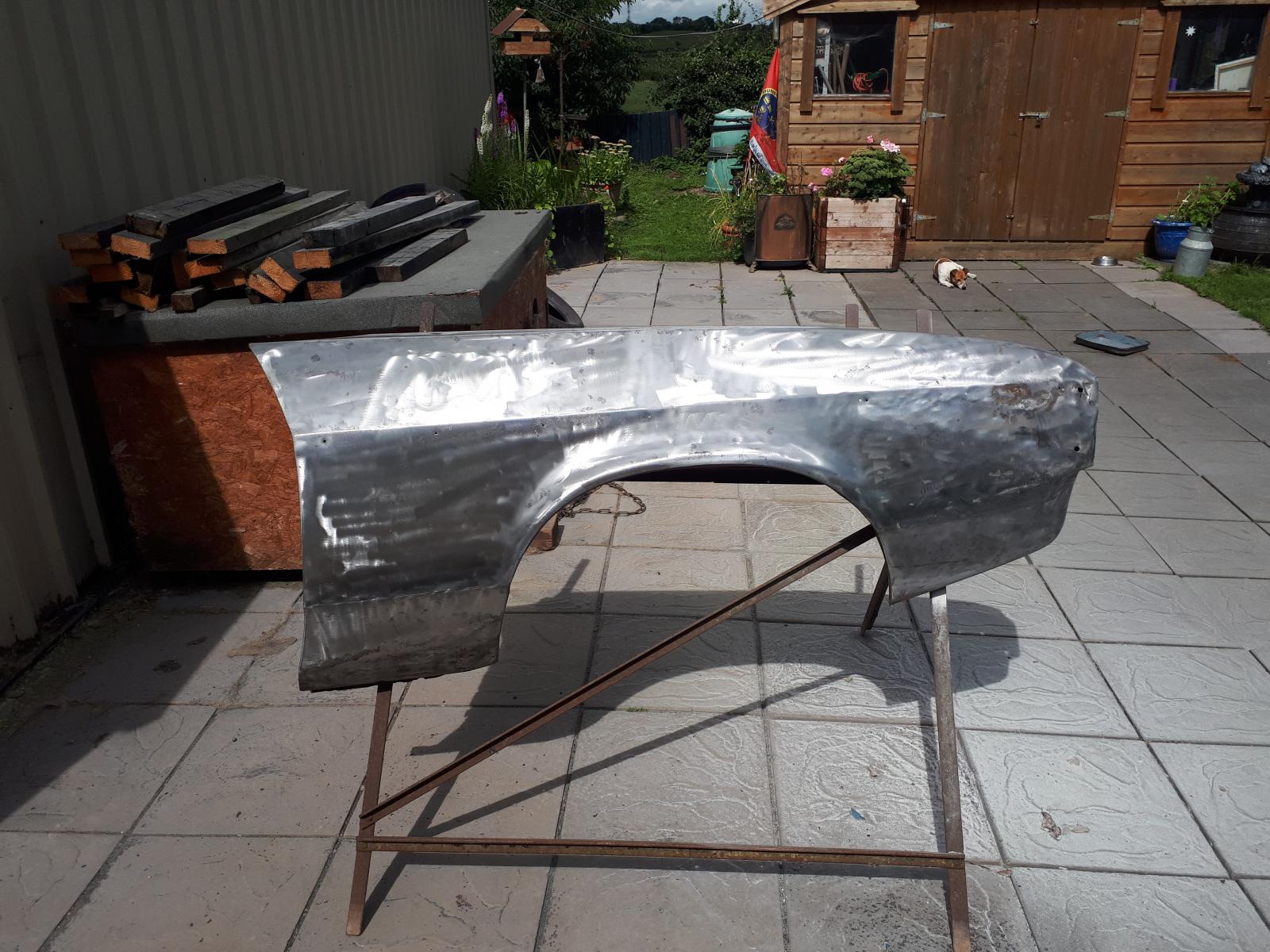

Today I haz been mostly stripping the paint of a used MK2 Capri wing.
Bought this a couple of weeks ago.
Bloody expensive for what it is,but that's Ford tax for you.
Still it's rot free,Just surface spots here and there.
Some filler in there too,as it's been twatted in the past.
Looks like it was a replacement at some point as it appears it was bolted on.
Hopefully it will fit ok.
Bonus smoll dog content too.
smoll dawg appears to know to stand clear.
