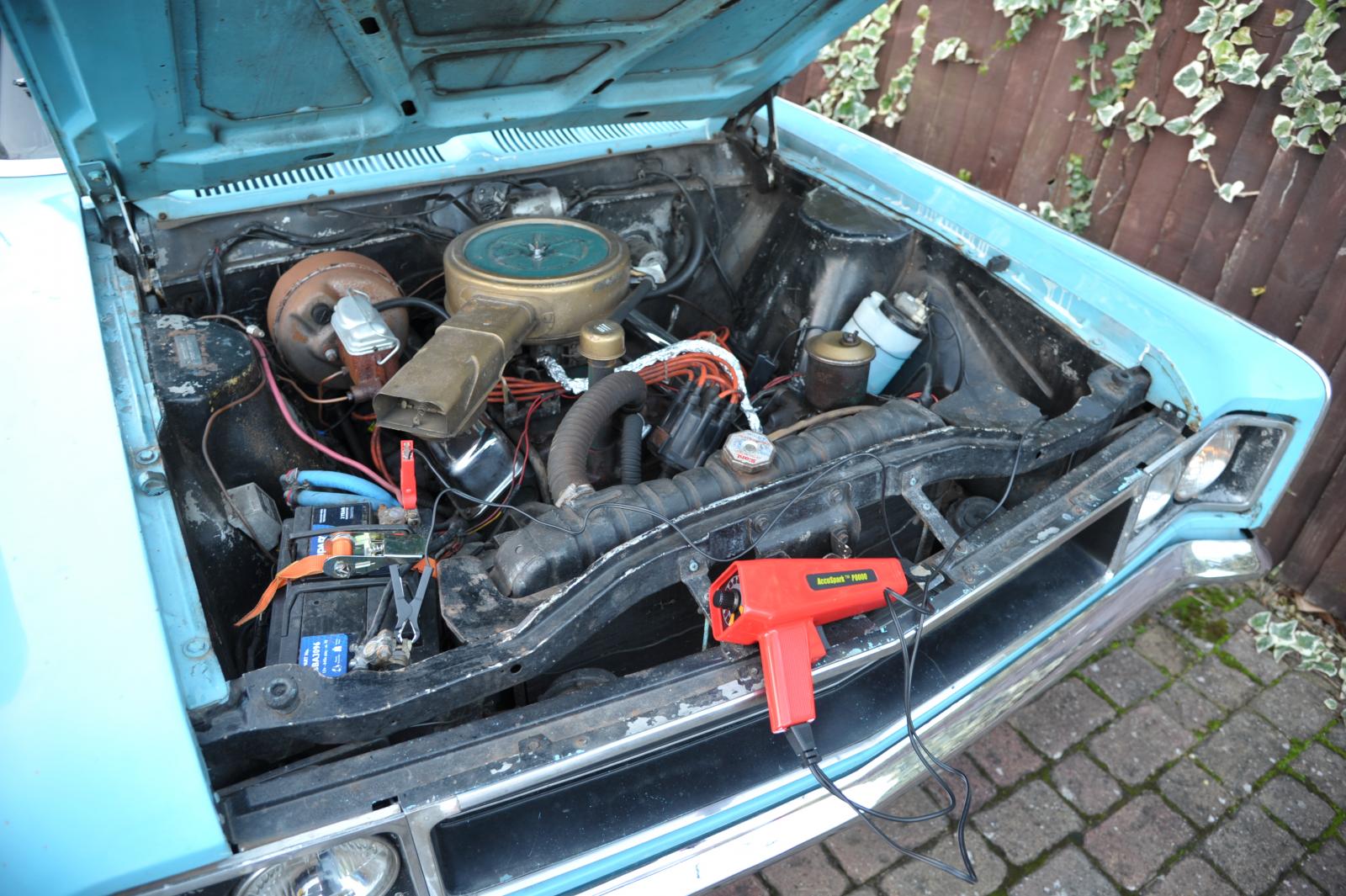

AMC lights - Wobbled wires under dash, sidelights all came to life.  Great fix but I will have to sort it out properly at some point.
Decided to check timing to see if that would help with the stalling when setting off problem.
I bought one of those fancy dial timing lights a while back.  Ironically, the correct timing for the AMC is TDC, so the dial was spurious.  It seemed to be set to about 10 degrees BTDC, so I corrected it.
This made absolutely zero difference to the stalling problem, so put the car cover back on and gave up - turned my attention to looking at the MOT fail areas on the Mondeo.  I am very tempted to do the brake pipes as it really doesn't look too bad a job.  Far too cold today though.

Going on previous with old yank carbs, could be the accelerator pump diaphragm be torn..
That was one of my first thoughts, but I rebulit the carb using a new one from the rebuild kit - didn't make it any better or worse :(
