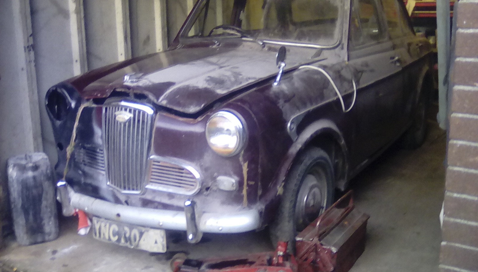

D Spares & Tyres Posted November 23, 2017 Posted November 23, 2017 There is mention of this somewhere but I can't find it so thought it could use its own thread. Its not really shite but although I am fixing it up, it is definitely not a restoration,just getting it back in the road in a useable condition. Lots of welding needed but no bodges, I don't want the rust coming straight through. Bought by me around four years ago, I parked it outside for two years and bought it home after that to start work on it but it got ignored for a year or so. It started life in burgundy but I decided to paint the lower half white or cream to brighten it up.I can only work on one side at a time due to the size of my garage but that's fine with me, I have been doing one panel at a time to help with moral. If I stripped the whole thing down it would look too daunting.So I painted the front wing after many hours welding it. Virtually remanufactured the drivers side front panel but winter came before I could paint it so I decided it was time to turn the car around and start welding the other side... Painted it black just to keep the damp out.You may notice the side is white but the wing is cream. I'm just experimenting with colours and will paint it all again next yearBack in the garage now, it makes a change to see it this way round although it does look sorry for itselfMy little lad has renamed it the Holesley for obvious reasons... Banger Kenny, Honey Badger, Justin Case and 40 others 43

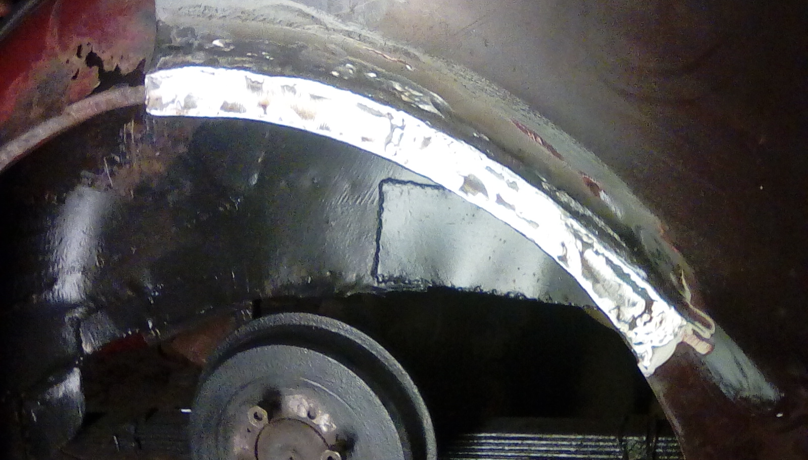

D Spares & Tyres Posted November 23, 2017 Author Posted November 23, 2017 Some welding pictures. I tend not to take photos as I'm going along, but here's a few of some rot and some repairsAnnoying having to cut away decent metal to get to rot but this was the best way to get to the rotten chassisNo idea if you can buy replacement arches but its as easy to make my own and far more cost effective! Sealed them with some fibreglass filler. It can be painted as soon as it gets warm again in the spring. Until then it can look bodged, but I know the truth. Done loads if welding underneath but you don't need to see all that. Will have a go at the sill end next... AlabamaShrimp, Skizzer, LC Torana and 29 others 32

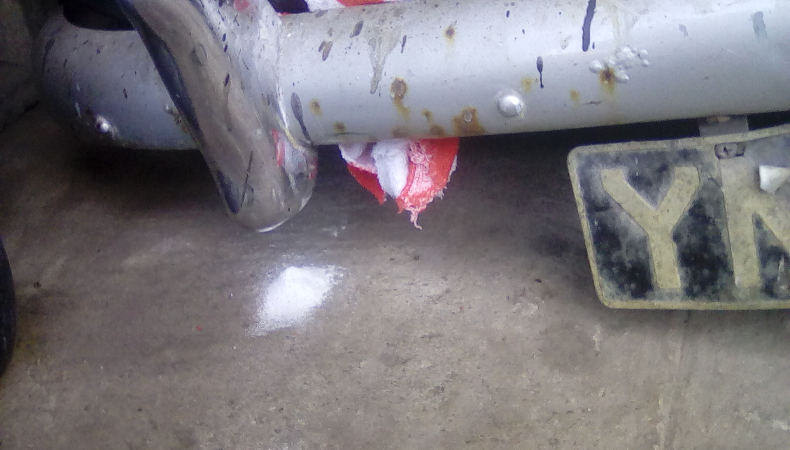

D Spares & Tyres Posted November 27, 2017 Author Posted November 27, 2017 Opened the front garage door to find the Wolseley looking a bit shifty. What is it up to? No wonder it looks so rough.... Turns out to be filler dust that had collected in the bumper over rider. The bungy has slipped and all the suspicious looking white powder has fallen on the floor in a neat little pile... More updates later, I'm going to try to finish the n/s/r corner of the car today and put the back end back on wheels Heidel_Kakao, Bobthebeard, Vince70 and 9 others 12
mercrocker Posted November 27, 2017 Posted November 27, 2017 That must be why the later ones have bigger nostrils.... D Spares & Tyres, Junkman, mk2_craig and 6 others 9
