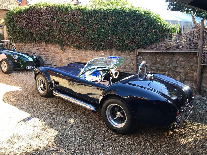

As mentioned earlier, on Saturday I dropped off my Cobra with a friend in Oxfordshire for some fettling. By lunchtime he had cleaned it so it looked like this
My friend Jason had visited a few weeks ago for a look see and I pointed out the things I knew needed fettling, mainly the oil consumption, the over fueling and the loss of "crispness" to the performance. I said that I was not certain the performance had dropped off or I had just got used to it. In addition there was a smell of fuel in the boot and the starter did not always engage first time, so I thought a strip and clean of the starter was on the cards.

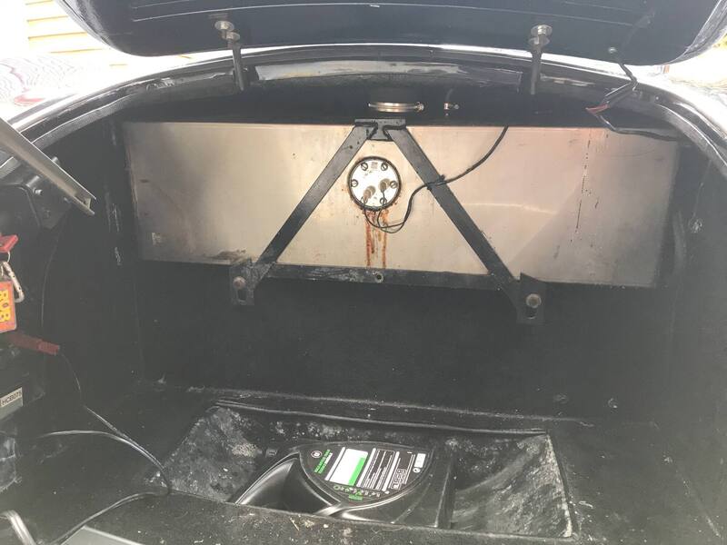

When Jason tested the car, he said he thought the timing was out and agreed it was putting out a lot of unburnt fuel. So after the clean he started with the starter and decided it was due to a lack of volts within the battery so charged it up. He was right, it has never failed to start first try since. Next was look in the boot and soon found the source of the fuel smell
Yes, a leak from the sender, obviously been like that since the new sender was fitted. Next was a look at the timing, and the first thing he found was the distributor was free to rotate as the clamp was damaged, and without work could not possibly secure the distributor. Again, this was last looked at by the specialist*
