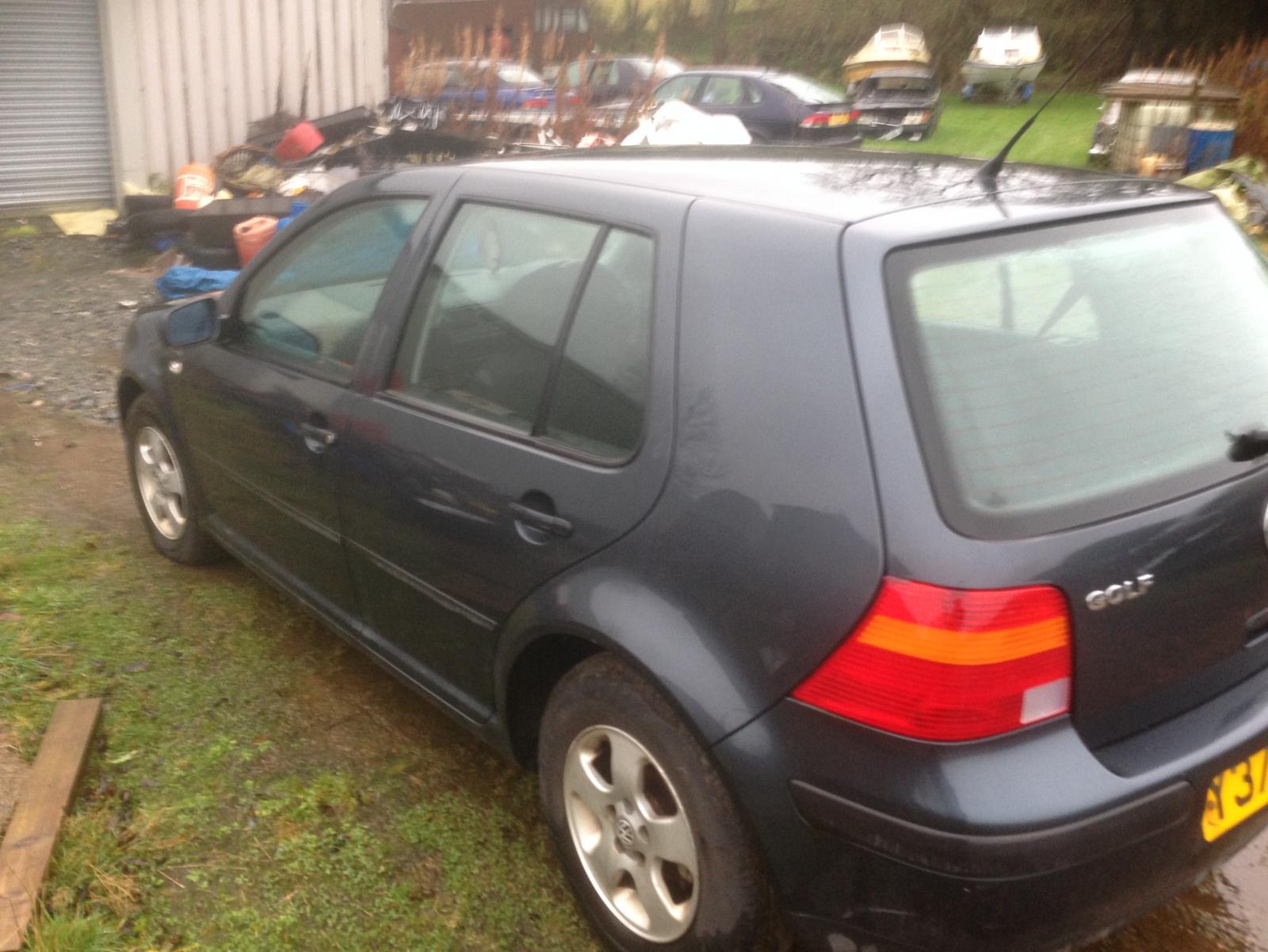

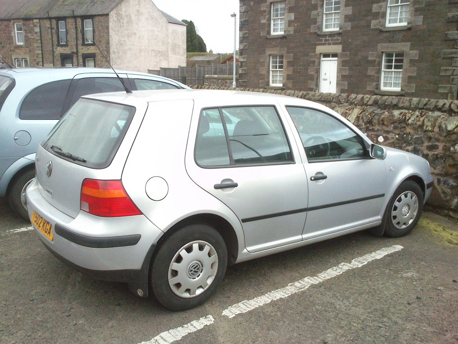

So, a couple of weeks ago, a friend calls and offers me a 2001 Golf 1.4 Petrol, 82k miles, very tidy for a hundred quid. Downside was it had sat for 6 months at a local garage where it had been taken with a running fault and a dead cat had been diagnosed. Now, the only other VAG product I have owned was an air cooled beetle 30 odd years ago, and as a fellow ASer has said to me, you can spot the VAG driver as he is the one who has left his personality in the glove box, but it was only a hundred quid, WCPGW?
A lifetime of avoiding VWs came to an end, and I collected the Golf, on the trailer behind the P38. Of course, the P38 got a tad warm on the return journey, so was parked in its usual spot awaiting attention and the Golf battery put on charge. It poured with rain all the next day, so the battery got a nice 48 hour charge. Of course, after this it was still as flat as a flat thing, so the battery was taken off my Morris Cowley Speedster (very much a summer car) and fitted to the golf.where it instantly, and noisily started, then stopped! The exhaust is completely fubared or disconnected, but I need to drive it up the ramps to see under it. Many retries on starting resulted in an instant start followed by an almost instant stop. Inside, for a search on the great god Google and it appears to be a common problem, with at least a dozen things that definitely cause it! Most common was an immobiliser fault easily cured* by removing and cleaning the connectors.
Now I hate plastic, and modern cars are full of the stuff, but I bit the bullet and removed several acres of the stuff. Eventually located the immobiliser, removed the connectors and cleaned everything in sight, Put it back together (ie threw the plastic on the back seat) and tried again. Instant start followed by the same instant stop. I phoned my local older VW guru and moaned about modern car shite (he pointed out it was nearly 20 years old!) and said I would probably need VAG-COM to sort it. Not having this, I phoned a friend who has a snap on generic machine, and he agreed to come over and plug it in. This stated that the ECU was disabled due to a faulty water temperature sensor. God Google pointed out this is a very common fault with VWs and a faulty sensor tells the ECU it is over heating so shuts the engine down. This made sense to me, so off to the local emporium and a new sensor was purchased. Back to the car, several grazed knuckles later and the sensor is fitted. Turn the key for the moment of truth. Yep, you guessed. No difference. I now hate this car with a passion, having wasted several days over 2 weeks chasing this fault. I will not be beaten, On Friday I ordered a VAG-COM unit and currently await its arrival. This does of course mean the car is no longer so cheap but at least I will have it for future use, though  the liklihood of another VAG product in my ownership was rapidly receding.
But, what isn't?
Cat collapsed and blocked - no go. You take the zorst off and tried again?
You may need to clear the fault code for the sensor - if not, the ECU might still think it's fucked.
Have fun changing the cat - some of the 1.4 16v ones snake around the subframe and you have to take an engine mount or two to get itin / out

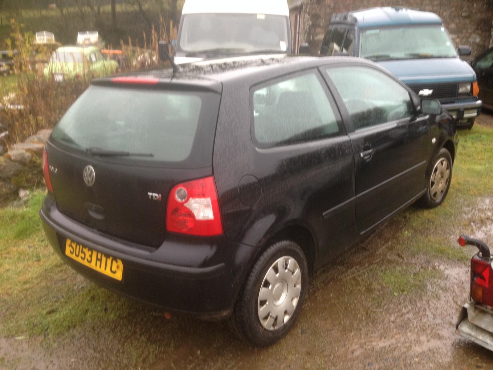

I was surprised. Roomy for its size, very little rust and 106k miles. A look at the back showed it was a TDI. No. Absolutely not. Walk away, so I did. Kinkersaab was still busy, so back around the yard I went, eventually ending up at the Polo again. Still completely disinterested, but with nothing else to do, I had another look. Goodish tyres with one new one. Cracked windscreen. Stereo removed. Yep, definitely shite. Oooh, the key is in it, wonder if it will start? Bit of pre-heat, and starts straight away, the little 3 cylinder oil burner runs clean and sounds good. No. No way. It is a VW and I hate them.
The victims potential customers had gone by now, so I laughingly enquired on the price of the Polo. Two minutes later I had confirmed my resolve and agreed to buy it. How the hell did that happen? From no VWs to two in a fortnight. Still, the first one had turned out so well* and I agreed to collect it Tuesday. Leaving wondering what I had done, I headed home. Less than 5 miles later the trusty* P38 overheated and went into limp mode. Pulled over and let it cool, checked the water level (spot on) and carried on. Quarter of a mile later, overheat and limp mode. Checked the viscous coupling, and sure enough, it is buggered with no resistance. Let it cool, carry on a bit, and limp mode again. Water level still fine, no boiling noises, but top hose does feel very warm. It had a new water pump and belts less than 8 months ago. Decided to try and limp it another quarter of a mile or so after which I could coast down a long hill and abandon it at my mates and get a lift home. Started it up, temp gauge returns to normal and it drives perfectly the 10 miles or so home. P38 gremlins!
Sunday I removed the fan, to do this I had to remove the two top hoses. Removed the hoses, and no water comes out, despite the header tank being full. Start the engine and after a few seconds water comes out of the hose, obviously pumping fine, so stuck he hoses back on and filled the header tank whilst it was running (it took 3 litres) and all appears good. To be sure, in true AS fashion, I drilled and bolted the viscous unit so that will work fine. Took it for a test run without the fan, and 40 miles later running fine.
Yesterday, I took the P38 (with bolted fan and spanner on the front seat) and trailer over to collect the Polo. Return journey completed without incident so it would appear  that an air lock was the culprit. The Polo came with the bonus of a half tank of fuel, so have been using it the last couple of days. Unfortunately, I am starting to like it, so mixed feelings at the moment. We will see....
