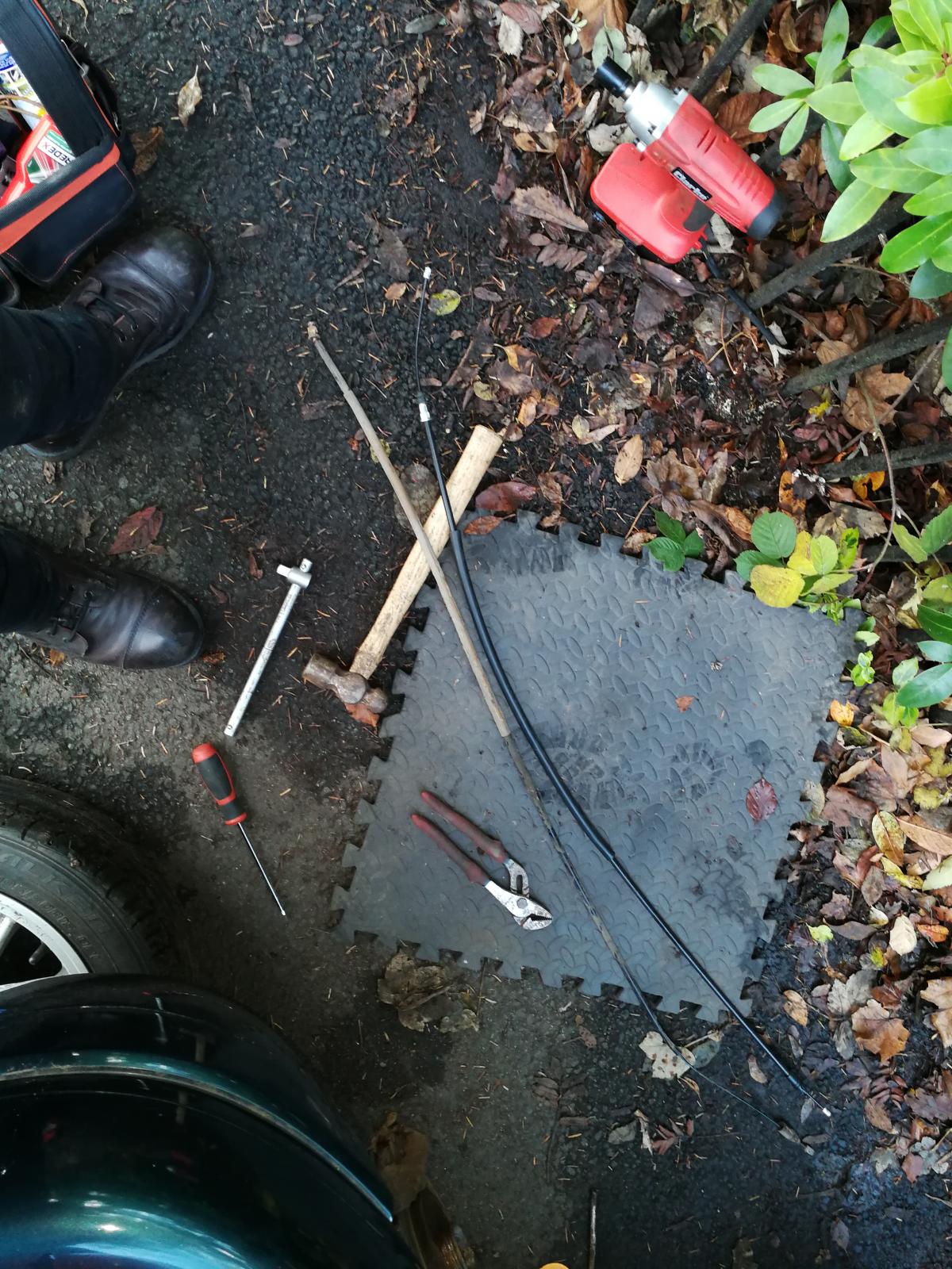

I got a new spring and 2 handbrake cables for this, and my brother came over to assist.

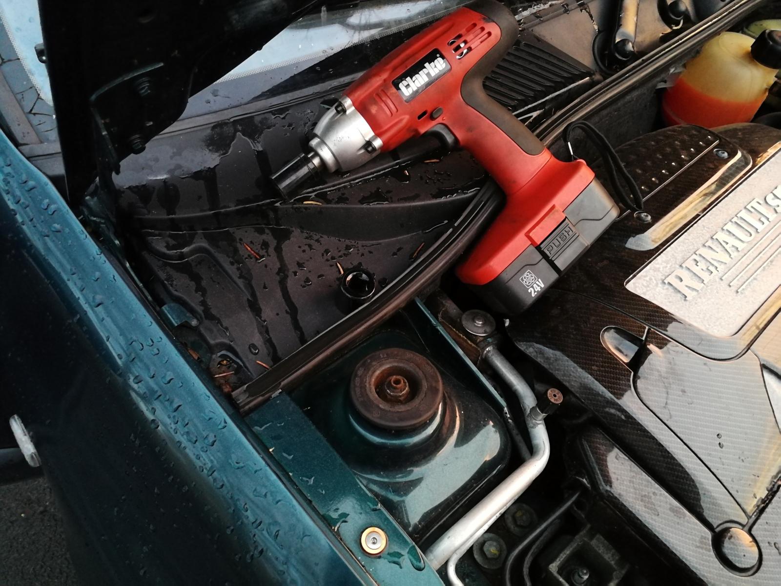

First up was the front spring.
Dugga dugga was applied
21mm took care of the bottom bolts
Then the top mount came off, and the new spring was fitted
Great success all round with the spring, so we packed up and defrosted over night.

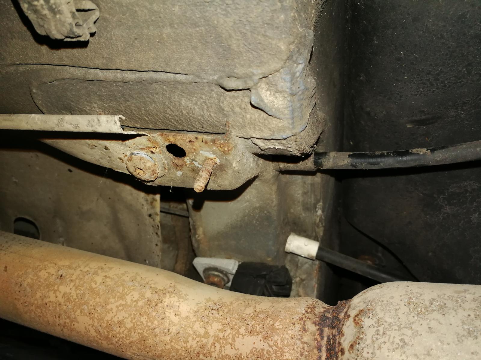

We found the end where it goes to the lever, and managed to get the heat shield loose enough to get in

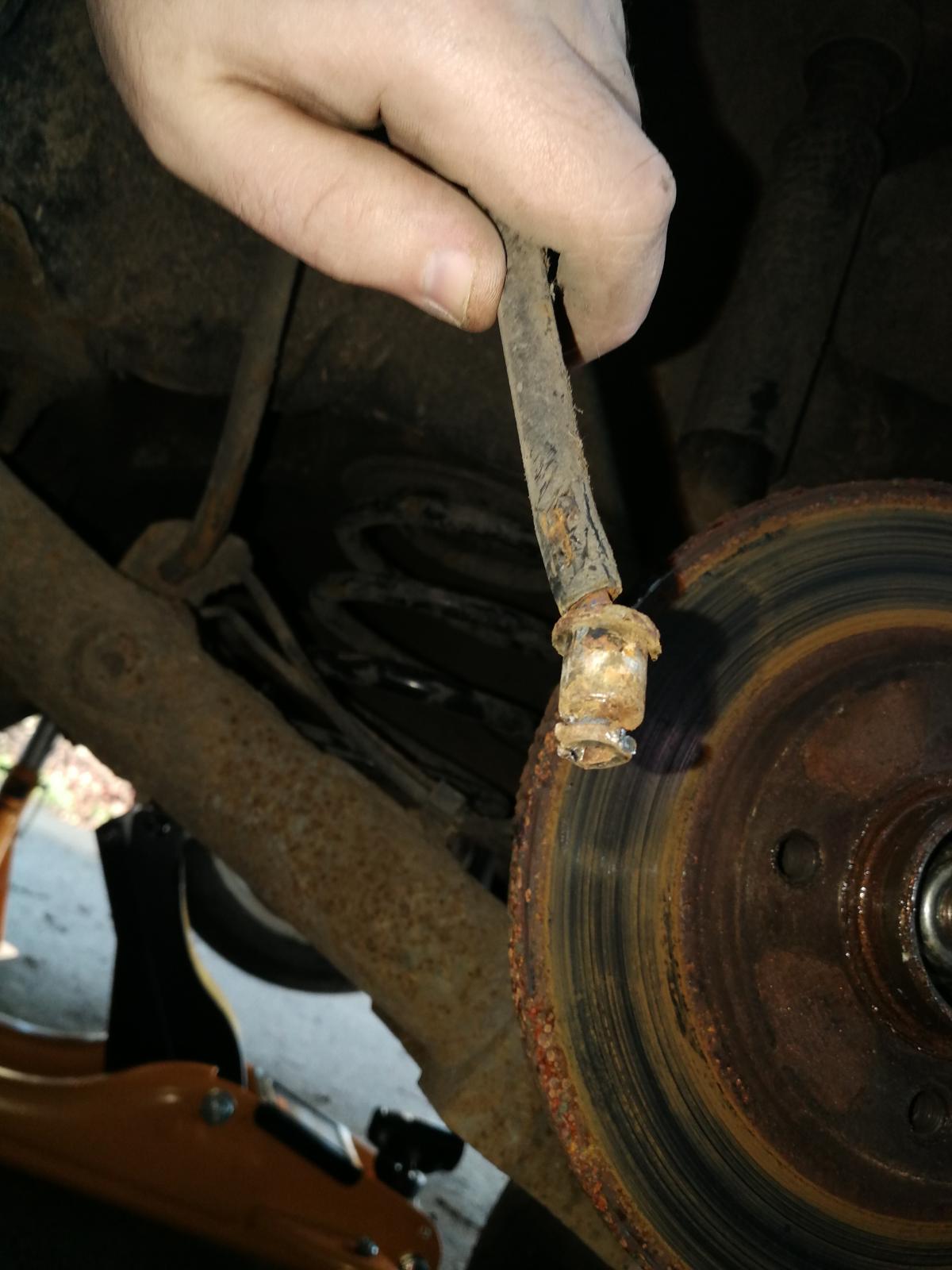

It was pretty obvious what bit had failed
The old one came out easily enough, and the new one was threaded in simply enough.

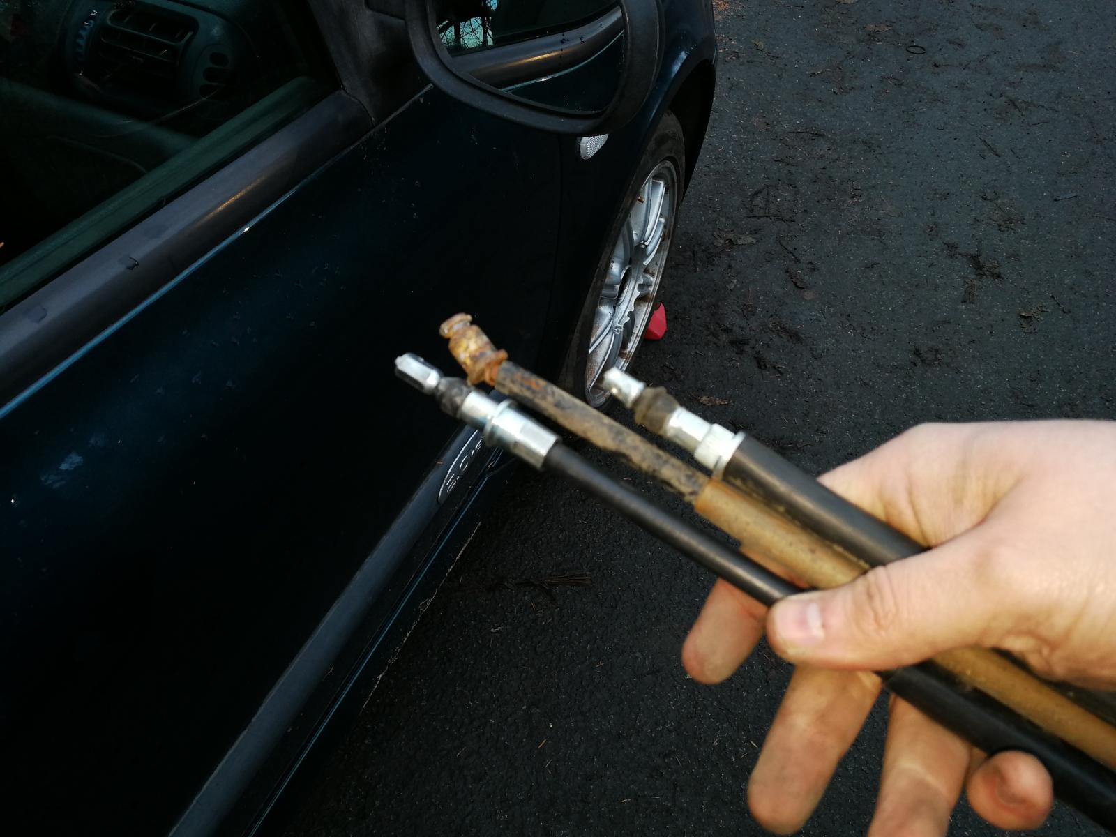

The cables are handed, and identified by different coloured locators. Black =LHS White =RHS

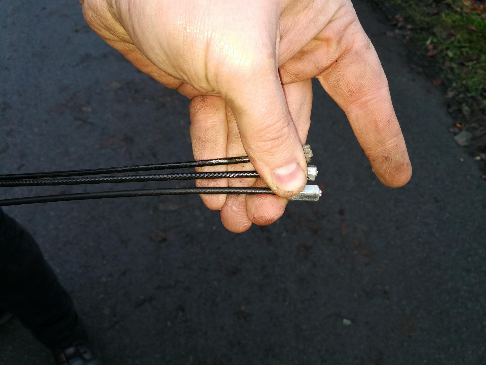

We pulled off the new cable and checked against the old one. It seems too short.
The RHS one should be longer, so we compared the new RHS to old LHS. it looked like it would just about make it - so it was also too short.
So, long story short - Both new cables are too short.
