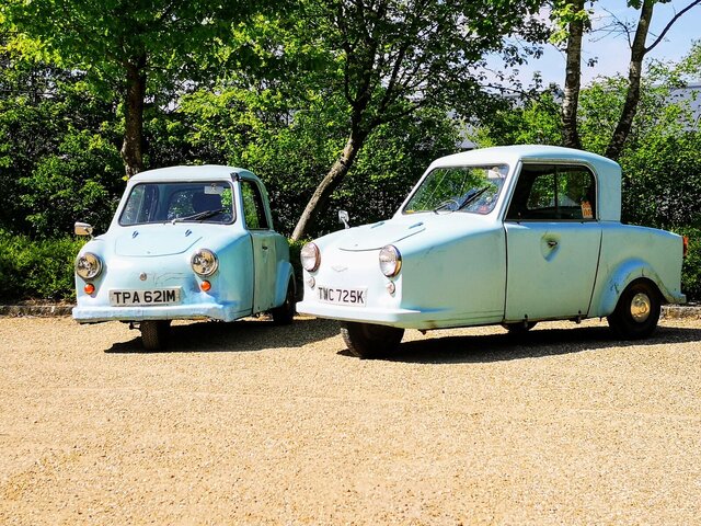

While I was playing automotive Tetris to put the Invacar away I snapped this photo.
This is a good one for the "what year was this photo taken?" category I think.

loving the photo too, even if the modern head lights on TPA give it away slightly :) it will be quite interesting to see how she does after dark

This brought us up to being as ready to greet TWC and Dollywobbler when they arrived.
Which of course brings us to our little meetup.  Nothing much that you've not probably already seen on his thread, but these are a few of the photos I took myself while we had the pair out for a juice sunny afternoon drive.
It was really interesting to have a brief shot of TWC to compare to TPA.  The immediately apparent differences between the two I noted were:
[] The 10" wheels and wider tyres make her more stable in a straight line.
[] TPA has a far louder exhaust.
[] TPA generally feels more eager, good 10mph difference passing by the bus stop just before you turn into our neighborhood.  Hard to tell whether this is a gearing difference or power output being a bit lower.
[] TWC seems to have a quieter engine, the noise from that feels much more distant than in TPA.
[] TWC has shown me how horrendous my brakes are in terms of free travel.  Actual stopping power is much the same though.
[] I really need to find an indicator stalk without a cranked arm as that's really awkward.
[] TPA has a stuffed throttle, though given the currently bodged cable in there it's not really surprising.
