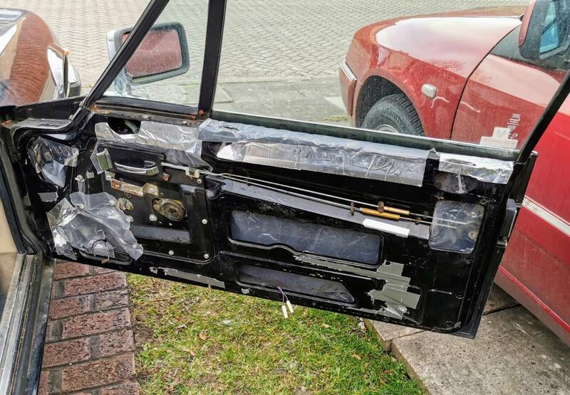

We will have to see.  Doing anything further requires me to remove the electric window mechanism and I'd really rather not mess with that if I don't have to.
Wouldn't *need* to mess around with this of course if whoever replaced the window motor had just put the original weatherproofing back in place (it was bundled up in a ball in the bottom of the door).
There's a contiguous piece from the top to bottom of the door the whole way along except for where there's an "n" shaped cutout to go around the window motor mechanism...and it's inboard of the wing mirror and window glass which should be the only places significant water should get in.  In theory.
There's an extra layer behind the door handle and speaker areas because they're where most of the water was appearing in the cabin.

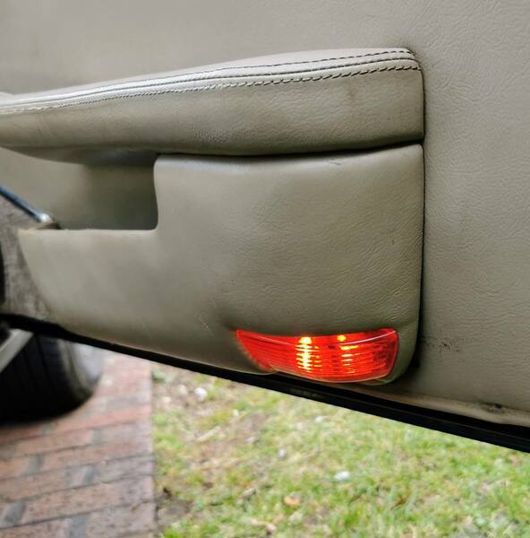

Not really visible, but I finally replaced the missing screw holding the lens on this light.
Which hopefully means it won't fall off about every tenth time the door is closed now.

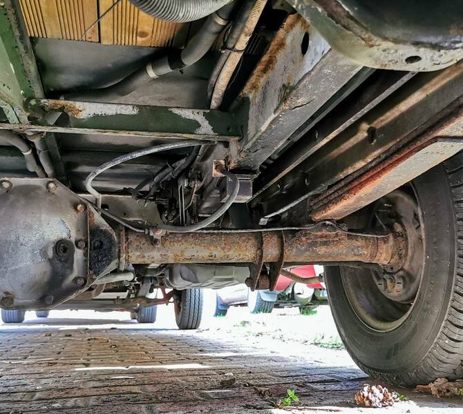

Annoyingly it appears that even with the level sorted that we do still have a slight oil leak.  It looks like it *might* be actually coming from the oil pressure switch as the whole area around it looks a bit wet.
Have given the general area a good spray down with degreaser so we can have another look after the next trip out to see if it's the culprit.  Would be nice as it's a cheap and easy part to change.
Not holding my breath though...My gut feeling is that we're looking at a leak from the crankshaft oil seal.

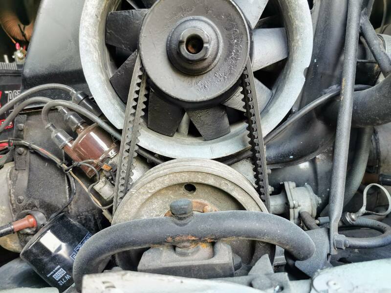

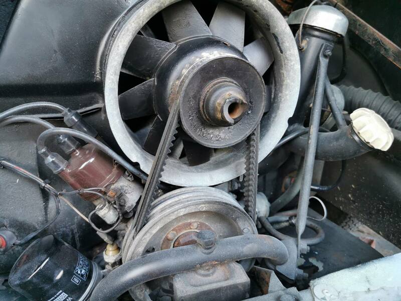

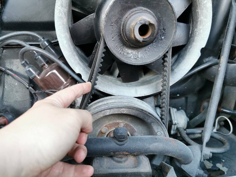

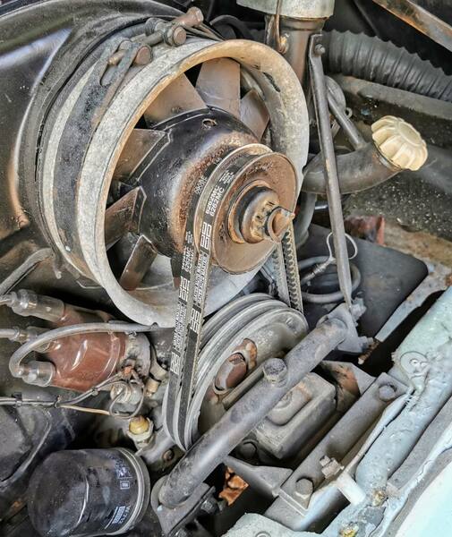

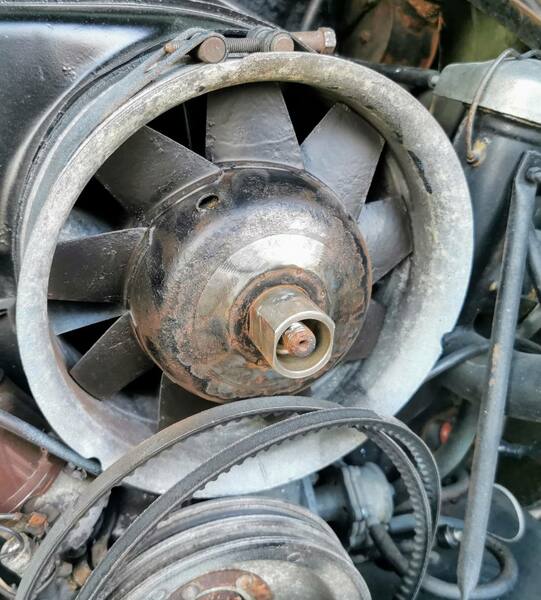

The belts are in a state as you can see too.  They have been loose for a while now...but lately have been getting a bit ridiculous.  Aside from the increasingly unhappy squeak every time the starter is operated from cold, it's never good when you can SEE how slack a belt is.
Yes, that is as floppy as it looks.  Especially the one nearest the camera.

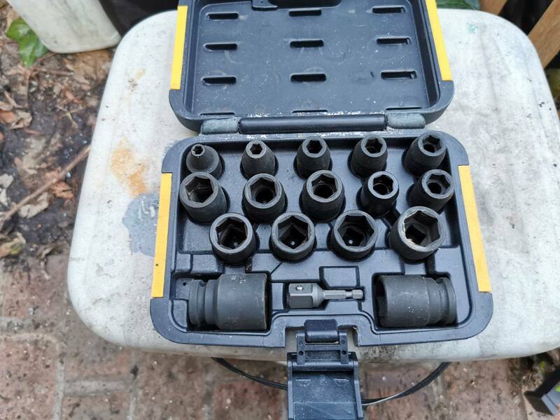

The reason I hadn't done something about this sooner was simple: I'd been completely and utterly unable thus far to shift the nut on the Dynastart pulley.  The belt tension on this engine is adjusted (like on old VWs) by adding or removing shims between the pulley sheaves...so any tension adjustment involves removing that big nut.  While there are two holes in the fan to allow you to wedge it in place - the nut was tight enough that these holes were ovalling out from the torque I was applying.
Right up until the point that I *finally* spent an hour turning the back of the garage upside down and unearthing the impact gun.
In approximately 0.3 seconds it buzzed it straight off without it seemed like any effort whatsoever...Didn't even have to lock the pulley...
Sometimes you just need the right tool for the job at hand.
It's not a tool you'll use for every job (and using it for the wrong one can cause you no end of headaches...), but really is an absolute godsend when presented with something like this or trying to get a wheel nut that's been done up by Kwik-Fit to 10,000,000,000 times more tightly than it needed to be.  This was less than £50 and for the three jobs I've really used it for so far I reckon has already more than paid for itself in saved time, sweat and spilled blood.  Just make sure if you get one to get a good quality set of sockets to go with it.

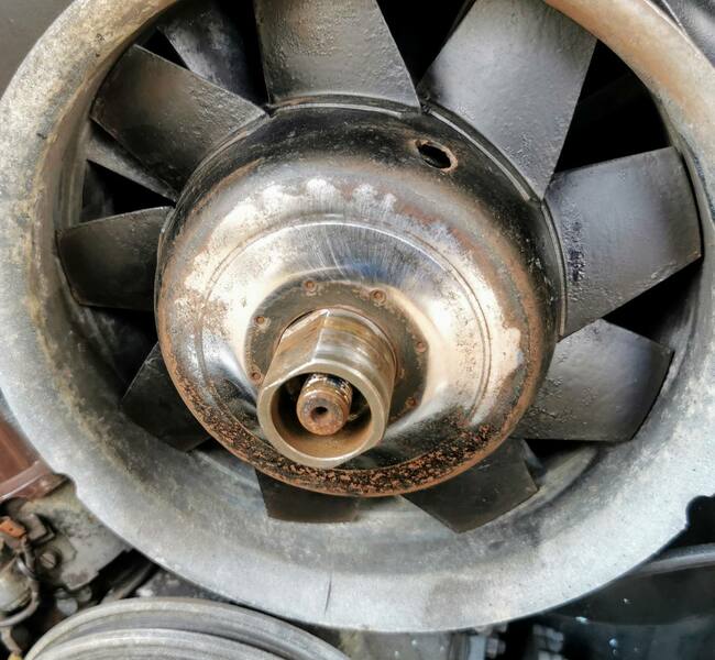

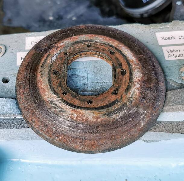

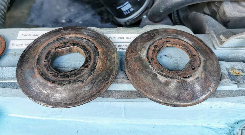

The other reason I wanted to get this lot apart was so that I could actually clean up the pulley running surfaces...After this engine had spent a good number of years sitting outside in the weather they were unsurprisingly in quite a state - I'm honestly surprised that the belts didn't just self destruct given the state these were in.
Definitely beyond the point of "self cleaning" at this point...so out with the carbide mop.  Realistically  I could do with a new set of pulley sheaves, but the heavy, rough pitting that will shred belts is gone at least.  I do have a friend with a lathe so might have a chat to see if it would be possible to use that to knock some of the crud off.
The fan hub (which forms the rear face of the pulley) got the same treatment.
Again...It really has seen better days, but is a lot better than it was.
The belts will want replacement now as running on the pulleys in that state has unsurprisingly wrecked them.  I'll grab a new pair next time I'm in the vicinity of Motorserv.   They're not exotic or expensive so I'm not worried about that.  They are at least properly tensioned now though (if anything a little over-tight in the case of the front belt).
Not really too worried - they'll be getting replaced shortly anyway - I'll spend a bit of time ensuring that the replacements are tensioned as close to as per the manual as possible.
Quick test revealed that the "chirp" on activating the starter is indeed now gone.
I had also completely failed to appreciate quite how much noise the belts were making at high engine speeds...The engine is SO much quieter and smoother when revved now.  Will be interesting to see if that's at all obvious when on the move - though given that about 85% of the noise you're aware of is CVT and gearbox I rather doubt it.

Decided to have a better shot at cleaning the Dynastart pulleys up on TPA.
There is deep enough pitting that they'll never be perfect, though I think this should be good enough for the job...given that the previous belts lasted the best part of a thousand miles and still worked once the tension was adjusted...if I go through £14 of belts once a year or so I'm really not going to lose any sleep over it.
Sadly Motorserv only had one belt (Gates 6262MC for reference) so I'll need to swing by tomorrow to pick up the second one before I can fnish reassembly.

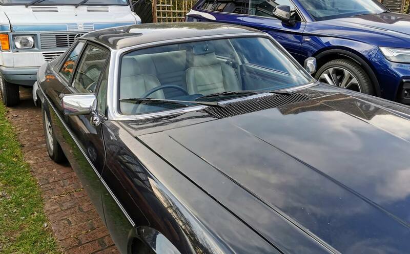

Only real car job was to finish sorting the wipers on the Jag.  When I sorted out the intermittent motor back last year I never really put any effort into getting the wiper alignment right and had broken the non return valve for the windscreen washers.  Both of these issues were resolved today, so the wipers now park in the correct spot again, so only a quarter of the way rather than halfway up the windscreen.
Replaced the wiper blades too as the ones on there looked horrible.  They went rusty pretty much the day they were fitted.
Last job was to realign the washer jets as the driver's side one washed the scuttle and the passenger side one was pointing skywards.
Much better.  Granted that's one item of about 700 on the to do list ticked off...but it's something at least!

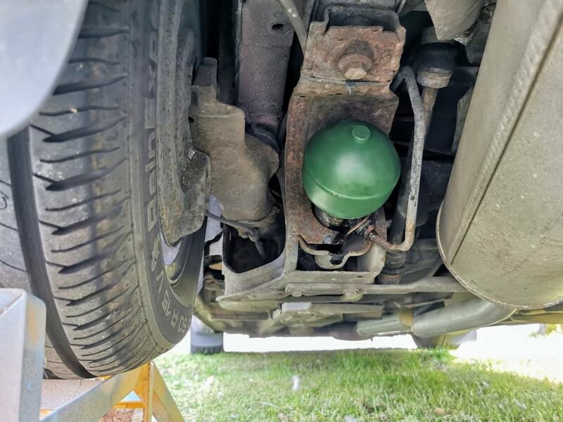

Task number 1 today... changing rear spheres on the Xantia.  Want this done so I can drop the sphere removal tool back off with its owner.  I hate having other people's tools on loan for longer than absolutely necessary as I'm paranoid about losing them.
Dodged the usual game of chasing the ramps around by doing the job on the lawn.  They dig in enough there to stay put.
Of course because it's the Activa there's a hydraulic line in precisely the most awkward place when you're trying to get the tool onto the sphere.
Not enough to be a problem, just enough to be moderately annoying.
Offside one first, wound off without too much of a fight.
Only slight game I had there was the seal vanishing into another dimension (I did find it eventually) which had me second guessing if I'd got the old one out of the strut for a few minutes.  New one in.  That's this side done.
Nearside required a little more persuasion to shift, but I was still able to do it by hand just using the sphere tool.  Didn't need to get any additional breaker bar or anything involved.  It's really nice working on a car where the previous owner or a garage haven't overtightened absolutely everything.
New sphere on.
Tightened the bleed screw on the regulator back up, checked for leaks then that's that job done.  Maybe 20 minutes?
Well it would be if the new spheres weren't dud.  Knew it was a bit of a risk being NOS ones from 1998...but was worth a shot.  Offside one is passable, nearside one though is just as bad as the one that came off.
No huge inconvenience really, as mentioned above they take about 20 minutes to change and they were given to me free, so I'm really not that irked.  Just would have been nice to get it done in one hit.
We'll be playing this game again shortly then!
Second new belt was picked up for TPA today so those have now been fitted.  Adjustment seems spot on with the six spacers split evenly with three on each side.

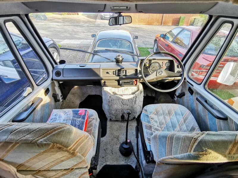

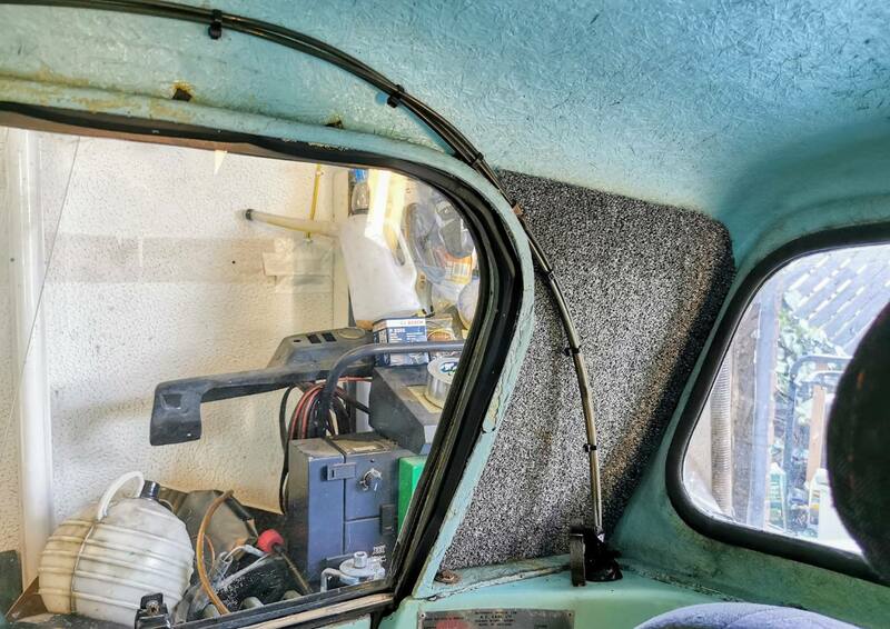

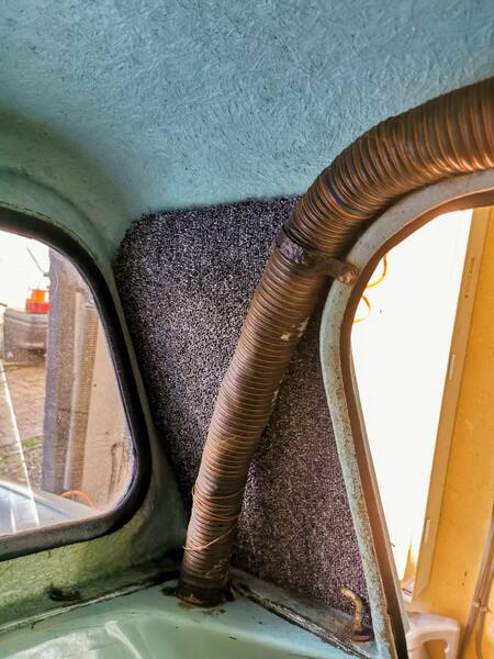

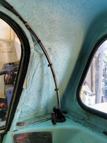

On the subject of trim, while getting the whole roof lined is definitely a job for "sometime in the future" one bit I really wanted to address was the rear C pillar on the offside, mainly because of an unsightly historic repair there.
Conveniently I had a couple of offcuts left from when I did the carpeting job which I was fed up of shuffling from place to place in the garage.  They were just big enough to do this.
Far tidier!
Obviously made a matching one for the other side too.
Have left them both wedged in place while the glue sets.  I'd really like to replace the windscreen demister duct, however it's still a way down the list - especially at £25+ a metre!

Oh that reminds me!
that terry clip you where wondering about, im pretty sure was for the original fire extinguisher included with the car back in 1973
if you look at the drawings from the workshop manual they show something in the same place as that clip which im pretty sure is the fire extinguisher :)
(which iv heard described as an aerosol type, did not realise they meant it literally in that it was the size of like a rattle can! LOL)
Always always be careful of nos parts. See my post on the Daf Owners forum:
https://dafcars.proboards.com/thread/3832/nos-parts
Aye, it's always a gamble.  I wound up binning probably 80% of the supposedly NOS parts I got with KPL because while they'd never been used, they looked to have been stored on the Titanic and were utterly wrecked.
If changing these spheres required any serious work I'd definitely have ensured they were checked (I do know someone locally with a sphere tester) before fitting.  As it is, all I've lost is about 20 minutes so no huge hassle.
It is a gamble though, which on more expensive parts is one I'd be less willing to take.  Though it is one you kind of have to with an old Citroen these days given the laughable approach to legacy parts support from PSA...

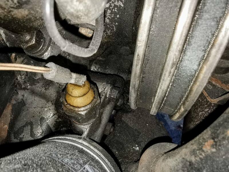

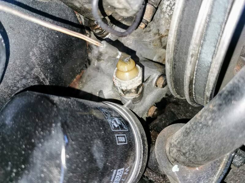

Well I don't know if it is the only one, but the oil pressure switch is definitely leaking.  This was cleaned up and completely dry before I set off today.
Will get a new one ordered from Prokschi later on.
Have to admit that I'm staggered at the difference changing the Dynastart belts has made.  Not so much in noise, but I'd say it's reduced mechanical vibration by about 80%, the engine just feels so much smoother now.  Wouldn't have expected such a small mass wobbling around a bit to make such a huge difference, but I know vibration can be strange like that once you take into account resonance effects and such.
It's definitely improved performance of the charging system too, it starts charging a good bit earlier than it used to.

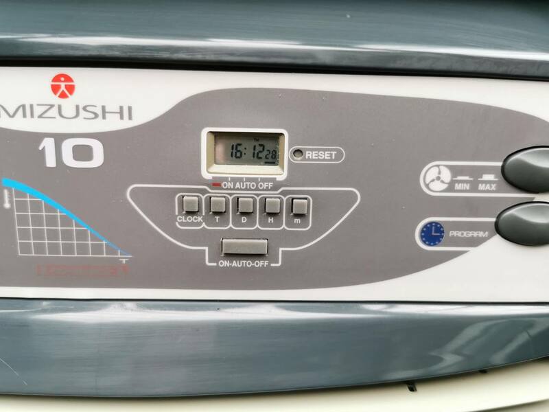

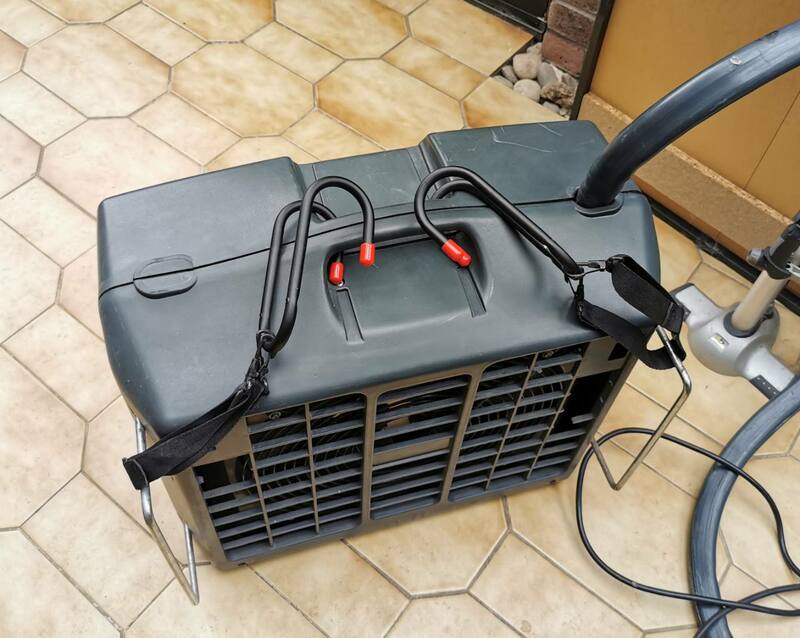

Okay, I've got two portable split air conditioners to pick up later this week.  I reckon I might *just about* be able to fit them both in the Xantia with a bit of very careful Tetris being played.  If I can get the damned boot open.  That's what I'm going to go have a swear at in a minute.
If I had the van available however it would be a dead easy mission.

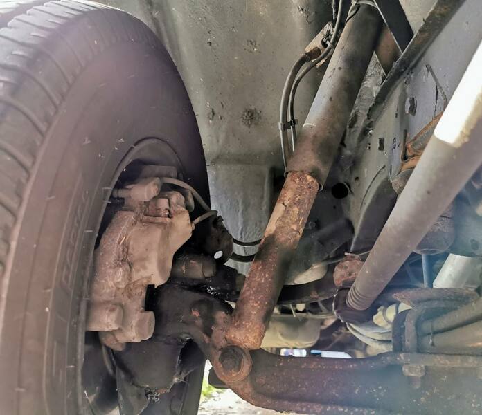

I've had a closer look at the brake flexible hoses and given the ferrules a bit of a clean up.  I'm not thrilled at the state of them and definitely reckon they'd be advised on.  I'll be changing them this year definitely either way.  I'm still irked they weren't even mentioned by the garage last year given the number of as far as I'm aware non existent faults they seemed to find on the brakes.

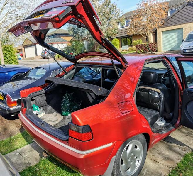

Bloody French cars...
I've been unable to get that boot unlocked for well over a month now.  Right up till when I went to sort it today.
Of course at this point it immediately starts working absolutely perfectly and I can find no trace of any reason for the misbehaviour.
Business as normal then!
Then went and cleared about two tonnes of dead leaves and dog hair out of the interior of the van.

The windscreen is at least fully weatherproof now it seems so I don't wind up with water dripping on my knees any more - that used to get old in a hurry.
Dynastart belts are squeaking a bit just now at idle but I reckon they'll shut up once they've bedded in a bit.
Well that could have been worse.
One sticky brake caliper (41% imbalance on the machine - though it felt like it was improving on the way home) and a couple of silly minor things that will take five minutes to sort.
I've got it booked in for next Tuesday to have the brakes sorted - though if I have the opportunity before then I may well whip the wheel off and see if it will respond to a clean up and grease of the caliper slides.
Bit irked at the headlight aim...that was last touched by the previous test station and I always reckoned it was off since they fiddled with it.
  • Zelandeth changed the title to Zel's Motoring Adventures...Jag, Citroens, Mercedes & AC Model 70 - 28/04 - MOT Results...

Oh, and I set the clock on the programmer (that we'll never use) because it was driving me mad.
The window ledge hooks for the outdoor units are long-gone so I had to improvise something there - not difficult though.
I reckon this one dates from around 2000,
The little Serviso unit I reckon is probably early-mid 90s, and honestly seems a far more intelligently designed unit.
So, so much quieter than the vented units...Reckon we will be very, very glad to have these once the warmer weather arrives.  This house is very good at keeping heat in...great in the winter, but it really sucks in the summer!  These little portable splits are surprisingly hard to find these days - though given that when new they cost more than a conventional fixed split system A/C unit...not maybe that surprising!
Seriously considering picking up another two of the smaller ones and getting completely shot of our vented units in the summer...These are a bit more cumbersome, but the efficiency savings should make it worth it.
