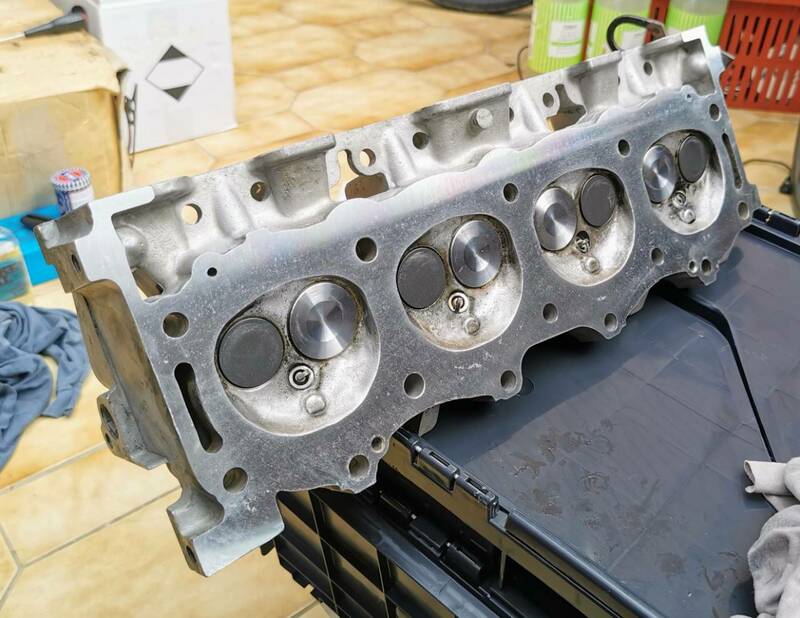

Got the heads built up with the new valves.

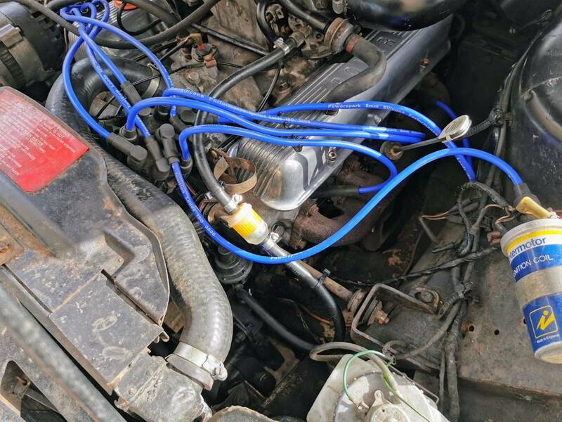

Yesterday I swapped out the old fuel filter as I'm not entirely convinced it wasn't starting to break down internally.
Don't have one the same side as the original one in stock so had to improvise a bit.
When I get some larger diameter filters in I'll return that to it's correct location.  Also rerouted the hose from the fuel pump a little as it was curved backwards before and was virtually touching the exhaust manifold.

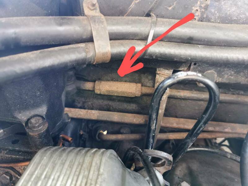

Also noticed that the fuel hose connection to the distribution connection to the carbs had the hose clip actually too far up so it wasn't gripping the barb...I was easily able to just pull the hose off.  So fixed that.
That could have got exciting.
