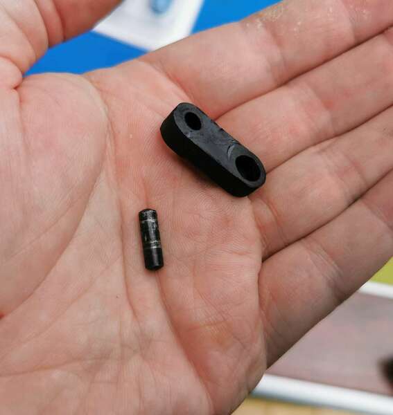

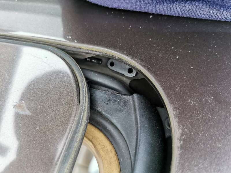

The catch shouldn't be too hard to find, most Renaults 5/9/11/19/21 of that era use the same one, there's bound to be someone breaking one with that catch on it.
Having a driver's door which actually closed reliably for the first time since I got the car and dry roads, seemed a good excuse to use it as an actual car today.

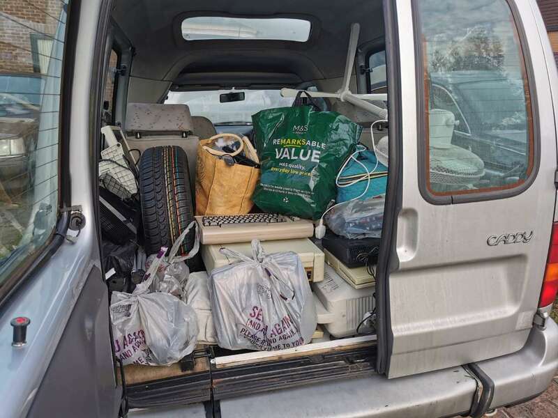

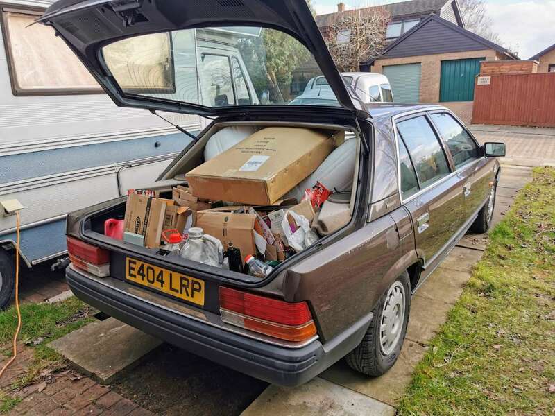

More proof that my cars don't get a free pass to sit around doing nothing.  25 on recycling duty today.
You can fit a somewhat alarmingly large amount of stuff in there.
Admittedly I'd rather be using the Caddy for jobs like this, but the Council insist it's a commercial vehicle so that ain't happening.

With the boot lid removed, there would be something pickup-like about this car.
What a machine! Enjoying your updates.
Down to having such a huge wraparound window on the bootlid I think.  Xantia is similar, albeit slightly less pronounced.
It is damned near as big as some pick ups with the seats down!
  • Like 6
I got away with the caddy at the tip. Rear seats were enough to convince them it was a car.

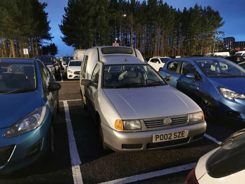

Glasgow achieved.
Just a bit of stuff on board.
Of course our room is on the ninth bloody floor so it takes about ten minutes per trip to the car because we have already swamped the three lifts in the hotel and there's a huge queue every time.
Taking a breather now, reckon I'm about two thirds done - after nearly an hour.  Hoping I can scrounge a trolley to get the last couple of loads of stuff out.
Caddy did a sterling job of being an absolutely low stress motorway mile muncher again, and got here with over 1/4 a tank of fuel left.
Edit: Always fun getting to see your car from viewpoints not normally possible.
Caddy isn't hard to spot even from 9 floors up.

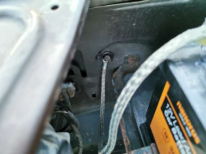

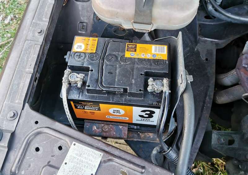

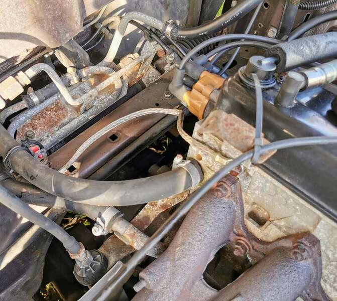

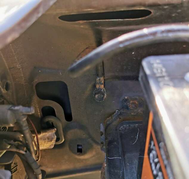

Today I decided to take something simple as I'm still feeling quite beat down energy wise from the weekend.  Target: Horrible crusty looking battery terminal connections on the Renault.  I want to discount these as a cause of the sluggish cranking before I condemn the battery.
The terminals have obviously been replaced at some point with the type which have two screws holding the lead in like a giant terminal strip.  I've never been a fan of these as it's difficult to get the things tight enough without stripping the threads out of the brass.  Sure enough both screws on both terminals were finger tight.
The body to battery ground lead was pretty much dead.  It's never a good sign when a piece of electrical flex makes crunching noises when moved.
After wiggling it back and forth a couple of times the wire came away from the flex entirely.  Must have been hanging on by a handful of bits of copper.
New earth strap installed.
I took the positive side apart as well and cleaned everything up.  A new set of battery terminals and crimp connectors are on order so I can redo this in a more permanent fashion.
Given the body to battery terminal was about ready to fail I figure the engine to body one is probably in a similar condition (not honestly sure where it lives), so I added a new one between a couple of convenient bolts on the head and cross member.
I will probably shorten that a bit once I've got more terminals on hand.  Likewise I might look around for something a bit further away from the exhaust.
The engine definitely seems to spin over a lot quicker now - at least it did the two times I've started it today.  So we might have a quick win there.

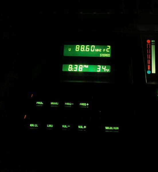

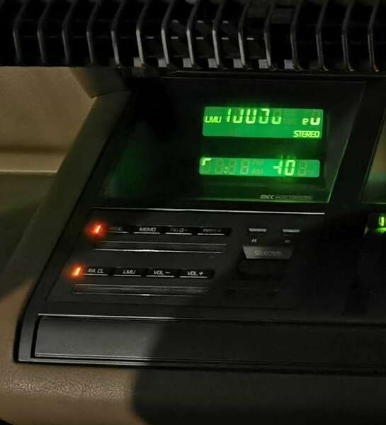

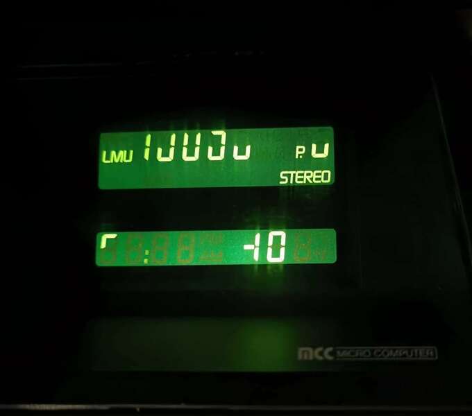

There was an utterly unexpected bonus prize to this activity though.
The central display has started working again - and by extension so has the stereo returned to a fully functioning state.  As I understand it this display is entirely driven by the stereo, and my guess is that at some point when the battery has gone flat it's crashed.  My disconnecting and reconnecting the battery has allowed it to restart in a more graceful manner.
Stereo works, steering column controls work, upper control panel works, I *think* the backlighting in the buttons works, heck even the external thermometer seems to be giving reasonable numbers (that was in the sun with the bonnet open so I suspect the sensor was in direct sunlight - it was showing high 40s while I was driving which ties in with the local forecast).  Would be nice if there was a way to switch it to show degrees centigrade, but I'm not going to lose sleep over that.
Having access to the controls and an FM source has meant I can properly try out the stereo...and it sounds bloody excellent.  Especially now I'm not listening through a tape deck that is kinda sorta working but really needs a service.  Haven't actually tried that today - it may too be doing better now, I'm not entirely sure the amplifier was correctly switching sources before.
Equally importantly though, I have a working clock again.  Not having a clock on the dash is something I find exceptionally irritating.
Even if you're not a car person (and/or a child of the 80s), it's hard not to have your eye drawn to the big digital display in the middle of the dash, so having it displaying sane information rather than gobbledygook is a definite improvement.
Before photo for reference:
An updated nighttime dash photo will of course follow later on now everything is working properly.

One of the additional things that wasn't previously working because of the issues with the central display was the illumination for the keypad below it.  Which was really glaringly obvious at night.
Before:
Those two yellow LEDs to the left shouldn't be stuck on either.
After:
Much better.  Whole central stack looks far more complete now.

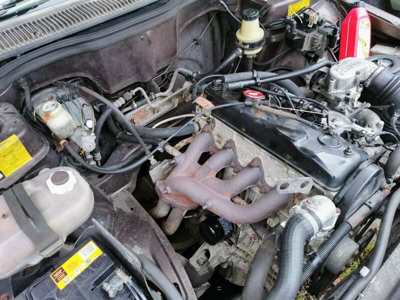

Job number 1 for today: Valve clearance adjustment.
This is about as simple as it gets!
Bit of gunk in there, but nothing alarming.  Unlike when I set out to do this job on a certain Mercedes and discovered the entire valve train to be coated in about 1/16" of tar and discovered the camshaft was merrily grinding its way through the cylinder head!
It's worth noting that the "rule of nine" does NOT apply to this engine.
With exhaust valve 'n' fully open, adjust...(I is inlet, E is exhaust, and note that number 1 is at the FLYWHEEL end of the engine by Renault's numbering convention).
1.  3I, 4E.
3. 4I, 2E.
4. 2I, 1E.
2. 1I, 3E.
Or just look carefully - the camshaft to rocker interface isn't that hard to see, so you can see which rocker is right in the heel of the cam lobe with a bit of patience.
Clearances should be set cold, and call for 0.1mm on the inlet side and 0.25mm on the exhaust side.  They definitely needed a tweak on this engine, especially a couple of the inlet valves which were quite loose.
It's still a bit tappy but is definitely better.  It's also more consistent though, it was really obvious before that one or two were far further out of whack than the rest.
It's worth noting that getting a proper look at the timing gear has allowed me to confirm that this does use a flat tappet lifter arrangement, so WILL want a zinc additive to be added to the oil unless a classic-specific oil is being used.
After a good test run it was time (finally) for an oil and filter change.
Doesn't it look better having that manky, rusty old oil filter out of there?
Immediately makes the engine bay look about 75% less neglected.
I did note however while wrestling with the biblically tight sump plug that I think I'd be best to start looking for a new radiator.
While it's not leaking, there's a good 1/4" of the fins at the bottom of this which are just missing.  I imagine the fins largely consisting of aluminium oxide for a significant portion won't be doing the heat rejection properties any favours.
The oil which came out wasn't horrible but did seem thinner than I'd expect for the book rating (10W 40).  No glittery residue left in the drain pan at least.  Speaking of that...my drain pan is JUST big enough for this...it takes 5.75 litres of oil for a change (I've left it just above half on the dipstick as I'll need to chuck some zinc additive in there once I've got hold of some).

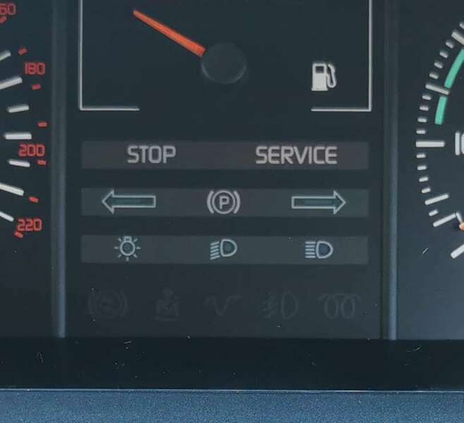

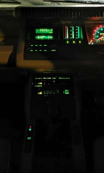

Once it was dark I went out, unplugged the washer pump harness and retook the whole dash photo for the dash at night thread.
I also tried to get some better photos of the central cluster of warning lights on the dash as they're of a style I've not seen all that many places.
Looks pretty traditional for an 80s car, albeit a little stylised with the indicator symbols when unlit.
When lit though the legends are actually brighter than the background.
Which is an absolute swine to photograph properly.
No matter what I do, the parking brake light's legend always washes out a bit.  I'd spent about ten minutes fighting with exposure settings by that point so decided to call it done!

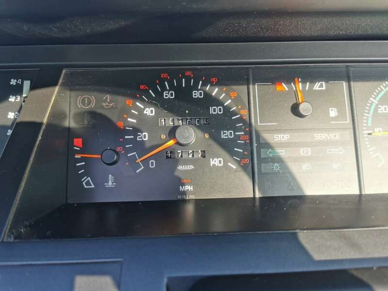

As someone who has always found the different approaches to instrumentation designs between different manufacturers of interest, it has always been a something that drew my eyes and just looks very smart.  Remember my 11 used a similar arrangement, albeit with more normally shaped lights.  Think in the mid 80s this must have really helped with the futuristic vibe of the whole dash.

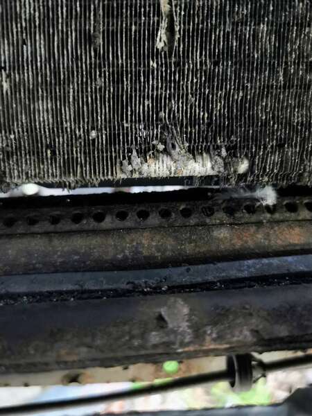

Looks like there are a few options out there for radiators, not cheap but equally not ruinously expensive.  Of course the real challenge will be actually clicking order and seeing if the stock reported does actually exist.  If all else fails it will get a bespoke one made up using the original as a template.  I'd rather not go down that road though as I imagine I'd be looking at well north of £500 for that.

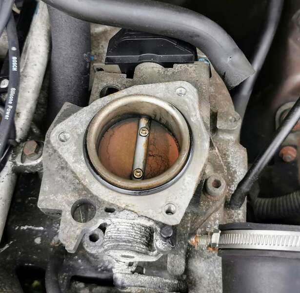

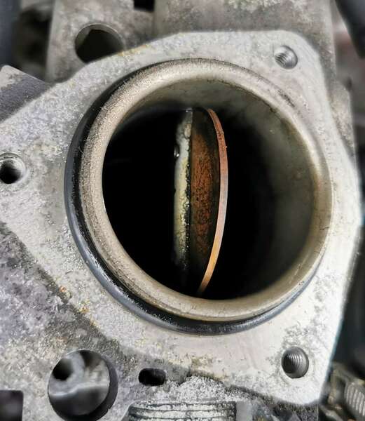

Quick and easy job this afternoon on the Renault, throttle body/plate and IAC valve cleaning.  She's a bit lumpy on light throttle, and definitely stumbles more often at idle than I'd really expect.  Though I think you're feeling that more in the car than you should as I think a couple of the engine mounts are a bit tired.
Given you need to actually unbolt the intake elbow (3x T30 Torx machine screws) to gain access to the throttle body it wouldn't have surprised me to find this had never been done.
Definitely a bit grubby and well due a clean, but it's definitely been done in living memory at least.  IAC valve is nice and easy to get to on this, right on the front of the engine.
So I pulled that off and gave it a good clean while I was in the area.  Wasn't really bad at all but I'd rather know that it's been done.
Haven't had a chance to go for a test run since this has been done yet, not really expecting miracles as nothing was too dirty, but I feel better knowing it's been done.  Plus I can now see there's no evidence of horrific amounts of gunge coming out the PCV system too, though I had no reason to expect that really.

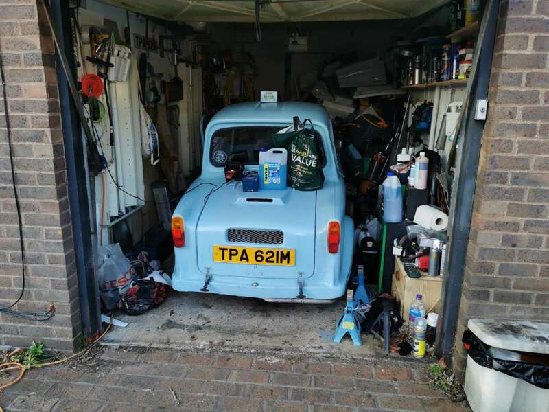

Looking at something rather at the other end of the automotive spectrum, it was time to take a quick look at TPA as I'd really like to get her out for a run this week.
First step: Spend half an hour unearthing her!
Photo was actually after she was parked back in the garage, but you get the idea.

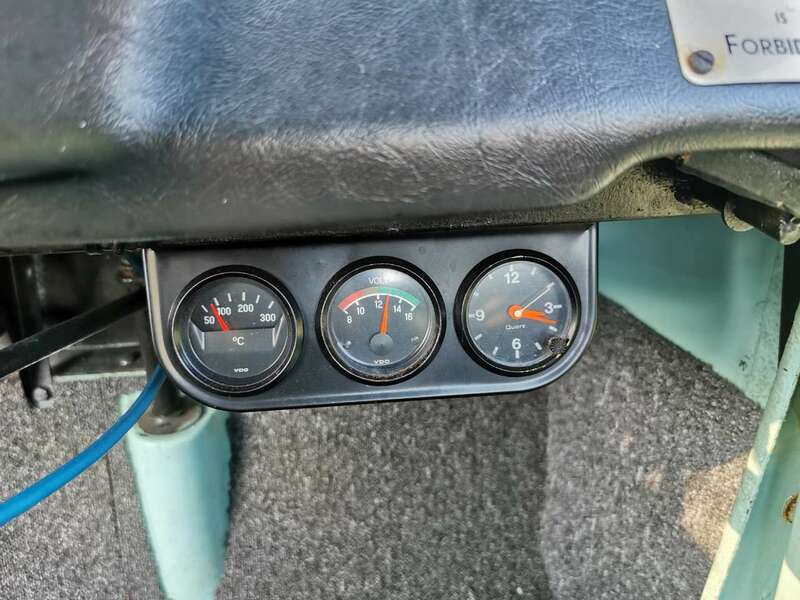

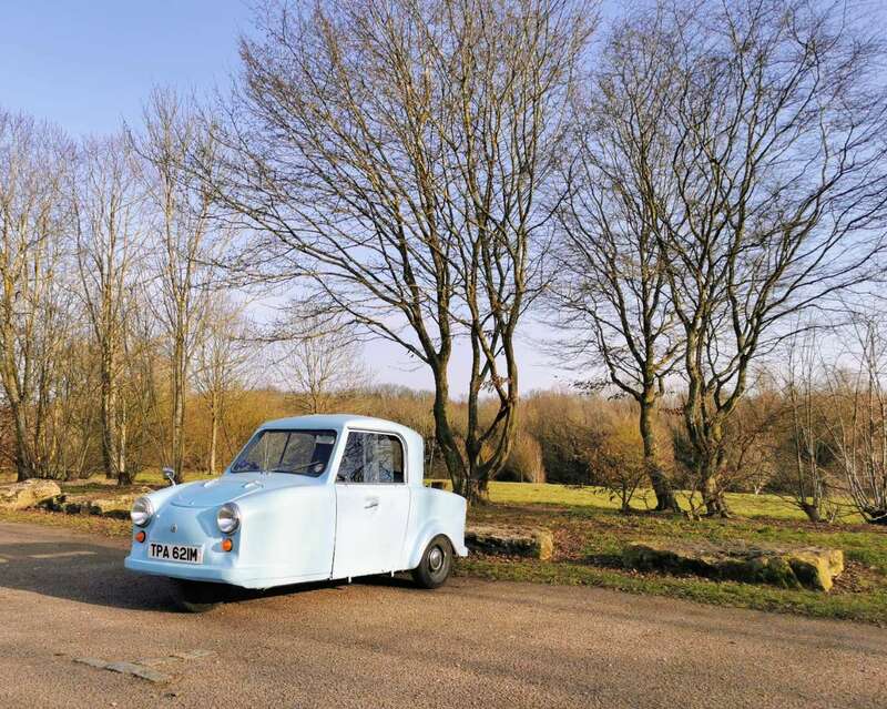

Had TPA out and about today for the first time of the year.  She doesn't seem really worse for wear - though it's only been a couple of months really!  The handbrake does feel a little gummy though so I think some fresh grease may well be in order there.
Hopefully we will be seeing her out and about more as the year progresses.
I think one upgrade that will be ordered up shortly will be a solid state voltage regulator for the generator, as I've noted that when running at speed with a fully charged battery we're seeing close to 16V.  So that's not going to be doing our battery or the electrical system any favours.
Edit: One solid state voltage regulator ordered.  We'll see how that performs when it arrives.

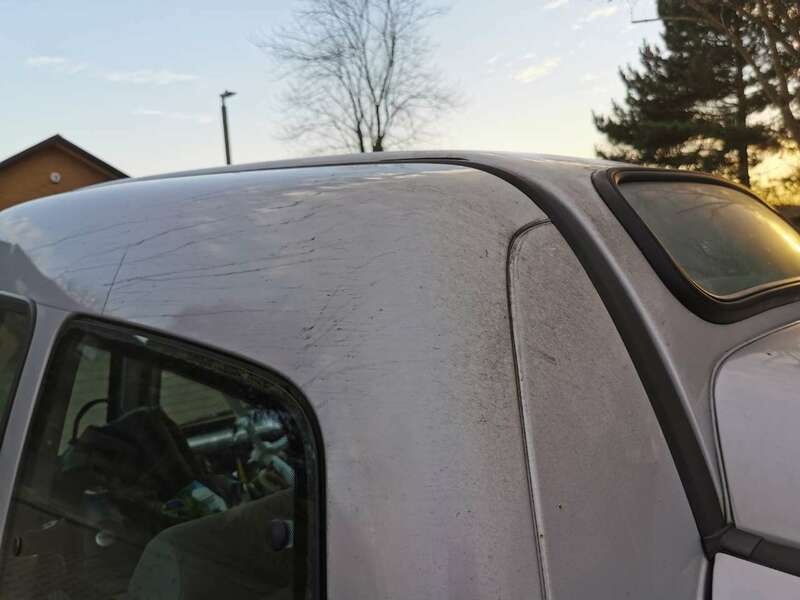

The Renault is also in the bad books today as it broke something without me even touching it.
Not immediately obvious, but the rear of that sunroof has dropped.  I shut the driver's door and heard something go *thud...tink...rattle...* from right above my head.
It appears that the sliding section isn't actually properly attached to the sled - as I have to manually push the panel back though the mechanism is clearly moving freely.  It will close itself up to the point when the rear should pop up to sit flush with the roof.
Things are not all well.  I'm guessing things like this shouldn't be sitting in the gutters.
I can see similar looking things on the driver's side and bits of broken black plastic.
I have a horrible feeling that even if I can find (or make) replacements for whatever has broken, that installing it is going to involve having to remove the whole cassette...which will mean removing the headlining.  Sure that will be an absolute barrel of laughs...
I wouldn't mind so much if I'd tried to open the sunroof, but I'd been deliberately NOT attempting to open it until later in the year!

Today's delivery for the fleet:
Which contained this.
Quick consultation with the workshop manual allowed me to confirm which wires go where.
Plus a trial fit showed the mounting bolts to be exactly the same as on the current regulator.
The only obvious difference is that three of the terminals on the new one require spade connectors whereas they're all horseshoe connectors bolted onto the original unit, so I'll need to re-terminate three of the lines.  I'll likely do the generator output one too unless it looks absolutely pristine.  There isn't much slack in this wiring so I don't want to go trimming ends off anything I don't have to though.
Interesting to see the new unit is made up of two distinct modules.
I'm guessing the smarts of the unit are in the lower bit and there are some chunky semiconductors mounted to the upper part which actually do the work.  Sadly in the absence of owning an X-ray machine that's as far as my examination can really go.
Unfortunately I've run out of steam for tasks requiring brain power today, so it's just going to have to wait till the weekend for me to install.
Given the potential for me to break expensive or difficult to replace hardware if I foul it up, I'd rather not be messing with things like this when I'm not feeling 100%.
Should be a pretty simple job though.  I'll likely take the opportunity to upgrade the wire between the B+ terminal and the positive lug on the starter solenoid (which is where the battery positive is tapped from).  It looks rather weedy to me for something that's intended to see up to 20A if the generator is running flat out.  Given there are two terminals provided on the new regulator I may just run a dedicated heavier gauge line direct to the battery for the charging side of things.
