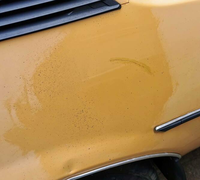

Did a very brief investigation into another very minor thing that was bugging me - this bit of blue overspray from something on the nearside rear quarter.
I wanted to see if it would buff off.
The answer is "yes, albeit with quite a lot of polishing." Also there's a look at what colour the car should be!
Of course at this point it decided to start raining so that's as far as we got.

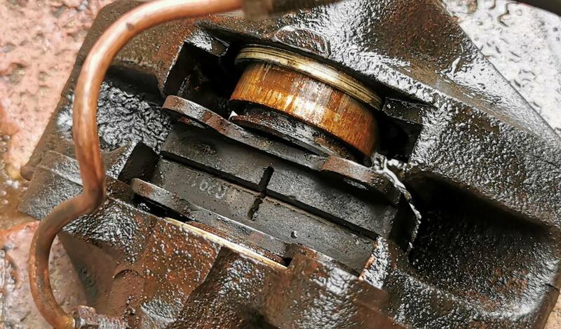

Today on "jobs that would be 5000 times easier if I had a proper workbench with a vice..."
Seeing if I could get the pistons in this free.
It's been stewing in Plusgas for the last few days.
I had a little movement from one piston before, and a combination of patience, compressed air and lots of penetrating oil eventually resulted in this.
It then pushed back in by hand.  So while it obviously needs to come fully out for inspection and cleaning, that side is at least free now.
The other one however I can't get to shift more than a millimetre or so.  However the headache I've been trying to power through since first thing this morning is trying to turn into a migraine so we've downed tools for the day now.
The piston bore of these calipers never need sleeved as the piston and square O ring are the sole elements of sealing contact, as long as the seal groove is in decent shape the bore only has to be cleared of corrosion and general dirt and any burs to allow free and fairly loose passage of the piston when dropped in without a seal fitted
In the past I've taken to heating them and using 2 flat screwdrivers to gently pry up via the piston dust shield lip to gradually start exercising the piston back and forth, it's usually either corrosion formation on the upper bore above the main seal but sometimes the seal bonds to the piston which can involve such joy as welding a nut to the piston to draw it out with a threaded bar etc.

Have got the good piston in this caliper sliding perfectly smoothly through the full range of travel by hand, so I'm inclined to leave it well alone provided it doesn't leak once subject to full hydraulic system pressure again.
The piston cleaned up fine, just a bit of surface tarnish in a few areas.
Given that I will pretty much definitely wind up having to replace the seal if I pop it fully out, leaving it alone makes sense to me for now.
It's been cleaned up, given a good dose of rubber grease and had the (also cleaned) rubber boot refitted.
The other piston however still refuses to move beyond the one point, though is relatively free up to that point.  Getting any leverage on it is bloody awkward and getting heat involved is a non starter because I'm having to hold on to the caliper.  Basically, I really need a workbench with a vice for this job!
Will have another ponder at the weekend, though I'm really just leaning towards sending these off for refurb at this point.  Especially as from what I've read when this car was initially got running and driving back at the field that the driver's side one had to be split and the pads removed to get it rolling.  So it's likely to be far more of a fight than this one has been so far.

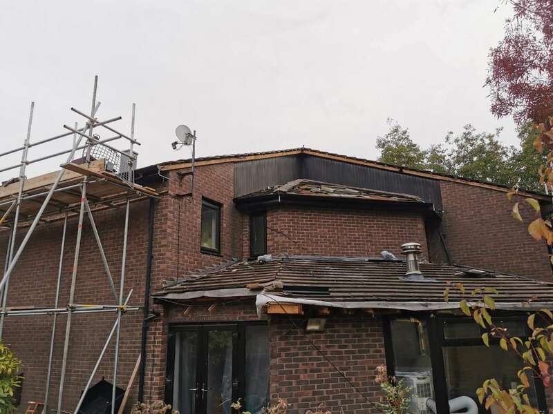

Funny how having a new roof fitted on your house manages to eat up huge chunks of your time.  Contractors are doing all the hard work, but input keeps (unsurprisingly) being needed.  Usually only for 30 seconds at a time, but it means you really can't get stuck into anything substantial as you keep needing to answer the door.
We're getting there.
[] All four roof sections fully stripped back to bare refers.
[] All felt & battens replaced.
[] 4X gable end rafters that were totally rotten replaced.
[] Roof light & support framework replaced (well...not yet, currently there's a huge hole where it used to be).
[] All new ridge tiles.
[] All soffits (all ~90 metres of them) and gutters replaced.
[] A LOT more broken tiles than either us or the contractor had anticipated replaced.  The fact that the tiles had basically been holding the north facing roof aspect together for the last 20 years probably has something to do with that.
In all we're expecting the final bill to come in somewhere in the ball park of £30K.  Isn't home ownership fun.  On the plus side, having all that having just been done will be a nice thing to have listed on the for sale ad when we come to sell the place.

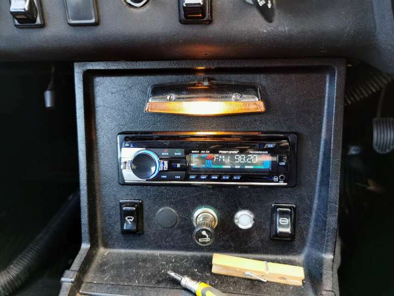

There were a few things she was here to have looked at.  All pretty quick jobs, so ideal to pick away at while remaining in earshot of the roof guys in case they needed me for anything.
[] Non working radio.
[] Dead instrument panel lighting.
[] Missing clutch pedal rubber needs replacing.

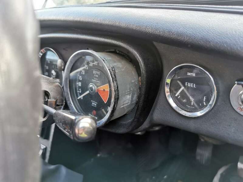

[] Rev counter not working.

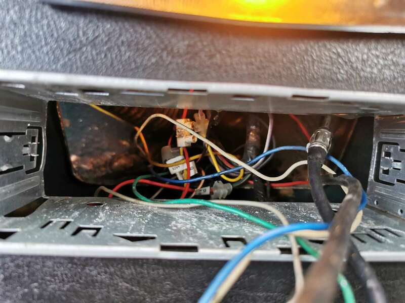

The radio issue became pretty much immediately obvious once I pulled the head unit out the dash.
Yep...not being plugged in would have a lot to do with it.
Turns out this head unit had never been hooked up based on the (very crusty) fitted ISO connector not matching the proprietary one on the head unit.
Helpfully the fitting kit turned out to be stashed in the centre arm rest.
Which also meant I could happen to this mess.
Which I totally forgot to take a photo of after tidying.  However the radio now works properly.
Something more period appropriate has now been sourced and will be swapped in at a future date.  Will be a two minute job at least now the wiring is sorted and labelled.

This of course actually belongs in the indicator lamp for the rest windscreen demister, so was clipped back in there.  Have to wonder how long it is since that last worked.
The panel lights were even easier to revive...after I have the rheostat a minute or so of highly technical wiggling back and forth through its full travel the dash lights were working properly.
Just about visible in daylight of you squint at the right angle.
Which is easier to see after dark.  Definitely back from the era where dash lighting was just what you needed and nothing more.
Quite cozy though, I'd take it over the cold white blindingly bright LED nonsense that's the norm these days.
If I can convince the control to come out of the dash I'll give it a grease up - the knob didn't seem impressed with the idea of being removed when I last tried though, and I'm not going to risk breaking it.
The rev counter issue has proven to be slightly more elusive.  Everything at the coil end seems to be in perfect order, though there isn't a direct connection there I can see, it must T off somewhere else in the loom.  I need to sit down with a wiring diagram to confirm where the signal for the tach is tapped off.
Thought I'd pop it out of the dash for a look, as wiring issues behind there seem high on the likelihood list to me, or the famously high quality wiring connectors used on BMC products of this era causing problems.
Oh.
Well that's annoying.  The tach doesn't quite fit past the indicator switch...I literally need about an extra 1/8" of clearance.  I did faff about with it for a while, but the retaining lugs stick out just far enough behind it that I can't quite get it out.  I intend to revisit this at the weekend.
I have stuck my camera up behind the dash and couldn't see anything amiss, nor did wiggling wires around have any effect.  The tach has briefly sprung back to life completely of its own accord on a couple of occasions, and my gut feeling is that it may well be the unit itself that may be at fault.
We'll be back to this.

Radio - Something more period appropriate has now been sourced and will be swapped in at a future date.  Will be a two minute job at least now the wiring is sorted and labelled.

Thank you for all you work in improving the MGB GT.
I have this Sparkomatic SR 312F Radio/Cass I am guessing from the 1980's.
The roof is very disappointing the original lasted 45 years and in May 2016 I had a new one fitted that is already in the same state as the original after all its years.

That head unit should look far more at home in there I think.  I do need to have another glance back there as I just noticed there are four speakers in the car (or rather two aftermarket ones in the boot plus two grills beside the rear seats - may or may not be anything actually behind them) but only saw wiring for two when I connected things up.  Will double check that.

Regarding the non working rev counter, mine needs a sharp tap on the glass to work and has done for 30+ years since it replaced the original.
Tried that!  It doesn't seem to respond in any way to percussive maintenance.
