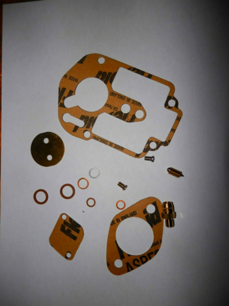

on the carb service kit I think this might do the trick :)  https://www.ebay.co.uk/itm/265075077626
(I do wonder what the 2 brass things on the right are?)
and if you dont want to get it from Italy Im sure haflinger technik would probably be able to help (and failing that, I do know of someone who rebuilt Model 70 carbs in the 1980's for the Ministry so have a load of rebuild kits on the shelf still)
Needle valve and seating.

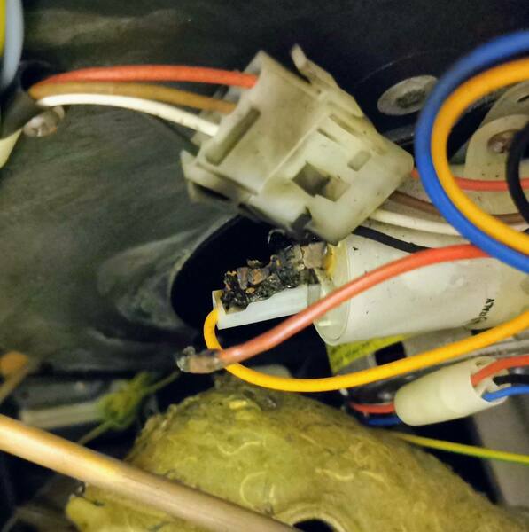

Yesterday evening the air conditioner in here packed in.
Trying to keep this room cool without AC is impossible.  I shut everything in here that generates heat off as soon as it became apparent there was issues and threw the window wide open - was still 23C in the annexe which serves as the actual bedroom at 3AM when it was -2C outside.  If the computer is doing anything vaguely strenuous it will end up touching 30C after a few hours.  Once the room is down to temperature it's not bad to keep it there - but actually getting it down there in the first place requires the services of a heat pump!  The radiator in here has been buried and never switched on even once (seriously - there's a desk built over the top of it now) since 2014!
Fault condition was that the compressor wouldn't start - just made angry buzzing noises for a few seconds before tripping out on the internal thermal overload.
My gut feeling was that this wasn't a physical compressor failure, most likely would be the motor start capacitor which had packed in.
These Seveso units are pretty sensibly designed and are pretty easy to work on really.  Bit awkward simply because there is a lot of stuff crammed into a pretty compact unit, but not too bad really.  I knew from last time I was in there that the start cap was just screwed into the back of the fan cowling.
Hey, look at that...
Yep...one of the leads no longer being attached to the start cap, that would explain why the compressor wasn't starting.
Looks to me like the spade terminal has become a bit loose over time through vibration and heat cycling, started arcing...which made it overheat, which made it worse...until it ate away enough of the terminal that it fell off.
Evaporator could do with a clean too.
Surprisingly the capacitor tested out as absolutely fine...not bad after 30 years.
Snipped the toasty wire back to good metal, crimped a new spade terminal on, connected it up and pressed the button.  Fired straight up.

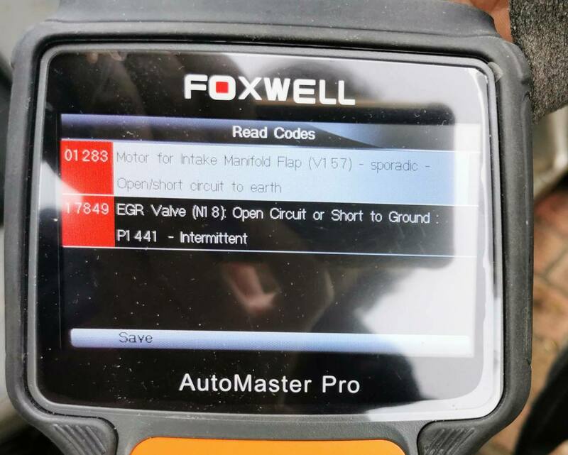

Bobdisk very kindly dropped by today with his diagnostic gizmo to hook up to the OBD2 port on the Caddy.  As we had hoped, a couple of codes were logged.
The first of which is the interesting one.
"Motor for intake flap (V157) - sporadic - open/short circuit to earth."
The second code is expected as it's indicating the solenoid for the EGR valve being open circuit - because I've unplugged it.

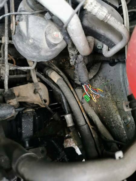

This is really useful as it gives me a component to home in on with my investigation.  First port of call is to make sure the wiring to it isn't obviously damaged as it is quite exposed.  Then we'll give it a good clean, which it really wants anyway.
Apparently this vehicle had issues with the aftermarket alarm at some point, hence it's loom being left in this state.
Alarm sounder end:
Bulkhead end:
Turns out that one of those wires does indeed still have 12V on it too in addition to being a gaping hole through the bulkhead.
I've now found that end of the tail (buried behind the heater box), and each of the wires has been taped, heat shrink covered then the tail as a whole treated the same way.  The actual alarm module is buried up behind the centre console and I didn't have the patience to go chasing that further today.
This lot was pulled out.

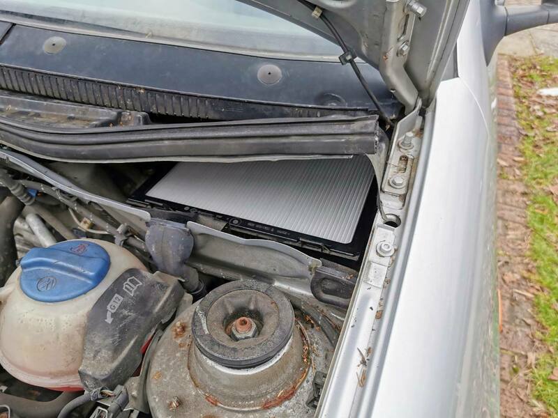

While in that corner I dropped a new pollen filter in.
Far easier than on a huge number of modern cars.  Old one wasn't horrible so has definitely been changed before, but was definitely due a change.

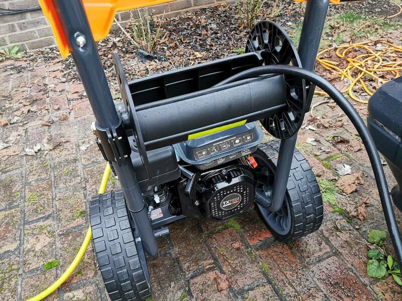

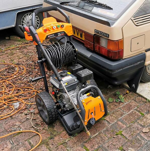

As a follow up to the appearance of this box on Friday, what was in it?
After about half an hour of assembly, this.
Assembly was about as simple as you could ask for - all the necessary tools and some PTFE tape were in the box.
The biggest complaint I'd seen from people in reviews of this unit was that they were managing to melt the hose that runs between the pump and hose reel on the exhaust.  Have to assume they had it routed like this.
Whereas if you just route it like this and stick a couple of cable ties in place it's a non-issue.
Yes the reel is very obviously an afterthought they just managed to find space to bolt onto the frame as it does make access to the pull start slightly awkward.
Really not badly though so long as you've uncoiled the hose, which you're meant to do before starting the engine anyway.
Speaking of the hose...being used to working with a crappy little plastic thing with a 4 metre hose meaning I was forever having to move it round a car while cleaning it, this amount of reach is pure luxury.
That's not even using the additional ten metre extension that came in the box!
Will be so nice not having to keep moving the unit around.  Can just get on with the job at hand.
Fit and finish is a lot better than I was expecting to be honest.  Just a shame the polystyrene packing has reacted with the paint on the frame in one spot.  Everything slotted, clipped or screwed together nicely as it was mean to and I had no issues with sharp edges or burrs on anything.
Engine is your typical Honda clone which turns up on everything from go karts to lawn mowers to generators...and while I'd obviously prefer the real thing (or being me to be honest, a flathead Briggs), I've never personally had any issues with these on any of my equipment or anything I've helped others look after.  If it was being used for hours on end every day, maybe.  For a couple of hours every week or two it should be fine.
It does have a low oil shutoff, which is always nice to have on a piece of equipment like this.
The detergent tank is a nice detail rather than just a hose dangling off to dip in a bottle (which inevitably gets either lost or broken) or an awkward thing you have to clip to the lance like the Nilfisk this replaces had.
As for performance?  Well you'd expect it to have more punch than the 1400W electric ones given the engine here is rated at 5500W if my math is right (8hp).  Yep... that's definitely the case...you properly have to brace yourself when pulling the trigger on this and use common sense as even with the wider nozzles fitted I don't doubt for a second that this thing will strip paint off metal if you're not careful.
Hoping to give it a proper test in the week, today was just a run of a few minutes to make sure everything behaved, and allowed me to blast some of the worst of the gunk out of the gutters and after a dousing in degreaser, the engine bay of the Caddy.  Not an oily engine anyway, just grubby from 20 years of use.  The washer bottle is going to need separate attention, but it generally looks a lot cleaner now.
Cars are much likely to get cleaned now as this reduces the hassle factor massively!
List price for this is £379, though it was discounted to £330 when I ordered it - decided it was a good thing to stick the £100 or so of vouchers I've had sitting around literally for years to use for - plus my nan sent some money at Christmas too...so good excuse for a new toy I reckon!

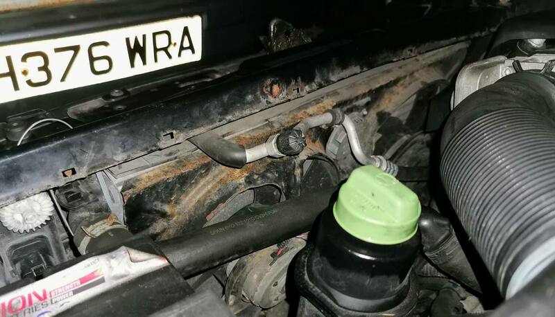

I really need to properly investigate why this keeps happening.
Kind of getting fed up of having to shove it back into place after every other trip.
...Or may just be evidence of how bloody awful the roads around here are!
I do have a question though for folks who know these cars/vans better than me.
Does anyone know how the radiator etc should actually be supported?  The top of mine is currently secured by cable ties (having previously been hanging by the coolant and AC refrigerant lines) as there is no evidence of any viable means for it to be secured to the underside of the slam panel.  I've also completely failed to find photos online of anything which looks like what's in place in my engine bay - not sure if that's just because AC wasn't a common option on the Polo/Caddy back in 2002 or if I'm just useless at internet searches.  It's pretty obviously wrong in most cases though as the majority of them only have a position available for a single fan, whereas I've got two.  The ones I have seen with dual fans show two which are very different sizes, and a plastic cowling...rather than these two which are pretty similar in size (the offside one is a bit bigger) and a metal cowl of quite a different design.  So I'm confused.
I'm guessing that there should be some form of bracket/block/fitting...thing...that secures the radiator to the bolt through the panel on both sides.
There isn't a threaded hole or anything on the radiator for that bolt to screw into by the way - I did wonder if it was that simple, but no.
Attempting to trawl Google for anything helpful has proven completely fruitless...and in fact about 70% of the radiators shown don't even have *any* tab/bracket etc at the top corners shown at all.  I'm basing this on Polo stuff, as trying to search for Caddy specific things is completely hopeless as the search engine totally ignores 2002 and just spits out a plethora of matches for the current models.
I don't think the radiator can be lifted very much as I think the bottom end (which feels like it's located by pegs rather than bolts given it moves pretty freely vertically) will then lift out of whatever retains it down there...which makes me think that there must be something missing between the slam panel and the top of the radiator.  It's one of those situations where I know the solution is probably dead simple, but without a proper diagram of how it all fits together I'm just guessing.

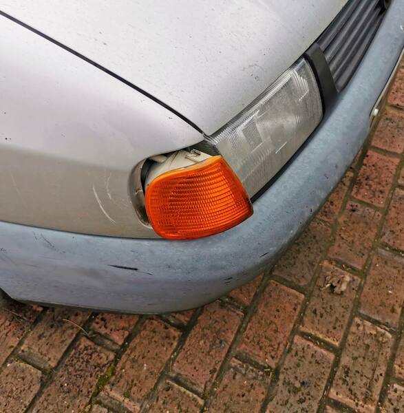

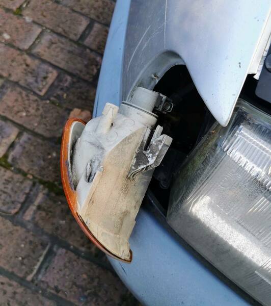

Shouldn't the indicator be held in with a spring loaded clip that hooks into the bodywork further back?
That was a typical VAG thing back in the day*
Entirely possibly.  I'm still quite new to this whole VW thing.  Just not a marque I have any real prior relevant knowledge of - not much common DNA with the T25 I owned years ago.
The ones on my father's Audi pushed in to a degree, then had a spring with a claw hook on one end that grabbed the light, the other end was bent into a V shape with a circular piece to grab and pull so the V would sit in a notch.
Access was via a hole in the inner wheel well. They're under a fair bit of tension and would break the plastic when it got brittle.
Let's sort this.
Looking in there it was pretty quickly obvious that there was indeed a spring clip meant to be involved.
However it was just flapping in the breeze.
Took a bit of figuring out that the spring was actually meant to fit into a groove on the back of the headlight, which has been deformed in this case so it doesn't fit very securely.
It should sit like this, but kept popping out whenever I tried to insert the peg the spring is meant to hook over.
(Front of the van is frame right)
Once I worked that out though it wasn't too difficult to sort.
Fixed.
The plastic tab the spring hooks over does have a crack in it, so I'll likely replace the unit at some point as I imagine at some point the other bit will also break - and the indicator units are dirt cheap so I'm not too bothered about it.

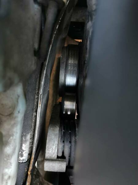

Noticed that there's a slightly noisy pulley in the aux belt area on the Caddy.  It's not bad, but with a long drive coming up at the end of next week I'd rather get it changed as a precaution.  The tensioner in particular looks quite rough so that's my prime suspect.
I'm not used to being able to walk into the motor factors and just get parts rather than having to wait several days for things to be ordered in.
Not sure if it's the idler or the tensioner so I've just picked up both.
Just need to figure out how to de-tension the tensioner, as that's going to be a major part of the job I think.
Hoping it's not a major pain of a job to change.

Okay, that's going to be one of "those" jobs.
Only way to get a spanner (can't be a socket as it's too close to the chassis rail) onto the tensioner to back it off is from underneath, which means I need to get the under tray and wheel arch liner out.
That ain't happening today with how windy it is.
At least the actual bolts holding the tensioner to the engine are pretty easily accessible.  However until I've safely restrained the world's strongest spring that's not a lot of use to me.

[] Properly sort the EGR related engine management issue.  I'm waiting on a supposed good air intake metering unit arriving and we'll see if that does it - the logged error code pointed to issues with the actuator motor in that.  Fingers crossed.  Failing that there are a couple of highly recommended VW specialists more or less on my doorstep, so it will get tossed towards them if I can't solve it myself.

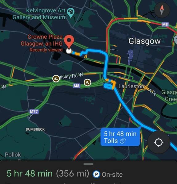

Distance to destination according to satnav: 356 miles.
Let's hope the gods of motorway traffic are in a good mood today.

The carb rebuild kit appears to *finally* have shipped to me...that's taken weeks!  Hoping that will resolve the tendency for it to weep fuel so much.
