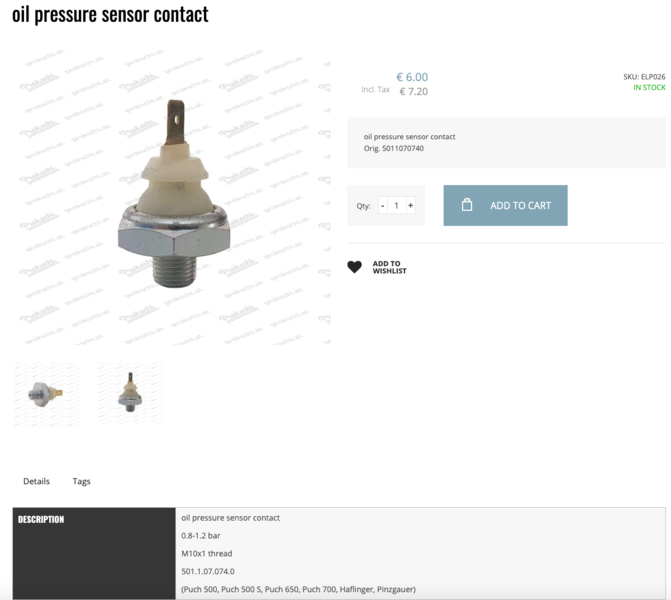

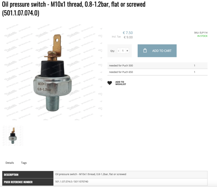

ohh sorry to hear it does not fit after all of that, are you able to put the old one back in in the meantime so TPA is not immobilised or is it one of those items once removed cannot be refitted?
but im Just wondering which one did you order?
as I see 2 listed on their website
this one looks correct
https://prokschi.at/oil-pressure-sensor-contact.html
(who's Bosch Part number is I THINK 0986344041 which if you stick into ebay does bring a couple, including a listing in the UK however quite pricey!)
while this one does not look correct, but looks like the one you received?
https://prokschi.at/puch-500/electrical-parts/oil-pressure-switch-m10x1-thread-0-8-1-2bar-flat-or-screwed-501-1-07-074-0.html
I can't even remember at this point.  It was like February that I ordered it I think.  Plus the website search functionality is bloody awful on mobile so goodness only knows.

Based on that Bosch part number I've got another one ordered, hopefully as it's not coming from Austria this time it this won't take snother two months to arrive!

@Zelandeth and @LightBulbFun  did you mean this one ?    https://prokschi.at/haflinger/electrical-parts/oil-pressure-switch-m10x1-thread-0-8-1-2bar-flat-or-screwed-501-1-07-074-0.html
Oh, they all come up with "404 not found"  /  now   / 20 min later, they do work 🤔
5 hours ago, bobdisk said:
Now, at 07:00,the links go "404 not found "again !!!!!! Am I doing something wrong ??
both links work fine for me?
but if for some reason they refuse to play ball on your end here are a couple screenshots
16 hours ago, PhilA said:
Just by looking at that picture I can tell you the new one is 1/4" NPT. Far too modern/American!
if the thread is not even M10 as described on the listing I wonder if Zel could get a refund for item not as described!
or if an email could be sent to the shop asking what the deal is so maybe other Steyr puch owners are not caught out in the same way?
The oil pressure switch that has come off looks like a bog standard switch that is probably used in dozens of other applications.  I'd look at identifying the thread, the length and the switching pressure, and I'll bet there are switches listed for lots of other applications with the same spec.
Might need someone to actually look in a catalogue, rather than trying to look it up on a parts computer, but the information will be there somewhere.

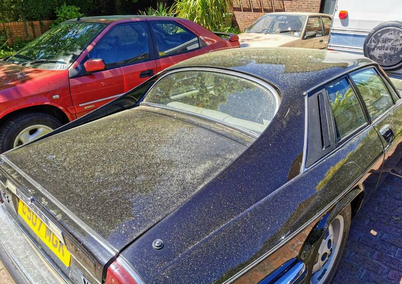

You can tell the trees around here have decided it's summer today.  The Jag was black this morning...Not now!
That's all pollen!  Thank goodness I don't get hayfever!

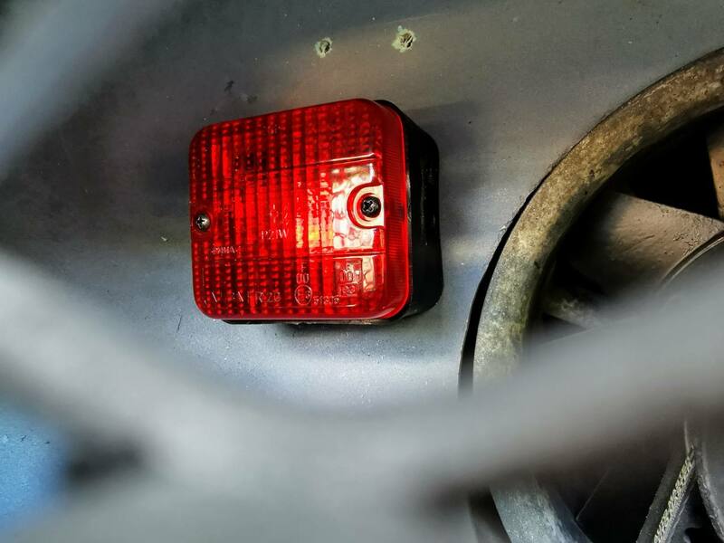

Also picked up something for the Invacar which had been at the back of my mind for a while.  Someone mentioned it a couple of days ago elsewhere and reminded me of it.
Not what you think.  I'm not just bolting a fog light to the bumper.  I'm going to be fitting a hidden auxiliary brake light as I've nearly been rear ended in the car twice so far and I know that the original brake lights weren't great in 1973, never mind compared to what dozy Milton Keynes drivers are used to in 2021.  This will be tucked away in the cooling intake plenum behind the grill on the engine cover so it'll be essentially totally invisible except for when it's lit.
The thought occurred to me that while I'm there I may as well add a reversing light as well - not because I want it to provide me with light to see by - but as an indication to other drivers that I'm reversing.  Not having one means that nobody will ever let you back out of a space in a car park and things...It's just something that it's nice to have.  For the sake of £3 of light, a switch and a bit of wiring it just makes sense.  I'm using  (and enjoying using) the car a lot more these days so little creature comforts like that are the sort of things which just make day to day life more pleasant as she's obviously not going to be leaving the fleet any time soon.  Does mean I'll need to track down another period appropriate looking switch and indicator light for the dash though.

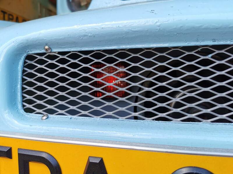

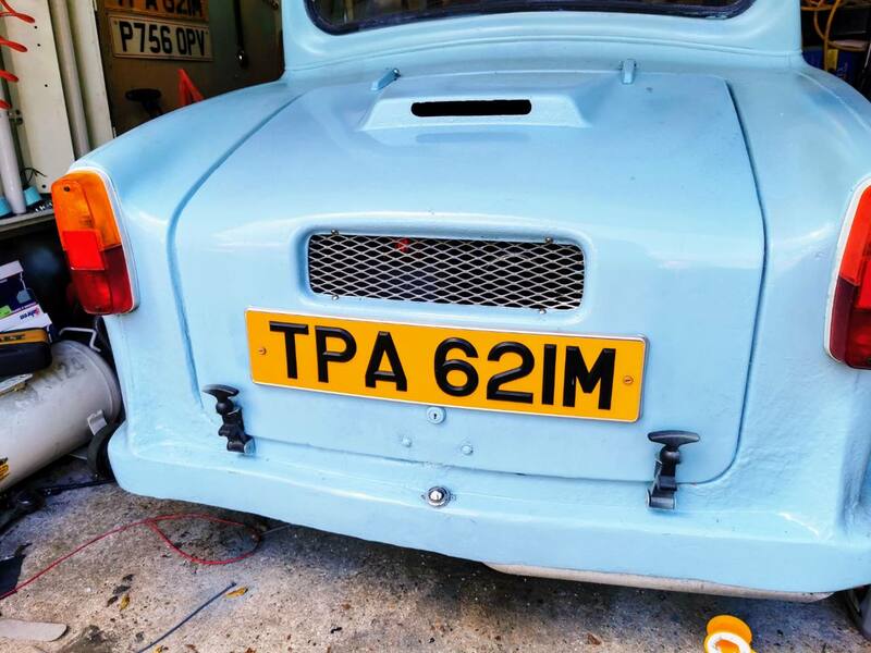

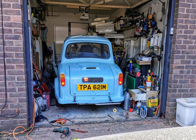

That was pretty painless.
Spot the difference?
Cue CSI style "Zoom, enhance..." sequence.
Yes, I fouled up the first time round and fitted it way to high up.
Then how it looks from average sort of driver head height when lit.
The photo doesn't do justice to how much brighter it is than the factory brake lights.
Will need to epoxy on a couple of lugs to the underside of the engine cover to hold the wiring in place to tidy things up but that's not massively urgent.
I don't *like* it, but just feel that it's kind of necessary with the standard of driving I see around here.  It should be a good deal more conspicuous to anyone following than the somewhat weedy original brake lights.   At least it's barely visible when it's unlit and you really wouldn't spot it unless you knew it was there.

Had TPA out today and can confirm that the brake light upgrade has had a noticeable impact on the behaviour of people following me - they definitely seem to back off when I brake now whereas a lot of people seemed oblivious to the fact until they realised I was visibly slowing down.
So mission accomplished I reckon.
I do wonder how much of that is the brighter brake light or actually the fact that an area of the car that no one would expect to light up, suddenly lights up up bright red and sort of caused the snap to attention if that makes sense? (where as brake lights are always there and always red even when off, so when the light up its less of a noticeable change especially if the person is particularly dozy)
glad to hear its doing its Job tho :) (might look at doing something similar with REV knowing how similarly cut throat it is around here)
