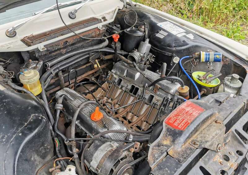

Starting point today:
Ish.  That's a photo from a week or two back, but you get the idea.
Couple of hours and a small amount of swearing (mostly at the bracket the throttle linkage/kick down cable attach to) later...
Note that some of the intake manifold bolts are different, so keep them in the order they came out.
The choke cable end is really frayed so definitely wouldn't be going back into the linkage on the carb if I took it out, which is why the one carb is just tucked in the corner.  There's plenty of length of cable available to keep it out the way so I figured I'd just leave it alone rather than adding to my immediate to do list - though the cable does want changing longer term.
Can't really see anything useful looking down towards our offending valve.
At least not that I'm able to interpret.
It's not something obvious like a bit of rag having got sucked into the intake anyway, so the head will have to come off to investigate and resolve whatever is going on.
That will be the next step.  I'm not touching the exhaust manifold bolts, the join to the downpipe has clearly been apart relatively recently (the bolt is still shiny) so it will be getting split there.
I was really quite surprised with how clean things were under the intake gasket/valley cover given that these engines don't exactly have a reputation for internal cleanliness.
Again kind of wishing I knew better what the story of this car was.  I almost wonder looking at this whether this engine has had at least some rebuild work done (the water pump and timing cover gaskets externally look bright enough to be essentially new), and it then just sat around for a long time before developing this problem when fired up eventually.  I did note when it was running that there was very little apparent blow by.
Nothing really found yet, aside from a surprisingly clean looking engine anyway.  We'll know more when the head comes off.

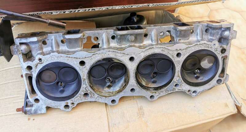

Here's a closer look at number 5.
Then it's neighbour number 7 which I know was firing just fine.
It does look like the intake valve on 5 isn't seated quite as deeply as on 7.  We'll get a better look when I pull the valve.
There's a bit of tarnishing in the cylinder, but I've seen (and run) worse.
I am slightly suspicious as to whether this gasket had sealed properly.
Especially around here.
I note it has what appears to be a 2019 date code.
Which if it is indeed a date code suggests someone has been in here relatively recently.  Which probably explains why the exhaust manifold just unbolted without any hint of protest.

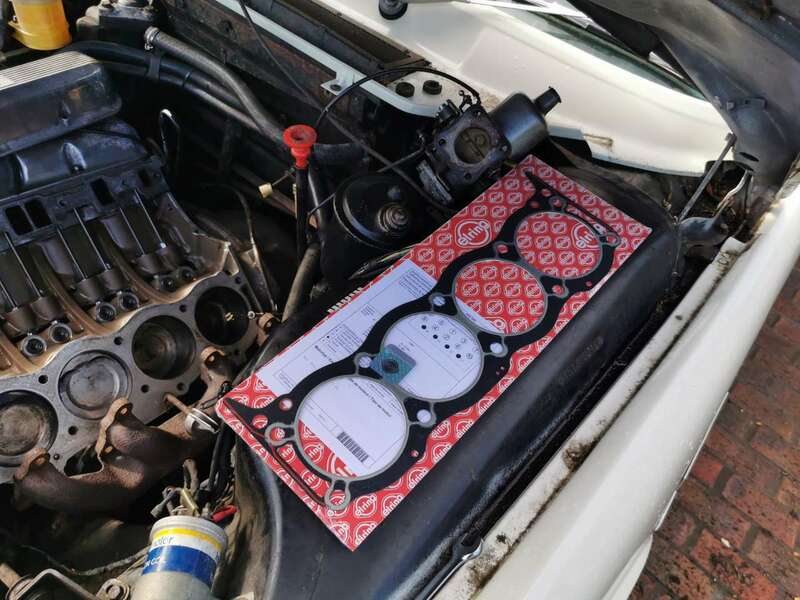

Speaking of gaskets, there will be a slight delay before things go back together (obviously investigation of my issue and cleaning will take a bit of time anyway).  Spot the deliberate mistake.
Yeah... someone managed to order gaskets for a two rather than three row head...despite checking three times.  I do despair at my mental capacity sometimes.
before you blame yourself, are you sure someone did not stock pick the wrong part? I mean from what I have heard about certain online parts suppliers on here, theres a good chance you might of just ended up with the Starter motor for an ALX400 :)
Nope, this was definitely me.  I know I had both options open while I was determining which one I needed...best guess I just closed the wrong damned tab!  That's what I get for ordering stuff while tired.
Y tho?
Probably worth putting Petrol (or water) on the top of that head and see if it leaks through the valves.
Might get lucky in just a pulling, cleaning of the valve and regrinding in may fix it if it's not sealing.
Leak test actually didn't reveal much.  Which made me even more suspicious.
There is always some pressure against the valves because of the spring in the hydraulic tappets providing some pre load.  So it's possible that if a valve wasn't seating 100% with that bit of pressure present, it might be without it - if for instance we had a slightly bent valve or something like that working against us.
With the valves pulled from number 5, no signs of damage to the seats at least.  Things have just had a really quick wipe down with a rag here.
