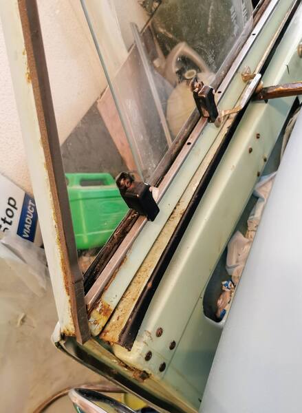

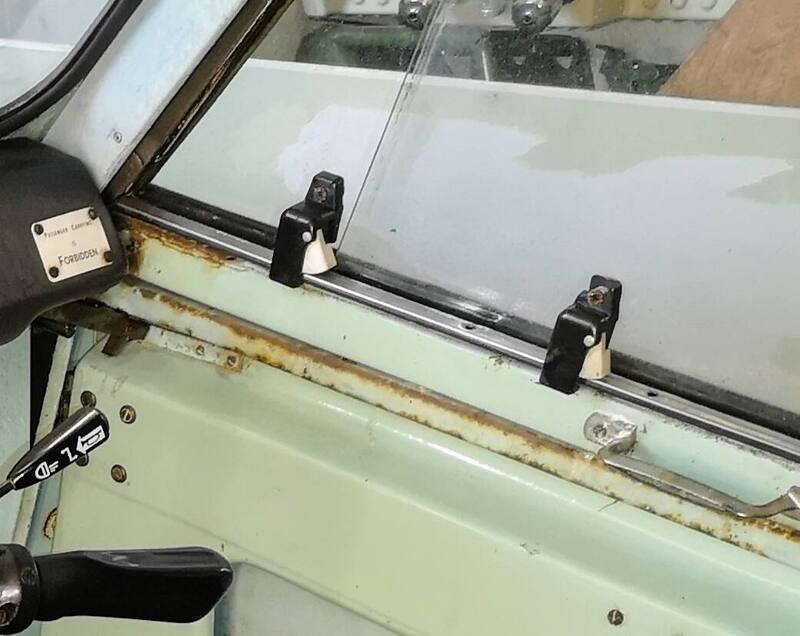

Yes, IIRC they are all four different. The front of the front ones slope to match the angle of the front of the front side window glass and the back ones are vertical to match the vertical front edge of the rear glass. Then each side is a mirror image of the other. I don't know if Invacars ever had them but Minis also had a "fuzzy strip" seal which pushed onto the rear edge of the front glass to stop the draughts.
yeah I think so :)  if your referring to this felt? strip going through the middle of the photo here?
That's the thing. Actually fits on to the front of the rear glass or they can get nicked even if the car is locked. Doesn't look like TPA has them. Would help the weatherproofing and certainly reduce the cabin noise if it had some. They used to go missing from a lot of Minis because they normally only push on, but I suppose they could be glued. In the above picture the front and rear catches look the same so I wonder why they had different part numbers.

yeah, I THINK theres some of these strips in the spares stash which if that is the case @Zelandeth is more then welcome to it as as im concerned :)

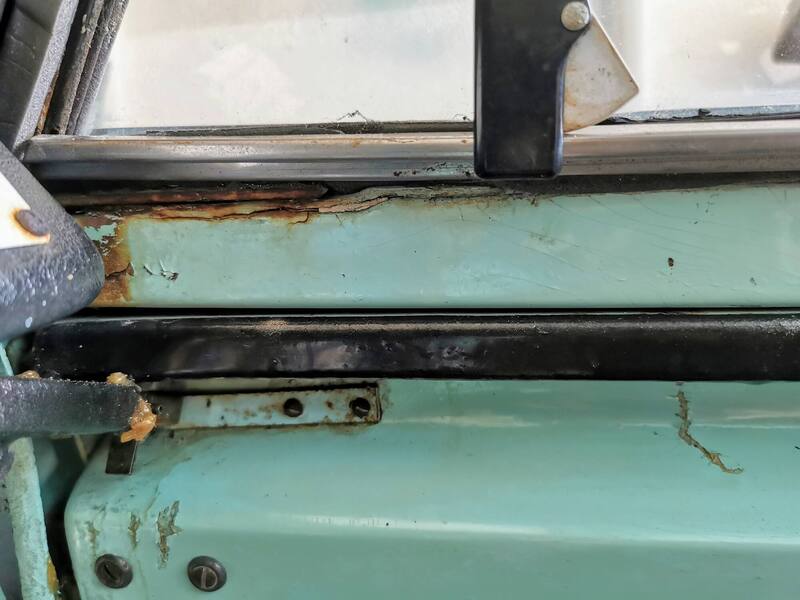

thought just occurred to me, is it because the 2 window panes are at different depths, but both catches have to line up with the same holes in the window trim
so the catches would have to be different thicknesses if that makes sense?
Yeah, those Mini ones look to be the job.  Though I have to ask HOW MUCH?!?
I've got the vertical weatherstrip on the nearside window but the offside one is missing (well, not missing but so utterly rotten as to be useless).

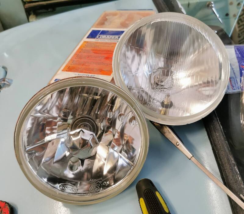

  See also headlights...The ones I bought to replace the horrible clear lensed things on there currently are absolutely identical to the ones advertised as for Minis and Land Rovers - but not having those words in the title seems to reduce the price by at least 50%.
I'd be willing to stand for £20 or so, but at £50+ they're having a laugh!
If the headlights are the same as Minis and Land Rovers, they are also the same as Morris 1000, and any other British classic of the era, (Rover P4, P5, MG Midget, MG B, Triumph Herald, Hillman Minx. BMC Farinas and many more)  that has them, They are Lucas 7 inch Sealed Beam. Not sure, but I think the bowl is also the same. so there is a variation to choose from.
https://www.morrisminor.org.uk/parts/54-headlights
https://rimmerbros.com/Item--i-GRID005448
I would put H4 Halogens in, better than tungsten, which is what the sealed beams are. Not original perhaps, but I have a thing about lights must be good. What exactly are those you have?
The ones currently in TPA are modern "upgrades" for Minis etc (different slightly to MG, Minor and Land Rover as they also include the sidelights).  They were bought in error for another car years ago.  They actually work well, just look awful on the car.  As the headlights I had were shot they made sense for recommissioning purposes though.
The ones I've bought are standard looking H4 units intended for Minis etc. Just for £25 rather than the £60 odd that exactly the same thing simply labelled as what it was rather than specifically naming the Mini.  So visually they will look identical to the sealed beam or equivalent units that would originally have been fitted.
Of course, you are correct. It can clearly be seen in Zel's picture in the next post to yours that the front catch is much wider than the back one so that it reaches from the outer glass to the same set of holes in the runner.

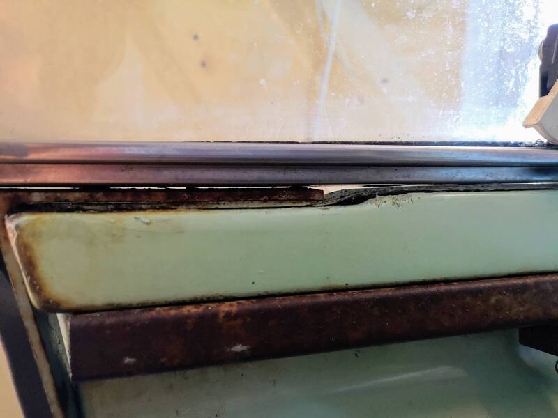

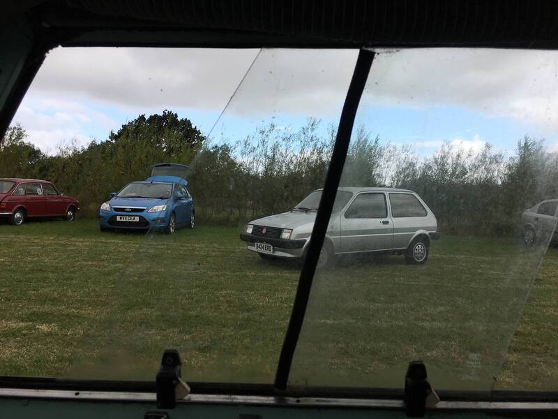

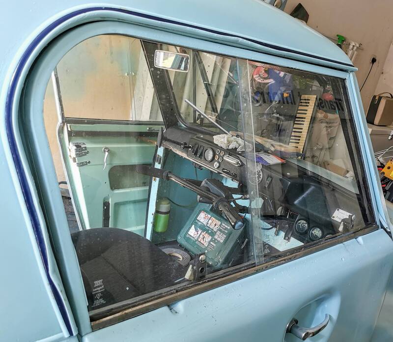

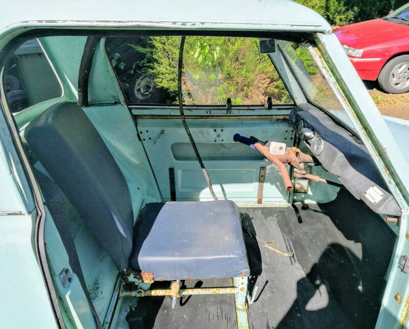

Well after nearly three hours of swearing and nearly passing out from heat exhaustion the offside window runner is sorted.
Look, no daylight!
Here's a "before" image for comparison.
(From the opposite side, but they were pretty similar).
The channel rubber is pretty knackered but will do for now.  It does at least hold the glass properly now.
Really don't want to have to do that again!

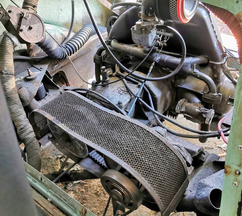

Having got the door back together it was time to reattach the gear selector to the gearbox.
This job is most easily done from underneath, though jacking the car up would have meant taking the car out of the garage and working beneath the deadly ball of death that is the sun today.  Not happening.

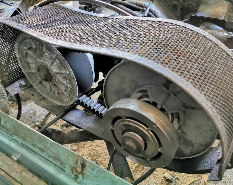

I wanted to inspect the pulleys, CVT belt and check the oil levels in the gearbox and diff - all of these things want the rear service hatch in the cabin out, so figured I'd just work from above like last time.
Pulleys look perfect.  There was quite a bit of surface oxidisation on the primary pulley when it was fitted, as I hoped though it's cleaned itself up through use.  Lovely satin smooth finish on both of them now.

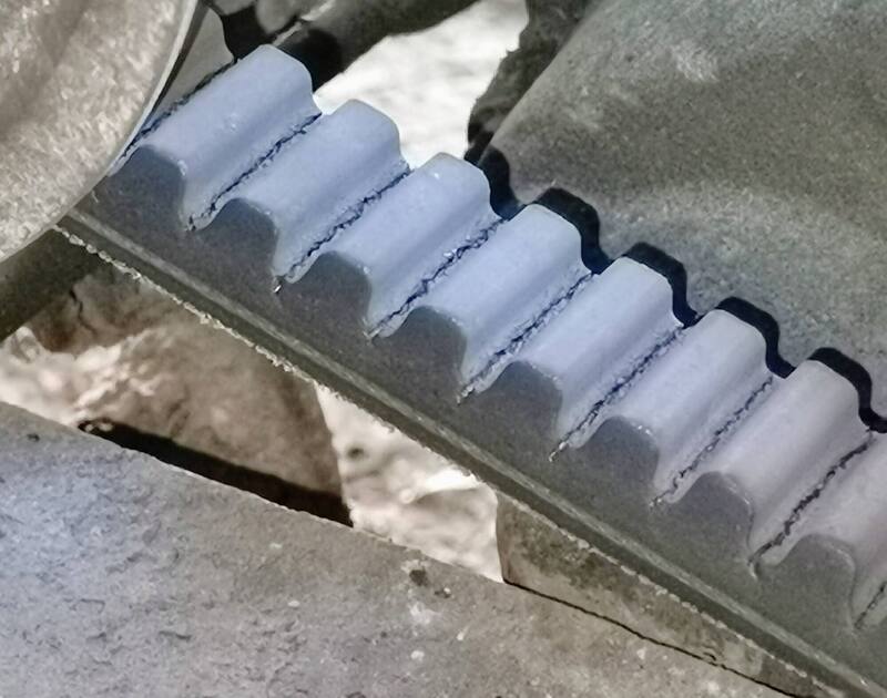

Belt also seems happy enough.  The manual states very clearly that cracking between the teeth on the belt will happen early during its life and shouldn't be considered a sign of impending failure, so I'm not worried about that.
It's really noticeable that before the pulleys were replaced that this whole area used to get covered in finely atomised belt material during any run.  No noticeable deposits anywhere since last time I was in here though so that behaviour seems to have been purely down to surface corrosion on the old secondary pulley.
The gear selector was originally attached to the selector arm on the box by a roughly 1/4" diameter roll pin, held in place by a split pin.  I was missing this because the replacement selector I fitted (the original one in TPA was totally siezed) didn't have it, and no amount of effort was able to shift the original one from the linkage.  Originally I fitted a bolt in this location and used a locknut arrangement to try to stop it loosening itself over time.  Apparently this didn't work as since then I've lost two bolts.
Annoyingly the replacements I have, presumably because they're a metric size, don't fit.  The smallest size I've got that fits drops straight through, the next size up won't fit.  Adding an extra washer to the smaller one adds enough length that I can't then get the split pin in.  So we will need to use a bolt then for the time being.
It was at this point I had a bit of a brainwave.  There are two pivot joints on the gear linkage of this type.  The lower one (the source of my problem), then an identical one where the rod actually pushes/pulls on the actual gear selector on the box.  The lower one is an absolute swine to get to other than from underneath because there is a load of pulley and belt in the way.  The top one however is near enough level with the top of the gearbox pretty much and is readily accessible.
So I took the standard coupler out of the top pivot and installed that in the hard to get to bottom location.  I then fitted a bolt and lock nut to the top one.
The fact that I can actually get to it makes it possible to easily do the locknut up *way* more tightly than I probably managed last time.  I also put a blob of thead lock on it.
At least if it does drop off again in future replacing the thing will be a five minute job as it's dead easy to get at.
I do get the impression that I may need to look at replacing the gearbox seals at some point though...

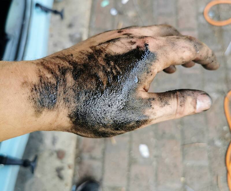

Still out of gloves.
I'd been literally dripping with sweat since about two minutes after leaving the house so called time at this point before I wound up passing out from heat exhaustion (showing 36C in the garage by the time I called it).  I'll check the gearbox and diff oil levels tomorrow before I button the service hatch back up.

One real bonus of having a wide angle mode on my camera now is that it's way easier to get group fleet photos.
Obviously I'll need to take another one once the Xantia returns from the garage, but I've been meaning to do this for months so wasn't going to miss the opportunity.
I enjoy how many extremes of the automotive spectrum we have covered in that one photo.
Love the wide angle shot :) (I also quite like the general short of the CVT setup/gearbox/rear of engine, its much better then my photos!)
Looks like my new Daf belts. They have never been used, but I suspected the cracking was due to age. Will post a pic after a few miles to see if they have changed (When its back on the road in a few weeks)
The important things for the belts are the taper angle and width. The taper is the most critical as while it might require a bit of trial and error, it should be possible to mitigate slight width differences by tweaking the distance between the pulleys (a bit of math could probably figure out how much change would be needed).
I've got two or three spare belts here so it's not something of immediate concern, just would be nice to know that it's possible to switch to a modern one in the future if supply of the original ones becomes an issue.
The impression I'm getting is that they're actually pretty resilient to the passage of time so it hopefully won't be too massive a headache.
In extremis, it should be possible to create a trimming tool/jig that could create the right taper and width if a belt of the right length but too wide is available; ultimately that's how the maker gets the belt profile in the first instance.

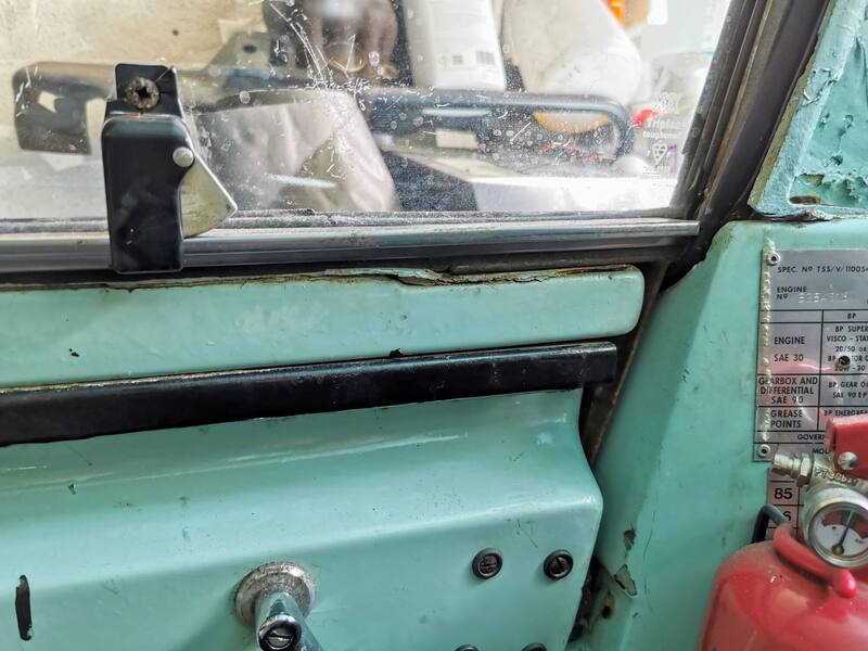

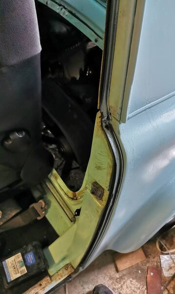

Before I called it done on the offside door I wanted to get one last issue ticked off while I still had the drill and such out - that the upper runner channel (normally held on by several tiny self tapping screws) had pulled out of the door at the front.
I drilled a couple of new holes and secured it with proper bolts with large penny washers behind the panel to better spread the load.  Hopefully that won't cause is any issues in the future.
Then once I'd resecured the seal in a few places I called it good.
That door is still a pig to get closed sometimes and doesn't run properly on the lower runner so I will need to pull the whole lot apart at some point.  I think that the rollers are knackered or seized to the axle they sit on.
While I was fiddling with door seals I resecured the one on the nearside door which had started to peel off yet again.  I've given up on gluing these in now after the third or fourth time and have just screwed it to the frame.  Yes, I know that's not how the did it at the factory...but I'm sick of having to clean everything off and try a different type of adhesive every two months...and Sikaflex seems like overkill which is about the only thing I can think of I've not tried yet!
I do have a full set of new door seals for this car which I'll probably get fitted soon as these are a bit dog eared in places.  It's a pretty low priority though.
I checked the oil level in both the diff and the gearbox and despite the visible leak they were both still showing as spot on.  Before I went to put the service hatch back in through I wanted to make an improvement to the fittings for that.

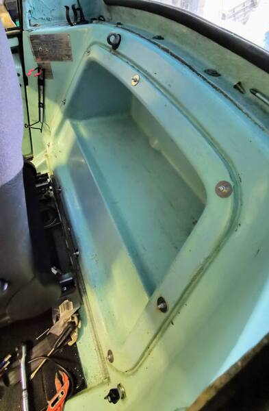

Originally this was secured by moderately large self tapping screws which screwed into spring clips behind the panel - all but two of these had dissolved in my case and required me to drill them out to get the panel off.  Trying to get the screws into the bottom two holes is also nigh on impossible given that I can't just pull the back of the seat off with two bolts because I'm not using the original seat.  Even having replaced the spring clips in there I've found that the screws tend to loosen themselves off over time as well.
My solution was to stick a bolt through from the back side, sandwiching the bulkhead panel between two big washers, essentially giving me studs attached to the bulkhead which I can then bolt the cover down onto.
This is the first time that I've ever actually had this really solidly secured in place I think.  It made getting the thing in way, way easier as it just slotted onto the bolts rather than having to spend forever trying to wriggle it around until all the holes line up and I can get the screws in.  I'll be curious to see if this has had any impact on the noise level in the cabin.

it will be interesting to see how the more period looking H4 halogen head lamps compare to the not correct looking but work very well set :)
do agree tho the Ring set do Look much better :) hopefully they still work satisfactorily!

Can confirm that the slightest gap around that cover makes a massive difference to noise levels. I once went for a drive without it at all. That was a mistake!
Having it securely bolted in place all the way round with a thick foam gasket seems to have reduced the number of squeaks and rattles from behind me by about 90%...just the doors now that make a racket on poor surfaces really.

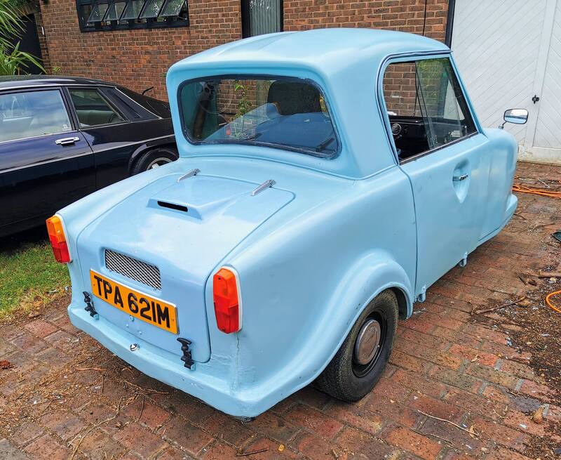

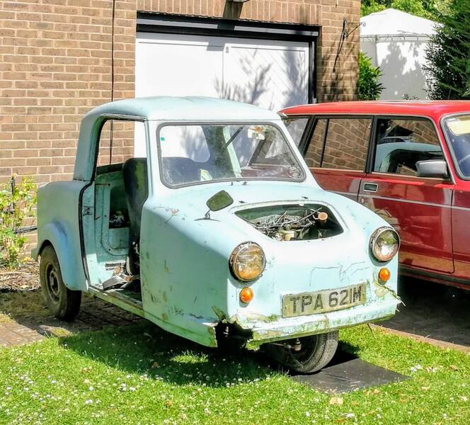

Really wishing I'd set the camera up today...TPA has been very much confusing other road users.  Not least the bus full of people we just overtook going up a hill.
Wanted to do a test to see how she would hold speed on a gradient. Lowest recorded speed on the A421 on the hill heading out of MK towards Bedford was 56mph from hitting it at 60, which I'm absolutely happy with.
She's done 40 or so miles all over MK today under all types of driving conditions and I can't fault her at all.
Being absolutely honest I'm really surprised how capable a car she seems to be given the reputation these vehicles have.

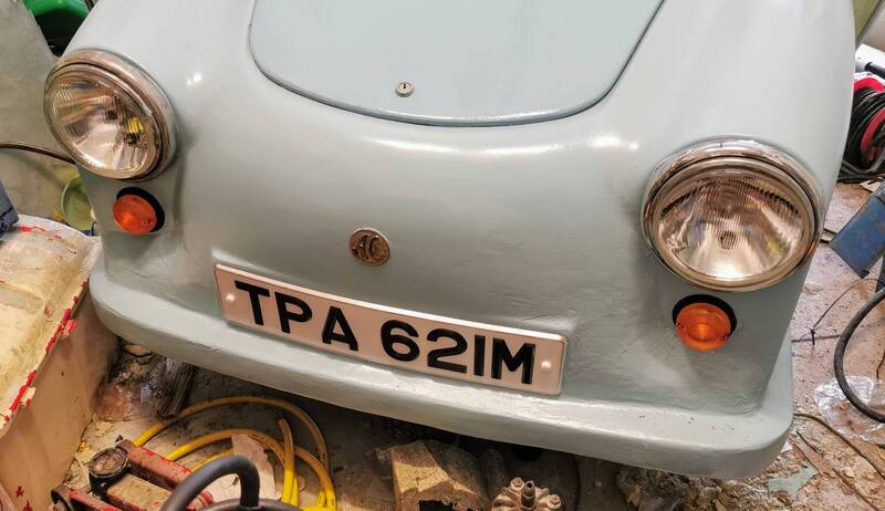

Here are a couple of updated "profile" shots with the new lights and engine cover fasteners on, and after I gave the interior a clean today.
The one thing I really wanted to check after a period of really hard high speed work was to see what the oil temperature was doing.  I'd made a point of painting the bottom of the oil pickup strainer Matt black so I could get a good reading with an IR thermometer.
That's absolutely perfectly reasonable I think.  Looking at the gauge I'd fitted that's about 1/3 on the scale.  I'd deliberately been working the car hard before jumping out to get this reading.  I'm not massively surprised by this given the ample size of the oil cooler but it's nice to have confirmed.

1 hour ago, Zelandeth said:
I Love shots of Model 70's from these sort of angles the way they are good at hiding the front wheel it makes it look like the front end is hovering/floating off the ground :mrgreen:
I think the biggest issue, is people are "colour blind" when it comes to these vehicles, they see all the different types, as one singular vehicle, just an "invacar"
so the Model 70 unfairly gets tarred with the same brush from all the other types
just recently for example I noticed in your Retro rides thread someone talked about cleaning up after one involved in a RTA, where he clearly said "because it only had 1 door" well thats clearly not a Model 70 then is it!
and its not helped by the fact a lot of people have never actually driven or experienced a Model 70 first hand, and people just slag them off with no real basis to it,
and finally also not helped with how people where jut brought up and in general where sadly not very nice to disabled people in general, see all the not very nice names these vehicles where called by kids and grownups alike back in the 70s and 80s etc
so a lot of people just cant/refuse to look these objectively as "an car" sadly
it is really interesting to see how much better TPA performs compared to TWC, I do have to wonder if TPA (and by extension her engine now fitted to TWC) has actually gone round the clock, especially given the oil leaks TWC (ex TPA)'s engine is now experiencing as well as clearly being down on power
(I have seen a couple Model 70's showing 90K on the clock! :)

if its Triplex screen (which I think it is, I know all the other windows on a Model 70 are) then there should be some dots/dashes around the Triplex name, exactly like the date code on on a fluorescent tube :)
I cant recall how to decode Triplex codes but I know a couple other members might :)

Don't know about laminated screens but the Triplex toughened glass windscreens were date coded with a dot under one of the letters of the word "TOUGHENED". Only 9 letters so no dot = 19x0, dot under the 'T' = 19x1, dot under the 'O' = 19x2, ... , dot under the 'D' = 19x9.

Despite a few folks having cautioned me on how poor these tyres are I didn't notice any issues today even when dealing with quite heavy surface water.  Definitely was using caution though as I knew with so little weight on the front it wouldn't take much at all to cause aquaplaning.
The novelty of looking in the rear view mirror and seeing three rather than two clear bands of road behind you on a wet surface will take a while to wear off.
The weatherproofing is definitely massively improved over when I got the car but still needs work.  Some water is still finding a way in around the nearside of the windscreen (though at least far enough over to clear my knees now) and I will obviously need to put some rubber washers under the bolts holding the window runner channel down as it drips into the door cavity along the bolts themselves.  Overall though given the absolutely torrential level of the downpour it wasn't bad at all.  The windscreen leak is the one which needs the most urgently sorting though as it has the potential to drip into my shoes.
