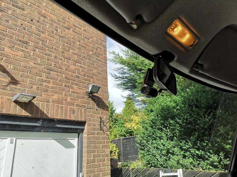

Task one for the afternoon, get the correct lamps back into the headlights on the van as I was satisfied the LED experiment had run its course.  While it was an interesting diversion, they aren't road legal so there was never any intention of them staying in there beyond getting some test images photographed.
Looks much less jarring with things the right sort of colour temperature.
Something I did while I was there was to clean up the offside headlight a bit.
While it's hard to catch on camera it was very obvious that quite a lot of light was being scattered by dirt on the inside of the lens.  Quite visible looking closely at it.
That can't have been doing anything any favours.

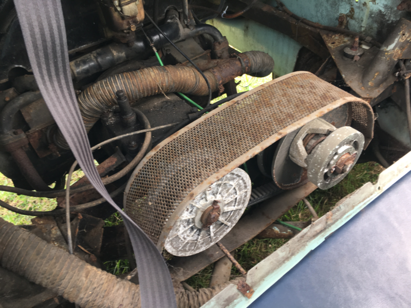

The engine mount is the big chunky beast immediately rearward of the crankshaft pulley.
The mount is just the rubber block and a metal plate under it (it's essentially a bigger version of the ones I mentioned arrived today), the retaining bracket it bolts into is just how it's attached to the chassis.  I had to transfer that over because *someone* took an angle grinder to the one in TPA when removing the original engine...
Goodness only knows what they sourced that out of.  The engine sits resting directly down on that, so it lives a relatively easy life.  The one on KPL was serviceable, the only reason it had to be changed was that I couldn't get the bolt out of it when I needed to get the engine out and would up destroying it while trying.
Unusually the only other places the drivetrain is supported is at the end of the outriggers from the front of the gearbox.
You can see one in the foreground here (having already lost the outer plate).
These fell to bits on KPL when I tried to remove them, but due to the rear wheel tubs being missing they had been essentially open to the elements for a couple of decades.  UV alone can destroy quite a few types of rubber over that sort of time.
Unless they're visibly sagging or you get obvious symptoms like judder when moving off or excessive shunt when coming on/off the power when underway (a bit is inevitable with this type of drive due to the tensioned side of the belt swapping under this situation) I'd not worry too much about them.

Yep. It relies on the engine and box being rigidly bolted together, just attached to the car at three points.
The "engine mounting bracket" could be even more complicated if you want to go by vague descriptions...the bracket between the gearbox mount and the box itself is just bolted on...as is the bracket on the bodywork that the main engine mounting block bolts to...

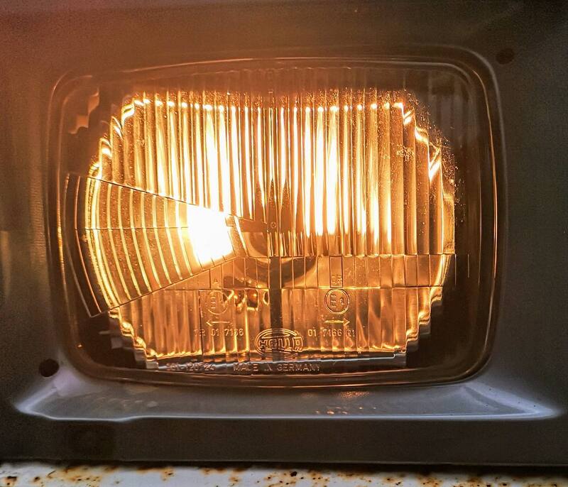

Another afternoon primarily spent in the garden, just had time for one little tinkering session before shutting up shop for the day.

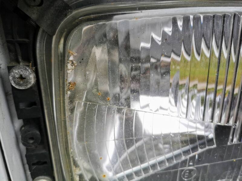

Figured I would see if I could make one good headlight out of one knackered old one and one decidedly mediocre modern replacement.
The original N/S light unit was still sitting in its box in the scrap pile, because I've not cleared that stack out in ages.
Pulling the lens reveals that the reflector is indeed knackered as I'd suspected.  This really didn't provide any useful beam at all despite still having at least something of a shine to most of the surface.
The bung that the wiring harness is supposed to pass through on the way into the headlight had been dislodged on this light, so I suspect water ingress through there is the main reason this is in such a poor state compared to the other one.
Ten minutes of cleaning later had the lens looking nice and clean, like new you could even say...goes to show how durable glass actually is I guess.
Comparing it side by side with the Depo one, the features in the Hella one look far better defined.  Everything looks a bit "soft" on the other one.
Original Hella one is on the right in the image below.  What you can't tell from the images is that the Hella lens is nearly twice the weight of the Depo one.
The seal fitted to the Depo light was just a generic foam strip as well rather than a properly contoured seal, so that was reused from the original light.
Despite the glass being a good bit thicker, everything fitted together just fine.  The fact that the lights now visually match again satisfies my OCD tendencies.

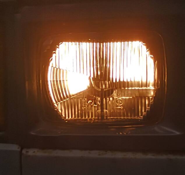

Glad to report that aside from looking better, the beam quality is vastly improved.  Bit hard to see here in daylight, but hopefully you can see that they are much more evenly matched now.
A *little* difference is still to be expected I think as the lamps aren't matched - the offside one is a Halfords own branded R2-H4 upgrade, while the nearside is an ancient Osram H4.
Might try to get a better photo once it's dark just for comparative purposes.
Beam image is clearly far better defined now though.
This image obviously is flipped the other way up by the time it gets to the road due to the wonders of optics (the downward kink to the left of the image is what actually forms the kick up to the left of the beam on the road).
For comparative purposes (and because the photo I got yesterday was poor because I was too close), here's the offside one.  They're pretty well matched now.
So hats off to @dollywobbler for the suggestion of making one headlight out of the two...It was definitely worth swapping the better lens over, seemed blindingly obvious once it was suggested but the idea hadn't occurred to me until it was mentioned.  Having had a closer look, it would be quite a bit tricker to convert an LHD one as the lamp is indeed rotated slightly - so I'd need to detatch that assembly from the back of the reflector without damaging it and get it properly aligned.  When there's a company who can restore a unit for £70 a side (at least it was a couple of years ago) it doesn't really seem worth going to that degree of faff when you're still going to be looking at £30-50 for the headlight anyway and then still needing to do all that messing about...Based on my prior attempts to detach things from reflectors, probably breaking the thing anyway...Reckon if I don't stumble across another O/S headlamp at the right price I'll just get it refurbished if it gets worse to the extent of being an issue.  It's not as though I do a huge amount of night driving these days anyway.  Thankfully, given I'm in the Xantia more often than not and while that car has many great qualities, decent headlights are not among them.

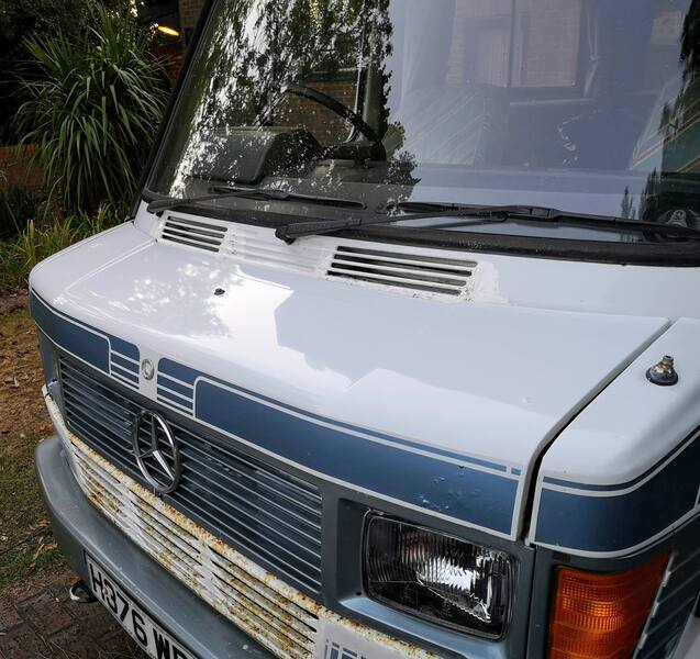

Aside from the obviously rusty front apron, the worst bit of the cab was the sandpaper like texture of the bonnet.  I'd done a bit of that by hand originally so knew it would come up well...heck of a lot quicker with mechanical help!
I need to stop procrastinating about it and just buy a new bonnet.  The vinyl graphics are basically holding the offside corner together.  Yes it's £150 (at a guess £300 delivered, painted and with the graphics remade) but hopefully shouldn't need to be touched again... especially as I'll obviously rustproof the snot out of it before fitting.  If going down that road I should probably just do the apron at the same time... imagine that would do a massive amount towards tidying it up though... likewise trying to sort the ridiculous panel gaps...the bonnet was obviously refitted by a blind monkey at some point...
The thought occurs as well that if I painted the whole windscreen scuttle with the same colour of white it would help make the rust look rather less obvious...

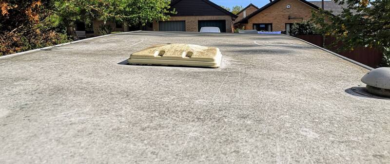

Speaking of the roof...yeah... it's been a few years since this was clean.
That front roof light will be getting changed soon.  That one does leak very slightly under really heavy rain... probably just needs a new head of sealant around it, but as the frame inside is cracked in a couple of places it just makes sense to change it I reckon.  Sadly I suspect finding one in anything other than white seems unlikely these days...

It may be an illusion, but have you checked the headlamp voltage on the van? They look a little on the yellow side. And as you probably know, it's quite a steep exponential curve of output versus voltage.
Should have mentioned it - the engine wasn't running when those photos were taken, so yes they'd be a bit on the dim side.

Need to do something about the paint.  The clear coat peel is getting utterly ridiculous now.  Exhibit A: Offside front wing.
The radiator grill and front bumper are now 80% clear coat free.  Bonnet would probably be just as bad if it hadn't previously been resprayed.  There are a lot of sweep marks there though.  Exhibit B:
Historically I'd tended to try to be gentle with the paint to try to avoid blowing any more of the clear coat off...think it's got to the stage now I can forget about that as it's just so patchy now.  The areas where it's failing have turned distinctly orange too rather than red which is just making it worse.
Interesting to see that if you hit the layer beneath the clearcoat with cutting compound, it actually polishes up reasonably well and the right colour.
So I think I may well just attack the thing with the pressure washer and then the polisher... I'm hardly going to make it worse!
Have now mostly finished the cutting phase on the first side of the van.
The new foam heads I got for the polisher work way better than the one which came with the polisher, especially on the troublesome blue dimpled bits.
Clouding was cleaned from the windows easily.
It didn't threaten to remove the graphics like the original mop was doing either.

Pretty well hidden away behind the rear view mirror...which was high on my list as I have having stuff like this sticking out like a sore thumb.
Can't see it from the driver's seat at least.
Wiring routing was a pain because everything is so solidly attached...dropping the headlining 1/8" to tuck the wire in required both sun visors, the rear view mirror, the passenger grab handle, both door seals and the blanking caps where the grab handle on the driver's side would be.  Over engineering can be a pain sometimes!

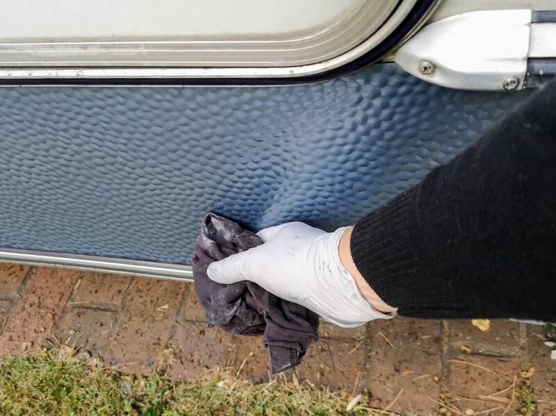

One of the biggest things which made the van look highly shabby was the paintwork on the nearside.
It had a lot of fun like effects on the blue dimpled sections and a lot of staining on the white section below the waist level rubbing strip.
Especially up close it looks horrible.
I had attacked this area with some polish by hand before and found this to have precisely zero impact on it.  This evening I decided to hit it with some proper cutting compound and the power polisher to see if that would be more effective.
Yep... that's an improvement.
Haven't done the white bit in front of the door yet as I was rapidly running out of daylight...but even so reckon I must have taken ten years off it visually in half an hour this evening.  Need to either paint or replace the grab handle by the door too...
There are still a few "runs" visible in the blue section but vastly reduced, so reckon I may give that a last going over before throwing polish and liberal quantities of wax at it.  Reckon this is the result of someone hitting it with TFR in the past.

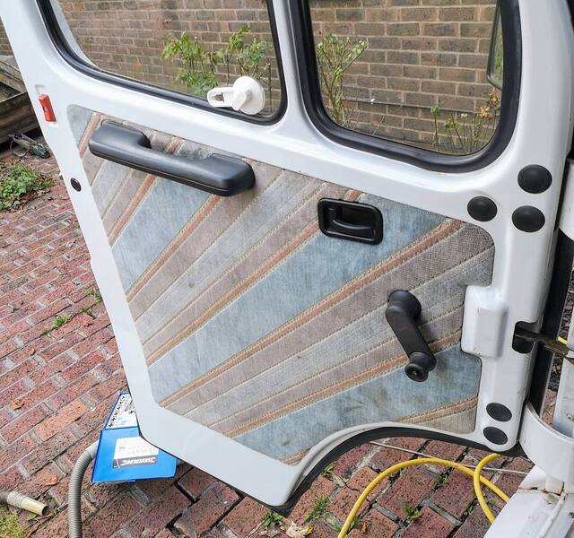

Biggest issue I've been noticing in the last couple of week is a downright horrific squeaky rattle in the cab coming from the passenger door.  This was rapidly driving me insane.  The window winder on that door has never worked in my ownership of the van, though the window could be manually slid down by a couple of inches.  So a suction cup had been employed to stop it from dropping open.  I was pretty sure that the rattle and the dodgy window were most likely connected.
The moment I started stripping things down I immediately became suspicious.  The screws holding the door handle on were cross threaded and this was found wedging the captive nut in place...
Yes, that's a self tapper held in place with blu-tac.  This suggested to me that I was very likely to find that Billy the Bodger had been messing around in my door.
Yeah...I wasn't quite braced for what greeted me when the door card was removed.
Okay...that linkage should be straight.  It's a good 2mm thick, so must have taken some serious effort to bend!  This was wedged around the wrong side of the window runner and jammed against the base of the door, presumably to keep the window up.  Cue a bit of investigation to try to figure out what on earth was going on.
This appears to be the root cause of the trouble.
This fits through the whole assembly, with the coil spring slotted into the back of it.  Now I need to track down a diagram to ascertain whether something has broken off this or whether there's meant to be an external clip to hold everything together.  It looks like there may originally been something involved with a square section involved.
Before I could do anything though I needed to try to get the linkage back into something vaguely resembling the right shape.
I've no idea how they bent it like that...but getting it back involved getting it cherry red with the MAPP torch and battering it with a 4lb lump hammer.
Better.  Though they've managed to bend it in this axes too.
Don't think this will stop anything from working though.
This allowed me to reassemble things to prove that everything was there fundamentally - I stuck a bolt temporarily in the place of the aforementioned fastener just to hold everything together for testing purposes.
Well that looks a bit healthier doesn't it?  You can see the scratches by the bottom of the window runner showing where the lifting quadrant used to be.  The cable ties are locking things in place just now as the bolt through the middle allows a bit of movement so the winder doesn't reliably stay meshed with the teeth on the quadrant.  As stated though this was purely a test.
I think once I've sorted that "thing" in the middle this should be back in action.  The teeth on both the winder and the lifting quadrant look perfect, the runners all seem fine etc.  Just need to figure out what bits are missing and replace them.
While I had the door apart I took the opportunity to make sure the drainage channels were clear in the bottom of the door and vacuumed thirty years worth of detritus out of the bottom of the door.  The paint is flaking off quite badly in several areas, so it will shortly be getting drowned in rust convertor and cavity wax.
Reassembly required a little remedial work too as I'd mentioned earlier, the screws holding the grab handle on were utterly cross threaded and good for nothing but scrap.
Luckily the ones on the driver's door were fine so I was able to confirm the screws were standard M6 items.  The nuts in the door responded fine to being chased out with a tap.
Suitable replacement screws were sourced from the drawer of random fasteners and the door put back together.
The suction cup previously holding the window up can go now...it was mainly being used to ensure the glass didn't drop on my head while I was working inside the door.
While I've not had a chance to take it out yet, it doesn't rattle at idle any more and now clonks shut rather than clatters shut...so hopefully will be quieter on the move.  I do need to look at adding some sound deadening in the doors though as they do drum something rotten...I get the impression some Dynamat (or similar) could knock a huge percentage off the noise levels in the cab.  Replacing some of that which has been removed from the bulkhead and floor when welding has been done in the past probably wouldn't go amiss either.
