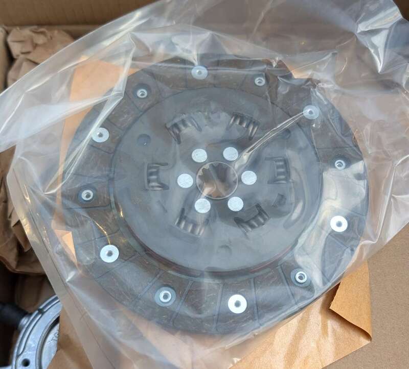

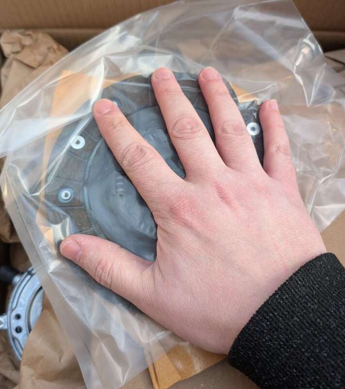

First item I fished out was the new clutch friction disc.
Which is definitely the smallest I've seen on a car.  Hand for scale.

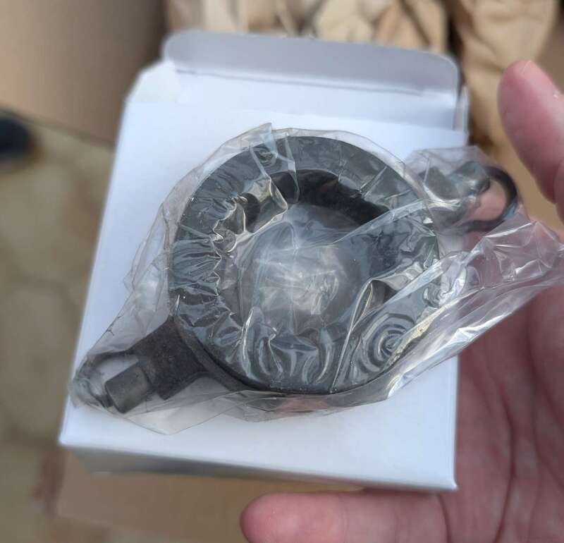

Clutch release bearing.

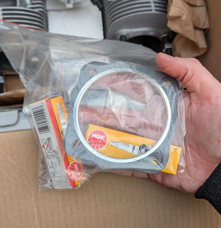

Head gasket set & spark plugs (handy as the new pair of plugs I originally picked up were the wrong sort and I'd forgotten to order more).

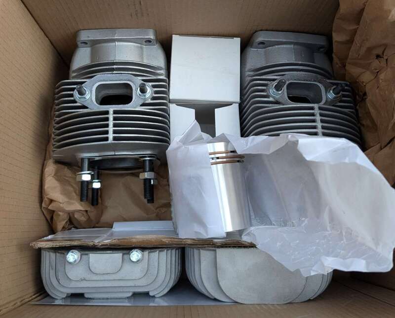

New jugs, heads and pistons.  Seeing things like this that are well...new...is kind of strange.  Never mind for something that's not been in production for going on 35 years.

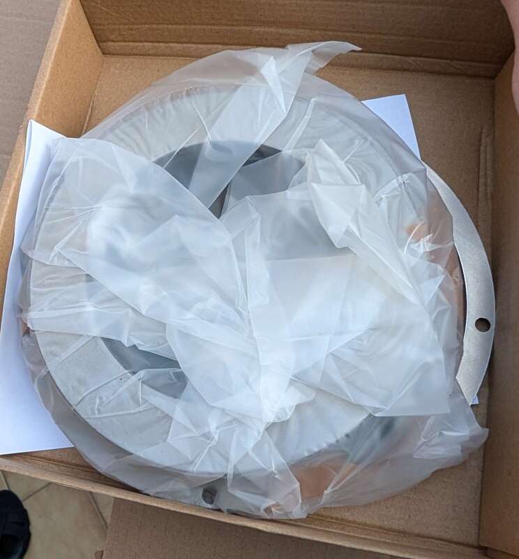

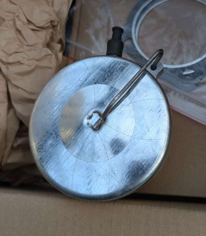

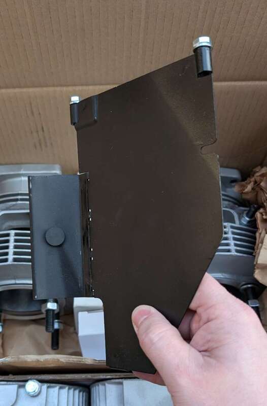

New air guide plate for between the cylinders.  Didn't know this was included.

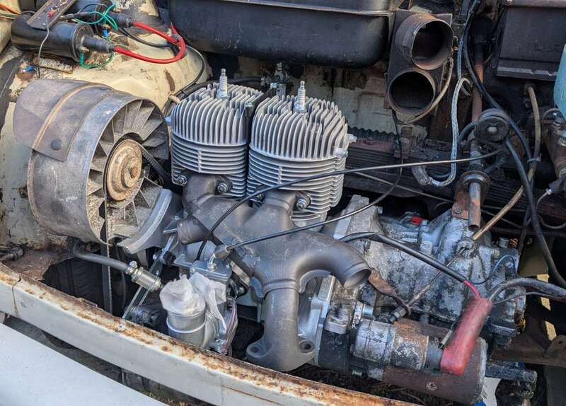

New exhaust manifold.  This is one which has had the air jacket modified to provide the additional clearance needed to accommodate the larger (in particular taller) carb.  Usually fitting that means losing the preheater duct for the cabin heater.  This allows that to be retained and the heater to work as designed.  This does actually make a huge difference to how effective the heater is.

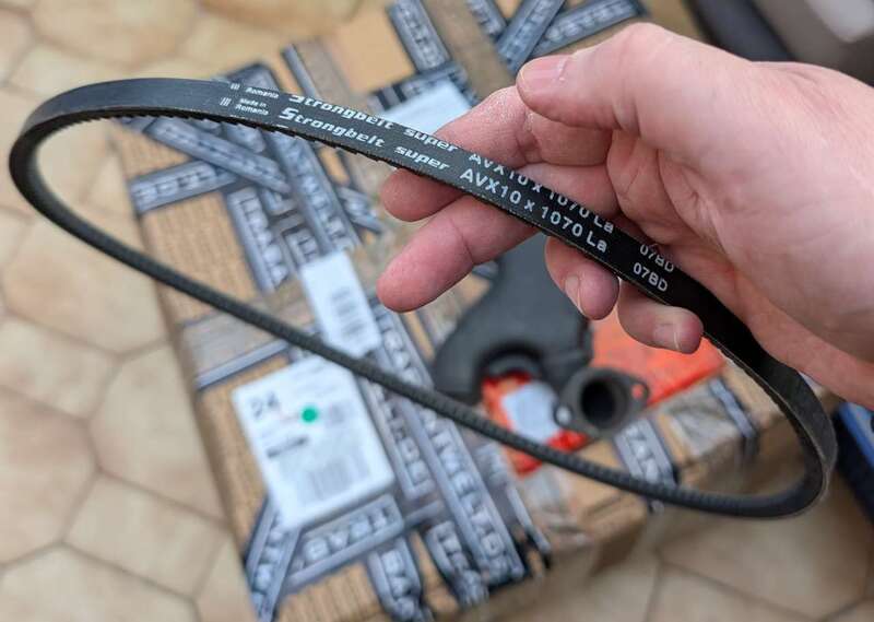

New fan belt - a slightly different length to the stock one.  A modified alternator bracket is another part of the Mikuni carb upgrade, and necessitates a slightly different belt length (longer I think).

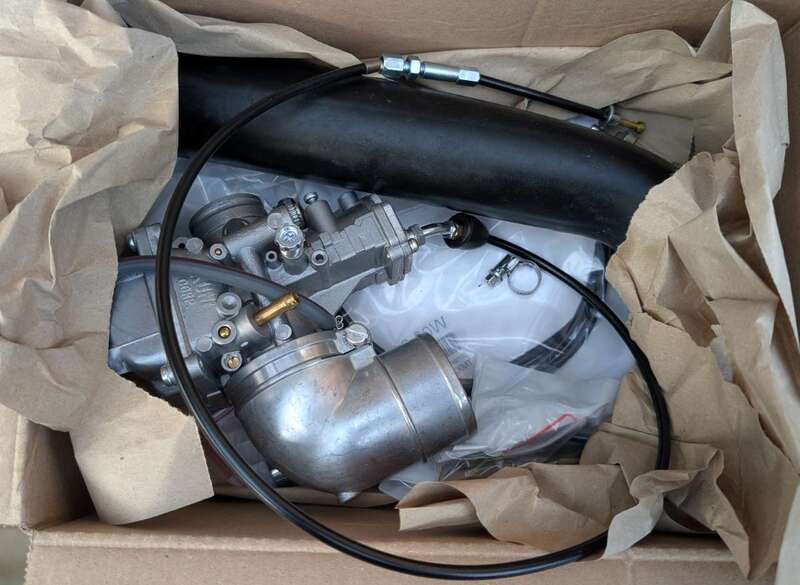

One shiny flat slide Mikuni carb and the required larger bore air filter duct.  This has already been jetted and tuned for this engine which should save me a fair bit of time.

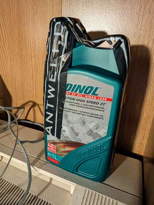

Random bottle of two stroke oil which seems to ship with all their engines and rebuild kits.

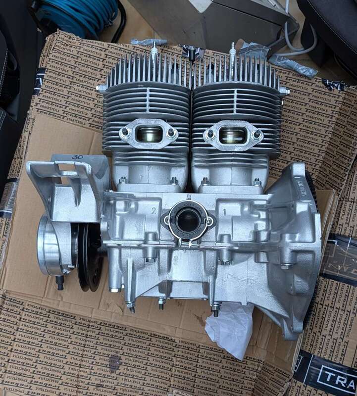

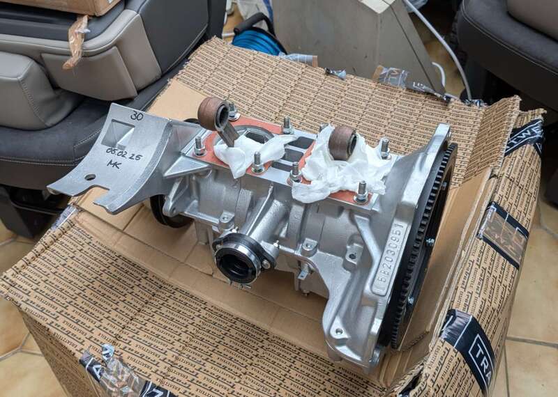

Finally the main event.

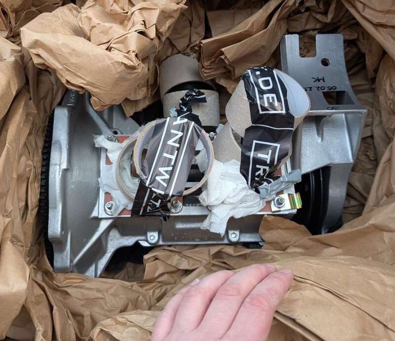

One shiny new engine core.
Normally this would have been shipped with the cylinders already fitted, they had to be split to get the weight of the packages down to a point where they could be shipped via their usual DHL setup rather than having to resort to freight which would have been a major headache as far as customs arrangements would have been concerned due to changes which came in at the end of January.
This crankcase also has the necessary adapter to accept the Mikuni carb already installed.
So with this lot all here we can start getting the car back on the road now.  Hopefully get the old unit pulled out shortly and get the necessary bits transferred over.

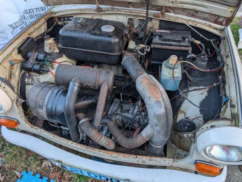

Where were we with this again?

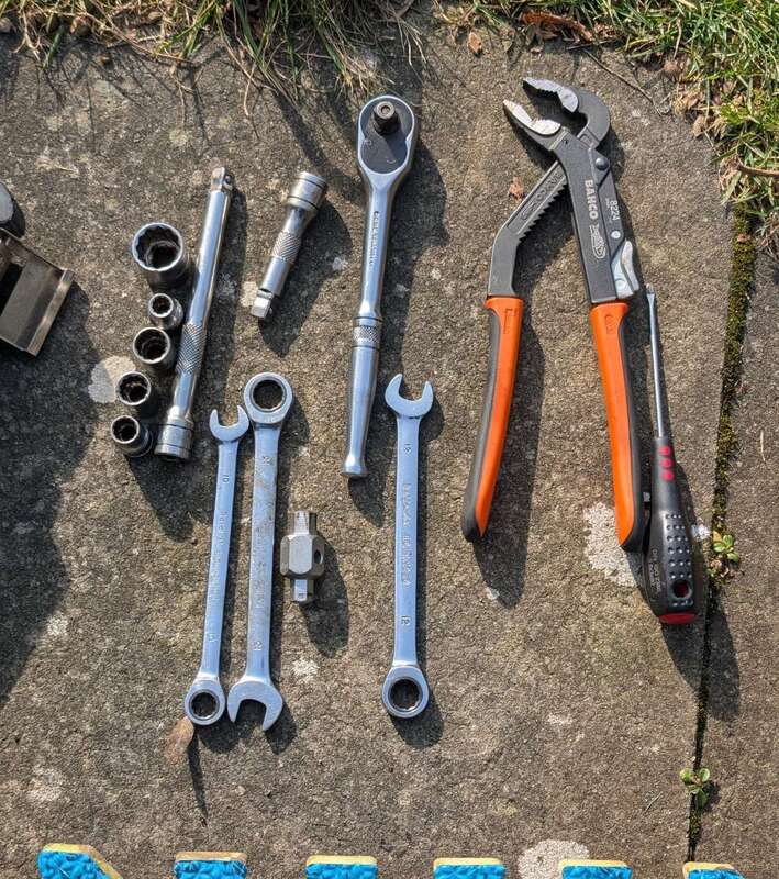

After a brief bit of reminding myself what was and wasn't removed/disconnected we got stuck back in.
Alternator was detached and tucked out of the way - the main terminal was threatening to pull the post out rather than unbolt do I just left it connected - there's plenty of slack to do this once the wiring is unclipped from the guides on the bell housing and crankcase.
Carb was next.  Not 100% sure this technically had to come off, but for the sake of removing two nuts and disconnecting a couple of cables it would remove a fair bit of bulk from the unit.  As the carb is being changed the cables all need to be unhooked anyway.

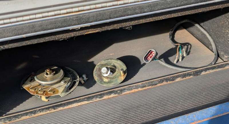

The ignition pickup was disconnected (made easier by the connector I added a while back) and the old fan belt were then pulled.  This has reduced the amount of "stuff" we need to contend with quite a lot and made the already small unit look far smaller still.
Starter motor then had to join the alternator as its retaining bolts double as retaining bolts for the bell housing.  This probably cost me the most time as I had to track down a set of hex bits for the bolts.
The cover on the points box was also removed to give a bit of extra clearance at that end of the engine.  Then the one engine mount directly under it was unbolted followed by the remaining bell housing bolts.  Only a small amount of swearing later while I figured out exactly which direction things needed to be twisted to fit through the available space, the engine was out.
It is indeed quite a tight fit to get it out between the inner wing and the gearbox in situ but it's entirely doable, contrary to what a couple of things I've read suggested.  Which I'm pleased about as anything which saves me from having to mess about with CV joints can only be a good thing.
Ignition pickup bits have been removed and safely stashed for transfer to the new unit.

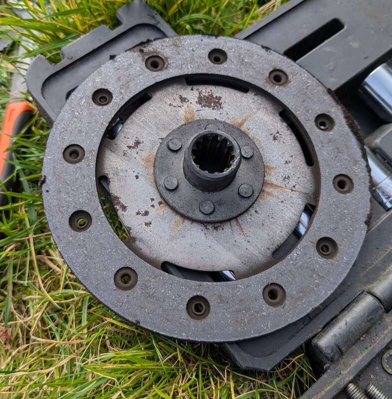

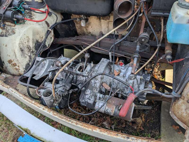

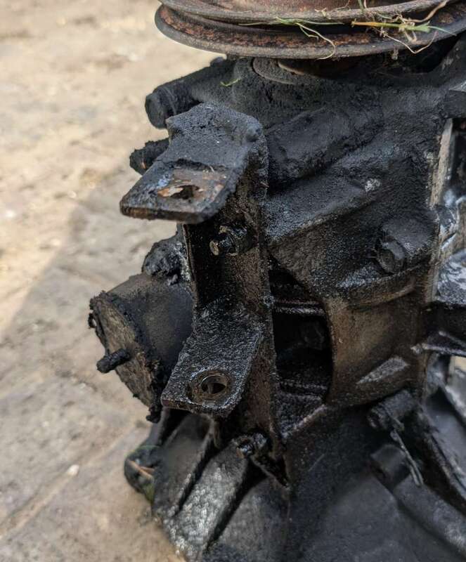

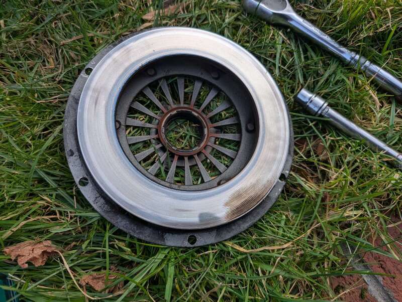

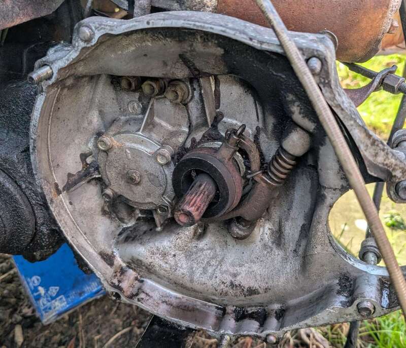

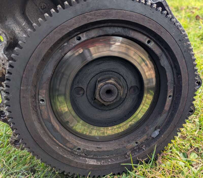

Pulling the clutch off I think has indeed revealed why we had some impressive judder when taking up drive.
There are more ripples in both the pressure plate and flywheel than the surface of the North Sea and there's evidence of a *little* bit of a hot spot.  No huge loss as neither of these components are being reused, was nice to see a reason for the symptom though.  Surprisingly the release bearing looks almost new.
We have a new one in hand though so it'll be changed before things are put back together.
Probably 45 minutes or so (and a decent chunk of that was me finding a hex bit to undo the starter motor bolts) to get from where we started to having it out and the bits I need to transfer removed.  Tools used:
Really do wish all cars were this simple to work on!

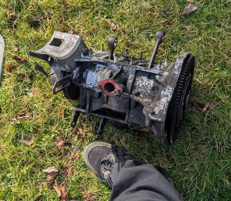

I think there is more oil in that bell housing than there is in the North Sea!

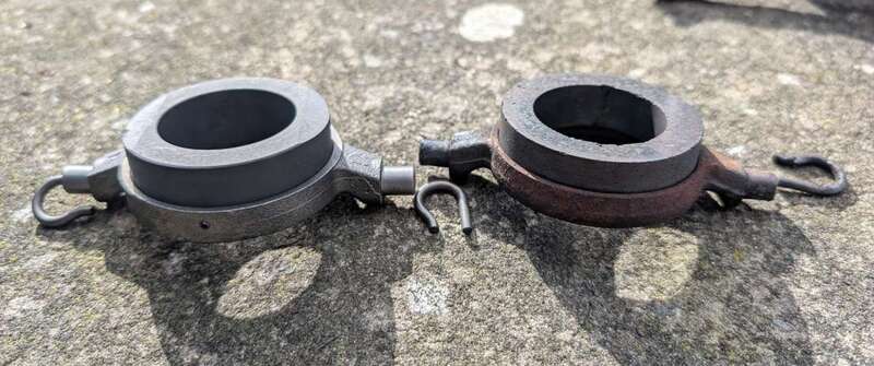

Interesting to see a graphite release bearing. While cheaper to produce, I'd thought it would be a roller bearing to give a bit more durability. I guess not that much stationary traffic in the USSR to worry about people sitting on clutch pedals at traffic lights.
I wonder if a leaking rear main seal would have caused a leaner mixture and helped contribute to the engines demise?
Or it's just blow-by from failing cylinder/piston sealing that caused a positive pressure in the crankcase and forced partially burnt oil/fuel mixture through the RMS?
Posted (edited)
Pretty sure the rear main had been dribbling when the engine was stopped for a while.  You can't have crankcase pressure in a two stroke really - if there was that much blowby it just wouldn't run as it would just choke itself.  I imagine it did play a role to some extent, but I think the bottom line is that the old engine was just very, very tired.  I think someone has chucked a set of new cylinders on it at some point in the not massively distant past when what it really wanted was a full rebuild.  I'm pretty sure the seizure marks on the pistons weren't something that had happened in my ownership, though I've no real way to prove that other than that there weren't any corresponding marks in the cylinders.

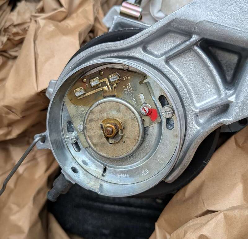

Has had the ignition pickup fitted.  I need to read up on how to time this as there's no actual mark on the trigger wheel to show where the firing point is.  I'm sure it's obvious once you've read the instructions, I've just not got that far yet - that's this evening's task.

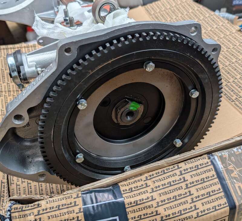

Flywheel looks considerably more healthy than the one on the old engine (as you'd hope being new, but still interesting to compare to the old one).

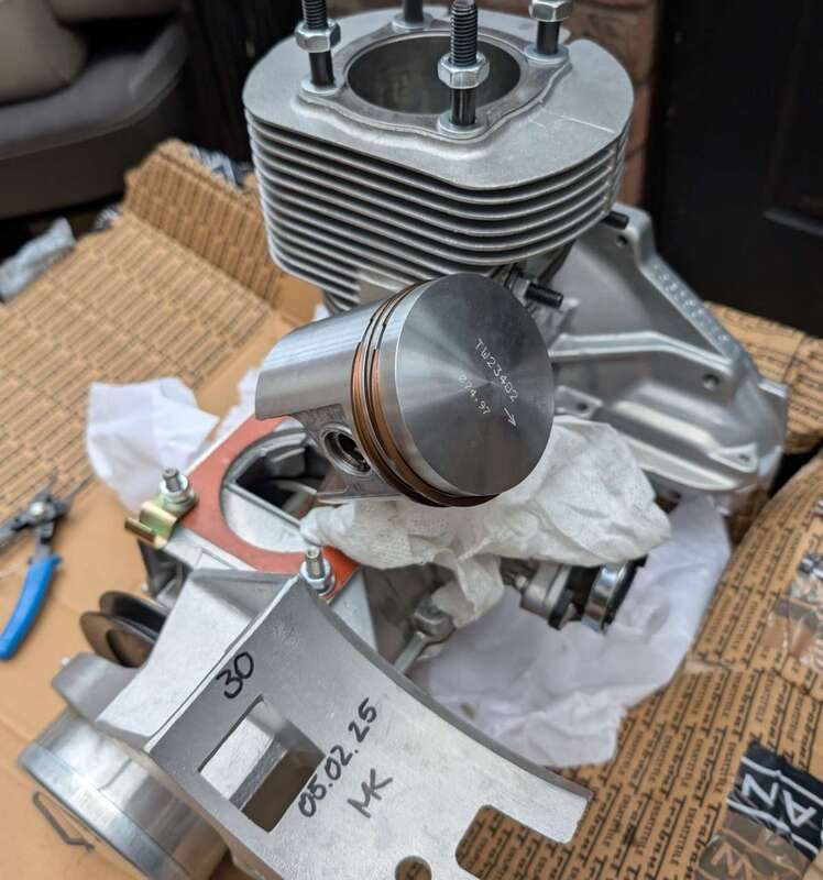

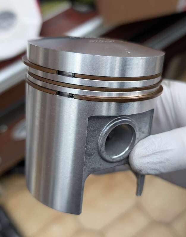

Shiny new pistons.
Which all went together pretty painlessly.  Note that it's very important to ensure the rings are clocked correctly on these engines as there's a little pin which keeps the ring gap clear of the cylinder ports.  If you don't line it up right you'll break things.
I didn't even launch any of the wrist pin circlips into my face.

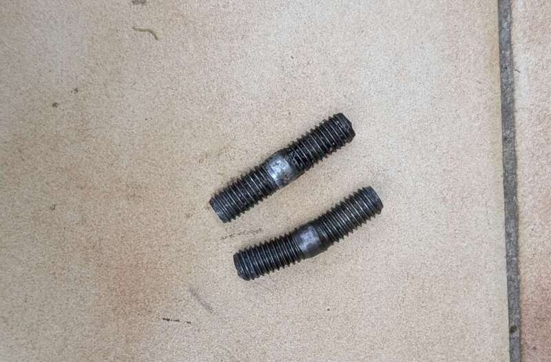

I do note that we appear to have one stud which has taken a whack during shipping.
Well done whoever managed that as this stuff was well packed.   That's where the alternator bracket attaches.
I'll pull the stud from the original engine and just transfer it over.  Just glad I spotted that now rather than after it was back in the car.
The pins on the pistons are to stop the rings from rotating and catching on the ports,not an issue on 4 stroke engines of course.

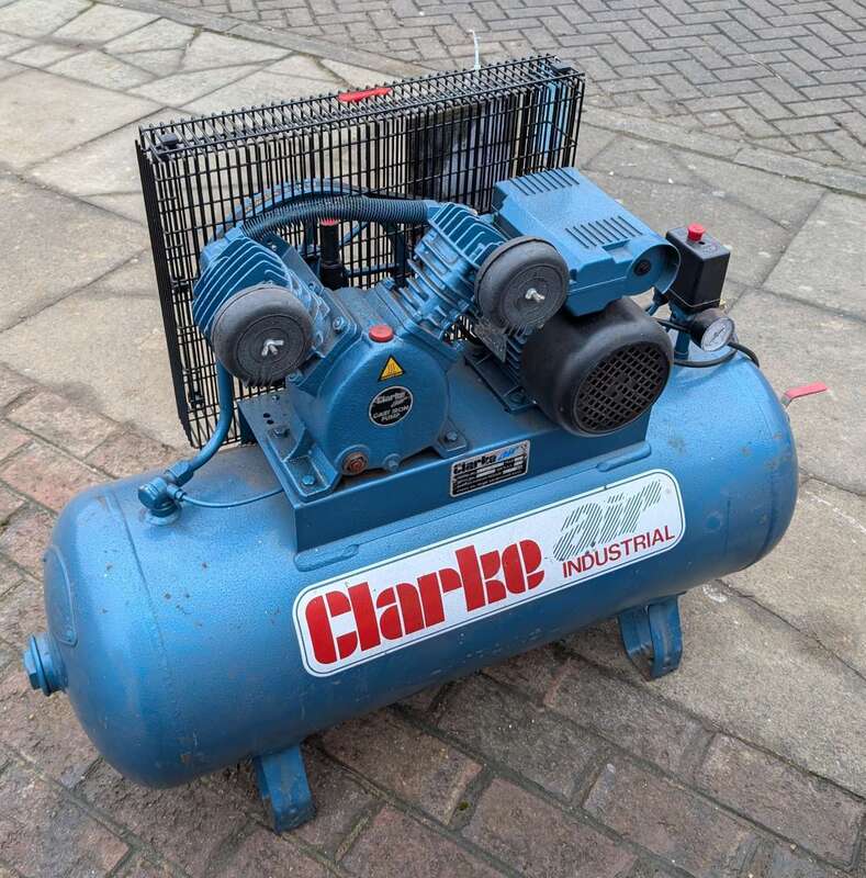

Nothing to report on Trabant progress today as by the time I got back from running various errands and had got everything I needed to for the day done I was out of time.

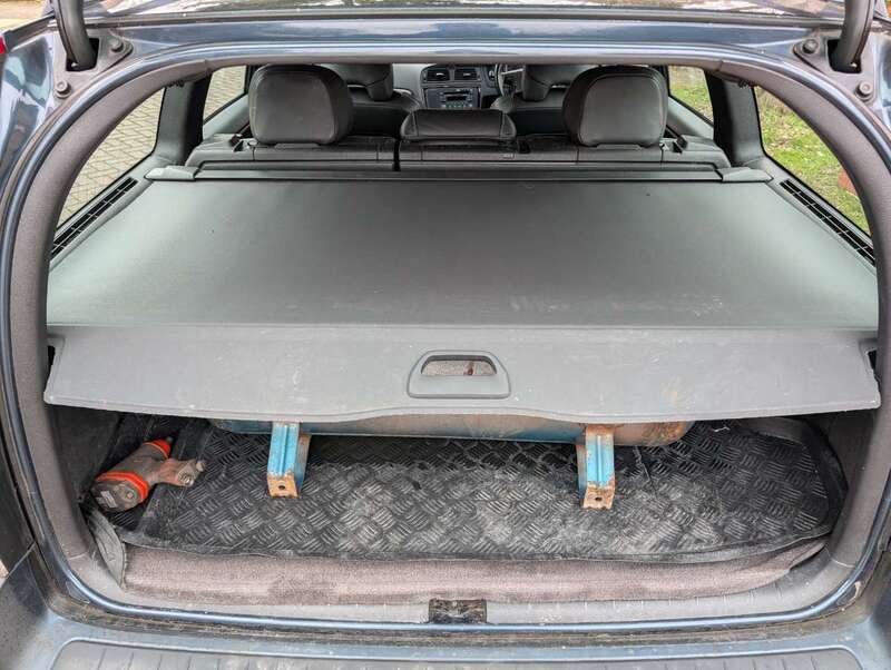

I did however add another entry onto the "things which easily fit into the back of a Volvo V70 which look like they won't" list.
Which in hindsight we should have loaded the opposite side up as it barfed a significant amount of the oil out of its crankcase breather.  Oops.  On the plus side I do have a plastic load by liner in there so no huge disaster, I'll give it a scrub tomorrow.  Compressor is probably overkill for my needs but the price was right and it was local.  I figure compressed air in the garage is one of those fields where it's always better to be over specified than under.  I currently have a 25 litre receiver up at ceiling height and a (tiny) remote compressor which really wasn't designed for garage applications.  The existing receiver I'll probably just leave where it is and pipe this up to feed into the system where the current compressor is - The fact that I don't want to have to mess about replacing a whole load of pipework may have a lot to do with that.   A bit of extra capacity isn't going to do any harm either.
I do however need to make a space for it to sit properly in, which is a task for the weekend I think.  Today was a case of "wedge it in far enough I can get the garage door closed and call it good."
Hoping I'll get a little bit of time for Trabant stuff tomorrow, though it looks like I've got a pretty full calendar so looking like it might be the weekend before I have a chance to get back to it.
Looks a nice compressor - I have been looking out for one similar for a while but nothing coming up local/priced right.

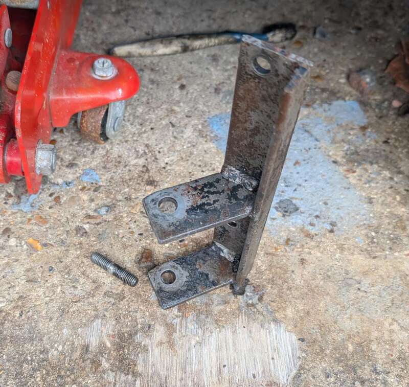

Couple of bits I need off here.
Yes there is actually an engine in there somewhere.

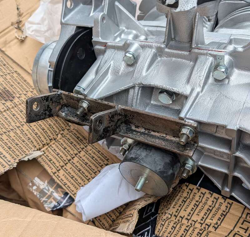

One alternator bracket and one of its mounting studs.
I needed one of the studs because one of the new ones on the engine had taken a knock during transit.  Thankfully it unscrewed without protesting.
Chased the threads on the old one before fitting just to make sure there was no gunk in them, though it unscrewed no bother (almost as if it had spent the last 20 years soaking in oil...) so was probably fine.
Alternator bracket and new engine mount attached to the new engine.

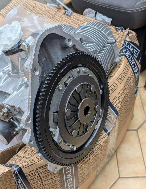

Clutch also assembled.

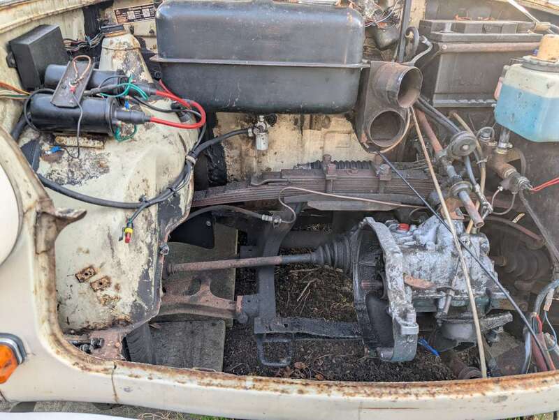

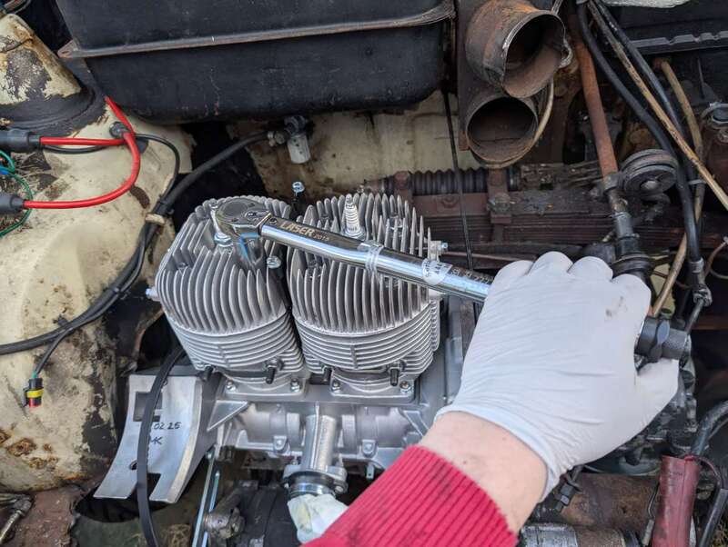

So where the heck were we?  Oh yes...I had a gaping hole in the engine bay in the Trabant and an engine waiting to go into it.

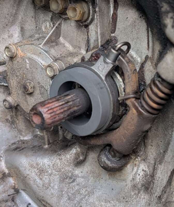

First port of call was to do something about the slimy mess that was the bell housing.  I didn't get carried away with this making it look like you could eat your dinner off it or anything, just got rid of the worst of the two stroke oil slime.
Comparing the new and old clutch release bearings shows that there actually is a bit of wear on the original one, though to my untrained eye it seems like it still had a decent amount of life left.
New one in place.
No photo of it, but I did clean up the gearbox input shaft a bit as well.
The two mounts on the gearbox were then changed.  Okay, fine I lied.  The lower one was.  The rear one on inspection actually looks perfectly fine (having escaped the oil contamination of everything else) and is a bit of a bugger to get to behind and underneath the steering rack.  I reckon it would be a doddle to do with the car on a ramp  - so it's going to get done somewhere down the line when I have such an opportunity.  It's not actually hindered by the engine being there or not.
This one however had gone distinctly squishy which I'm sure wasn't helping out clutch judder issues at all.

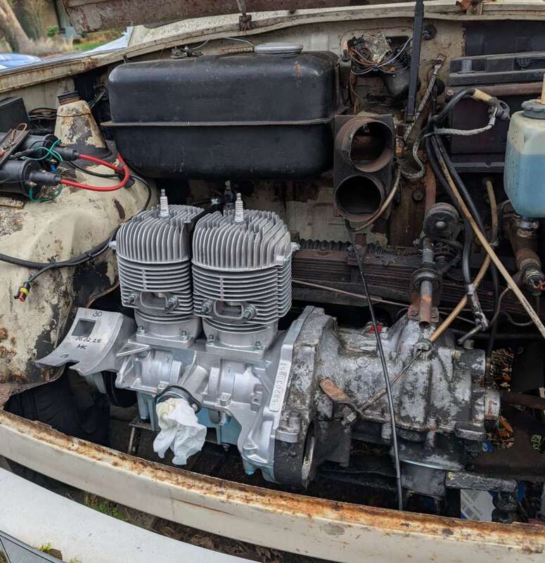

The next step made it suddenly look like I'd made a whole bunch of progress.
This was actually the easiest engine to slot in I've ever handled.  It literally just slotted in - didn't even have to faff around getting the gearbox input shaft to line up.  There was about five seconds of wiggling while I got the lower engine mount stud to line up with the hole in the subframe, but that was it.  Once the engine was actually secured in place I grabbed the torque wrench and went over the head nuts.  As predicted this was far less annoying with the engine held in place.

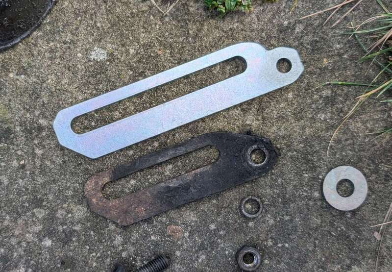

Here's a comparison between the standard and revised alternator top bracket that's needed to accommodate the larger carburettor.
Installing the carb itself actually took about 30 seconds - though routing the new cables probably ended up occupying half an hour or so - mostly because you need to dismantle the choke cable to fit through the same grommet in the bulkhead as the original (roughly centre frame above).
This lot needs to come off the carb end or there's no way in hell it would fit through there.
Just glad I didn't end up pinging that spring off into oblivion.  It's almost like I've learned from previous mistakes in that I did that INSIDE the car with the doors closed just in case it did make a bid for freedom.
Getting there.
That little fuel filter doodad isn't actually one of those glass ones with the ends that unscrew - it's bonded together and just visually looks similar.
Really wasn't that long between that stage and this stage.
There was video recorded of the first start - but there may as well be no sound as it was windy and all you can hear is wind noise.  On the plus side, the wind did mean that the smoke dissipated (relatively) quickly!
I was expecting somewhat biblical levels of smoke though.  I'd put a decent amount of oil down both bores and into the intake as I really didn't want to take any chances of the engine running dry on the first start.  I was not disappointed.  I'm sure our neighbours will forgive me one day.
Aside from needing to tighten the fan belt a touch, and I need to pull the cowling again most likely as the rubber pipe for the heater pre-heater connection is touching the belt inside the cowling.  I'll see if I can get in there with a pair of pliers and pull it clear, but I suspect I'll end up pulling the whole blasted cowling for the fourth time.
I definitely need to find the front air dam which should be below the bumper - it's primarily there to keep road spray off the alternator, and with that being hung down even lower now it really is very exposed.

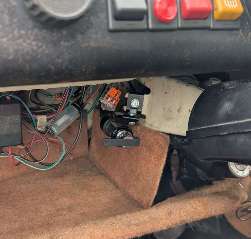

I'm not a huge fan of this choke arrangement (well technically it's not a choke on a Mikuni though as far as the effect on the engine is concerned the purpose is the same).  It's secure enough (the little L-bracket is chunky and metal) but just feels a bit shonky.
I'm inclined to just enlarge the hole in the original control's mounting point so the intended retaining collar can be used.  It's a kind of odd control anyway.

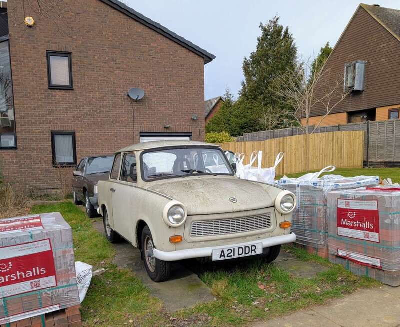

The big news however is that she's moved!
Only been around the block a few times and nowhere beyond 50% throttle so far as I'm following (one of) the guides to breaking in the new engine - but should be pretty much clear to resume normal use tomorrow, though I'll definitely be exercising a bit of additional mechanical sympathy for the first couple of hundred miles.
First order of business this week though is going to be a wash!
I have cleaned the windows, but this is just begging to get pulled over by some traffic cop having a bad day with the car being this filthy (c'mon, she's scruffy enough at the best of times).

A bit of rattle I can deal with.  It was the rotational (but not every engine revolution) noise that sounded like a fan or water pump with a shot bearing noise which always made me suspicious.  I suspect that lines up with the distinct tight spot I can feel approximately every 3rd revolution of the crankshaft when turned by hand.  I have a feeling there's a roller somewhere that's got a chunk taken out of it or something like that.
At idle in neutral the gearbox currently is nosier than the engine from inside the car.
