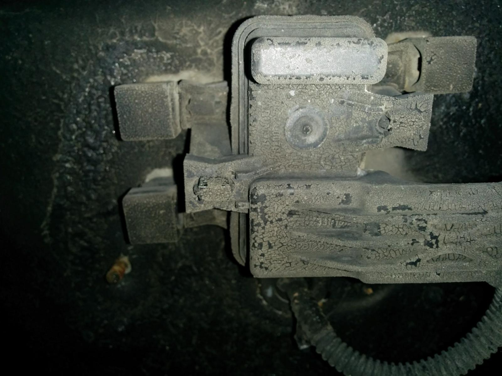

This one was intended to help me work out how to get it off the car, but it started raining so I stopped trying.
This one shows the connector going into it. It's filthy and corroded and I'm pretty sure that some of a wire broke away in my hand while it was fiddling with it, so I reckon if I can get some access to this and do a bit of rewiring, we might be in business, to some degree at least.

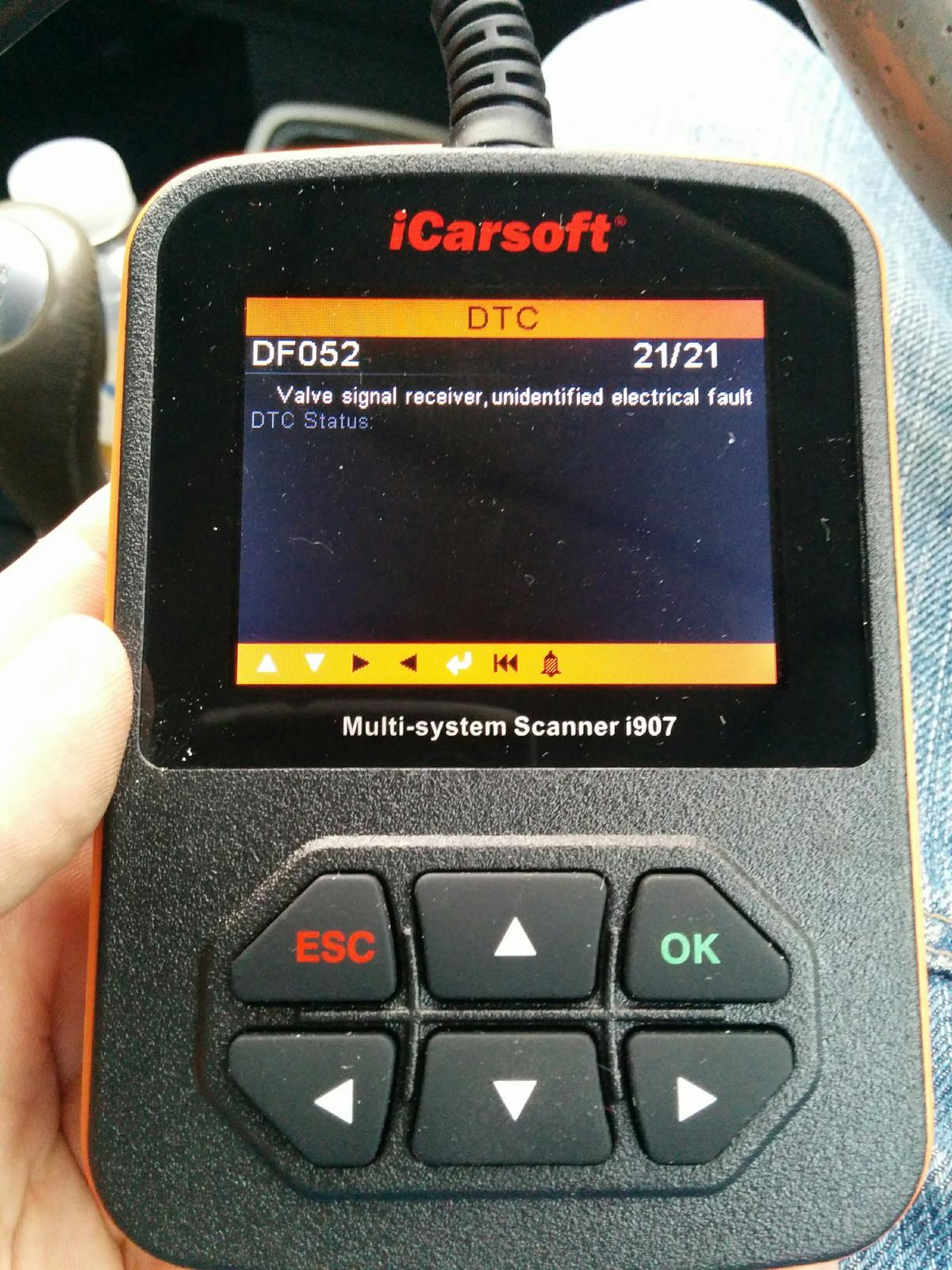

Incidentally my super diagnostic tool confirms that something is fundamentally up with the receiver, it's not just a case of the sensors being knackered (well it may be, but we don't know which yet).
Meanwhile I can see that the faulty parking sensor is on the right... hopefully that means the outside right one; I'll start working in from there.
Renault were just absolutely hilarious* with their early-2000s cars.
Let's put the electronic handbrake motor, TPMS receiver, and other vulnerable electronics on the underside of the car with no real guards or covers in place! WCPGW?! :D
