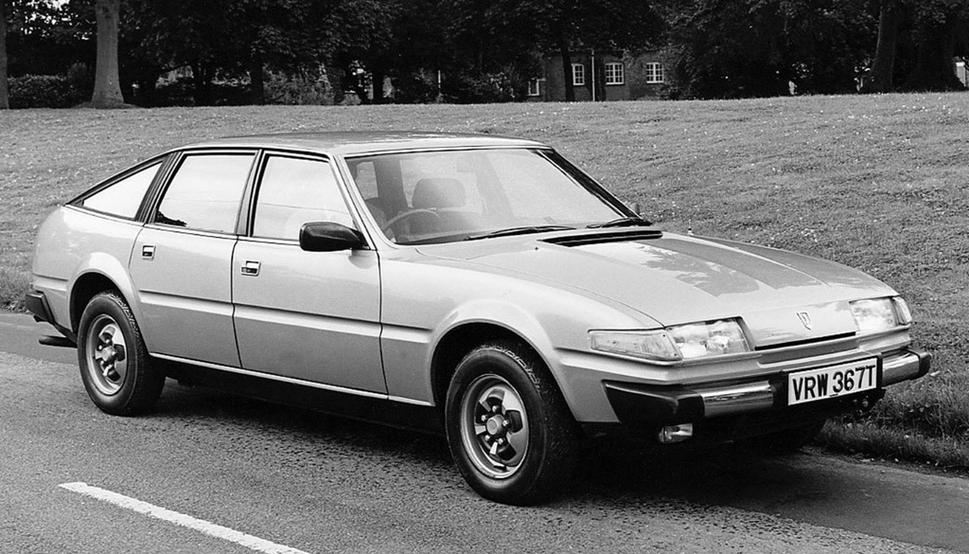

That looks lovely! ☺️ But it's definitely sitting too high at the rear. The 2600's had the self leveling Nivomat rear springing and damping set up. Make sure that is operating correctly,or you might in the future be looking in to replacing the rear springs and shocks as none of that kit is now available...oohh but for that interior you'd forgive it anything! ☺️

It does look high to me but if this picture is anything to go by it;s normal
Worst case scenario if the nivomat thing is playing up I would imagine the bits to put it onto standard dampers are probably cheap and it's a pretty old tech rear end on these isn't it? (I remember people being unimpressed with it on paper after the de dion rear of the p6)
It does sit too high, but springs aren't bad to swap. 2300/2600 SD1 parts are ridiculously cheap from Rimmers.
New Boge shocks are available from the SD1 Club, the matching springs from Rimmer Bros.
Drive around a bit and it should self-level to the correct height. If it doesn't, then start worrying.

That does look lovely - the SD1 is something of a favourite of mine. Are the tyres the correct size? Low profile tyres can sometimes make a car look like it is on stilts.
I don't know to be honest. I think I'll use it for a bit (once I've changed the cambelt, which is £11 and according to autodata a 0.75 hour job) and see how it sits then. It's really not been used for years and would benefit for some good usage really.

I will be very surprised if the car is sporting nivomats - they are prohibitively expensive and dont last very long.
It has probably had a kit fitted from Rimmers. I would'nt fit vitesse springs as the extra ground clearance is actually a bonus.

I was just thinking, it's got new bolts holding the fuel tank on so that's obviously been of for some reason meaning it's been on the workshop up on the ramp, I'm wondering if that's why the rear is sitting so high and it's only done 20 miles in the last 7 years, it probably just driving to settle down again.
You have to take the tank out to do the trailing arm mounts (unless you want to blow up). It's a common sd1 fail and a shit job so if it's been done on this I'd take that as a bonus.

Looks nice Trigger. Look forward to seeing you improve it even more. Rear suspension does look high as said by others.
Sounds daft but I think the ride height thing is because a Series 2 in red is so rare unless it's a Vitesse, usually modified so even lower these days. That we're just not used to seeing red cars with standard suspension.
This 2300 from The Doctor a couple of years ago ,looks even higher.post-17414-0-31433500-1501280889_thumb.jpeg
Didn't these come with Boge rear dampers?

Only top of the range cars got the nivomats - you can tell if they are nivomats by the rubber gaiter at the bottom.
